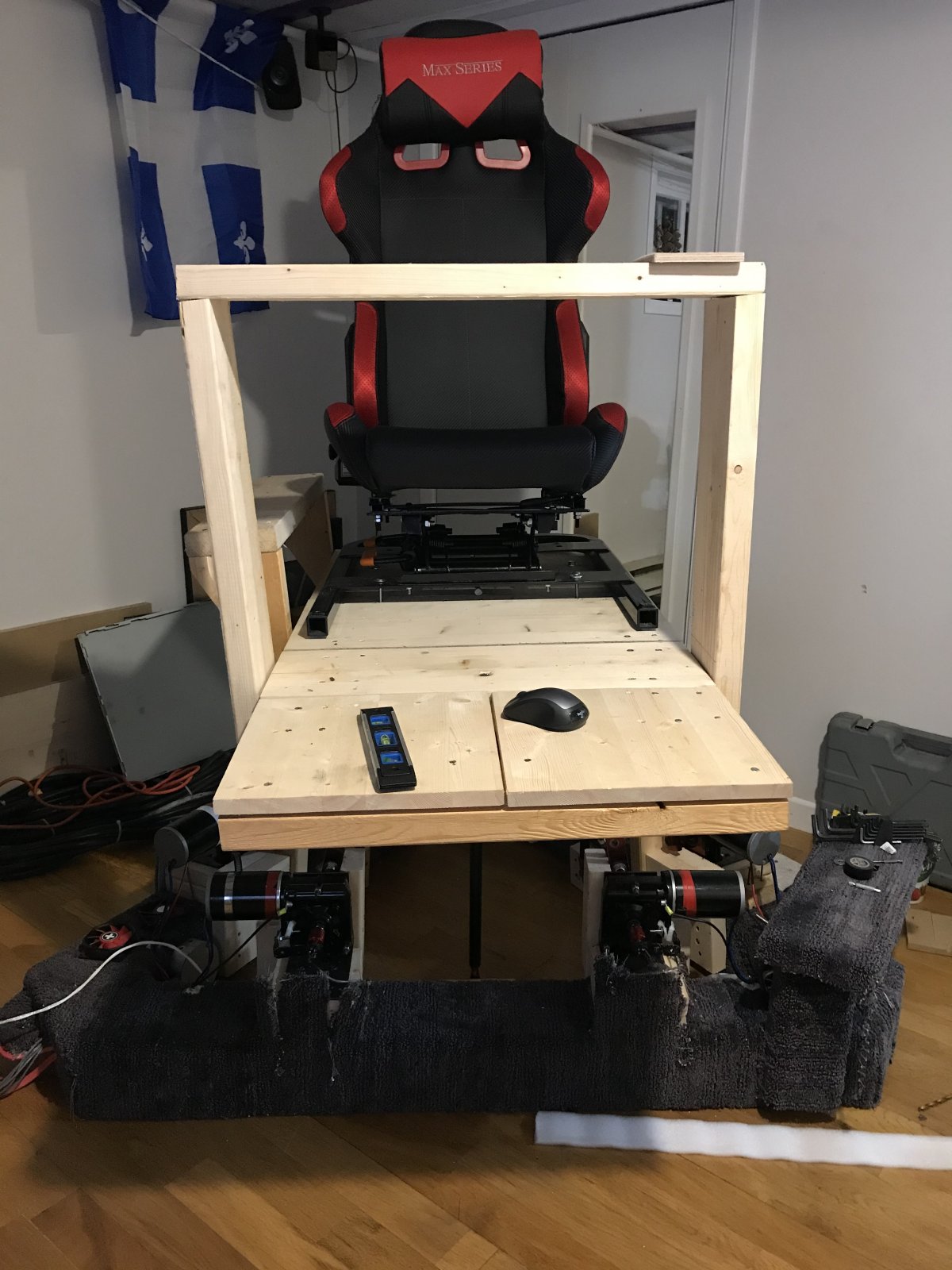

    So......wooden platform is almost done.....need to drill hole for my shifter and handbrake.
    oscillation problem is a thing of the past. there were a few setting to change in describe software.
    but now i think 5 of my gearbox are 25:1 and 1 is 50:1......the 50:1 can do anything it want, with or without me on the platform(i have 40kg strut under each mounting post) and the 25:1 can't bring down the platform if it has no load on it and in certain circumstances can't lift me up(when the angle of the platform are really extreme with this motor alone in smc3). so i've ordered a few more 50:1 motor and i think i'll be fine with those. maybe should have counted the rotation before i order but seeing how it reacted my guess is preetty good me think.
    current draw on the motor is fine.....around 6 amp under normal circumstances.....can go to 9 or 10 with a heavy angle on the 50:1 ......on the 25:1 tough, it caps my power supply at 14 amp pretty regularly.
    the thing is way more powerful than i expected. I'll see if i can live with the 25:1 under the 2 post where my feet are, and just changed the 4 other.....if not i'll change them all.

    AAANNNDDDDDD.......IITT WWWOORRKKSS....
    my gas strut are not strong enough tough so I had to use the closer hole on my arms so movement is a bit limited. It's going to be enough for now until I've tried a few games to make sure it's pleasent enough to continue investing on the thing.
    Pretty happy with the thing. It runs off a single 15 A/120v outlet with rubish power supply. Efficiency is around 50% on those, but all in all my motor run around 5A in average so no breaker tripping and no special outlet.....yeah!!!
    Underestimated the load put on the front motor as those are the one where the weight distribution are the fartest but they have almost no load on them as my fat ass sit the fartest from them. Still it's the one that struggle the most. Until I buy new gas strut i will have to be careful where i sit I think.
    I haven't figured out how to configure simtools forsway and surge movement. Can't figure it in my head how those two movement are made. Tought about it a bit last night after goind to bed, and my guess is you need only 4 motor for those two movement. Can someone point me in the good direction for this? In the meantime I'll make a few more try.
    Now need to put the controllers in a computer case. I've push back on this task as it was not essential but my ears are gonna thank me a lot if I do it fast. Fans on the power supply are freakin loud. POMAN was using 6 of those, don't know how he endured that thing. I have only 3 and they are driving me nuts. I've made the motor wire 20 feet long in case it's too loud and i want to put it in the wardrobe. I hope sound will be dampened enough in a case to put it under the platform. The whole thing take a bit of space, and if I can save on this, I'll do it. Probably will build a cage to put it in,in case something bad happen or probably more for when something bad happen :p
    I'll try to put a few videos of my journey here tonight and at the same time apply for the license for simtools as I play almost exclusively assetto corsa. Tought if it all works ill give MSFS2020 a go for sure. Will porbably require a new computer tough :(
    All in all it cost me under 2000$ cad for a 6dof platform. Was ready to buy a dofreality for 8000$ cad but couldn't do that until a few more years saving. How great is that, i'm really happy. I probably need to invest 100$ for new strut and i guess around 200$ for 3 new dell power supply. Those can output more amp than my chinese one so probably that fans will be quieter too......

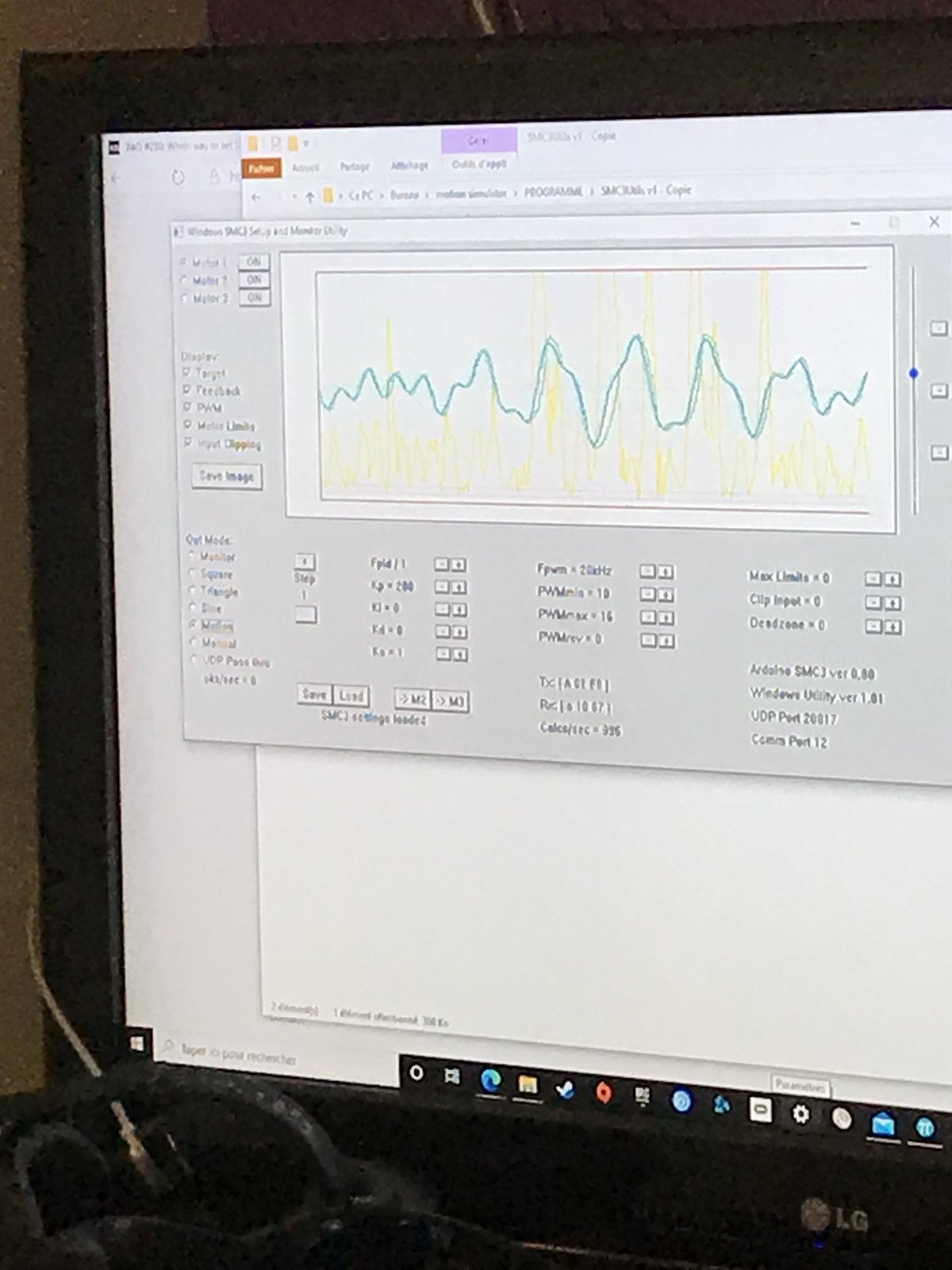

    Hi
    here is a few screen from my simulator....first one is how it's made second one is a screenshot from smc3util. it's from one of the motor at the front( so the weakest one.) you can see in it that in big elevation change(going up), there might be a slight delay. that's why I'll probably end up having bigger strut in place.
    In simtool i have limited the movement of those 2 motor so that they are always in the sweet spot mechanically wise so they don't end up lagging. if i limit the pitch they stay near 90 degree on the arm so are way stronger.
    the 4 motor at the back don't have any problem as they are directly under me and there's no weight beyond in the rear. the gas strut is fine in this situation. the 2 in front end up having my feet(and so the platform)extending about 20 inch beyond the motor. never tought it would have put such a strain on them.
    once i have my simtool licence i'll start to play with assetto corsa to see how it fare in real life.
    I made pretty much all the simulation possible in simtool and even in the worst case(3 or 4 arm maxed out i think) it can bring me back without any trouble. It gives me some nice angle in almost all the axes but still i want more, especially on traction loss. so bigger strut on all 3 axes are on the plan. hope i'll size them right this time. i have 3 times 45 kg installed, and i plan on 3X 60 instead. hope it'll be enough to go with my 2nd hole on my arm and this way it should have enough throw that i can do whatever i want. story for another time. meanwhile I WANNA TRY IT :p

    Holy crap it’s working!!!!
    Couldnt do more than a 2 min drive before 1 am rang in. Traction loss will have to be readjusted its too intense. But it s freakin workin....woohoo.... my 5 years old self stare in disbelief. I have dreamed about that for such a long while. For the longest time never even tought it was possible to jave rhat in my house and now.....playin in vr with a motion platform.......can t waot for tomorrow night to try it for real......
    was amazed that motion compensation in pitool for the pimax was that good. Had to recalibrate the headset and it was done. Hope that when i add my buttkicker it will stay the same.
    Job for another time, now let s enjoy this thing
