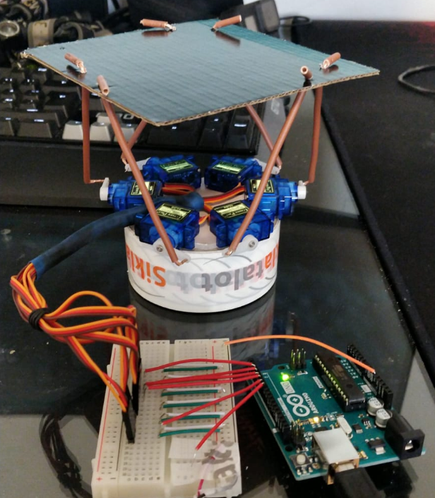

    Update:
    Soon to order all parts for the big build.
    In the meantime I bought a few small servos and built a small scale sim with arduino board to test out a few things. Testing seems to work well and axises seem correct.
    (yeah few cables came undone)
    Do I need a license for SimTools to test this with a game like Dirt Rally? Now SimTools Game Manager only has Live for Speed and no other games.

    Well done :thumbs
    SimTools comes bundled with the fully functional Live For Speed plugin, specifically for testing purposes: https://www.lfs.net/downloads
    For other plugins you do need a licensed version of SimTools.

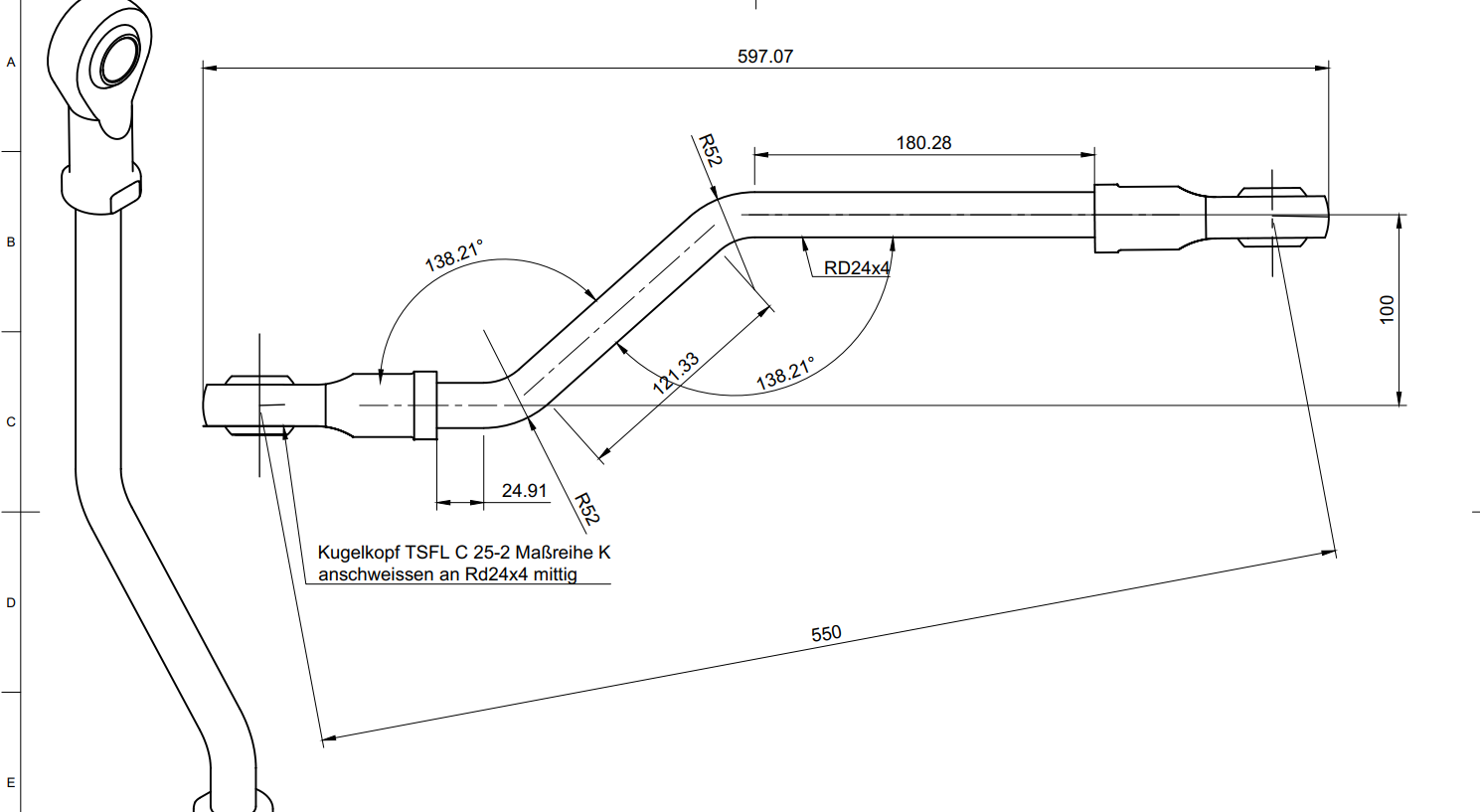

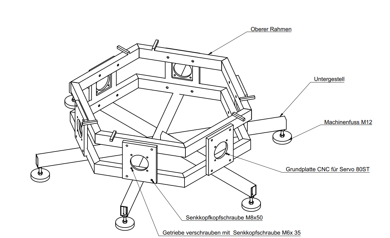

    Yor design is similiar to my one . if i may help with experience
    the width of the hexagon is 800 mm and the side length is 400 mm, then everything (motors and power amplifiers) fits into the rig
    the feet down works as hardstop for calibration with thanos or m4s controller. with your gearboxes you can have levers of 180 mm .
    To make the machine very compact, I recommend that the connecting rod between the upper and lower is curved.
    i use spacers to m16 for the m24 ball joints to obtain more freedom but for the beginning m16 balljoints work too.
    Cool Project. Have fun.
    Viel erfolg
    from my first plattform
