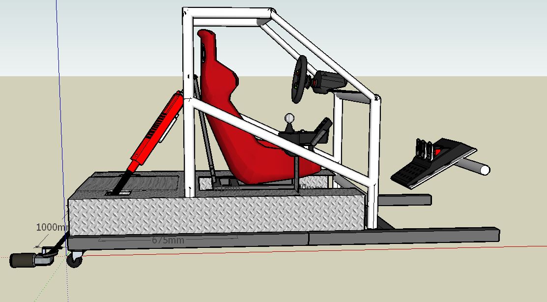

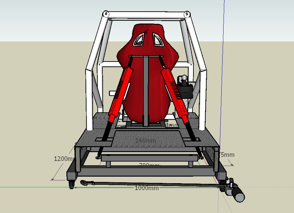

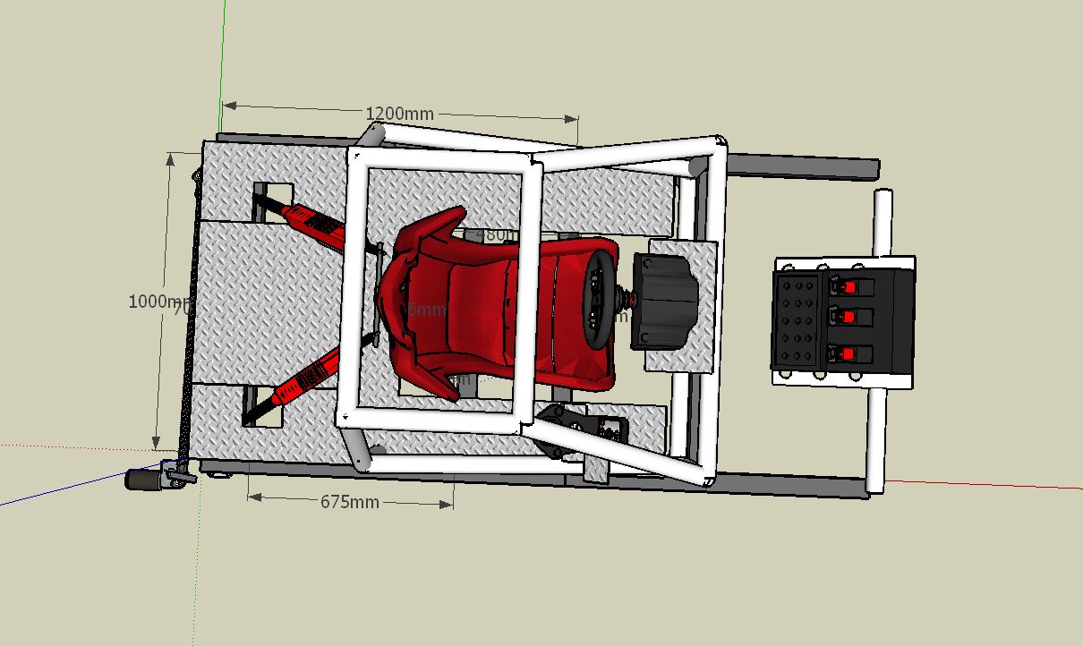

    ı want to review my purchase list with you.
    3x http://www.sahibinden.com/ilan/yede...arazi-araci-12-volt-mini-vinc-208108518/detay
    8x Moto Monster
    3x JRK or 3x arduino UNO (Never done coding before,but i know i can manage it)
    ?x Power sources ( after calculations)
    3x Rotary potentiometer
    Hbridge
    1x http://www.sparco.com.tr/urun/sprint-v-new_5160.aspx?CatId=156
    1x Thrustmaster T500Rs with F1 and
    1x TH8A shifter
    1x Oculus rift dk2
    That is roughly the need i think.If you have any addition on the list,i would love the ideas.
    The design is almost done,i will show some drawing later on.Actually i am an artist,so design is important for me.
    Kind Regards
    Baran

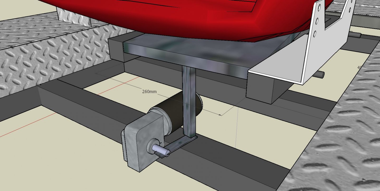

    @Pit The link is general look of the product.I have talked with them about the specs and managed to find the 12v motor with the specs i have listed before.
    checked the link you gave,they are the same company.
    What do you think about the design ? i have find an arduino r3 in local dealer.will that be enough ?
    Thank you

    do you recomend to do seat mover or platforrm mover.i think i will go with seat mover ,it looks more realistic.i want to know your ideas about this and the latest list i have made.because i am making orders tonight.if i will go with seat mover i will update the project photo.
    @Pit @noorbeast
    2x http://www.robotistan.com/10K-Potansiyometre-Ayarli-Direnc,PR-281.html
    2x http://www.sahibinden.com/ilan/yede...2-atv-winch-2000-lbs-atv-vinc-148352757/detay
    what about this motor
    http://www.robotistan.com/12V-55-Rpm-Cam-Silecek-Motoru,PR-1628.html
    2x http://urun.gittigidiyor.com/ev-elektronigi/arduino-uno-r3-yeni-versiyon-ucretsiz-kargo-159402536
    4x http://robotus.net/robot-malzemeleri/l298n-motor-surucu-devresi-2-kanal/
    or http://www.robotistan.com/L298N-Voltaj-Regulatorlu-Cift-Motor-Surucu-Karti,PR-1329.html
    some plastic chair at first tests.
    already have driving force gt and screen.
    i dont know how much psu i need.i need help on that .found this
    http://www.hepsiburada.com/liste/hi...tails.aspx?productId=bd303945&categoryId=1012
    Total : 455 $
    will be running on notebook
    intel® Core™ i7-4710MQ 4-Cores; 6MB L3; 2.50GHz > 3.50GHz; 47W; 22nm
    2GB GDDR5 nVIDIA® GeForce® GTX860M 128-Bit DX11.2
    8GB (1x8GB) DDR3L 1.35V 1600MHz SODIMM
