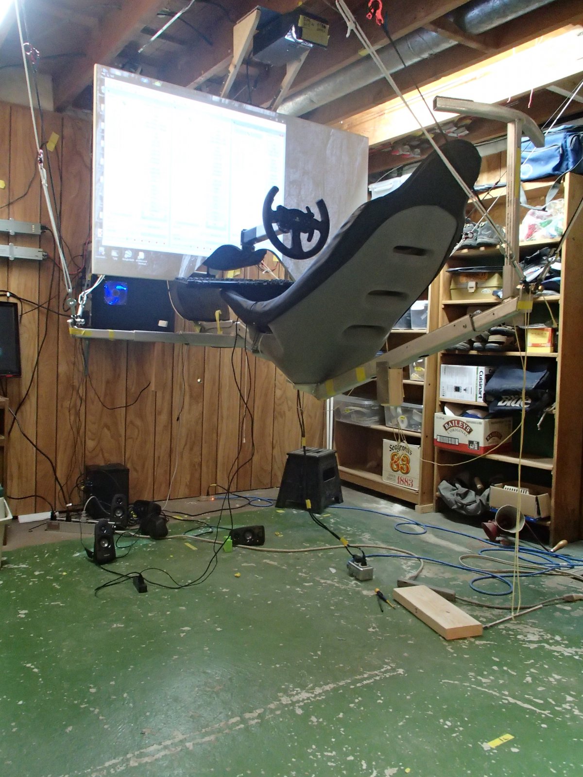

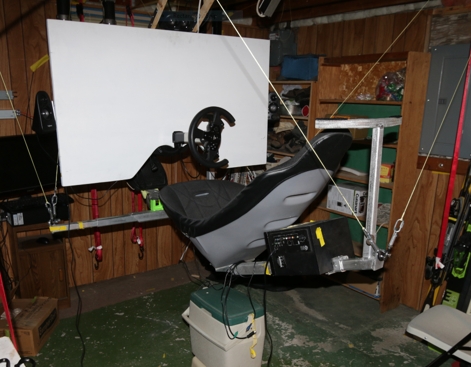

    Here's an update on the latest suspended Rig. Others rigs are on other posts.
    Right now I have about 30 in. of vert travel (limited by ceiling height: ) and more tilt than needed. Sway and serge I'm hoping for about 30 in.+ as well. I would love to show you this in action but I'm have limited time for the next month or so. I'll update when I'm up and running again.

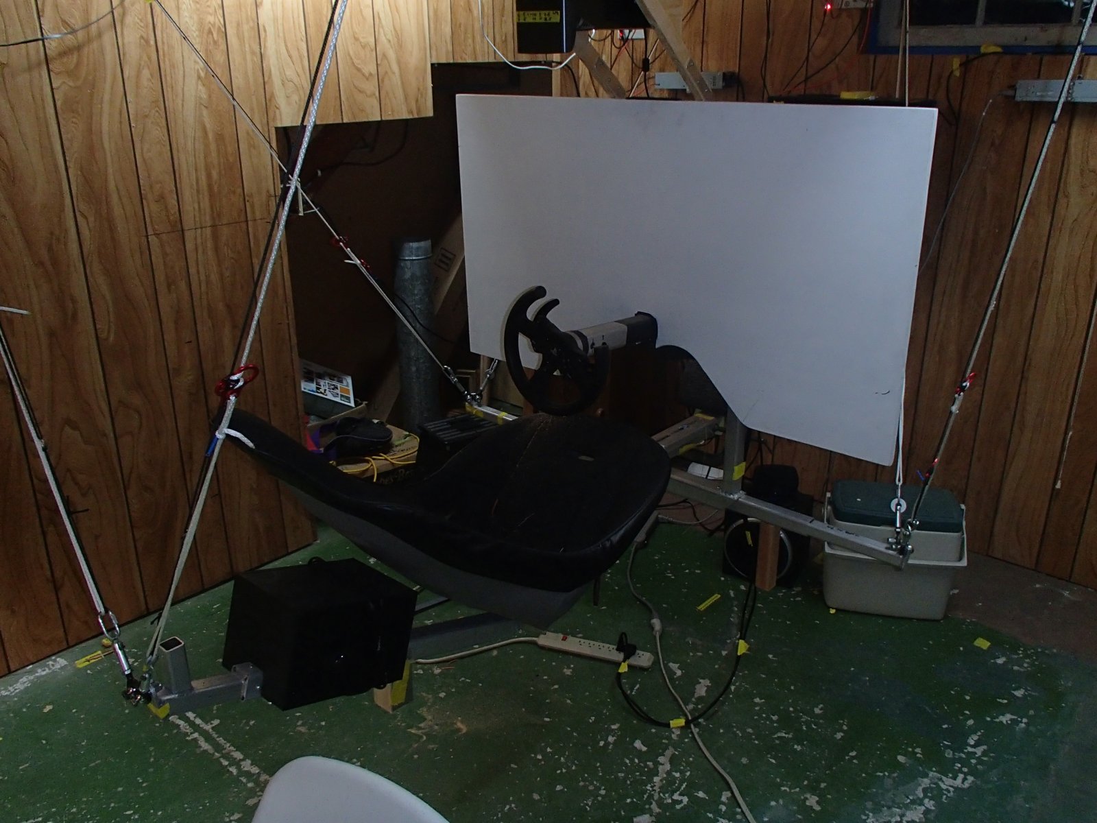

    Hi, Getting time to continue the build
    1st cable version 2 axis.
    This was the next version. 3 axis! I liked these because the pivot is above the cog. I could run this about an hour before i started to get queasy. Had traction loss on this one and a true 6 cable hanging rig
    • Like Like x 7

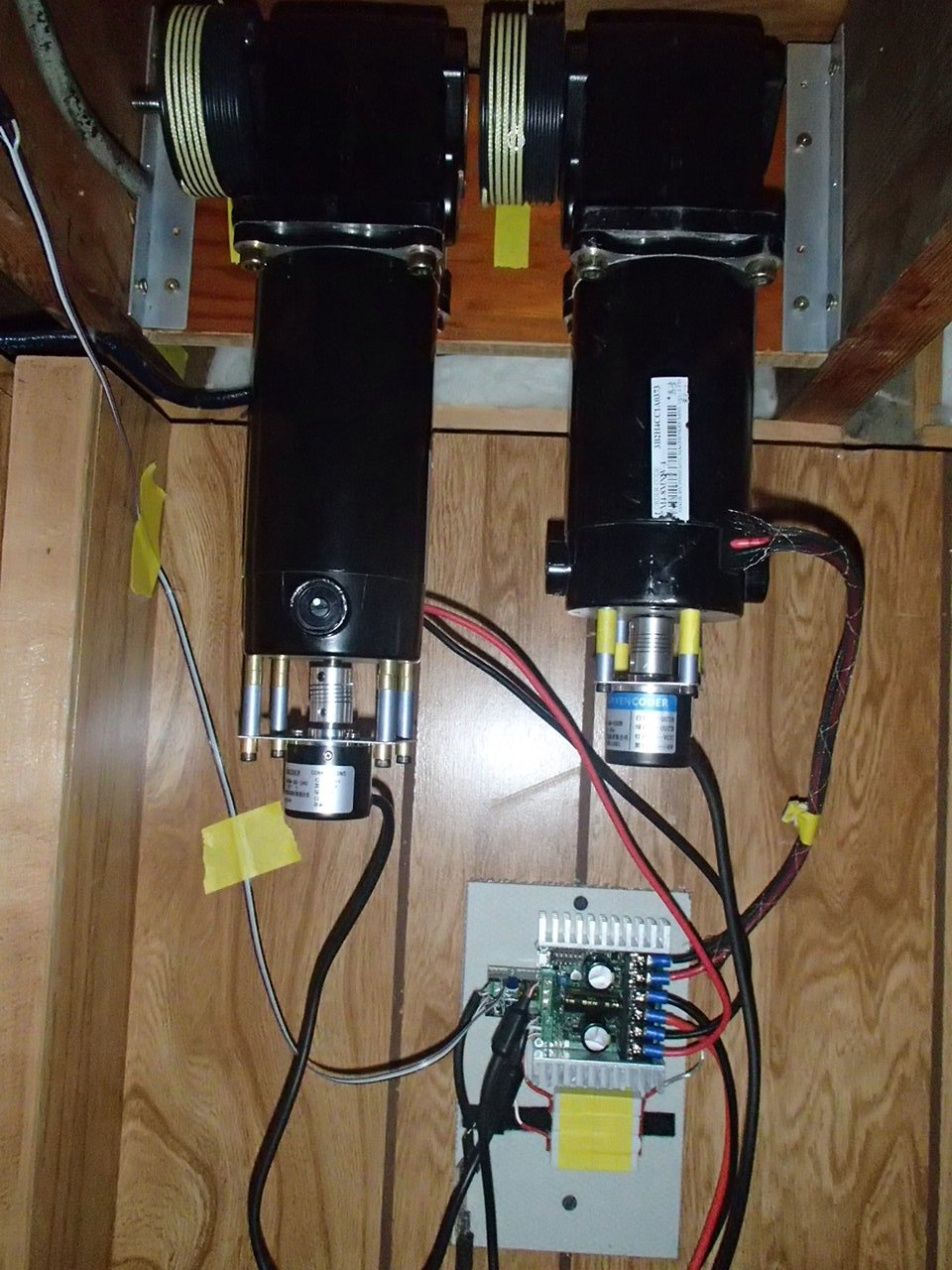

    Could we get a few pics of the cable reel end?
    Im curious what size motors, gearing and drum diameter you adopted.

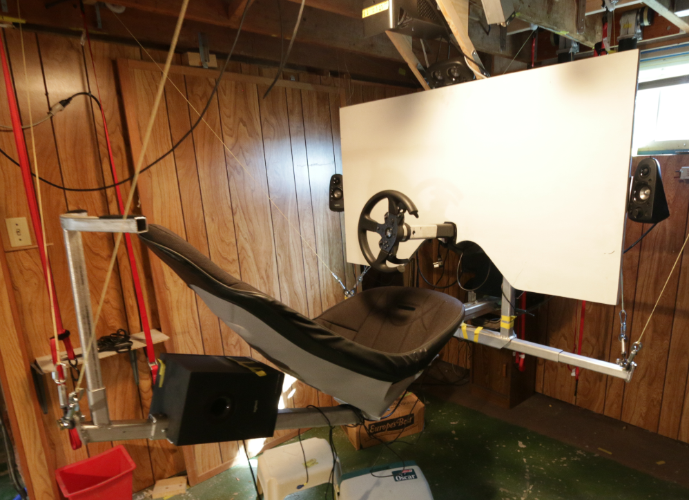

    I'm using 24 v wheelchair motors on 12 v power-supply with 3 in pulleys. Sorry the two Rigs in the videos have been scraped for the upcoming 6 dof. Should have kept one to race with : )
    Here is a photo of the drive. Might need to add counter weights to take some strain off the motors. Will clean up the wiring when I get past the testing stage.

  6. JAD
    JAD Active Member
    Jan 17, 2016
    205
    Australia
    1,446Coins
    +142 / 3 / -0
    Thanks for that.
    I dont see any issue for you running the Flypt Mover. Its just flipping the directions as required.
    You mentioned about possibly adding counterweight, but I reckon you have a lot more to gain by going 24v.
    I also run the sabertooth with the kangaroo and encoders like you have there.
    How did you incorporate the limit switches?

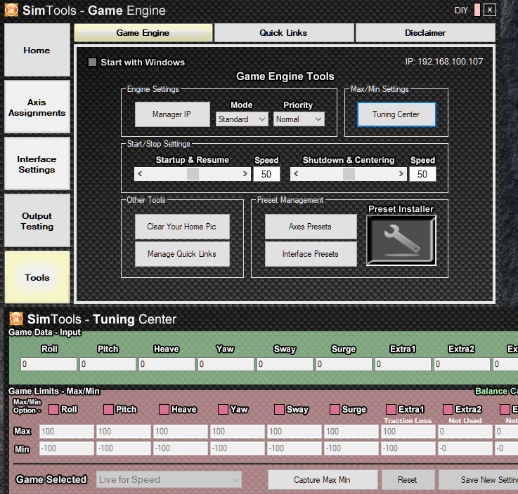

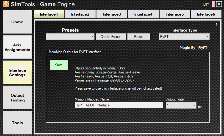

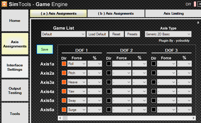

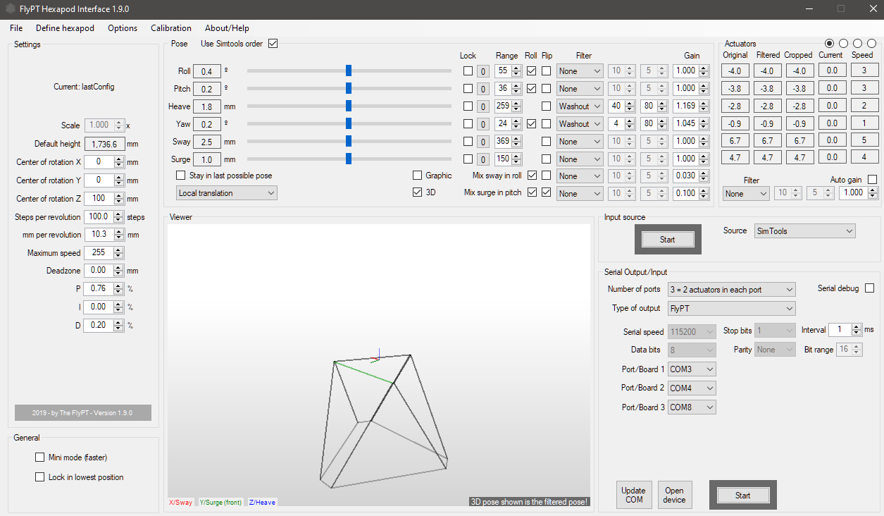

    No luck. Help required!
    Can you see what I'm missing?

  12. JAD
    JAD Active Member
    Jan 17, 2016
    205
    Australia
    1,446Coins
    +142 / 3 / -0
    Check out this post from FlyPT.
    It looks like you need to add the 100% values to the axis assignments and re-arrange the forces.
    https://www.xsimulator.net/community/threads/flypt-mover-interface.13464/page-3#post-180938
    I havent got into FlyPT's Mover yet so I cant be sure if that is all you need to look into.
    Im still experimenting with Simtools and coming to understand the axis assignments and tuning relationship.
    I was looking to jump on when he puts out the next update.

  14. PaulB
    PaulB Titanium2dof
    Apr 15, 2017
    121
    Canada
    723Coins
    +57 / 1 / -0
    I think FlyPT can work the way it is for my one off. I just imagine everything upside down. : ) FlyPT has such great potential to be able to program the way I need!
    My problem I think, is just getting the correct versions of software and plugins to work together.
    Thanks for all the work. I look forward to next week.

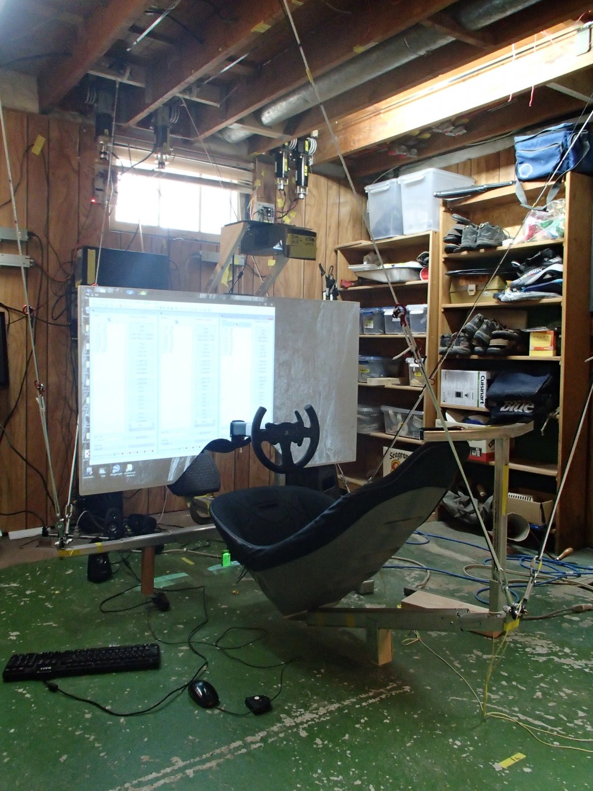

    Quick update. Still sorting out Tuning issues.
    Here you go for the race this weekend! : )

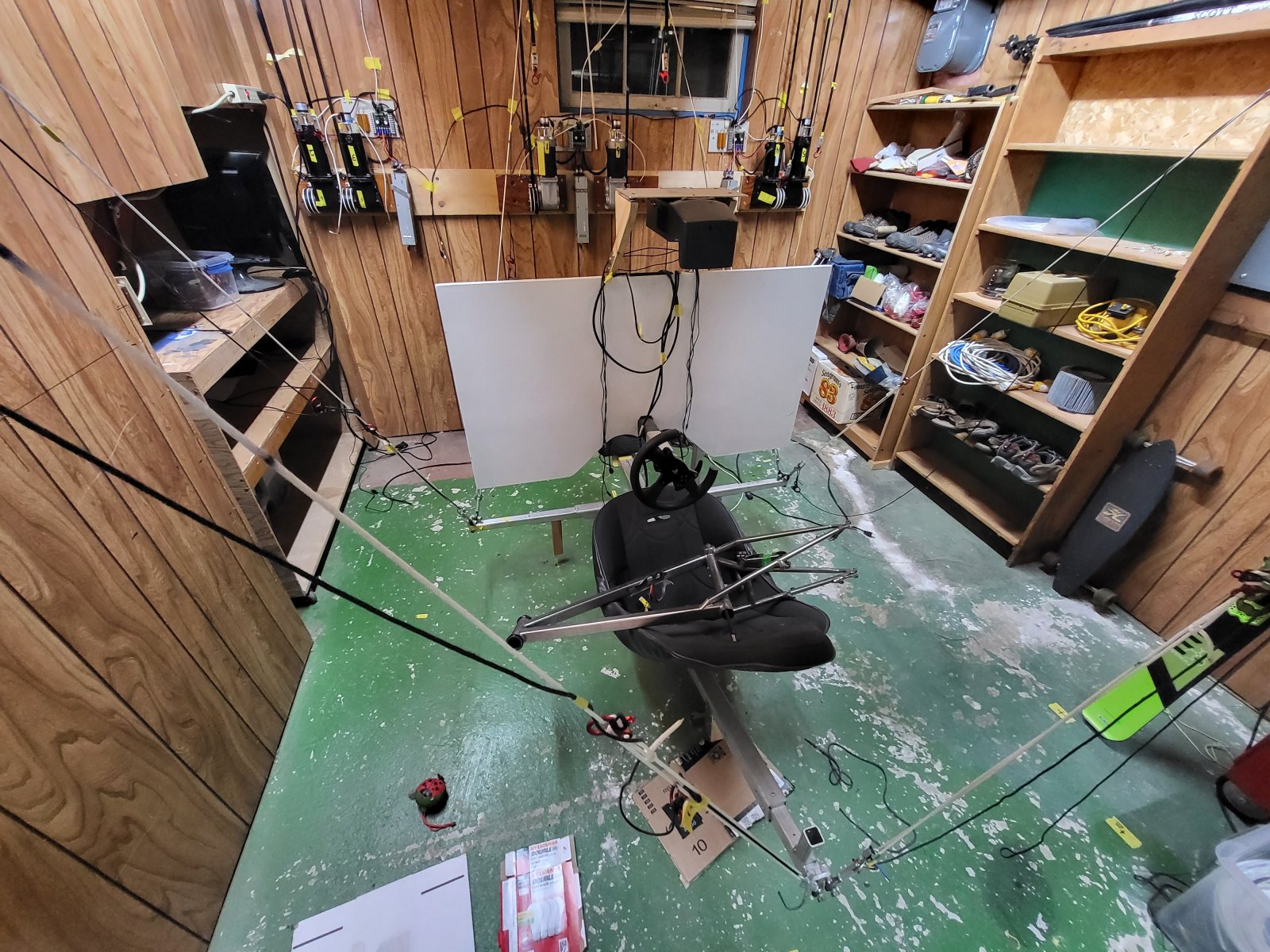

    Getting time to work on the Sim again! : ) Sorry about the mess.

    3DOF, AC motor
    I like this design, especially that the winches and motors are mounted next to each other to the wall and not at the ceiling. That makes it maintenance friendly.
    Are the gearboxes self-locking? If not I would be concerned about the seat dropping down in the case of a power failure. Maybe you could secure it with an auto-belay device like those used in climbing gyms. But they are really expensive.
