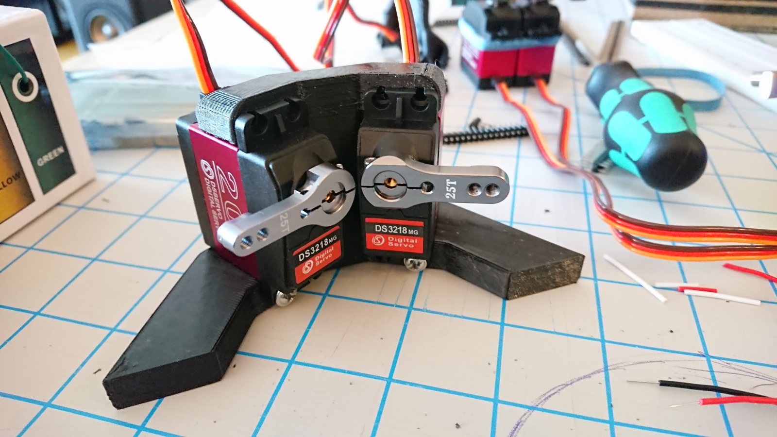

    I'm new to this scene in pretty much every way. I plan to get the commercial pilot's license for helicopter this year with the plan of continuing work in my current job during the off-season until I get my hours up to where the new job can sustain me financially. To stay sharp during the months when I'm not flying, I want to set up a solid sim rig with VR and a 6 DOF motion platform.
    I plan to go the DIY linear actuator route, inspired by FlyPT and others. And go as much DIY as possible in everything else as well. I have a background in electrical engineering which will hopefully help. But it's also good to know that there are plenty of commercially available controllers, etc available these days in case I get stuck.
    The timeline for the actual platform is far in the distance though, after I have my license, workstation, peripherals, VR headset, etc. set up, so bear with me.

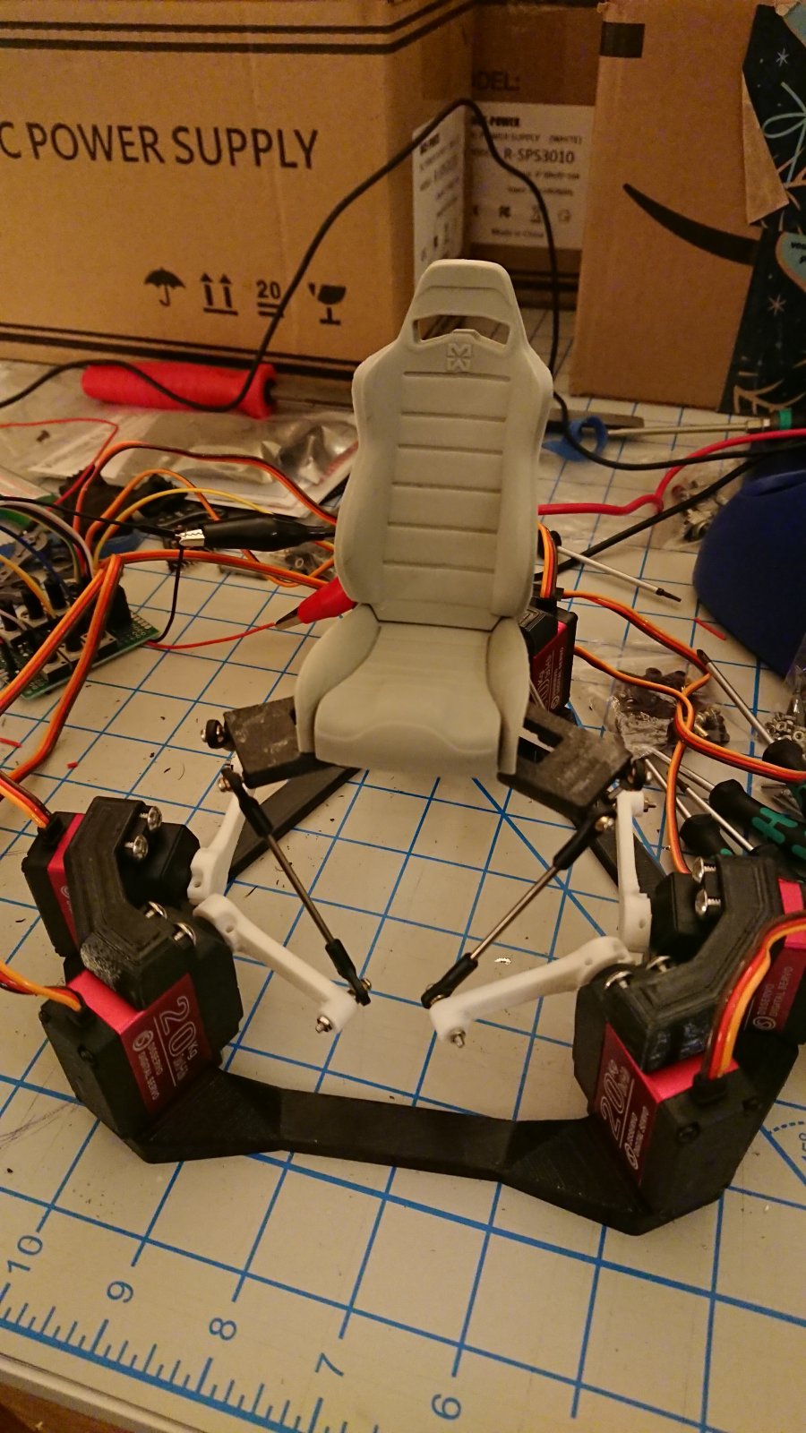

    I did have some time over the holidays though to build a 1:10 scale model with the structure built from 3D printed parts, and R/C servos in place of linear actuators with the whole thing controlled by an arduino. For now I'm just using 3 pots to manually control XYZ offset and Yaw/Pitch/Roll.
    Test print of a section of the servo base
    Finished 1:10 scale model with 3D printed servo arms
    I also built a functional virtual model first to verify the math and figure out the proportions:
    Here is the finished model in action:
    There are still some kinks to work out, especially with my very crude range limiting in Arduino, but I'm really encouraged by how it's looking so far.
