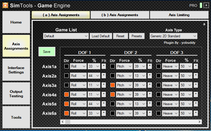

    Can you please post pictures of all of your settings, in particular your Interface Settings, Axis Assignments and Tuning Center settings.

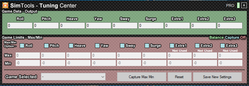

    Here are the pictures of the Interface Settings, Axis Assignments and Tuning Center settings. These screenshots where taken while the simulator was moving with no output.

    I am presuming you altered @eaorobbie's code to match the A B C D Interface output, so try changing the Output Rate to 10ms.

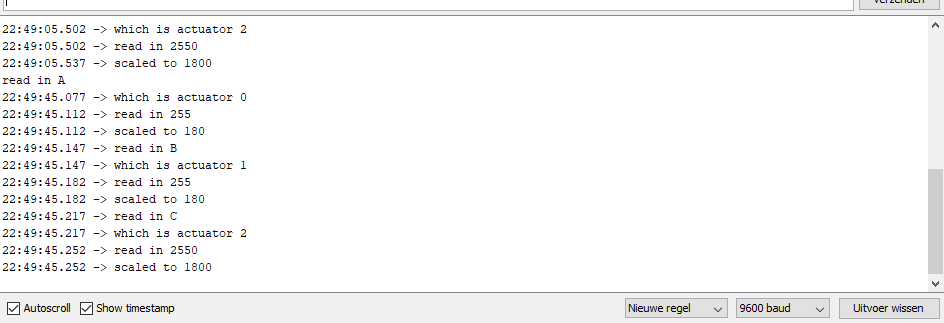

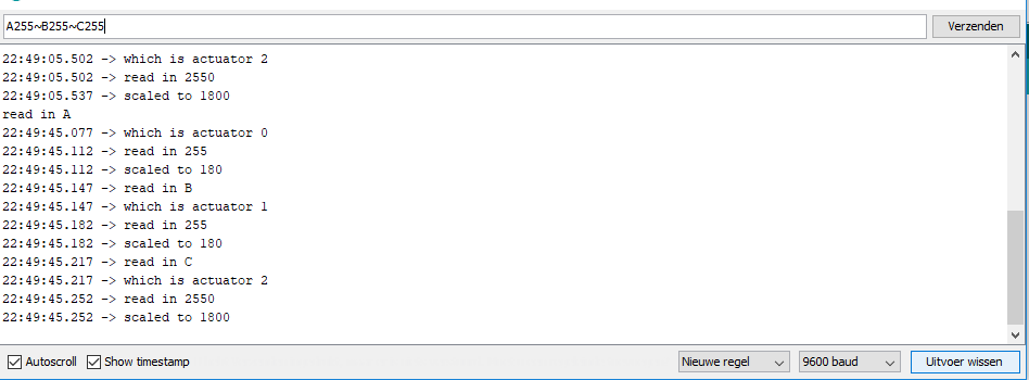

    I tried it out and yeah from the moment I connect 6 servo's it does this weird thing but what I noticed is this one, if I type in (manually) this first line in the first picture then it adds a 0 to the last servo's value... I think that this can be one of the problems...

    Itried a lot off things out and what I was wondering about was that is was really weird in my sketch for my Arduino, There was a line that I could not understand and I just deleted it and that solved the problem of the extra 0 that comes and goes. Something that I noticed while testing, the servo's that are moving so weird are not even getting a signal from the Arduino, I disconnected them and it still stays, someone knows what I have to do now? because I think when there is no PWM signal send to a servo it moves so weird just the same as it moves when I disconnect them. Please can someone help me?

    UPDATE!!
    I fixed it with deleting that one line, it said that if the value was under 0 or above 9 it can not do anything and that fixed everything, now it works. Next problem, the servo's move to little to really feal it in the small simulator so if anyone can explain how I can make it so it moves more then I would really appreceate that! Thanks alot!
