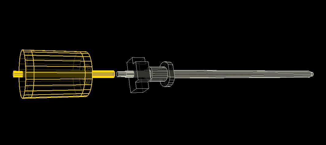

    I made a second mini linear actuator as this one below and I made a mini 2 dof (roll and pitch) plugged on LFS.
    6 DOF from scratch
    I'll try to make a better video next weekend.

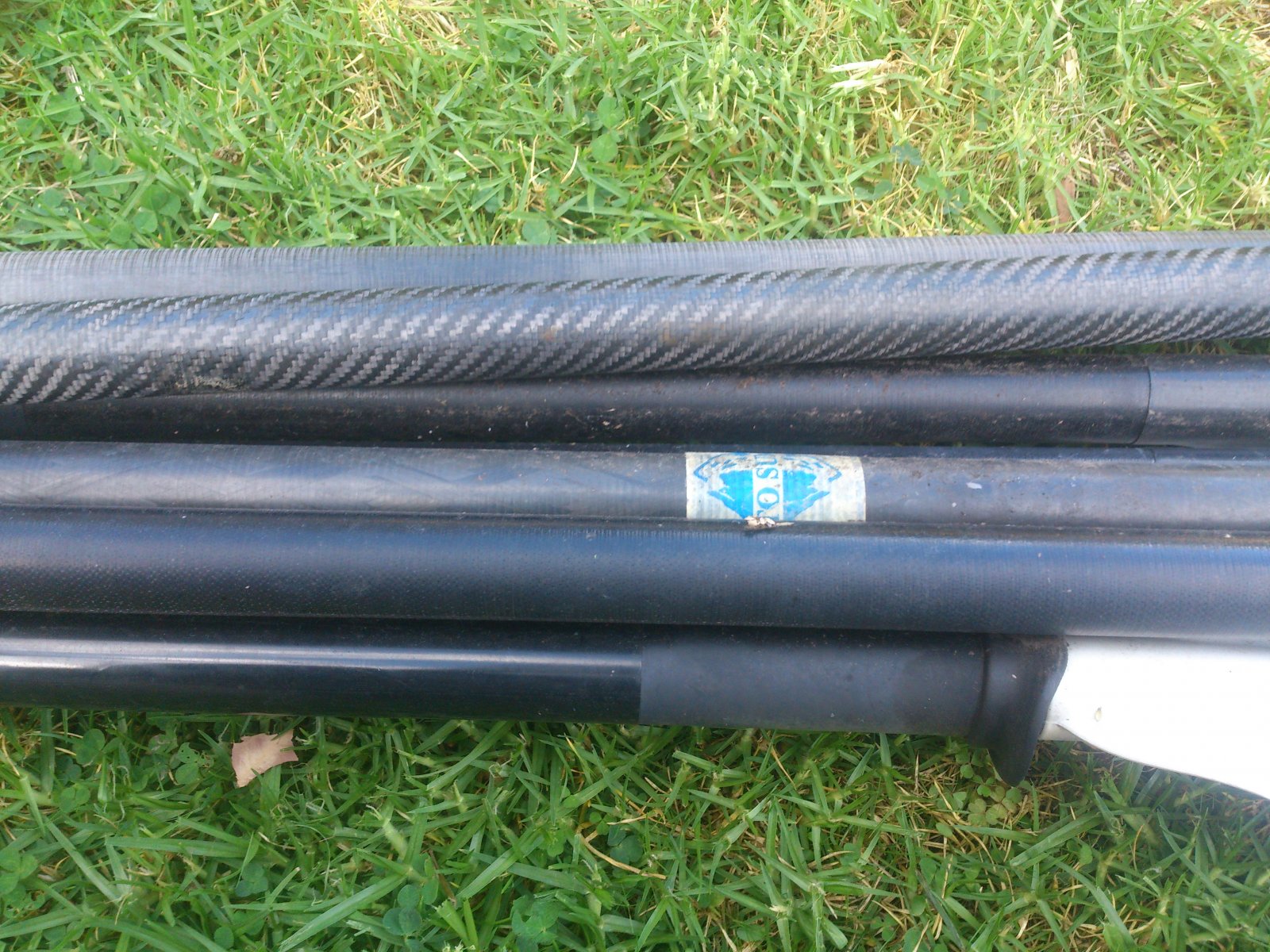

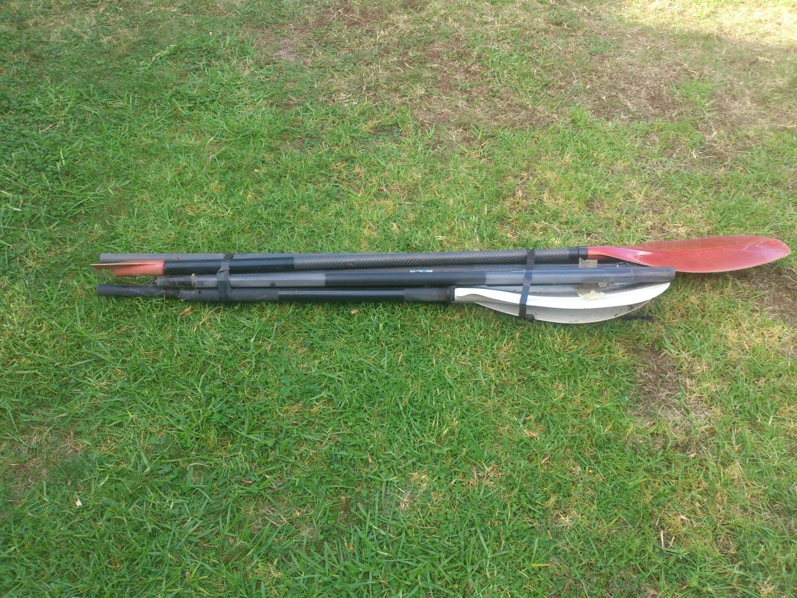

    I scored some lengths of 28x25 carbon fibre tubes from a neighbour who was a competitive kayaker .
    They use the tubes for the paddles, it isn't the tubes that breaks but the blades do.
    I believe that they mainly use "roll wrapped" cf tubes rather than "woven wrapped" cf tubes because of the strength.
    Maybe you can get the tubes locally at a sports/kayak store or even from kayaker.
