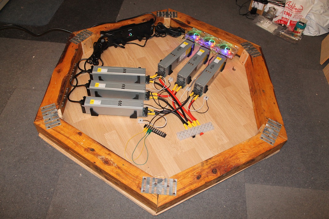

    The power supply is set up. I used a bar of screw connector for the end connection. I had to modify the soldered connector at the end of my wires so they fit in. I should have use the connector as is and use a battery pole like connection to connect them all together. I can't believe I did not think about that before. I will have to change that. But all power supply works and I get my 24 V. I also have 12 V wires out of each PSU in case I need power (like the fans). Already messed up my wire's color convention and inverted black and white wires. :rolleyes:
    I'm missing 2 pins connectors for the back of the PSU and this is why there is extra wires, for now.
    Also, there was a little mess up in my relay order (not the right base) and i'll get them a bit later.

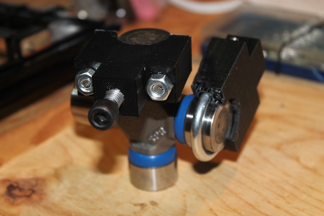

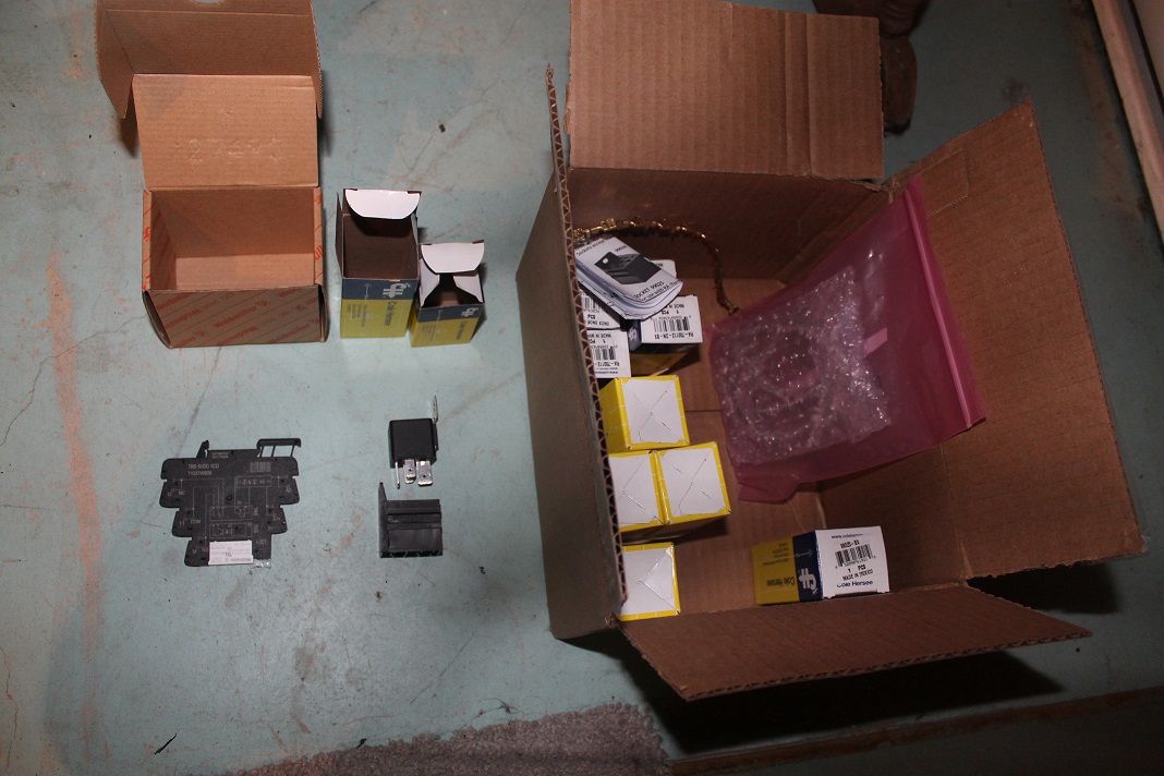

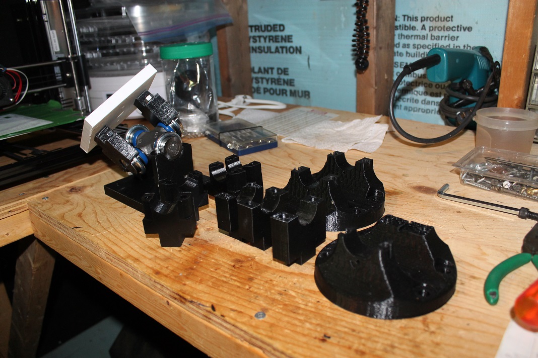

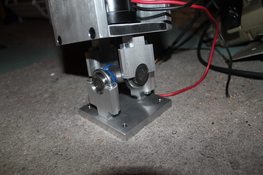

    I have received my relays. Did not do anything yet with them. I'm occupied to finish the U-Joint design for now. Because I have seek advises to my mechanic friend and he told me what to design. Then, I will provide him my drawings so he can do them in aluminium. I must say that the 5v relay does not look like anything I have used before.
    So, I am printing u-joint prototypes of the designs I do. It helps me visualise the result, see the multiple errors I do, and gives me new ideas. After many tries, I think I have something. Since they are going to be done in aluminium, I could reduce their size and complexity. They are quite simple now, and they give a wide range of movement. Another mocup piece is printing as you can see. If you wander why their is a white piece, it is because I run out of black plastic.
    This is how I expect to attach it all. My mechanical friend will review it all and probably change everything, but, I like to think that I am getting a bit better at it.

    Nive work,
    Are you sure the printed part on the bottom of the actuator will hold the complete weight of the sim + the surge weight from the acceleration ?
  6. bruce stephen
    Jun 7, 2015
    1,286
    general contractor
    michigan
    9,115Coins
    +1,243 / 9 / -0
    hes having them machined from aluminum.
  7. Pierre Lalancette
    Dec 11, 2016
    1,012
    Tech Artist
    Quebec, Canada
    8,052Coins
    +947 / 6 / -0
    3DOF, DC motor, Arduino, 6DOF
    Just inserting screws in the holes for holding them assemble cracked the plastic all the way. No plastic will hold that stress. Like Bruce pointed, they will be machined from aluminium.

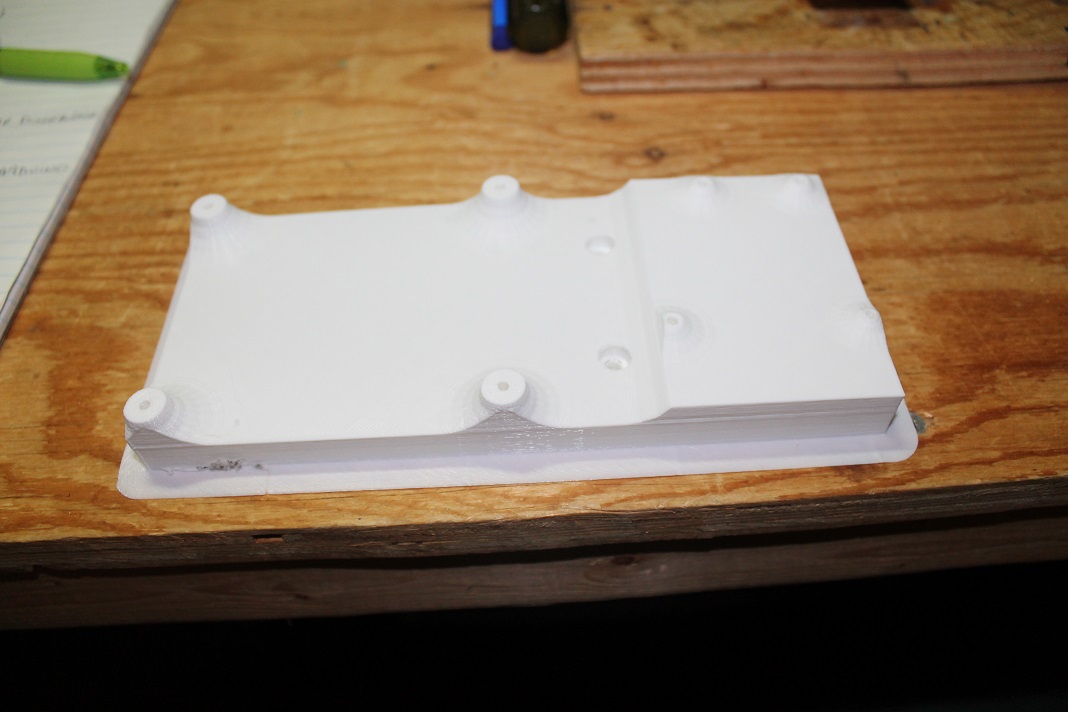

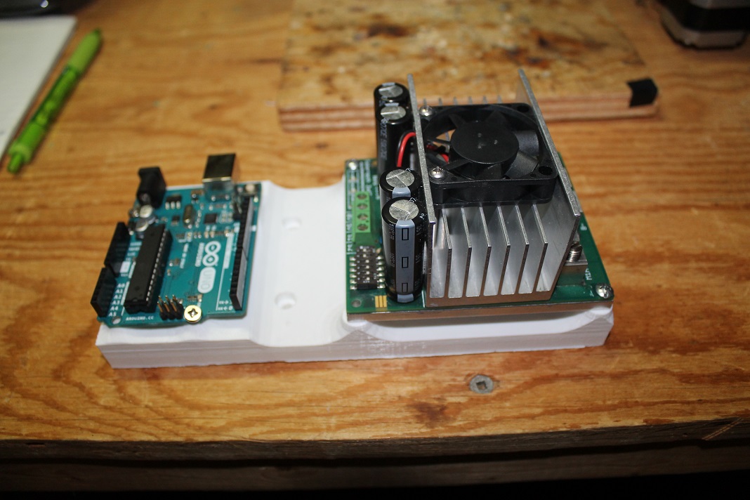

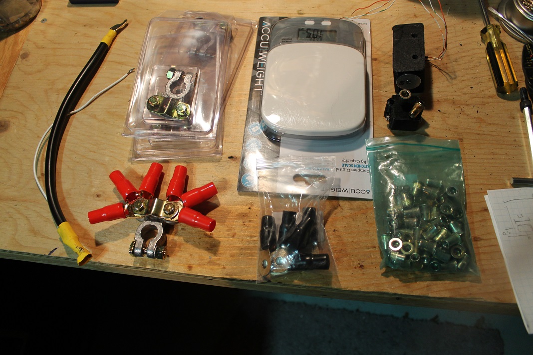

    I bought a small balance for mesuring the glue. I ordered new insert, as my others one were modified to fit inside my carbon tubes. I will use them in printing part for the potentiometer gears. I bought connectors for the batteries, that I do not have yet, because batteries are expensive. I also bought connectors for the wire, but they were too big. I had to exchange them. I also got a break in the soldering of my PSU, damn. Soldering those big wire are quite a challenge. The end connectors needs to be change to fit with the batteries. Soldering wires is in my future.

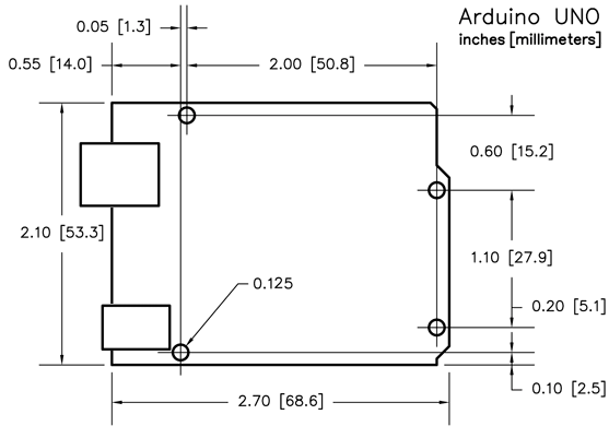

    I made a support for the arduino and the saberthoot. I tried to mesure and fit the arduino holes, but it proved to be better to use an official arduino blueprint measurements.
    Air can circulate underneath and cool it down.

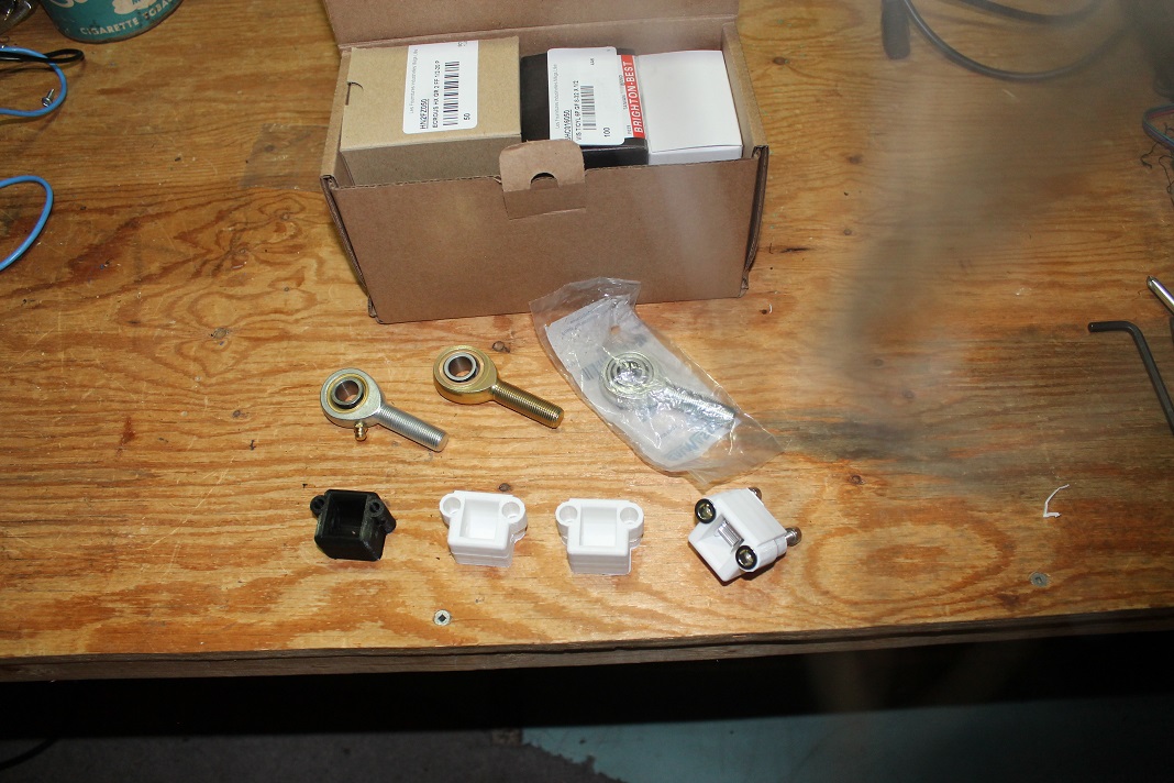

    Did a few things.
    I bought all screws I need to build the actuators. Still waiting for the machined parts.
    I bought two other helm joints to compare. They don't have the grease plug. So I am asking this question:
    "Is it worthy to have the grease plug in the helm joint?"

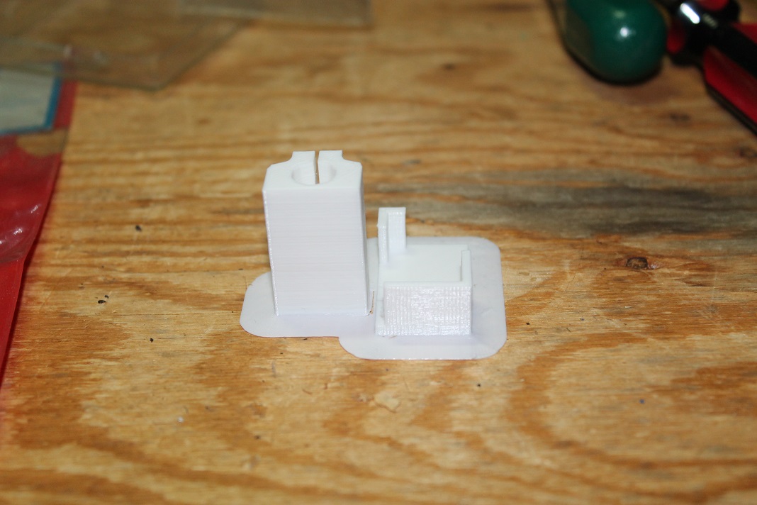

    And last but not least, I thing I finally finish my first working design. It is the top part of the potentiometer strap. As you can see, it passed through some iterations.

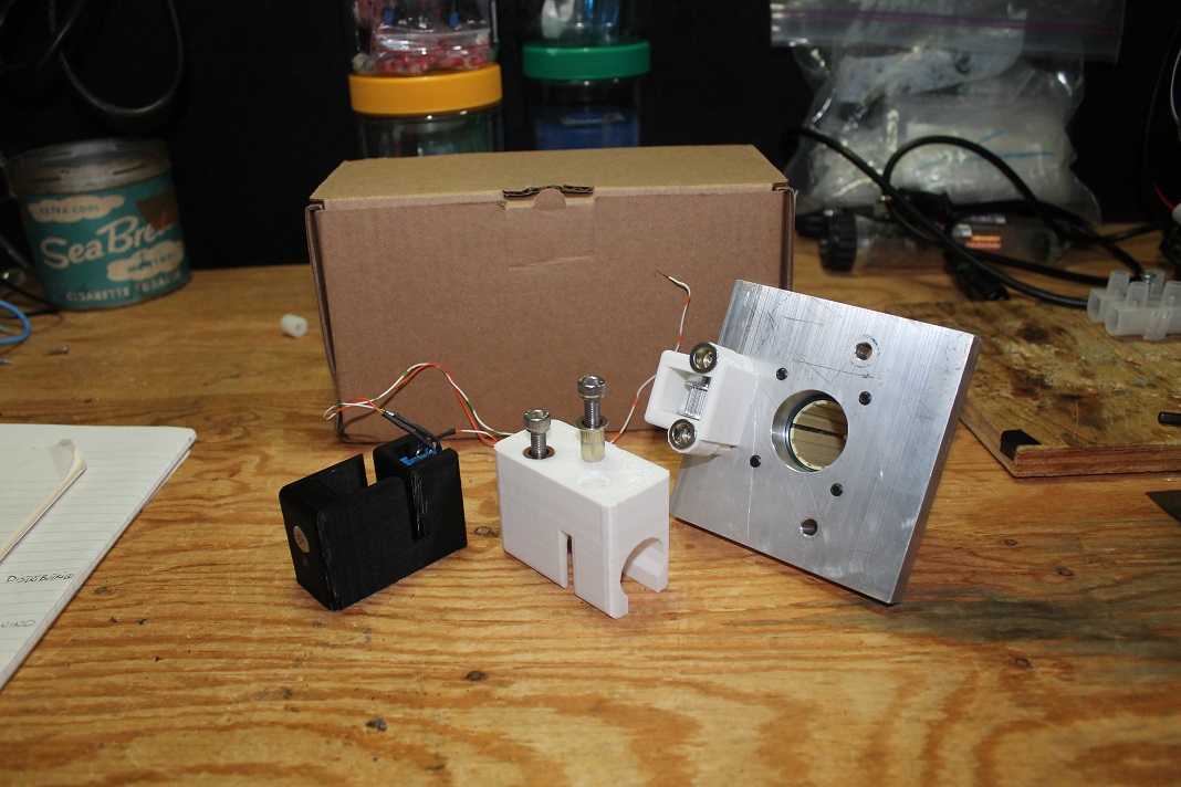

    Small update while waiting for my mechanical parts. I have changed the potentiometer support to be able to incorporate insert (black: old, white: new). I will stick them in and they will hold the bottom part strongly. Also, here's the top part in place.

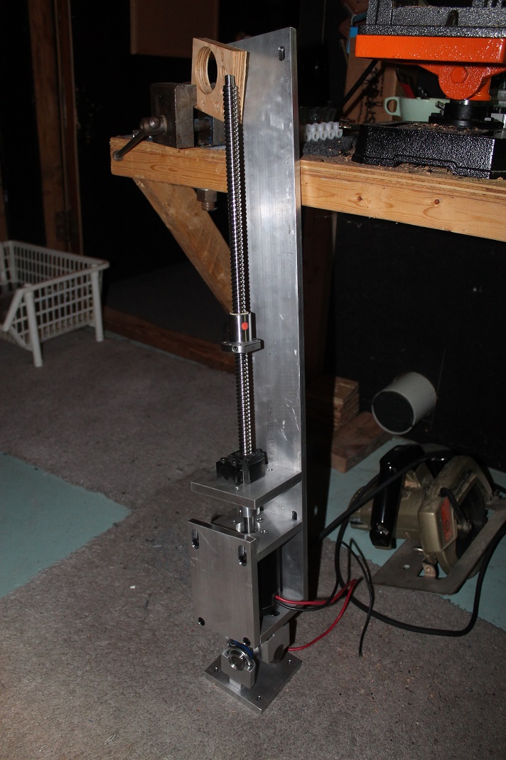

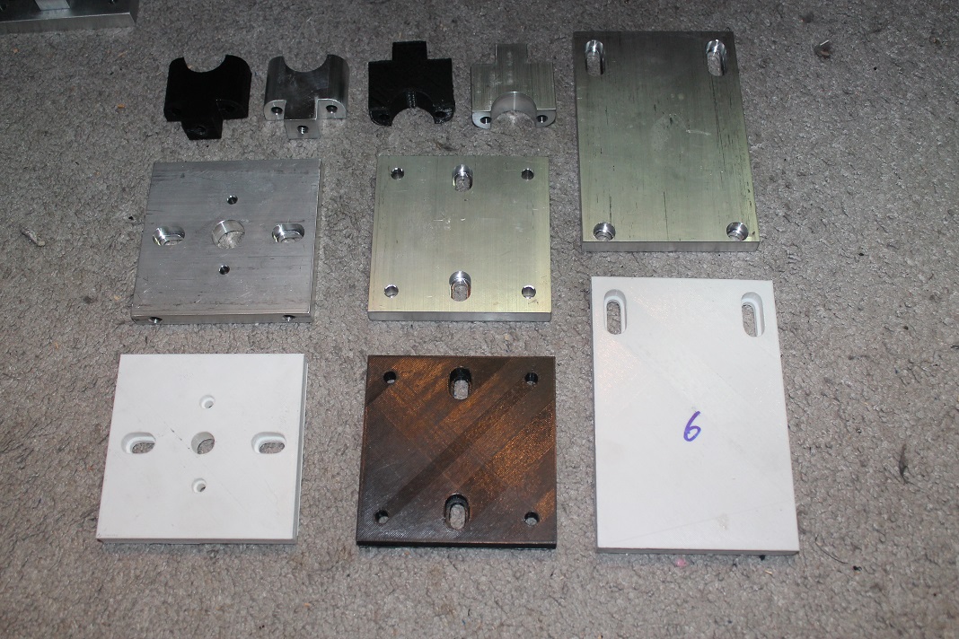

    I have received my parts! My friend told me that only the small part didn't translate well to his digital drill. He had to rework it. Another 400$ CAD invested into the rig. :rolleyes:
    My friend assembled one to show me the result. They are great! He told me it could support up to 800 pounds.

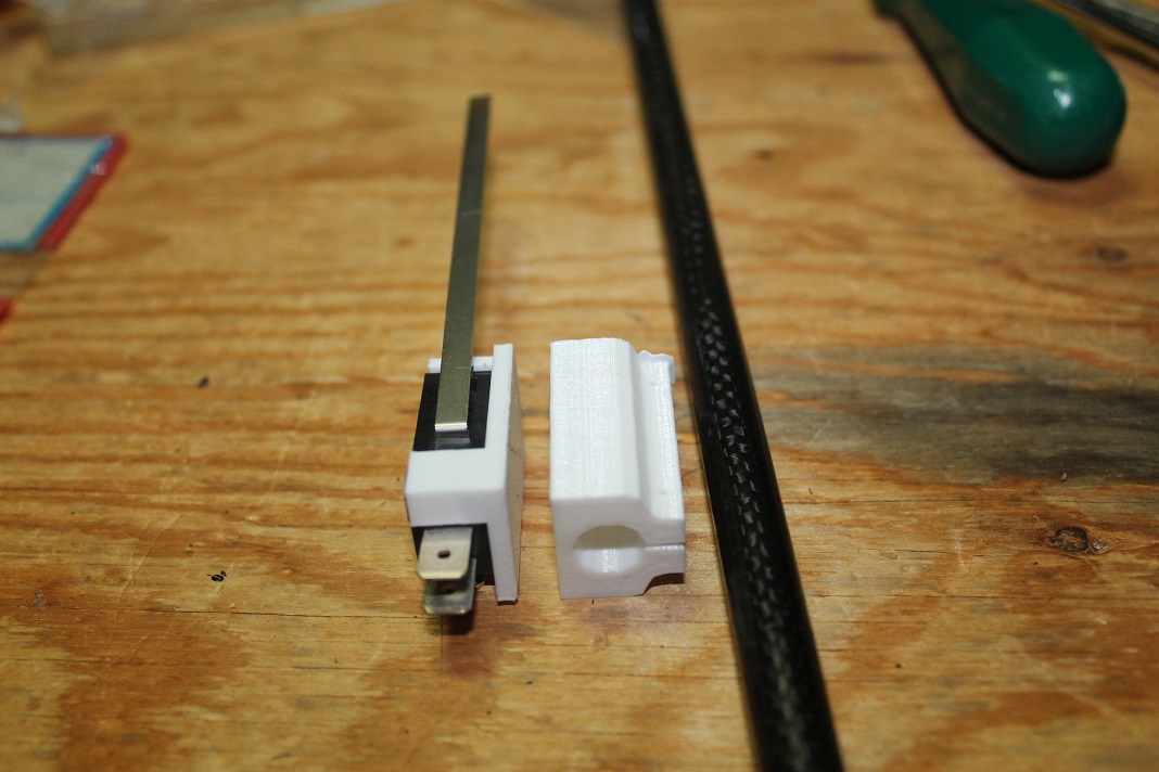

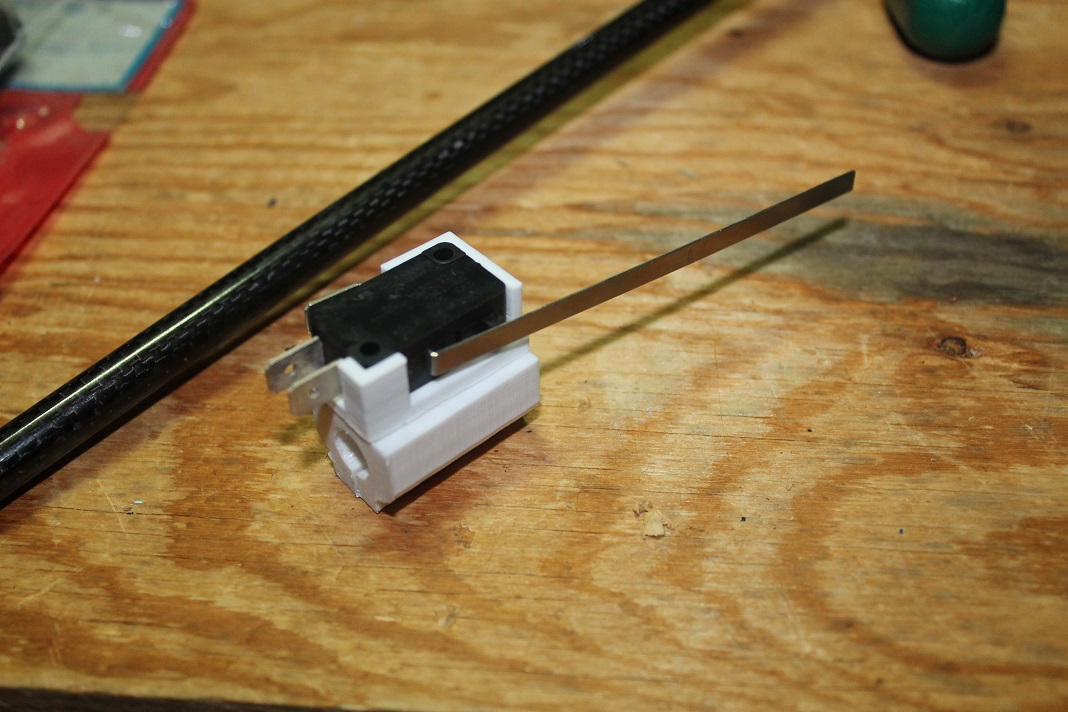

    Also, I started to work on the design for the limit switch holders.
    I designed the holding part way to small for my carbon tubes, but the switch fit perfectly. It only miss small holding holes.
    Once the holding part redesign, they will be glue together to make the final part.

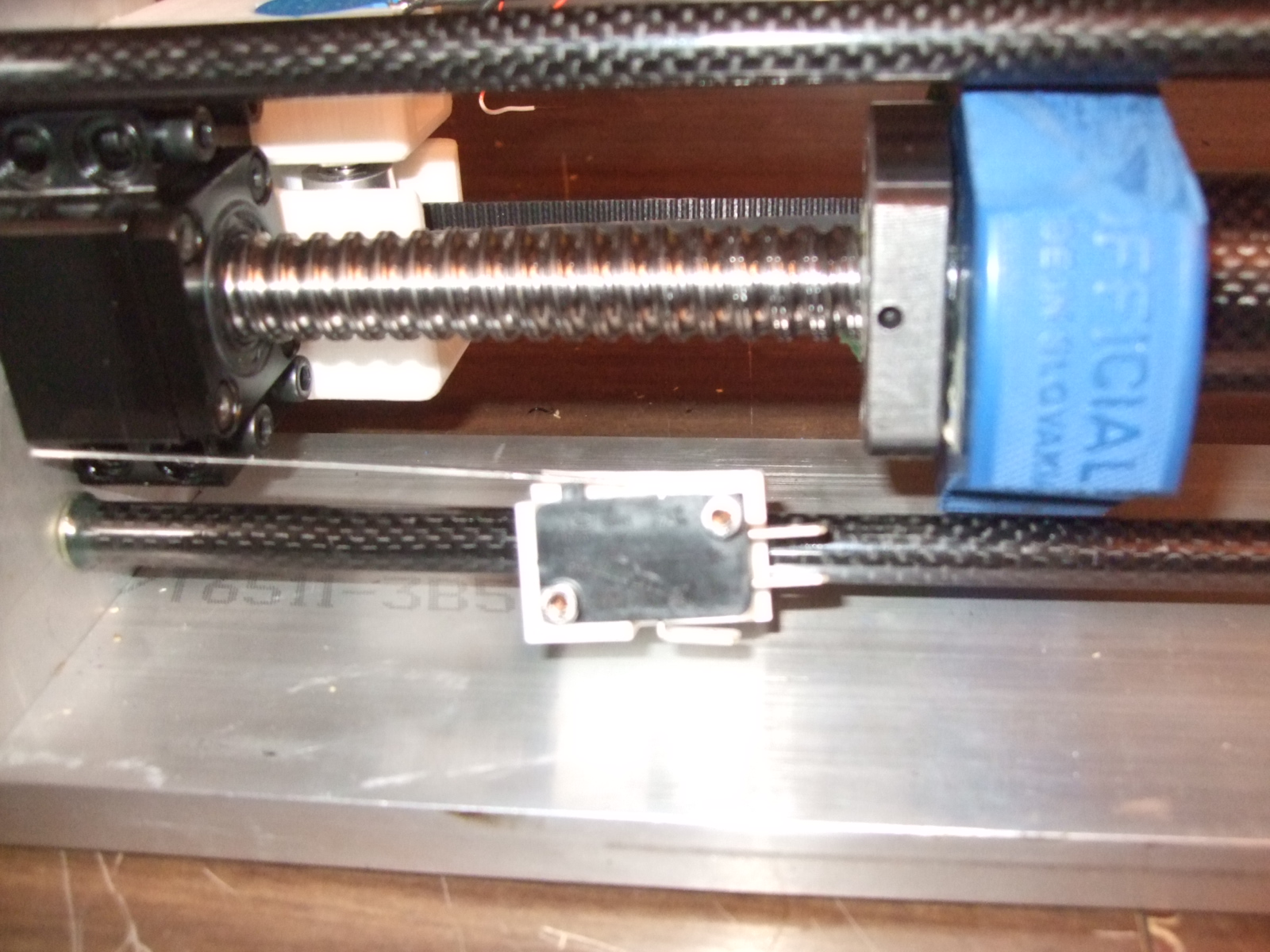

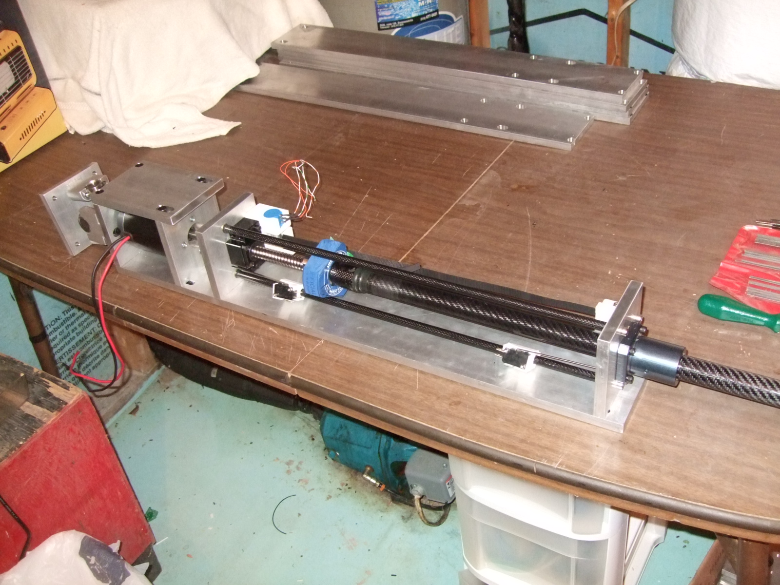

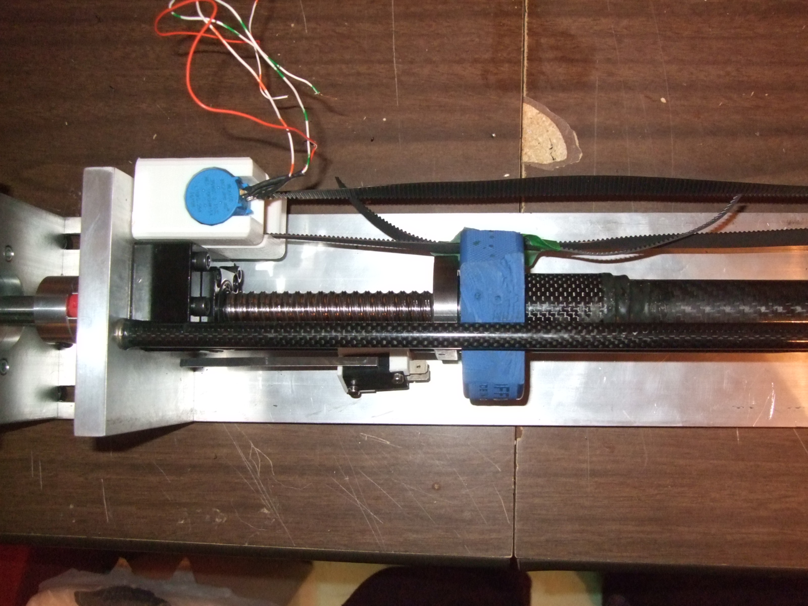

    Trying to put everyting together for one actuator.
    I found that the limit switch's support design is buggy. The carrier will not trigger the limit switch, but it will destroy the limit switch support that stand in its way. The limit switch support needs to be rethink and redesign... Again.
    Now, how do I attach the strap to the carrier? I don't think the masking tape I use in this setup will hold. :)
  14. llluis
    Mar 30, 2017
    164
    Quebec
    1,632Coins
    +103 / 1 / -0
    I believe you'll have to replace the puck by a 3D printed part.

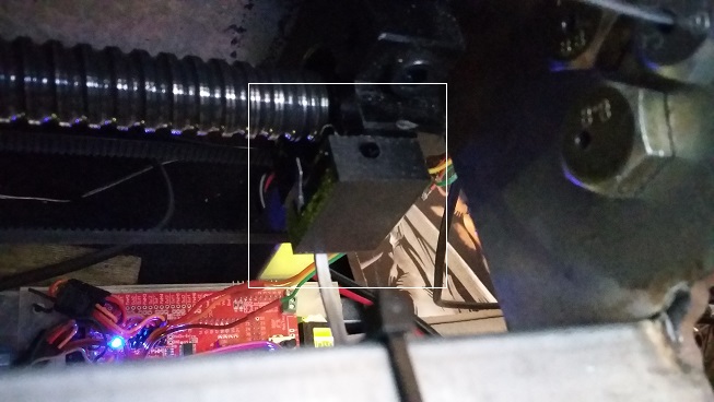

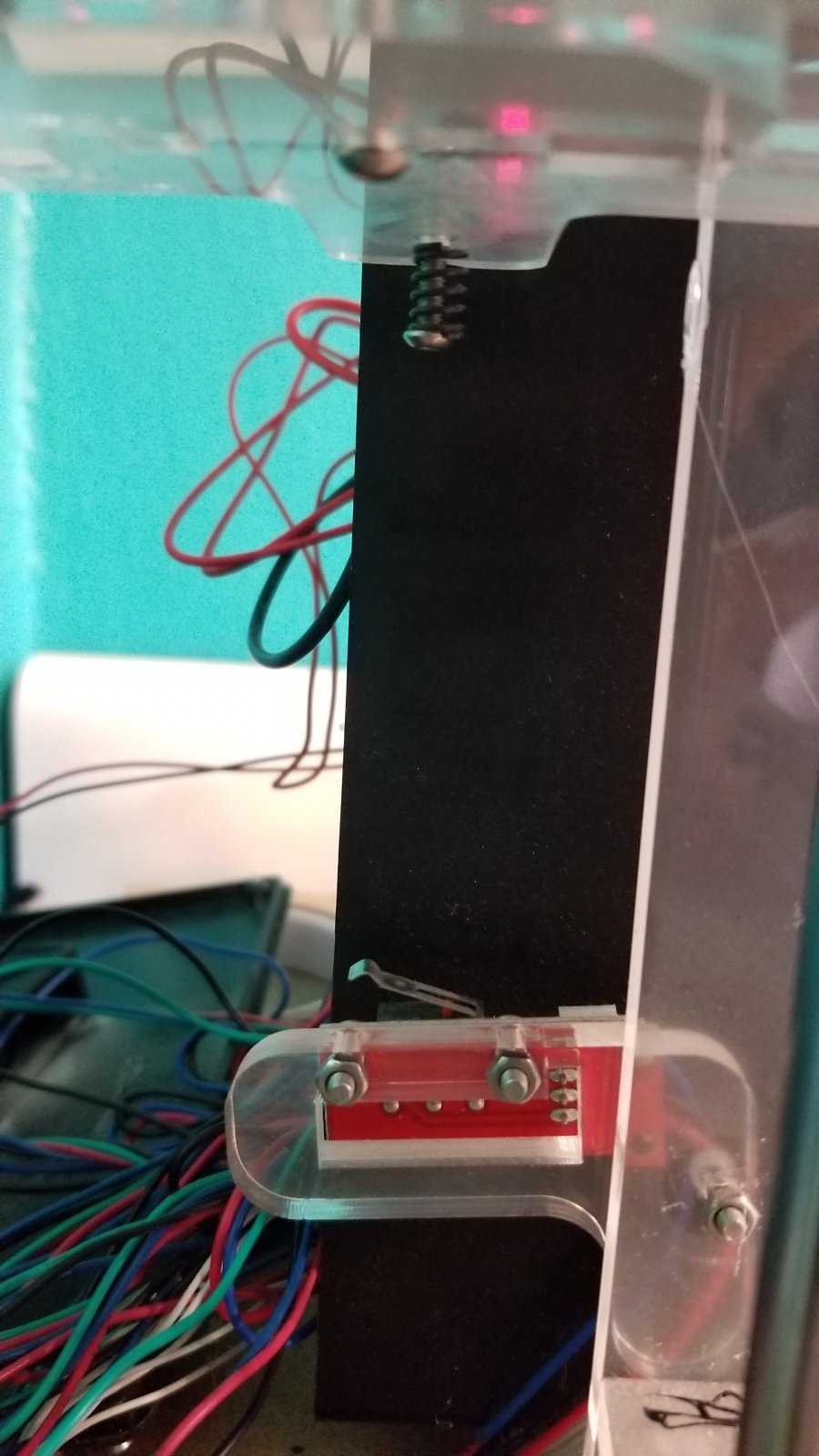

  15. SeatTime
    2,572

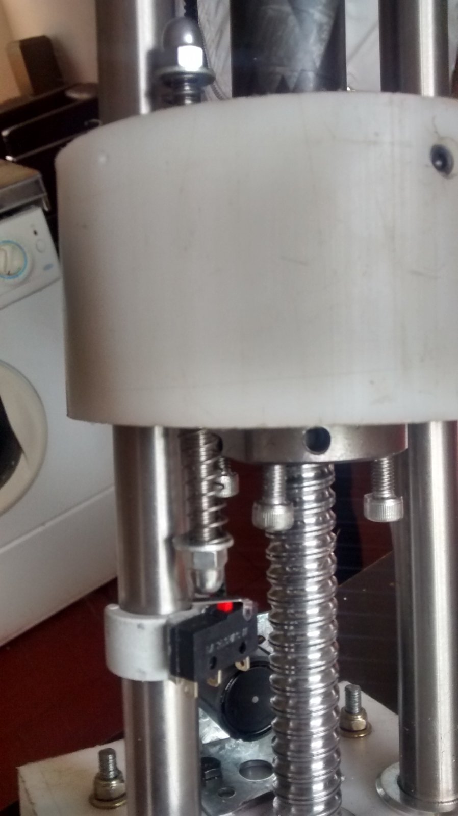

    For the limit, I have mine at the very end of the screw (so that the carrier never can touch them) with a small rubber bump stop under the screw to absorb the initial impact when required. This also ensures that the carrier does not drive through/past the limit (possible if it was driving down with gravity) and engage the motors again :eek:. Never had an issue with mine. Obviously it will initially hit with decent force before the motors cut when something fails - but your actuator should be strong enough to handle that. I also have momentary override buttons in the cabin to re-engage each actuator if necessary, so I do not have to manually wind them off the limit. Oh - you really need to move on from that hockey puck... :D. FI I normally only have an issue with the limits being reached while I'm setting up a new game profile.
  16. Pierre Lalancette
    Dec 11, 2016
    1,012
    Tech Artist
    Quebec, Canada
    8,052Coins
    +947 / 6 / -0
    Thanks for all the info SeatTime. Put the switch at the end... Hum. Makes me think a lot.
    As for the puck, I really like them. Okay, they are hard to cut, and the end result is ugly. But, they are strong as hell, and they can manage a failure of high amplitude. I am thinking about to add a printed part over it, to manage the switches, the linear v-wheels and the strap with precision. For the rest, I let the puck take care of the heavy lifting.
  17. SeatTime
    2,572
    This is how mine are basically setup - Eg. On my G-system - I use a 3D printed carrier to hold the limit switch and wiring. I don't even use a rubber bumper on these ones, as there is little gravity or inertia involved in this case. Like to use all the ballscrew that I have paid for :).
  18. bruce stephen
    Jun 7, 2015
    1,286
    general contractor
    michigan
    9,115Coins
    +1,243 / 9 / -0
    you could just set it up like a 3d printer zstop, so that when it hits the stop it just moves the screw and compresses the spring.

    As you can see in my pictures, my potentiometer setup is taking a lot of space. Maybe I can redo it to be more compact and incorporate the limit switch into it.
    Design, print, fail, design, print, fail...
    Thanks for all the input. I don't know how you manage to put so many things in such small places.
