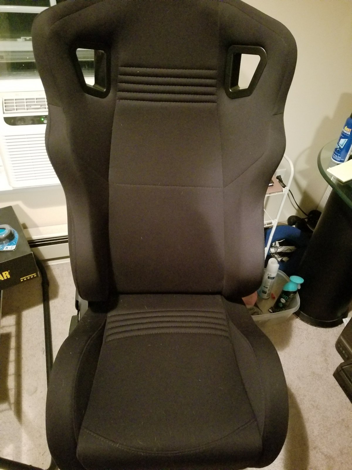

    6. Racing Seat (Ebay) (108.99 free shipping)
    https://www.ebay.com/itm/UNIVERSAL-WOVEN-FRABIC-HIGH-HEAD-REST-BLACK-PERFORMANCE-RACING-SEAT-PASSENGER/153152337153?ssPageName=STRK:MEBIDX:IT&_trksid=p2060353.m2749.l2649

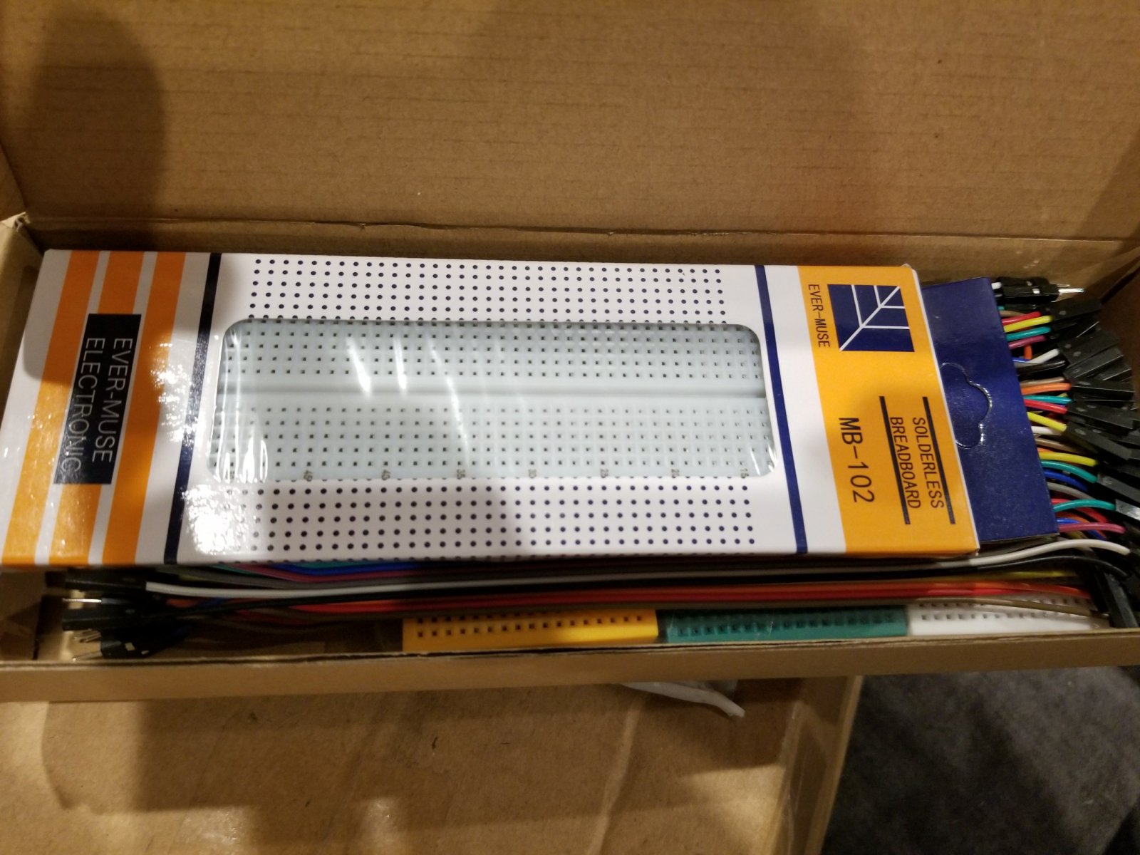

    7. Bread boards with Male/Female wiring ($14.22 free shipping)
    https://www.ebay.com/itm/Haiworld-breadboard-Jumper-Wire-KIT-For-Arduino-Raspberry-PI-And-Electronic/332612417236?ssPageName=STRK:MEBIDX:IT&_trksid=p2060353.m2749.l2649

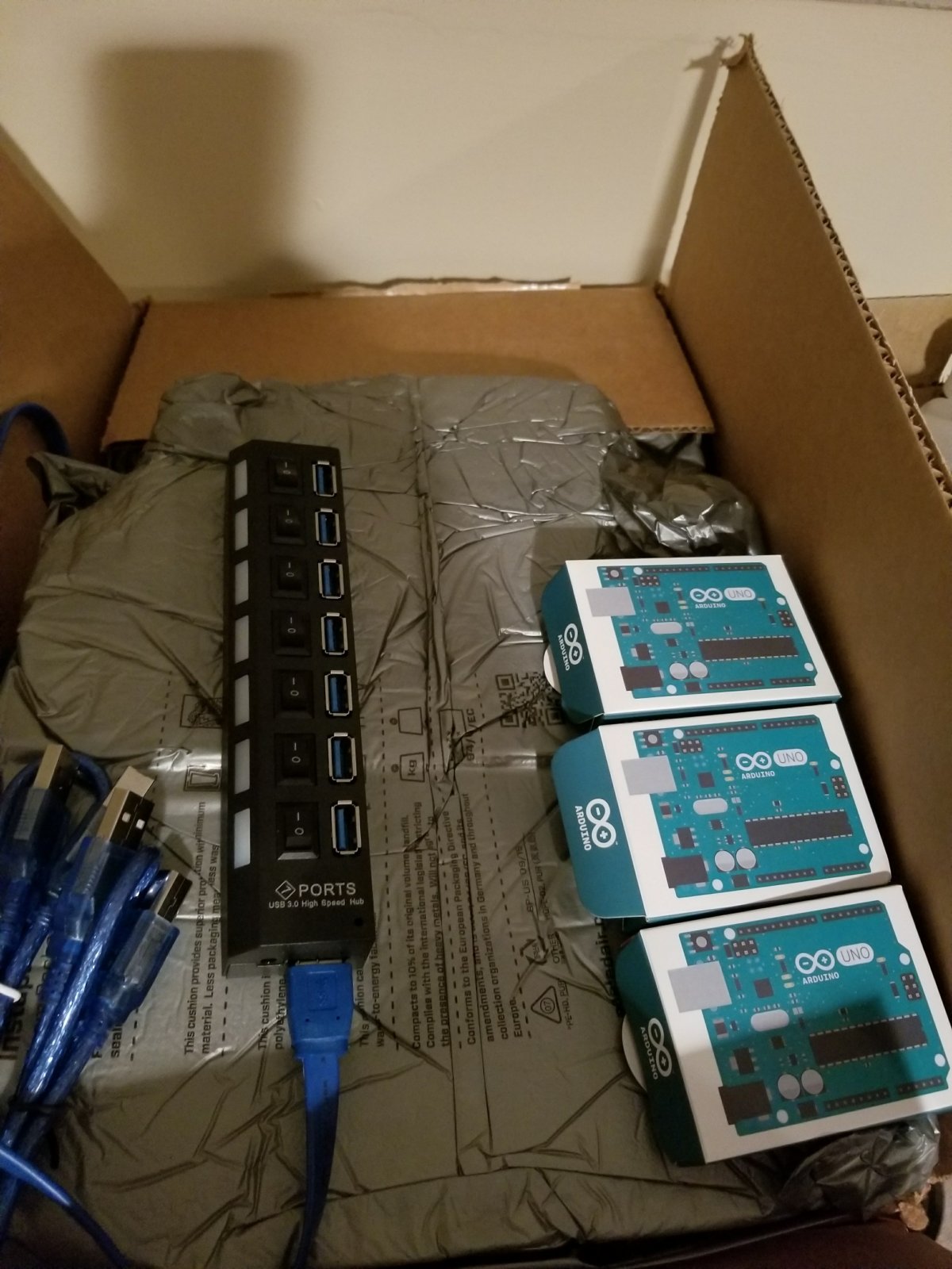

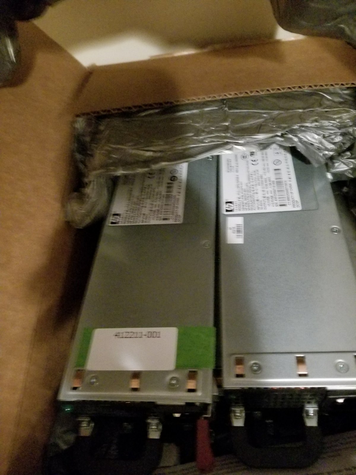

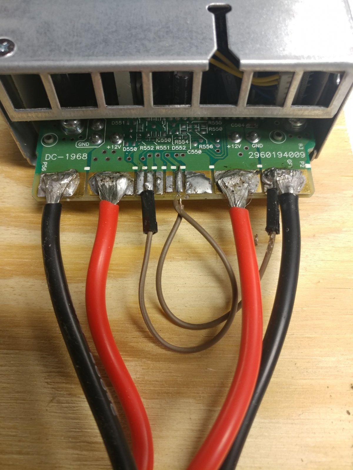

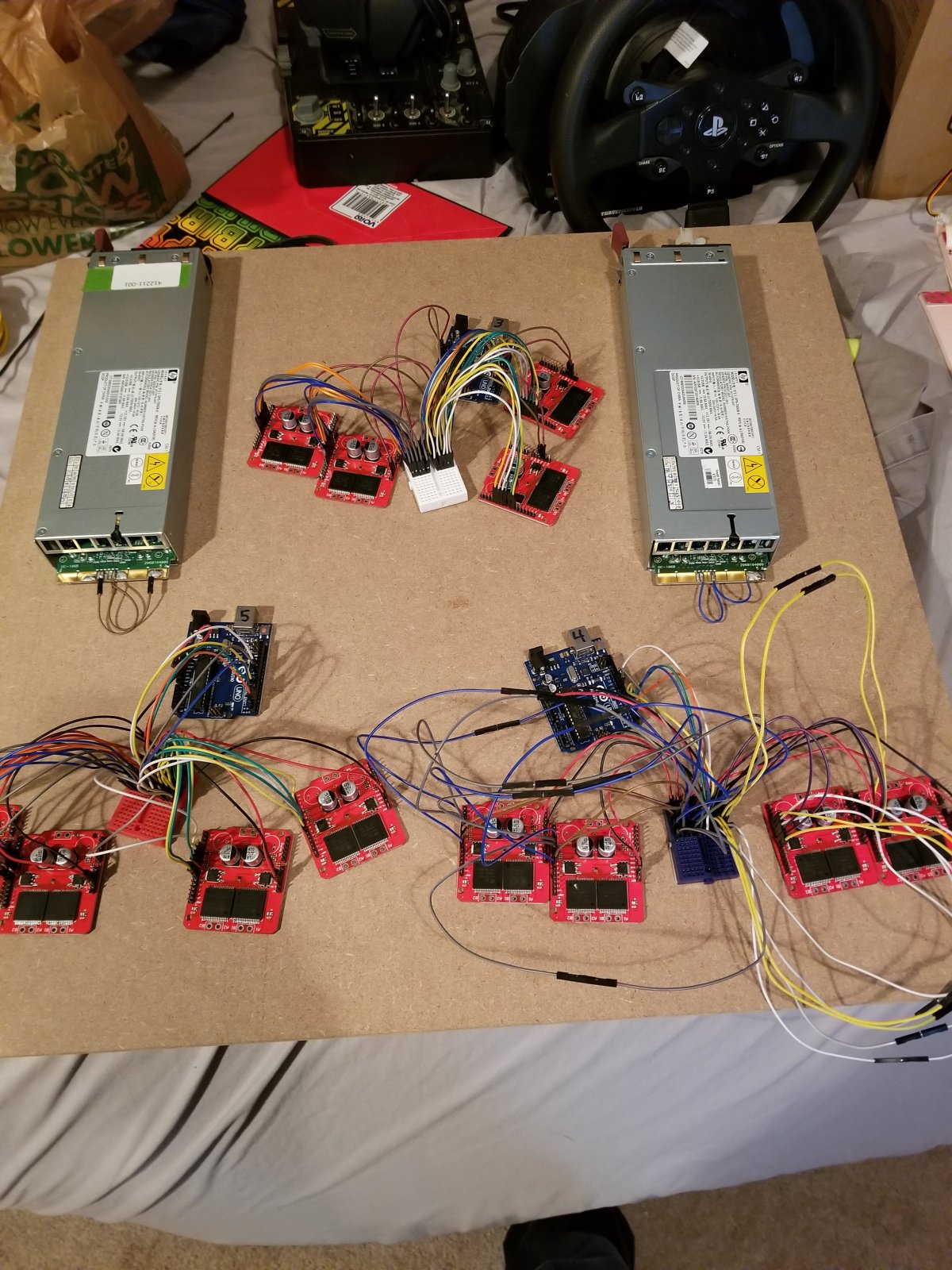

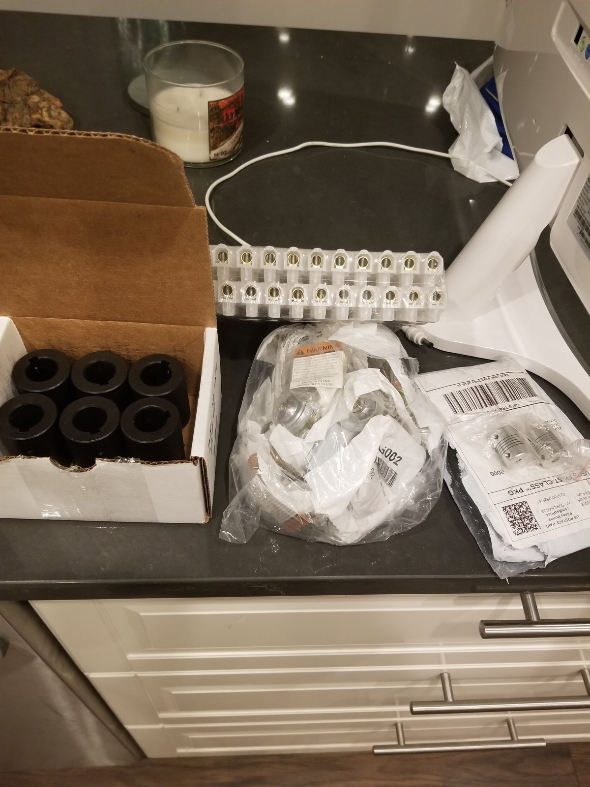

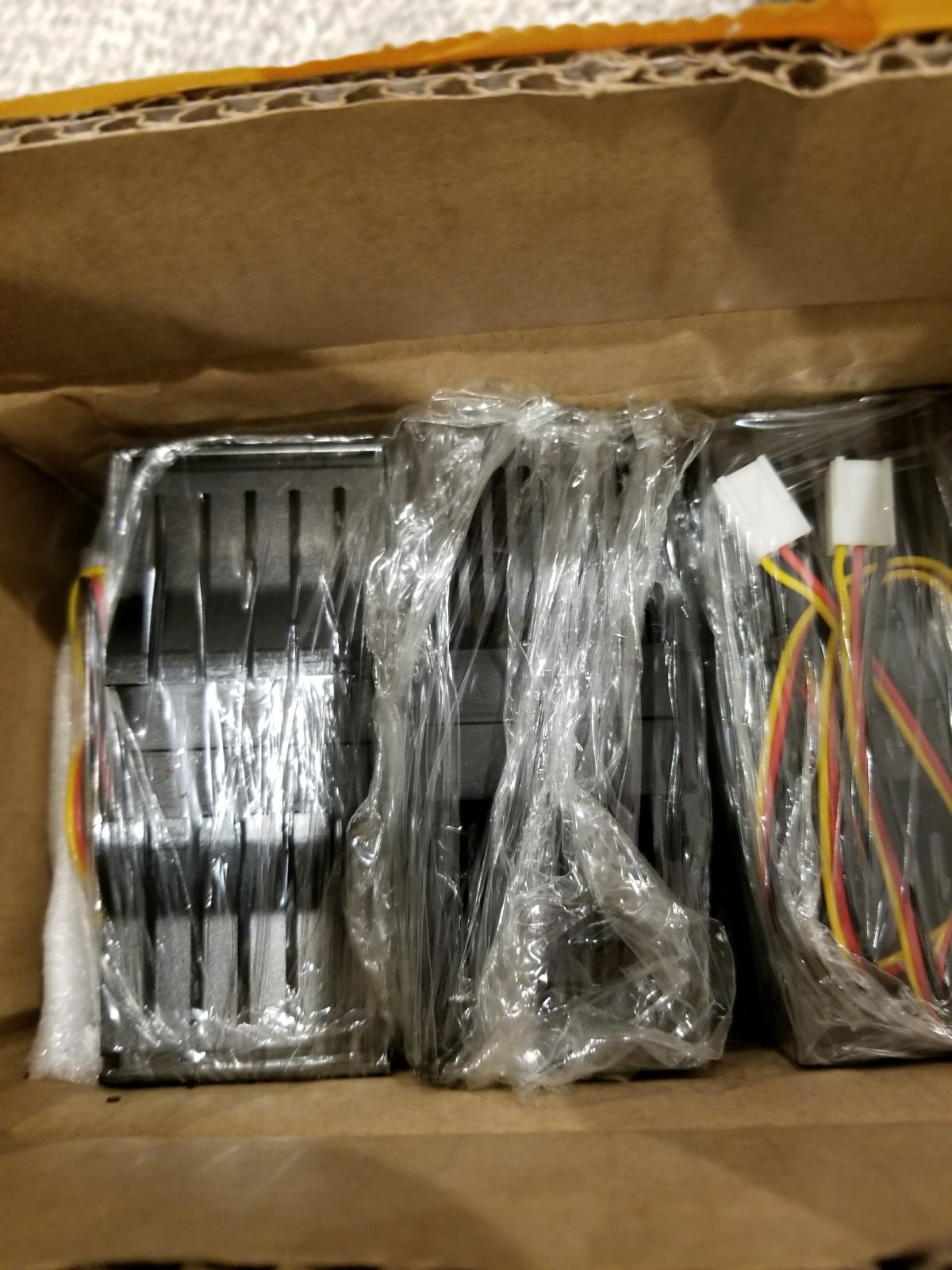

    Began wiring and received some goodies in!!!

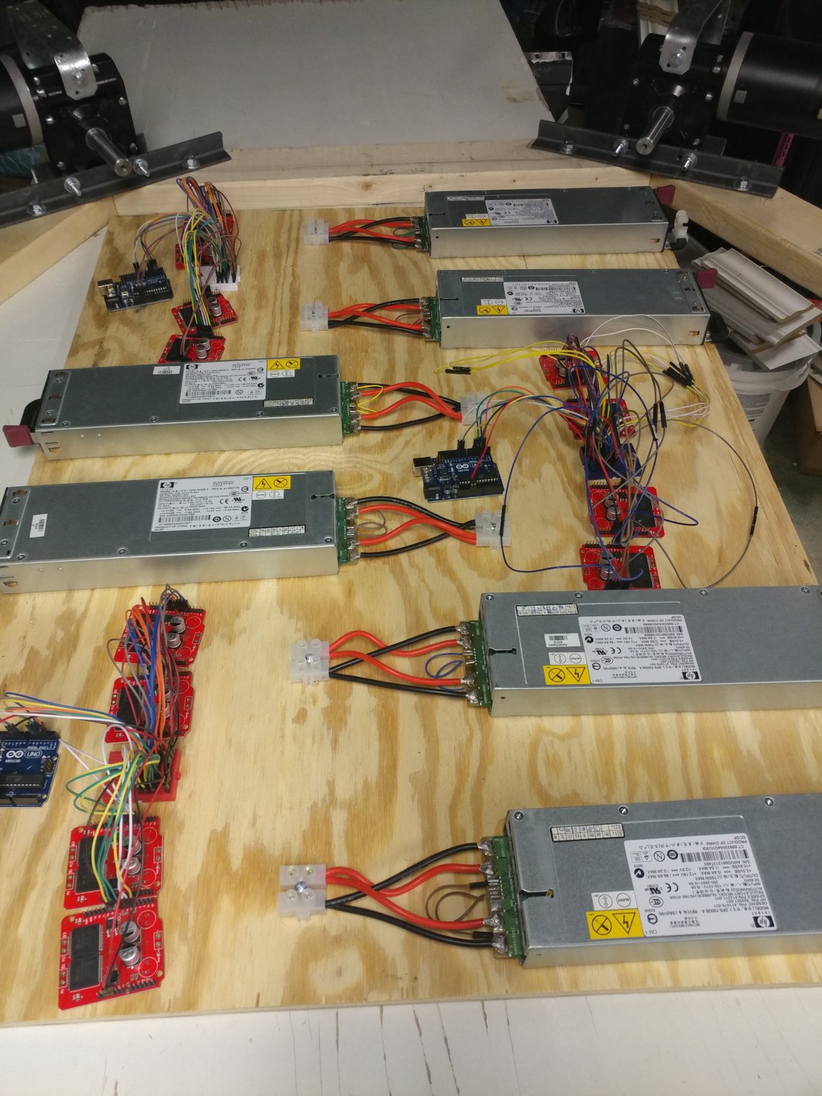

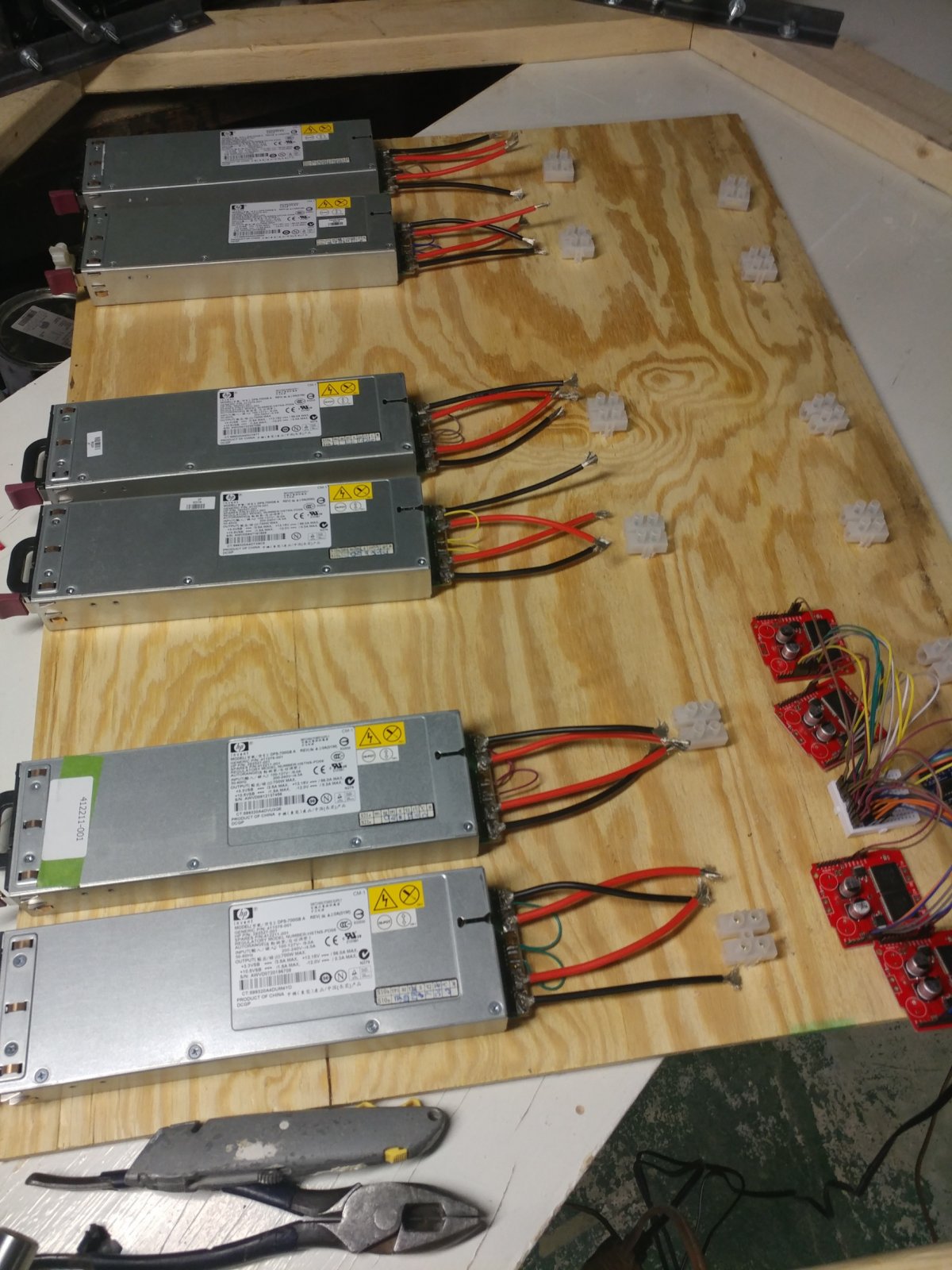

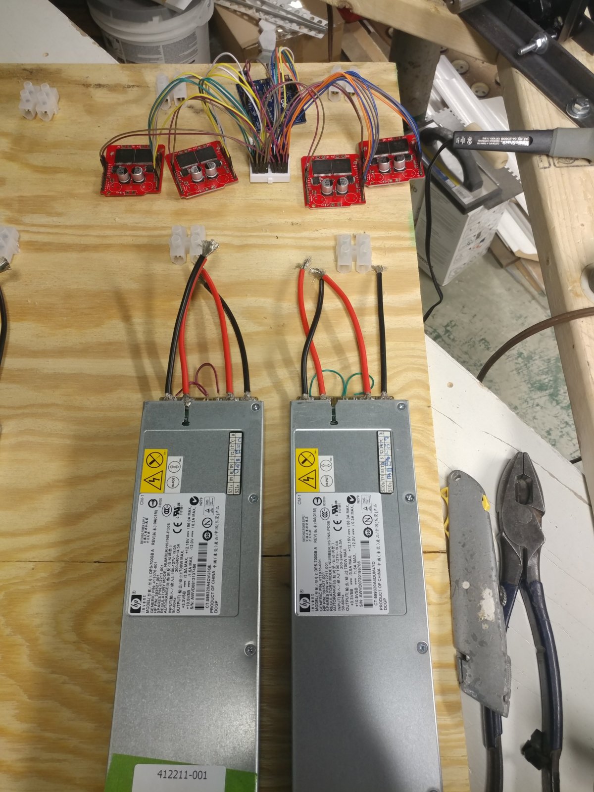

    Got quite a lot done in the past few weeks! Need to finish wiring the pots, motors, and build the upper half and were ready to roll!!!

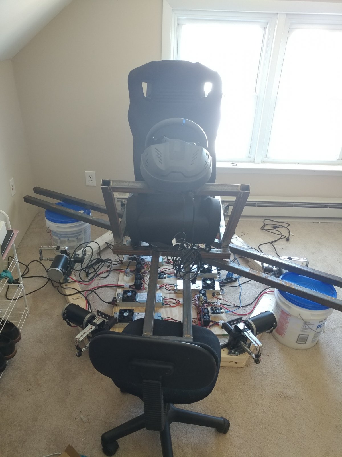

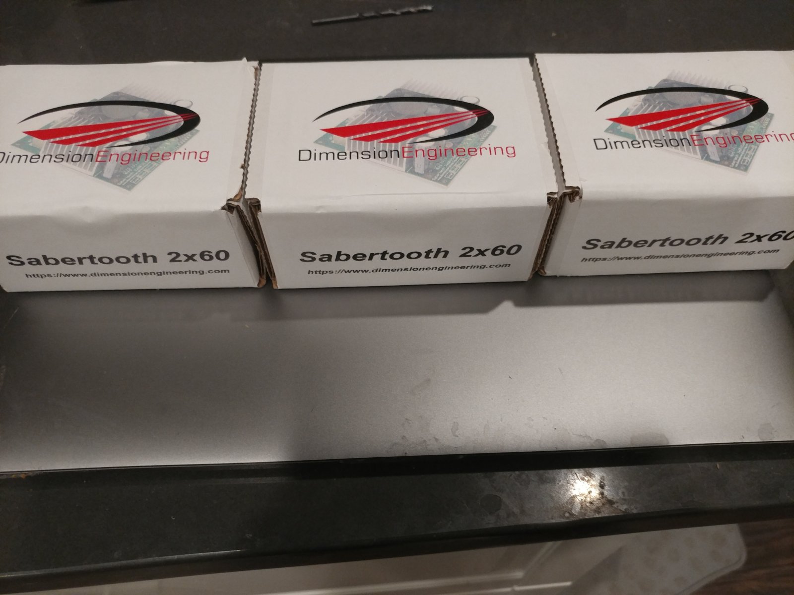

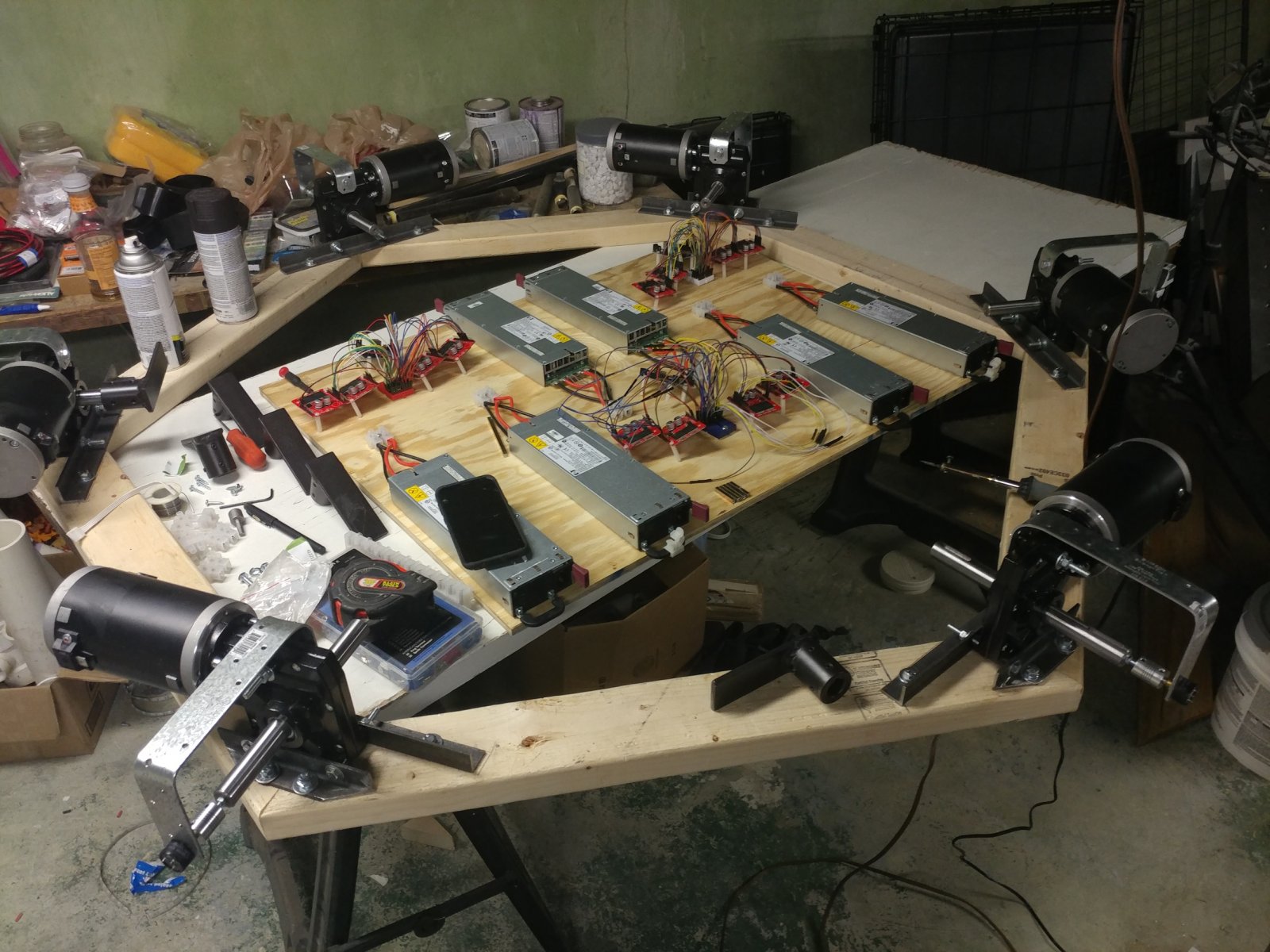

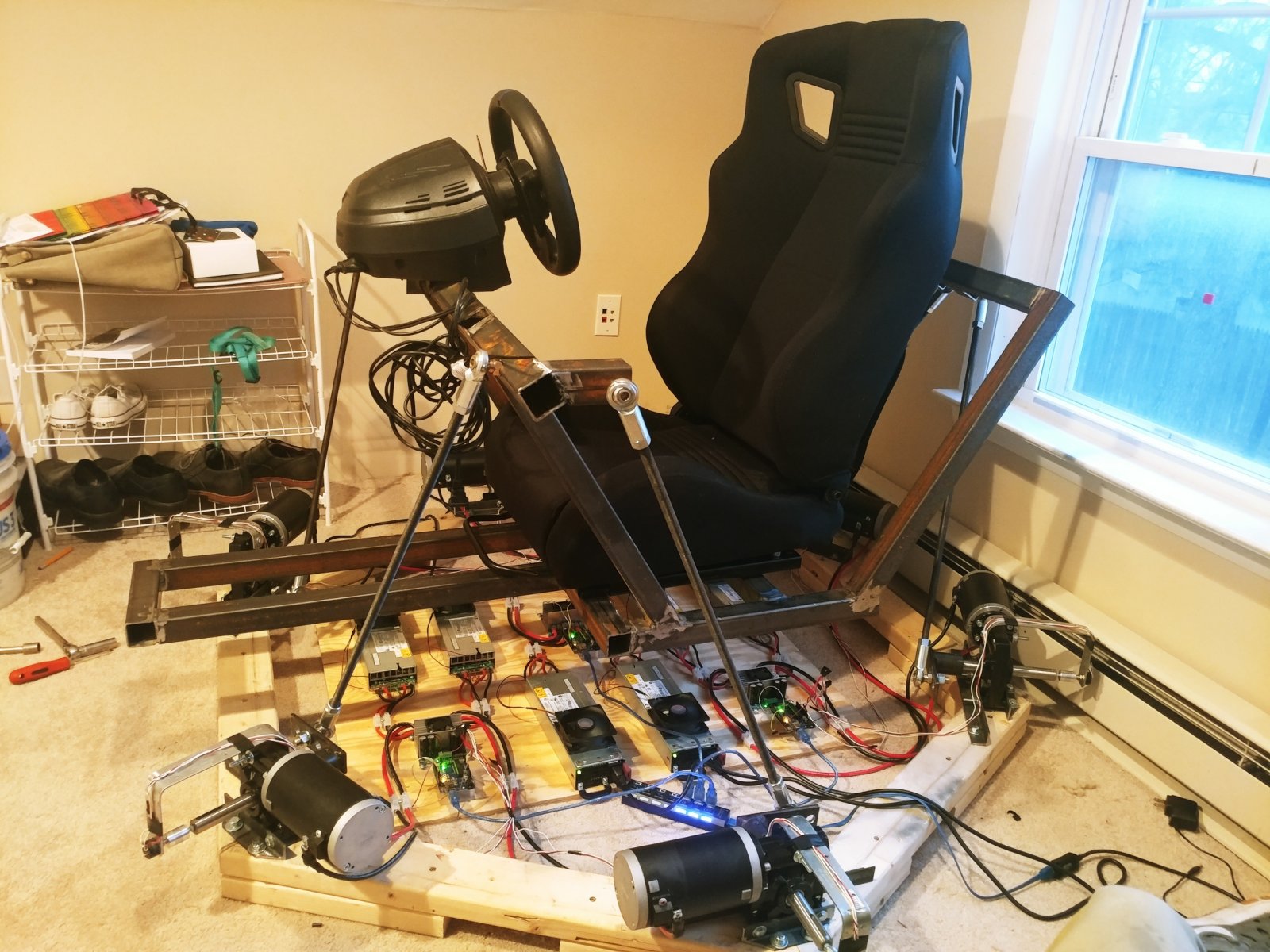

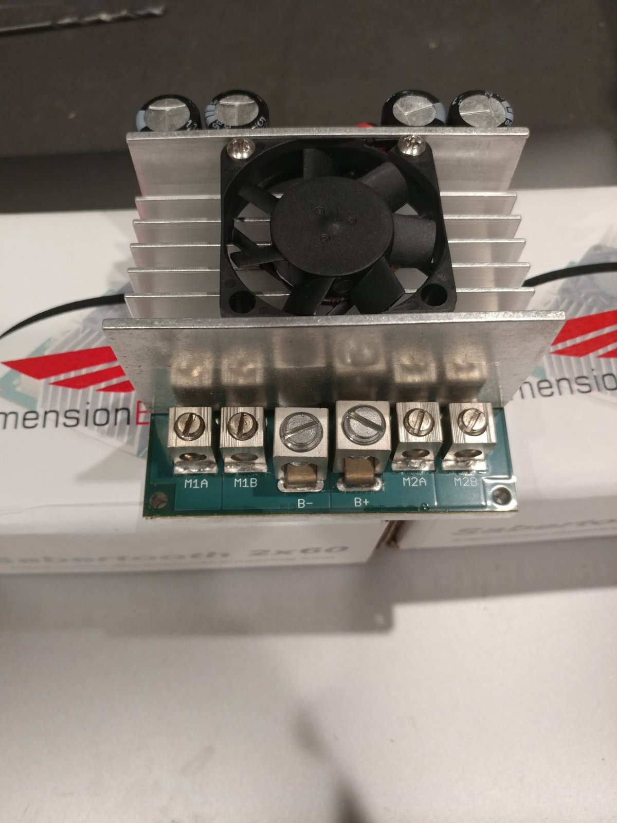

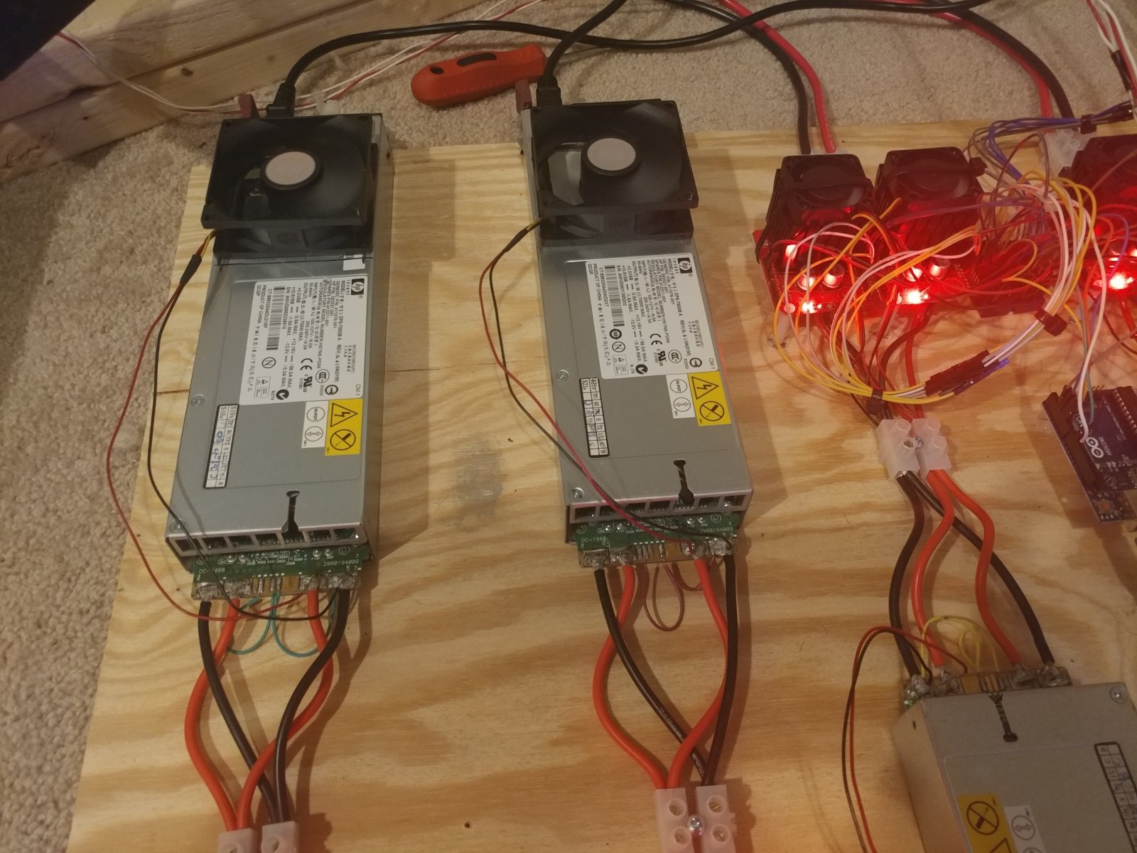

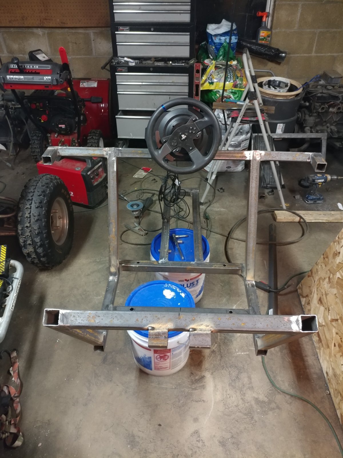

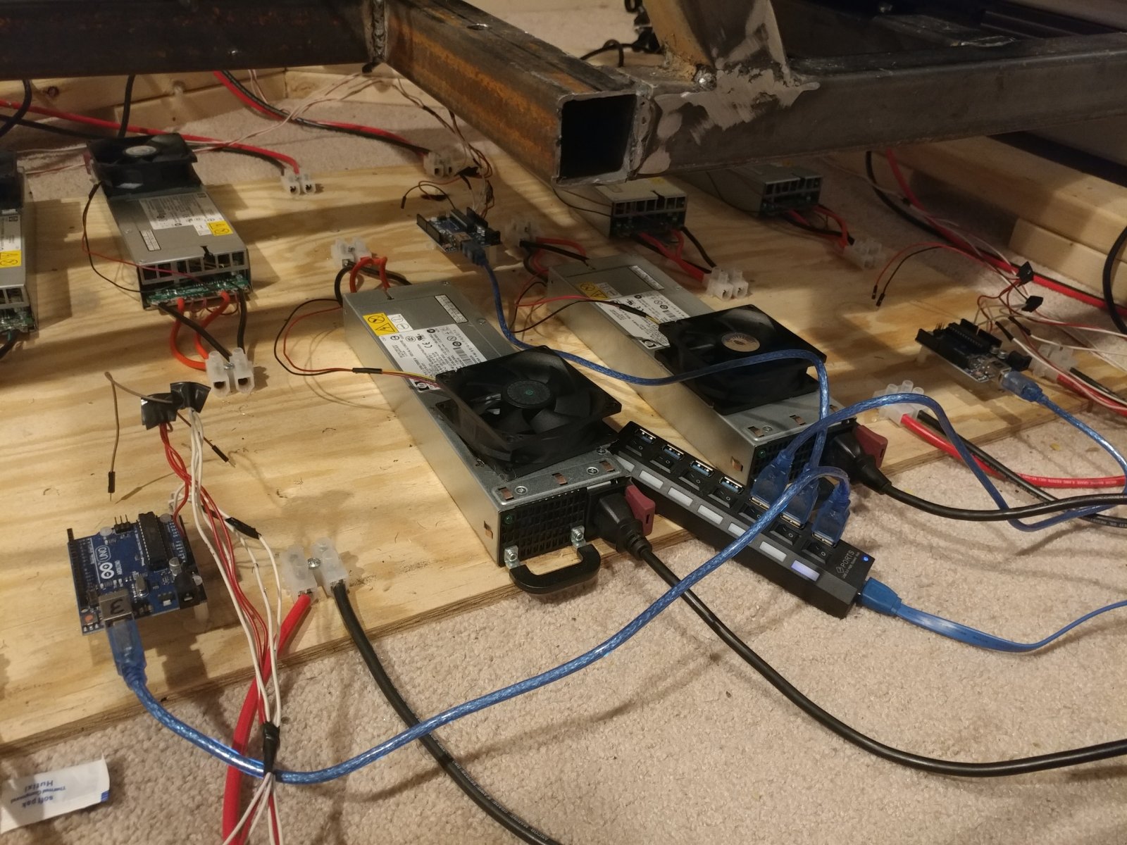

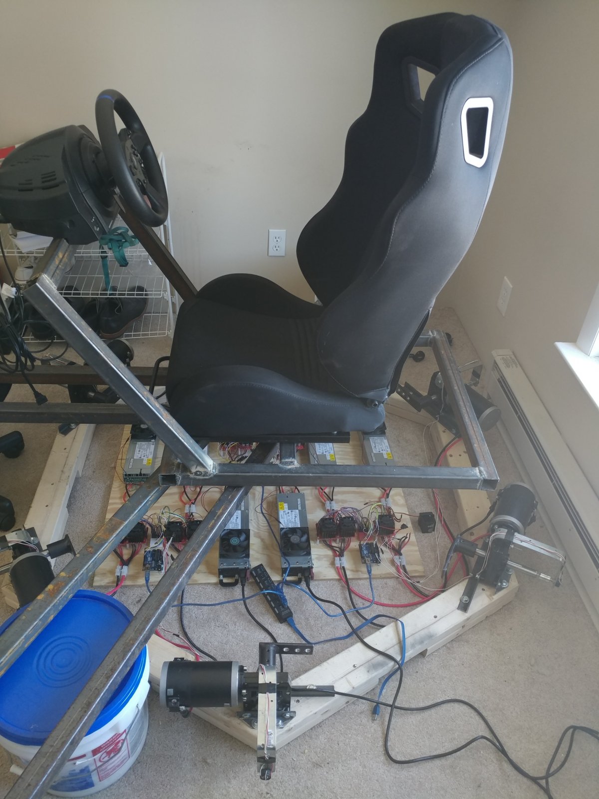

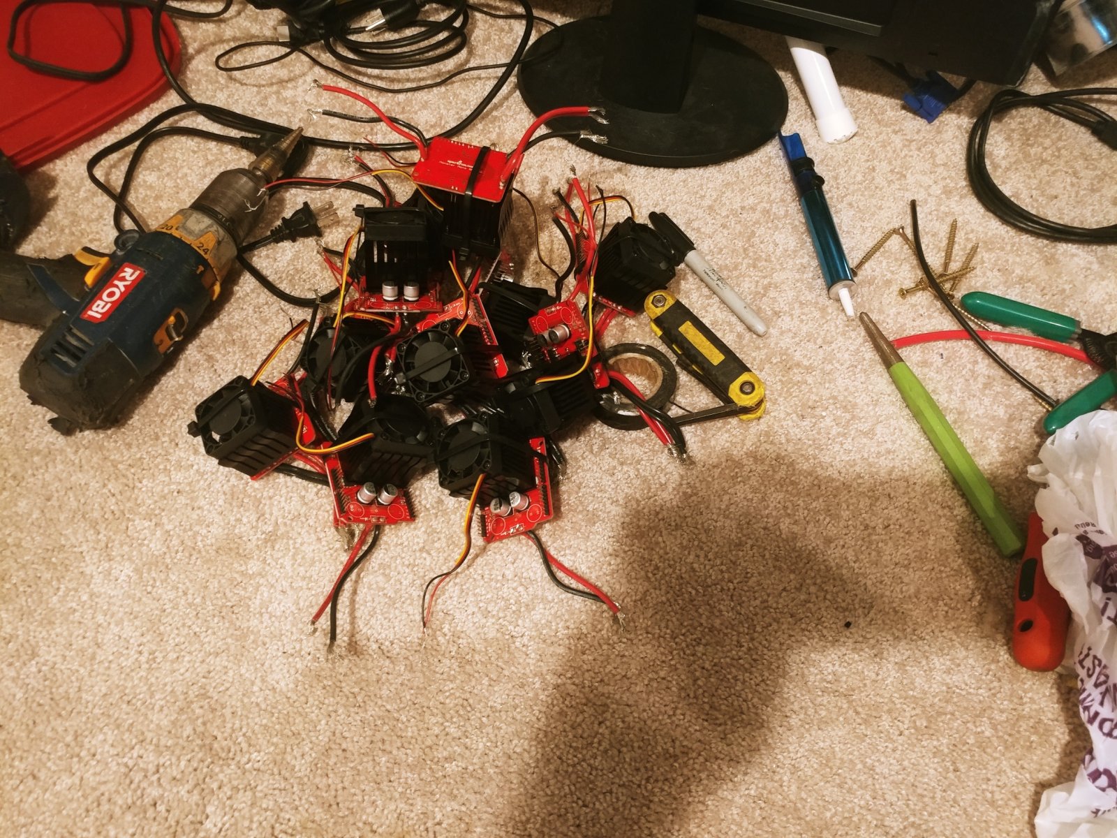

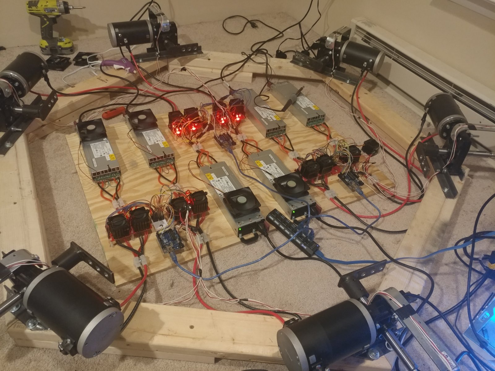

    UPDATE UPDATE UPDATE!!!!
    Since last post, I have....
    1. Built the base and seat
    2. Wired up all electronics
    3. Mounted seat to base
    4. Replaced 6 MMs which had burnt out on one of the two boards! (Junk I know)
    5. Replaced 2 PSUs, one due to faulty cap, and the other who knows.
    6. Installed fans on each PSU to prevent overheating
    7. Removed all MMs and purchased 3 Sabertooth 2x60's!!
    8. Troubleshoot Arduinos/Motors/ST due to wiring. (Was wired for MMs which I didn't catch until the second day!)
    9. Assigned all Axis/DOFs
    10. Purchased Forum pass for plugins. (Currently waiting on!)
    11. Applied for DIY Simtools key!
    The list goes on... I cannot describe how I am feeling right now, on one end I am exhausted from completing everything, trials and tribs on my own with no one to bounce ideas off of. On the other hand I am completely overjoyed with the fact the I completed this with NO PREVIOUS KNOWLEDGE!!!!
    Thanks to all whom paved the way!! Pics below....

  6. SilentChill
    SilentChill Problem Maker SimTools 2.0 Beta Tester
    2,280
    18,247Coins
    +3,003 / 29 / -0
    Nice work dude !! Another thread I missed somehow ?!? Look forward to seeing in action :thumbs
    Wise move getting the sabertooths you will never look back :D

    I would recommend you add a big battery to your list..

    @SeatTime, Im seeing mixed reviews about the need for a battery for regen purposes. Its a VERY grey area for me as I do not completely understand why its needed. By mixed, what I mean is that Ive read the Sabertooths can be setup to run on just the power supplies without the need for a battery as long as the PSUs can handle the draw?
    Please correct me if Im wrong, as well as enlighten me as to possible ST problems if a battery is unused.

    Quite simple really, your driving into a inductive load 'big DC motor'. When they change direction quickly the motor will generate a inductive pulse Ie. they will act as a generator. This pulse has to be absorbed somewhere - either in resistors as with the 2 x 32 or in a battery as recommended by the manufactures themselves - see the manual. Some power supplies (normally PC types) are more effected by this pulse then others, which is likely why you have seen mixed reviews. In the end, just a recommendation.

    @SeatTime ,
    From reading all of the threads regarding STs I believe the consensus is to parallel with a battery. If I do not, will the PSUs/STs trip out or?
