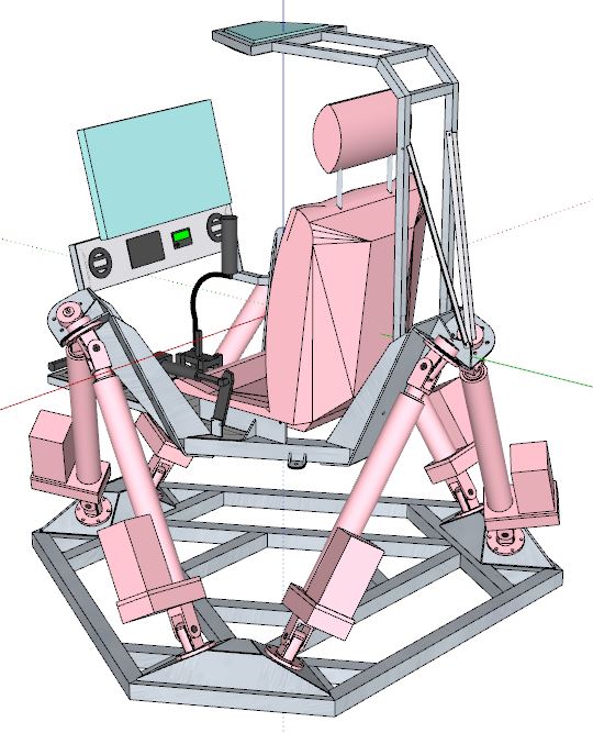

    Hello. I want to make a simulator with a moving system, using all 6 coordinates of movement on the simulator ASSETO CORSA. Equipment available, desirable and professional experience in electronics, metal processing, automation. Express your opinion about my desire. .

    A 6DOF is an ambitious first project, so spend some time researching.

    Hello. No, the system will be different. One drive, one axle. Rotate the chair radius of 1 meter 360 degrees. chair tilt + - 90 degrees, tilt forward and backward 45 degrees (90 like, but this greatly increases the size of the structure). Two more axes are linear (forward, backward) (left, right). Another axis, this is a platform up and down (I think it will be enough + - 200 mm) Something like that.

    Since I was engaged in repairing industrial CNC machine tools, I had the idea to make a chair for an industrial robot, then you fly in all the poems.

    Could you please draw a picture of what design you have in mind.

    Hello. I read a lot of information and decide to make a 4DOF simulator for starters. And the AC drive so far I have
    only 4dof. I want to control the step / dir signals.

    Thanks for the answer. I'm confused, don’t know what to do. I wanted to do on such a principle (https://www.motion-sim.cz/new/?page=home&article=15&menu=79), but my friend went on this, and he did not like it. Can I do 6 DOF? How much is 6DOF better than others? I will have actuators with a stroke of 450 mm.

    Good day. I reviewed a lot of information, I decided to do it on your controller. Actuators are almost ready for me. Servo control step / dir. I understand that I need AMC-AASD15A.

    Yes, but the controller is out of stock right now until I get more parts. It was sold out because of Black Friday/Cyber Monday sale...
    https://www.tindie.com/products/tronicgr/amc-aasd15a-servo-motion-controller/
    Make sure to use AASD-15A servos with it to be plug and play with ready DB25 male-male cables... You don't want to experiment with other servos and custom cables... :eek:
    Unless you wanted buy actuators from PT-Actuator supplier, he also sells the AMC-AASD15A controller along his actuators kit...
