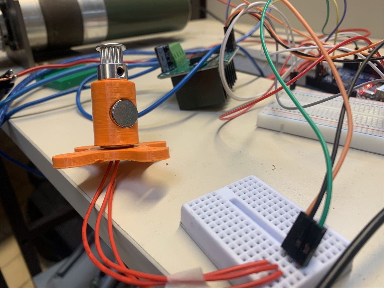

    Hello everyone
    We are juniors from a school in Belgium. We are a huge fan of F1 Formula racing and the wild idea came to us to make a racing simulator in our classroom. Our teacher gave us green light, so we started to scramble as much materials as we could find in our school to make this project come true. In the proces we stumbled upon this site. The projects on this site inspired us and we wanted to share our progress of the simulator.
    We think we started the project with a good beginning. We made a circuit with an Arduino uno. The circuit contains an Arduino, servo motors (we assume from a CNC), an ibt_2 board and DIY hall sensors.
    We focused mainly on the project of @scruck and @Halloween2go. So a huge thanks to this guys to give us inspiration.

  5. tibe Lemmens
    tibe Lemmens 5em
    Jan 10, 2022
    7
    15Coins
    After tons of experimenting with the hall sensor, we found an easy concept which is printable en reliable. Afbeelding(1) (1).jpg Afbeelding (1).jpg
