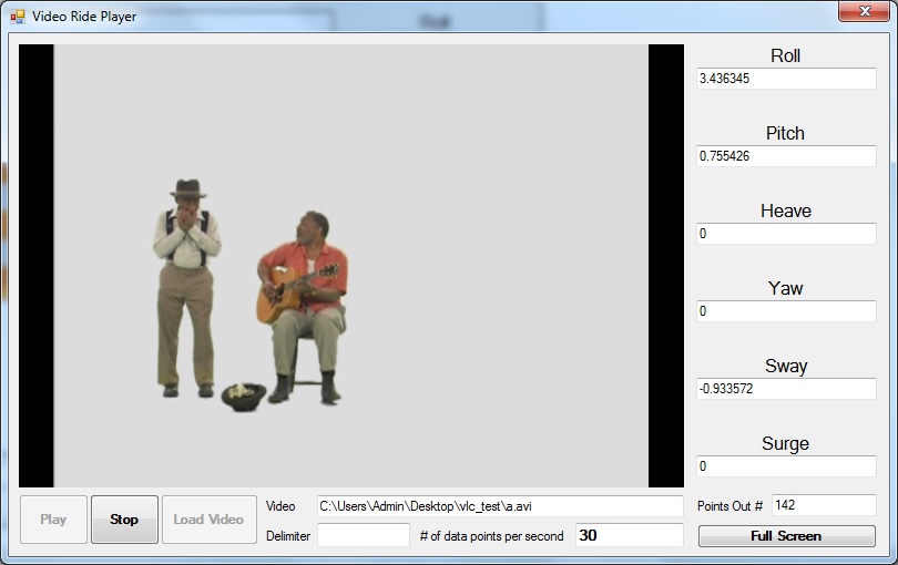

    Hi. I am 5D Cinema operator. I want to write/edit motion codes of my films.
    I know the meaning of my codes, principle of my system but i cant find a software or a basic way to create this motion codes.
    system uses 2 type of codes. 30hz and 100hz
    30hz motion file has 30 line of motion codes for 1 second.
    100hz motion file has 100 line for 1 second.
    a part of 30hz code
    (6 columns means)
    x y z roll pitch yaw

    Can anyone help me?

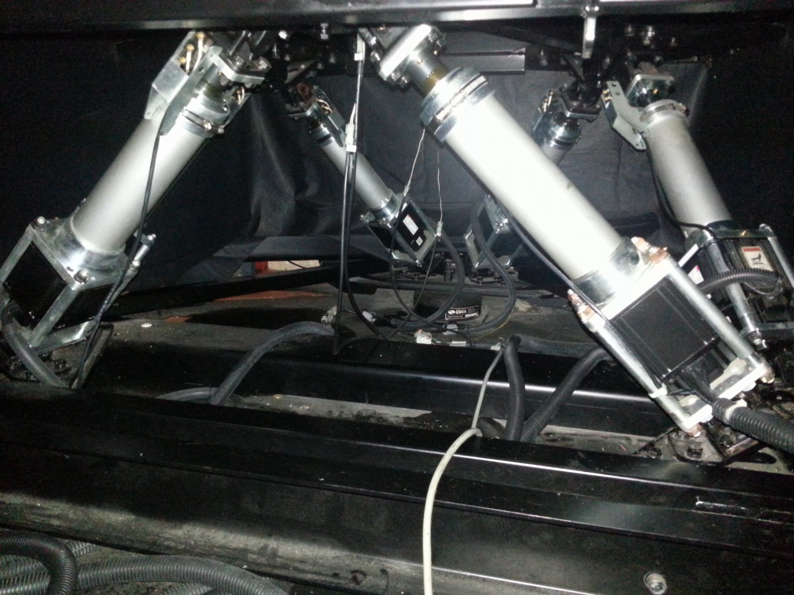

    and here is a photo of my system. ( 6 dof stewart platform )
  3. yobuddy
    51,760Coins
    +5,206 / 19 / -0
    I can help you with this!
    First I need to know the software you use for playing the "movies".
    What we need to do is simply make a plugin for that app.
    Is this video software something we all could use in the end?
    Sure be fun sharing ride movies amongst each other.

    @Ashraf My software came with my system. It is installed on systems computer But i have no installation package of this software. I need to create motion codes which i wrote my first post.

    This is what I have come up with after a few hours.
    It's using a fake telemetry file with any old video as I had no real ride videos to play with.
    But it looks quite possible!
    • Like Like x 6

    Sounds cool, so the possibilities to have a video plugin that we can create motion cue file behind could be a reality. Does sound like a cool addition.
