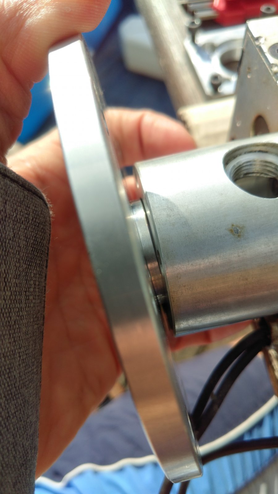

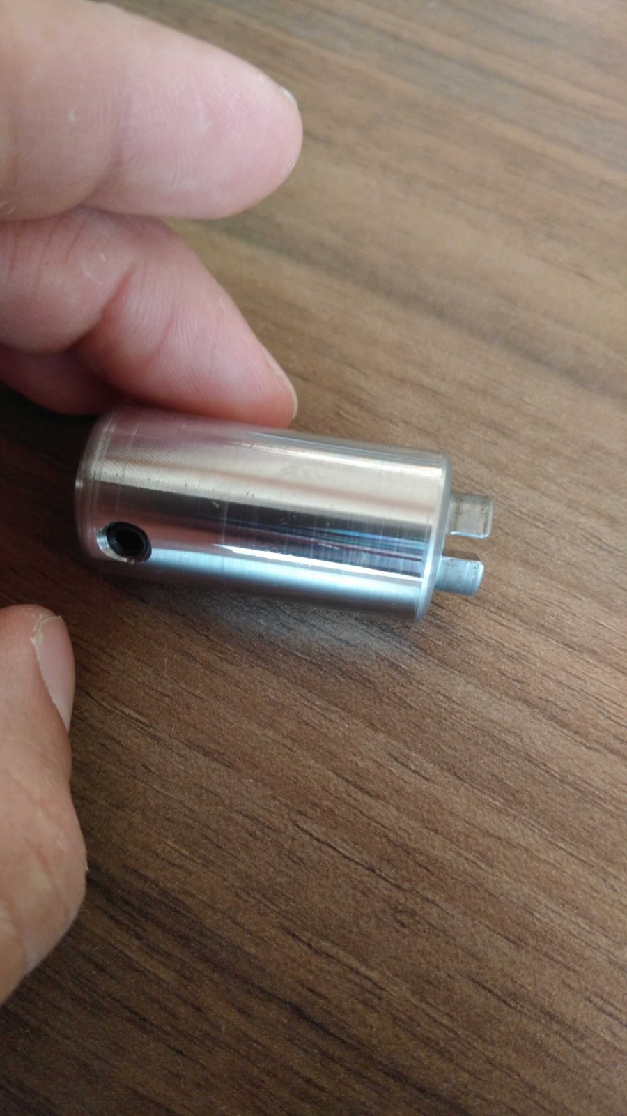

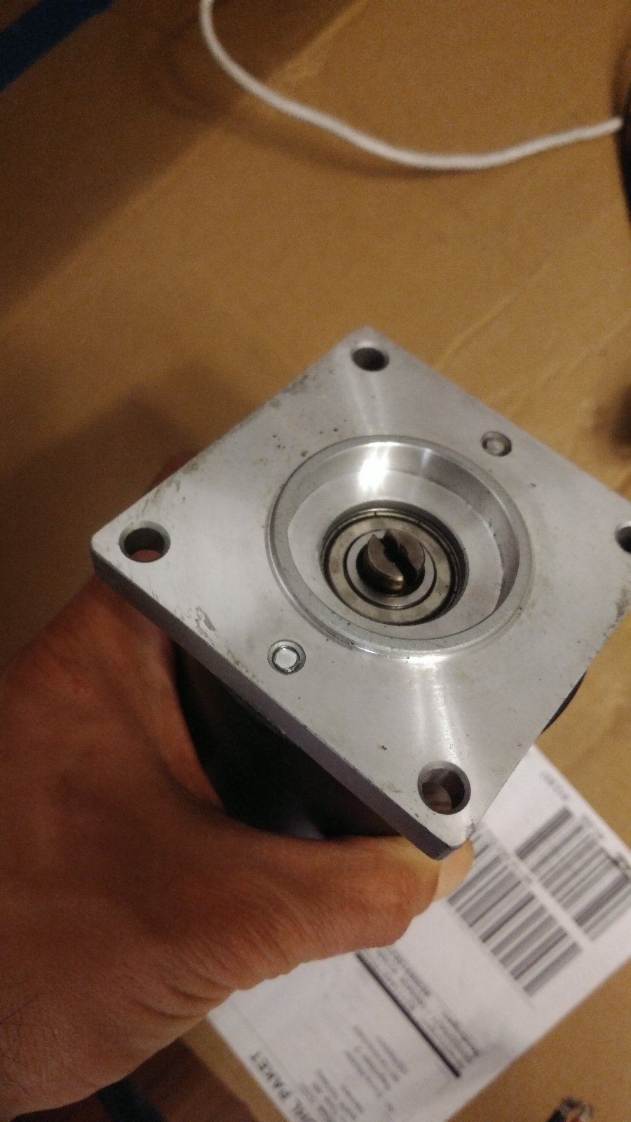

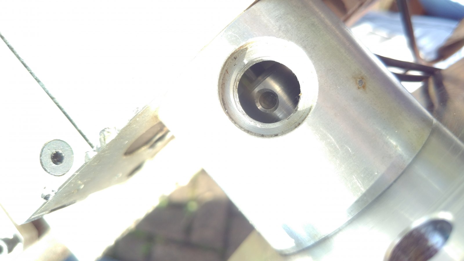

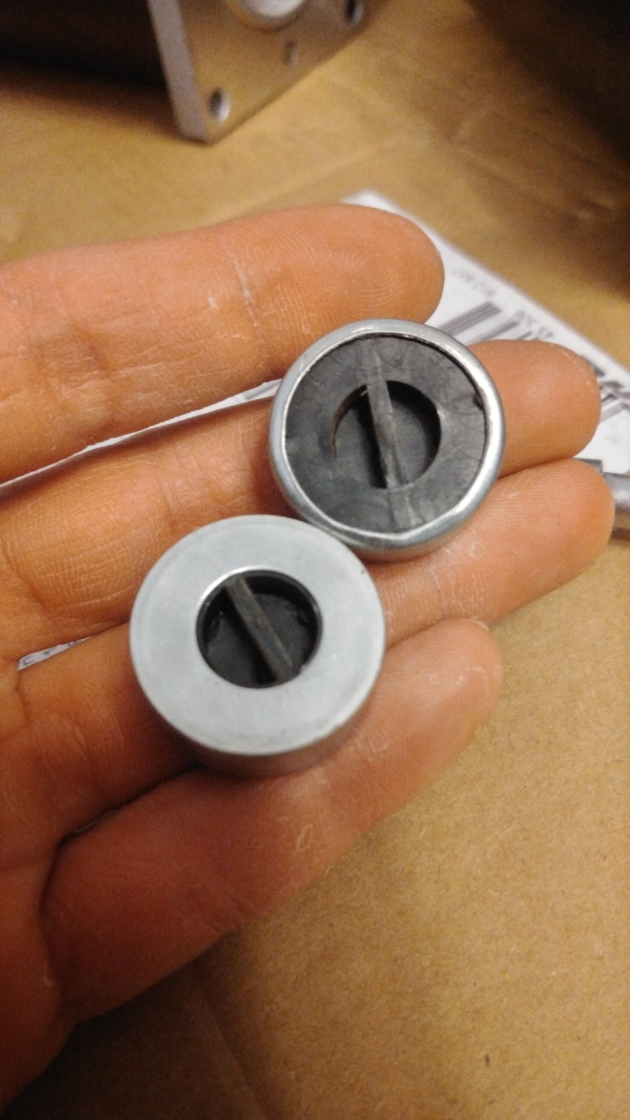

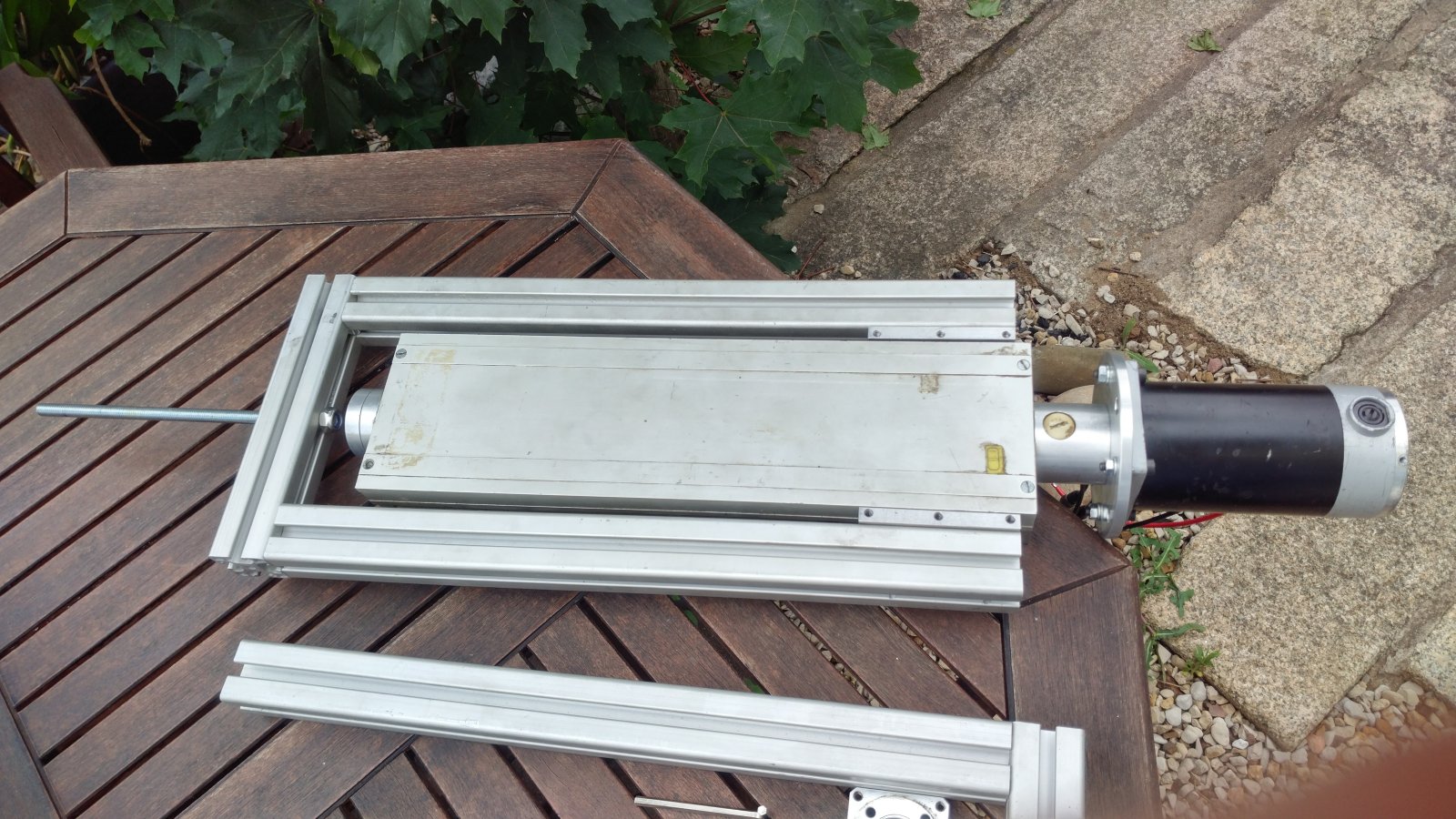

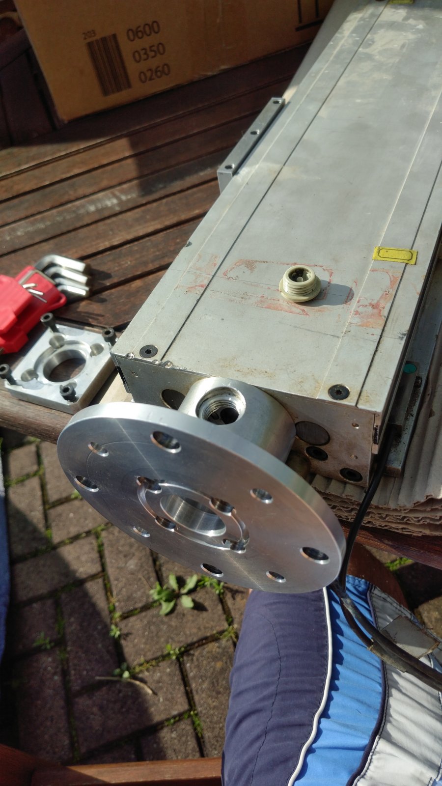

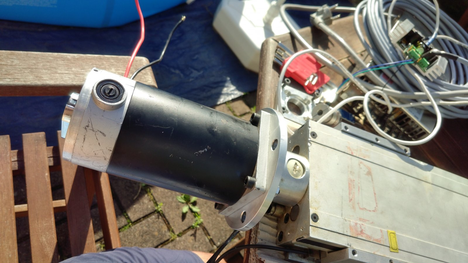

    The last weeks I designed the actuators and bought a lot of stuff. The first surprise was that the motors didn’t have a regular shaft and used these couplers:
    It’s a worm gear wheelchair motor with a brake. I couldn’t just buy a regular coupler for two shafts but had to design my own one:

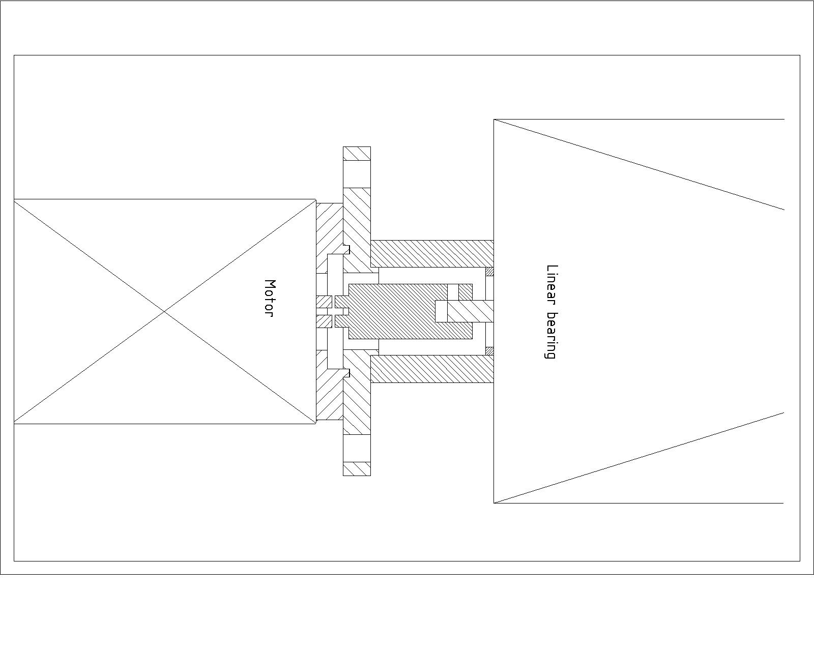

    The hollow side is attached to the linear unit, the other side is put in the coupler of the motor:
    The centering of the Motor and the ball screw is granted with this plate:
    It has a rabbet/dado (don’t know the English word for it) for the motor and for the linear bearing.

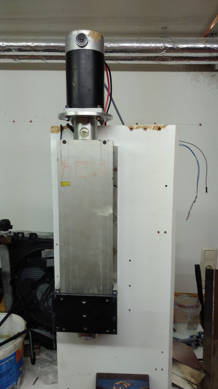

    The plan was to assemble it like this:

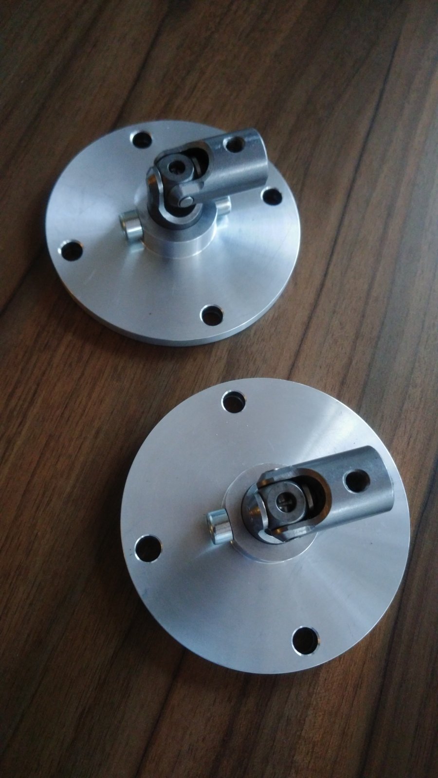

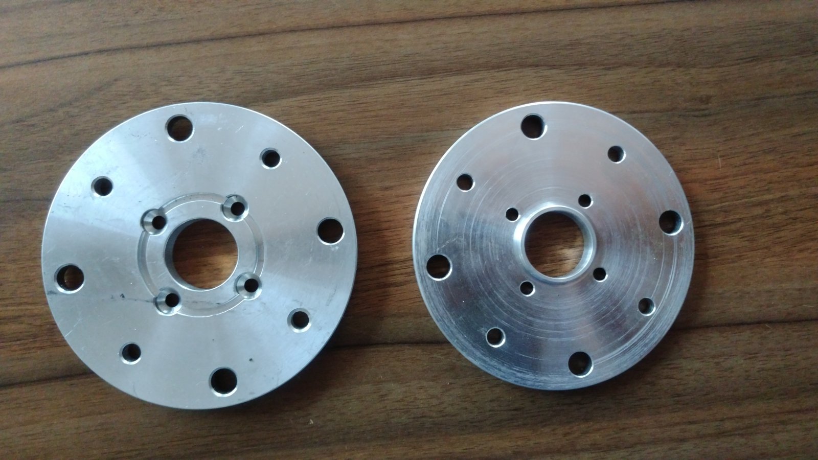

    Not shown in this drawing are the flanges with the u joints. Didn’t find an affordable u joint with flanges, so I just bought an u joint and draw my own flanges.
    This flange will be connected with threaded rod to the plate you see above. The other side of the flanges is not finished yet.
    Here are some pics of the parts assembled:
    IMG_20190617_174843.jpg IMG_20190617_174839.jpg IMG_20190617_174853.jpg IMG_20190617_175047.jpg IMG_20190617_175353.jpg IMG_20190617_180226.jpg

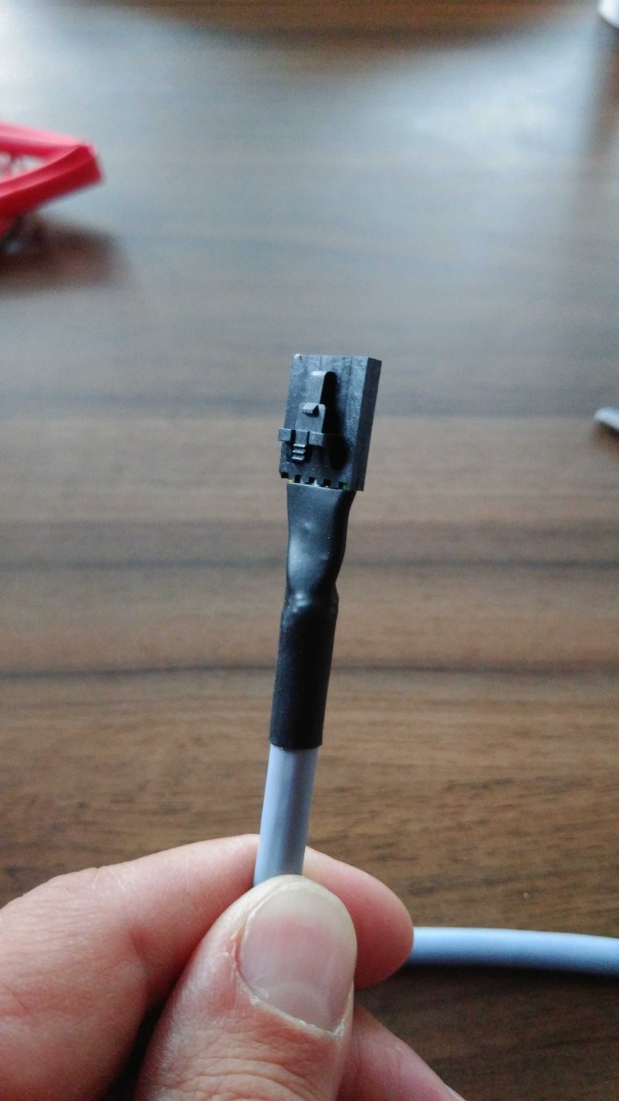

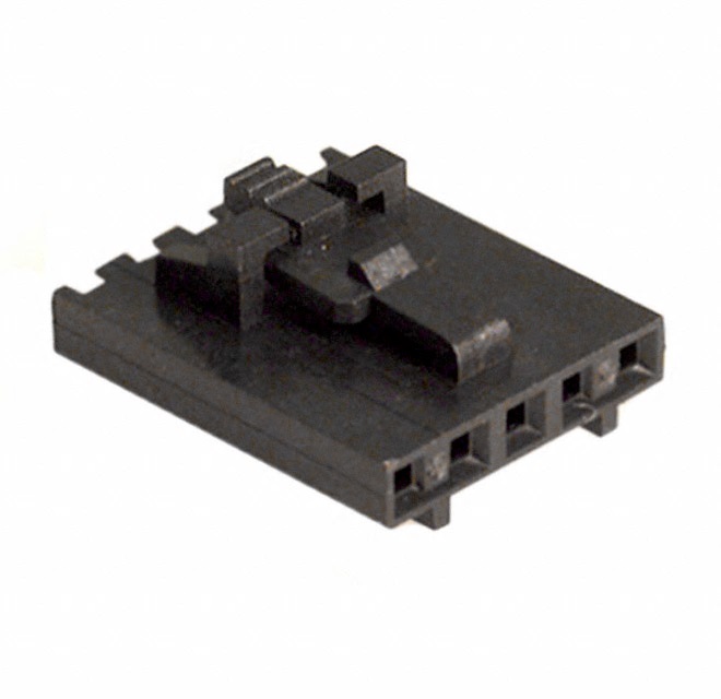

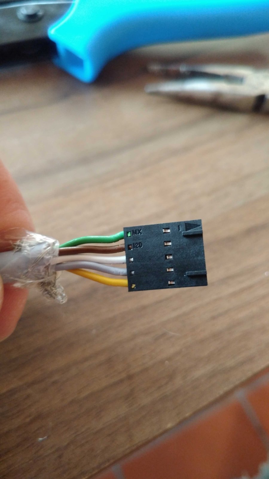

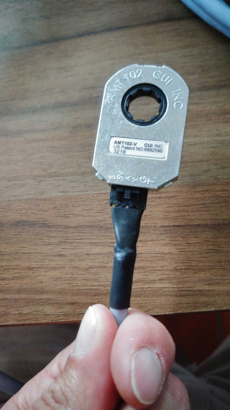

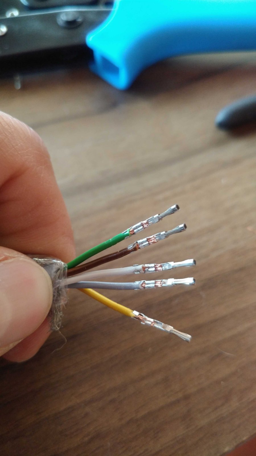

    At the back of the motor is a quadruple encoder from CUI. Thanks to @wannabeaflyer2 I didn’t have to search long for a good encoder.
    I found really quickly a cable for the AMT102 for 20$ (with plugs on both sides), but I didn’t want to pay 40 $ for cables which don’t have the proper length, so I started looking for the male plugs. After hours I found the name of them: Molex SL 5 pin W/Latch.
    And then I was able to find a supplier: Digi key J The price was as expected ridiculously low: 0,32 € a piece. But since my crimping pliers didn’t work, I had to pay another 15 € for the pliers. But it was worth it: At the end I paid less and have the length of the cables I want:)
    Here some pictures of the crimping process:
    I didn’t drew the encoders in CAD. And here I made a mistake with the threading. The way they are now, the cable collides with the M10 threaded rod which connects the upper part of the actuator with the u joint flange. So I will need to disassemble the motors again and make new threadings rotated by 45 °. At the moment I have M2.5 screws, but maybe I’ll take M3 screws…

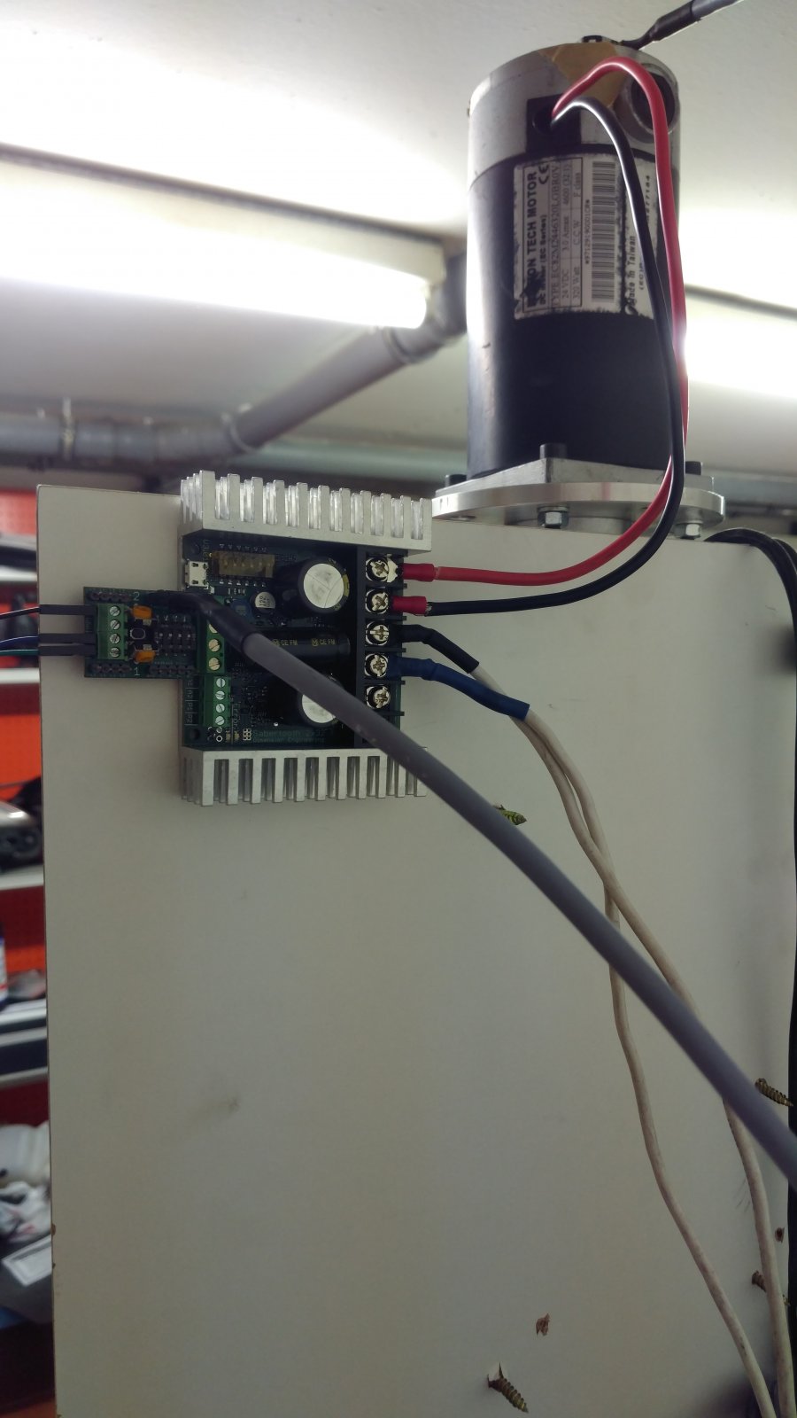

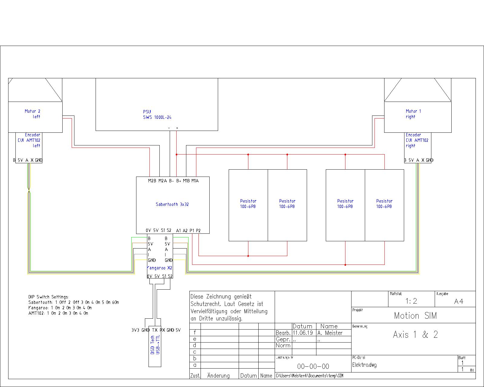

    Here is a wiring diagram of the two back-axis.
    Also the DIP switch settings are listed. Atm the encoders work with the highest possible resolution, maybe I’ll have to change that.
    I also made my first test with the kangaroo auto tune function. It’s really easy :) and you can quickly see the actuator moving. What didn’t work out was the regulation with a pot (don’t know why). Also the kangaroo had problem when I added 15 kg to the actuator. The kangaroo didn’t seem to do anything against the gravity: the weight pulled the sledge down:(
    The next step will be to attach the things to the PC and test it in DeScribe and with SimTools.

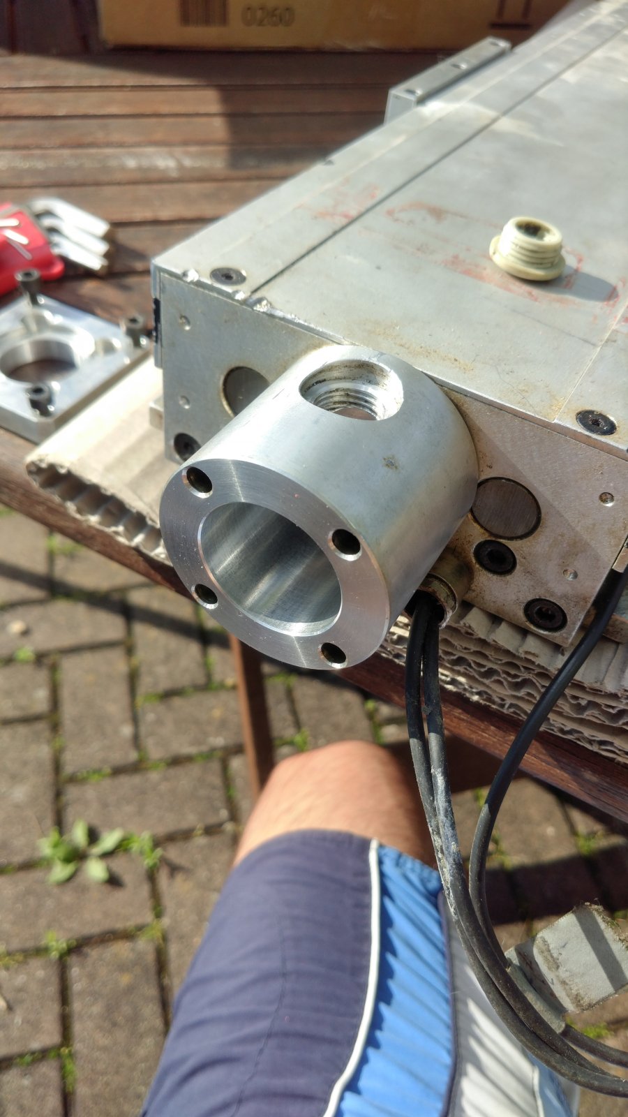

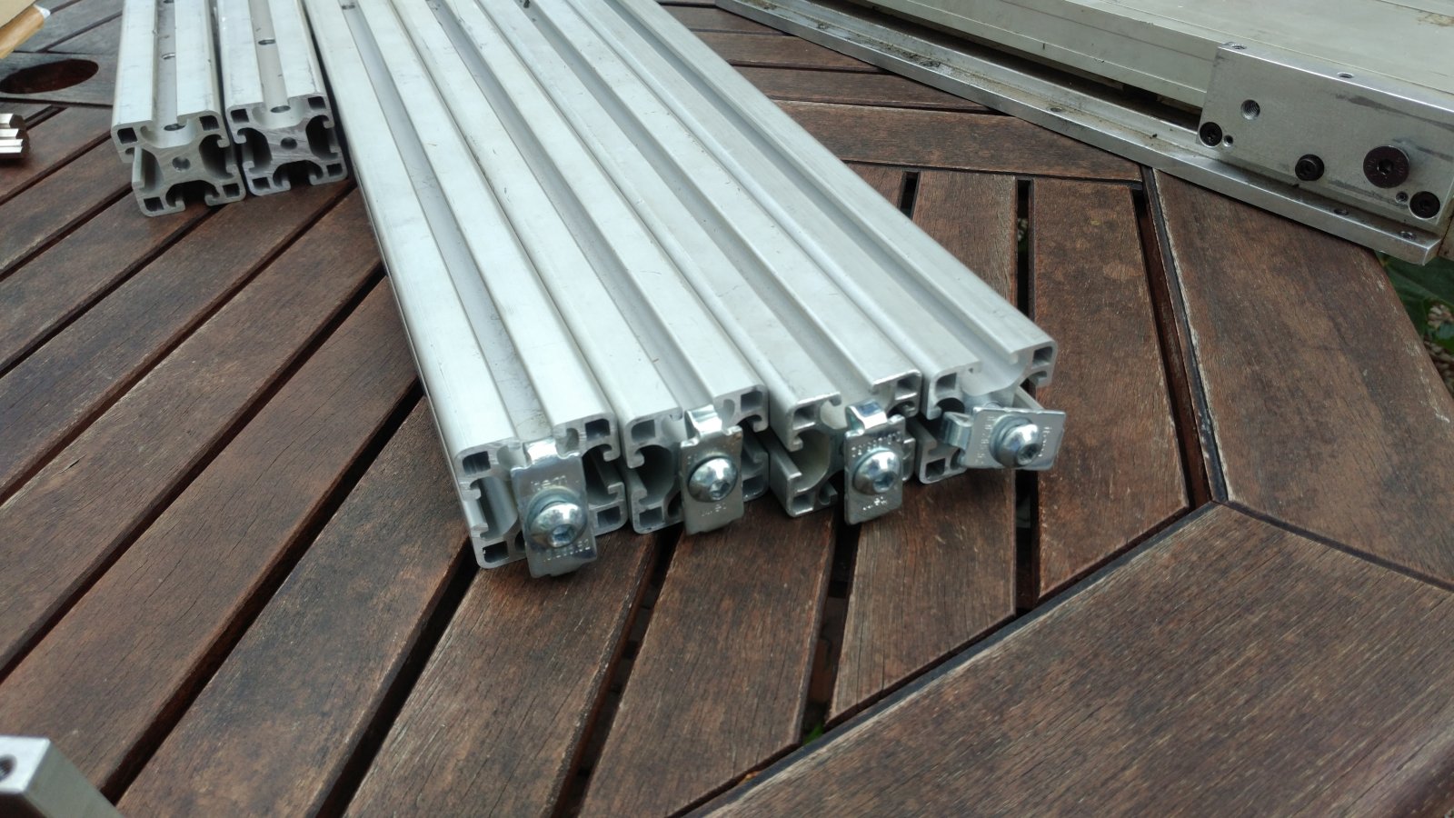

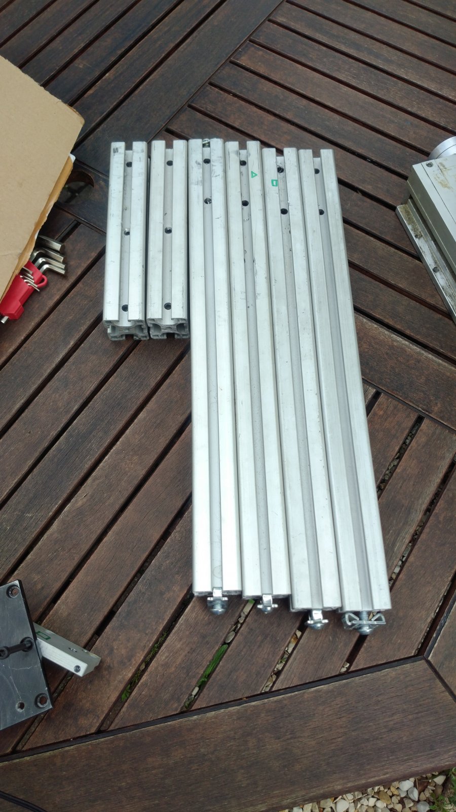

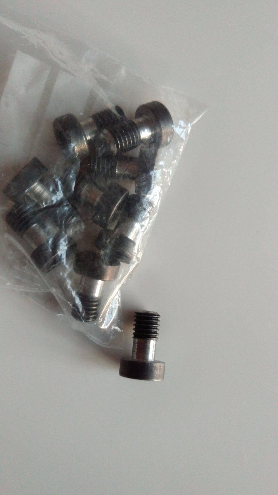

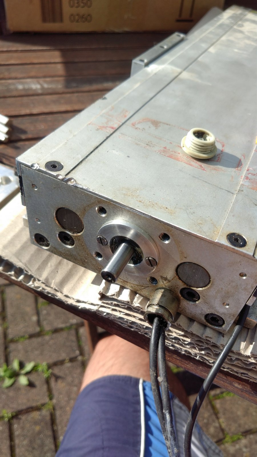

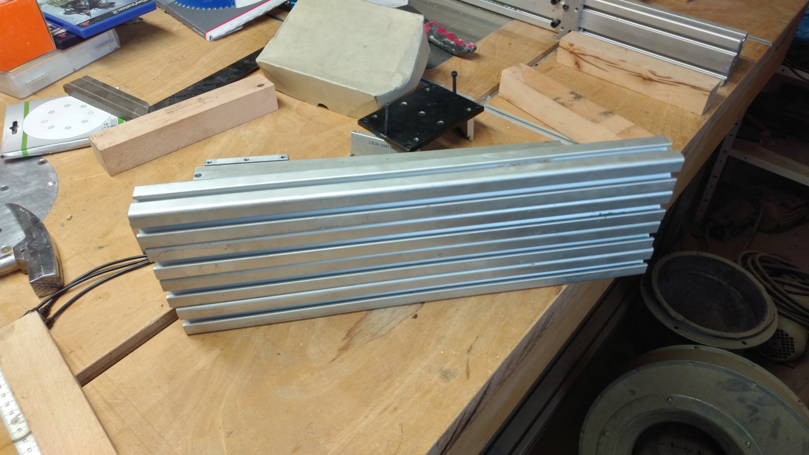

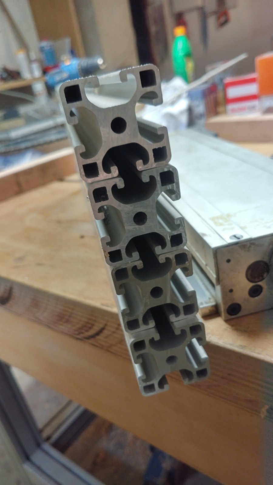

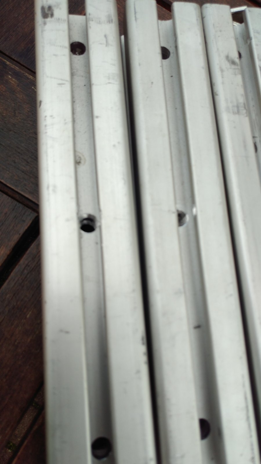

    To keep you up to date I also want to add the newest progress. It’s the connection of the actuator with the moving upper Frame (with seat, pedals, wheel...). Had several ideas in mind and tried some of them. At the moment my solution are some extrusions which are cut and got some holes and threadings. In the linear units I needed some threadings in the sledge that I can screw the extrusions together. For that I again needed custom screws :D
    Here are the pictures:
    IMG_20190620_102932.jpg IMG_20190620_162744.jpg IMG_20190620_162748.jpg IMG_20190620_164812.jpg
    In the last picture you can see a threaded rod. A rose Joint will be screwed and connected to the frame. As soon as I have it done I’ll add some Pictures.
