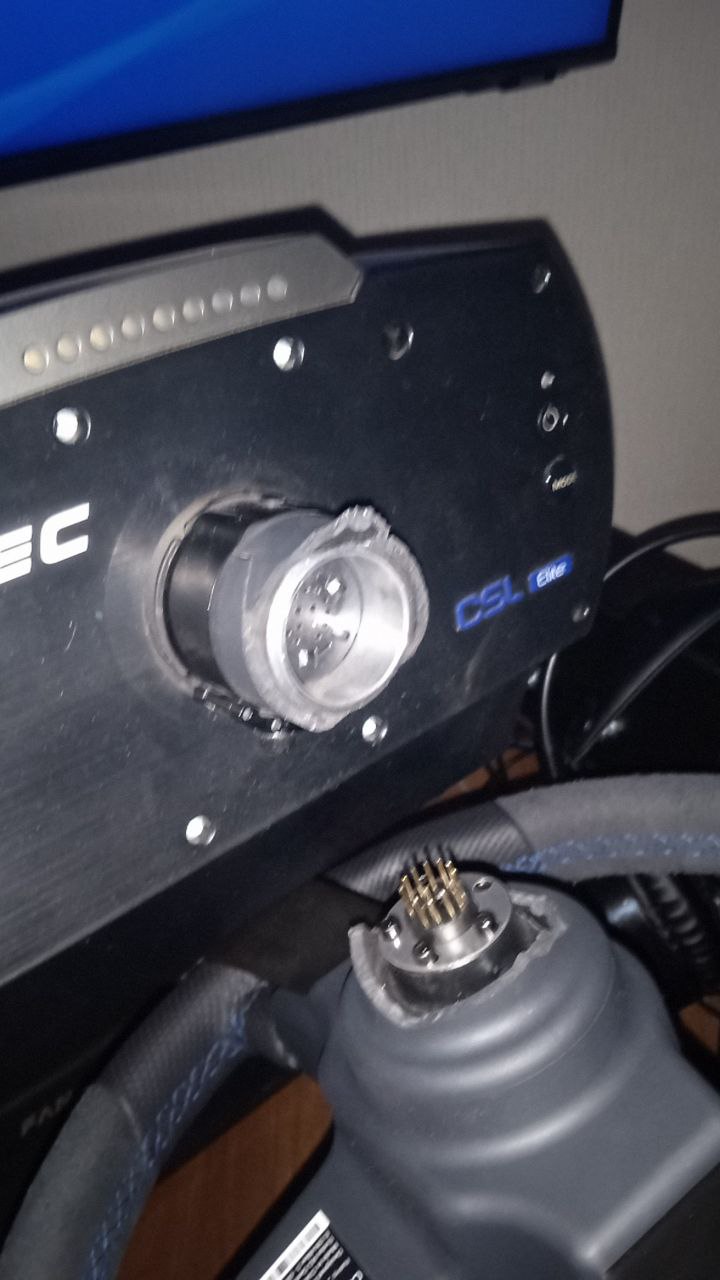

    Hello! This happened, how to fix it? Somebody knows?

  4. Gadget999
    2,026
    12,353Coins
    +498 / 11 / -0
    Oops !
    Can you buy an alternative wheel ?
    Can you get a quick release kit for this wheel

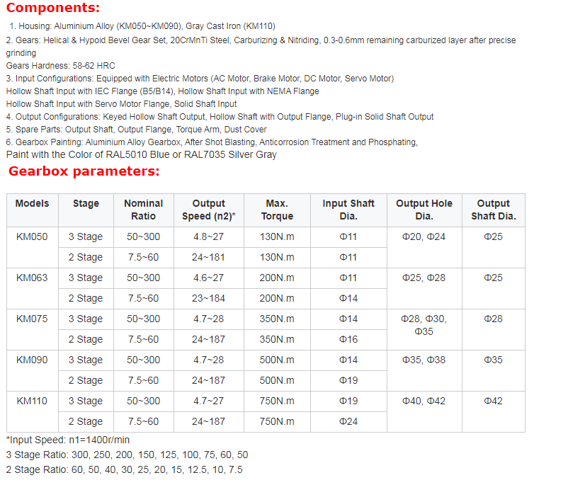

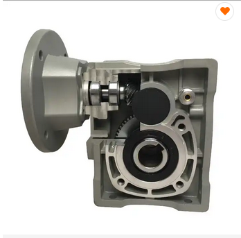

    Some characteristics:
    I'm thinking of trying this gearbox, but I don't know which one to choose?!
