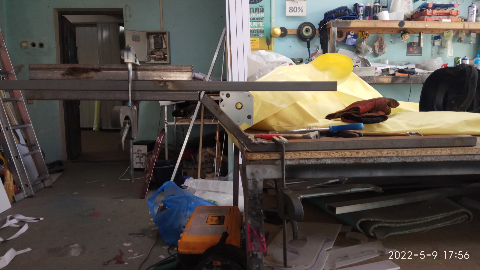

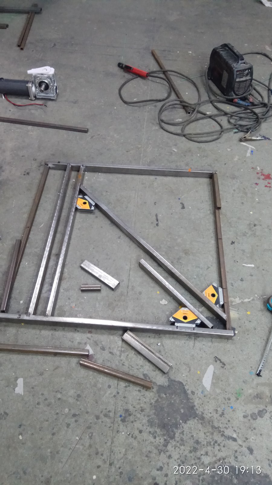

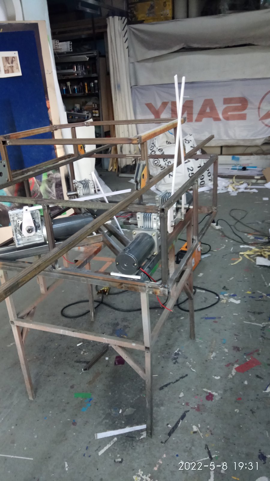

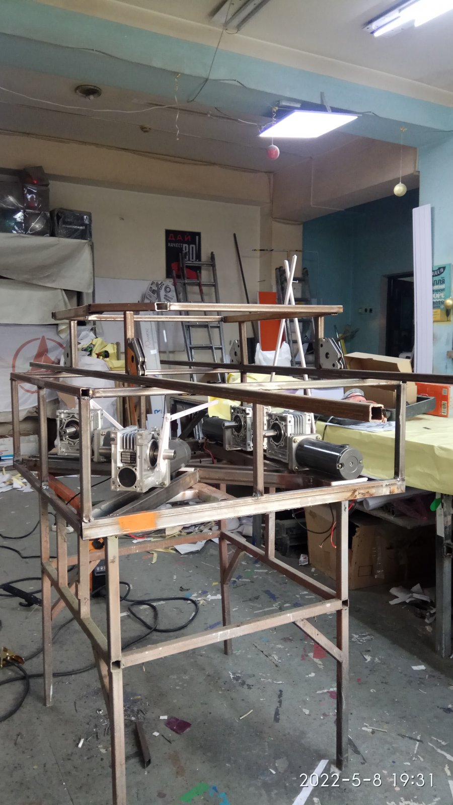

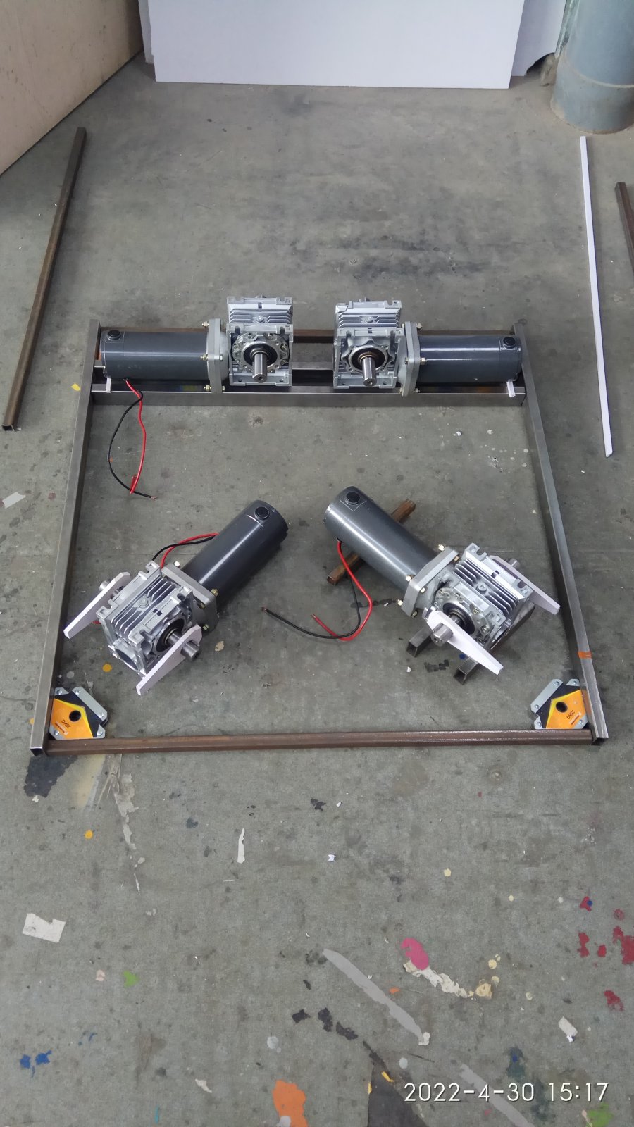

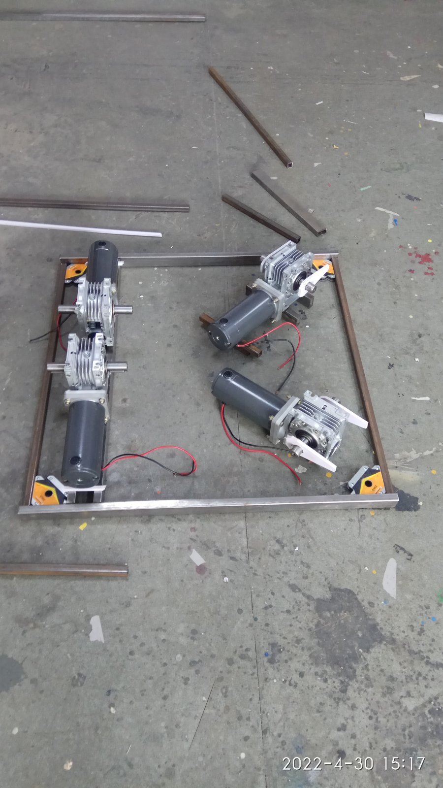

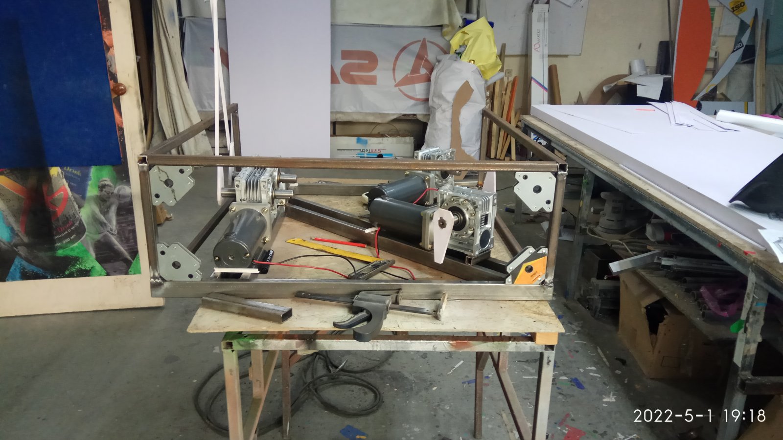

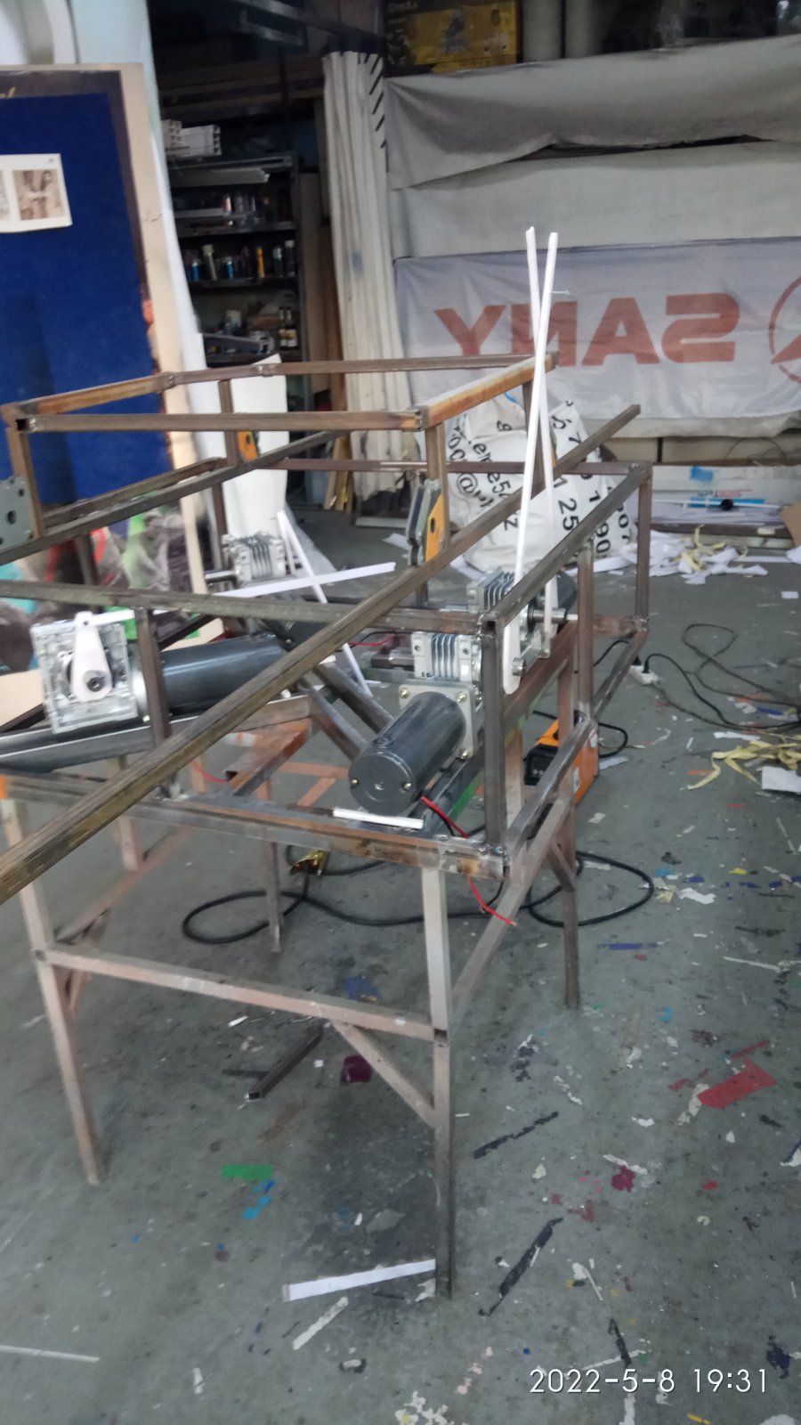

    Hello everyone!
    Started assembling the platform frame.
    If anyone is interested, I'll post pictures.
    First day
  3. kalbasator
    kalbasator Active Member
    Dec 28, 2021
    110
    Kazahstan, Almaty
    170Coins
    +39 / 0 / -0
    3DOF, DC motor, Arduino, Motion platform, 4DOF

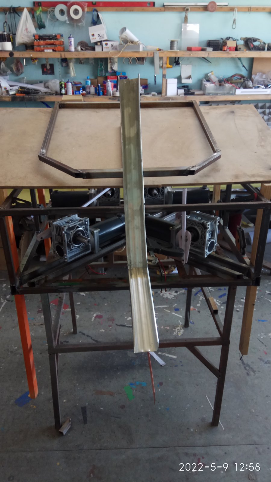

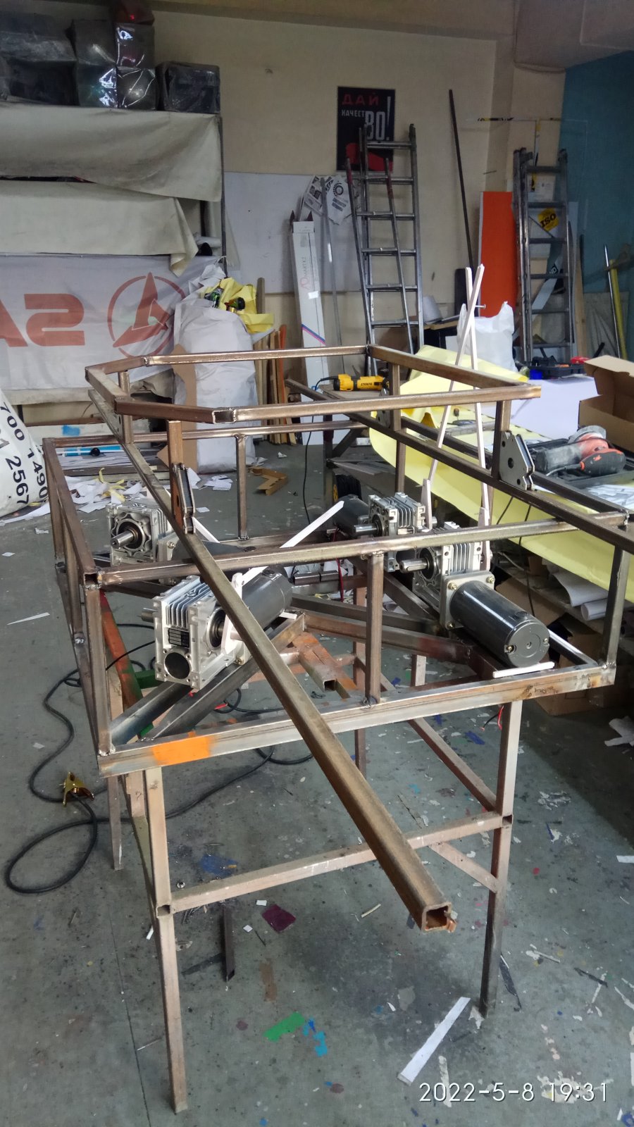

    Second day
  4. kalbasator
    Dec 28, 2021
    110
    Kazahstan, Almaty
    170Coins
    +39 / 0 / -0

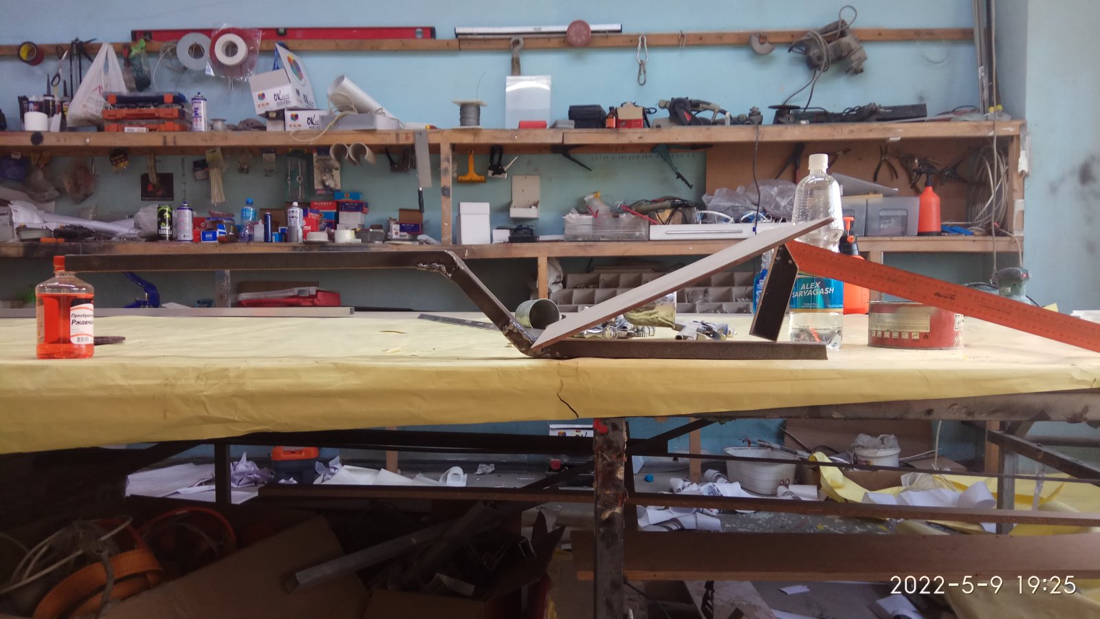

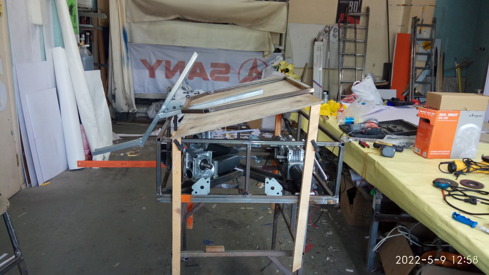

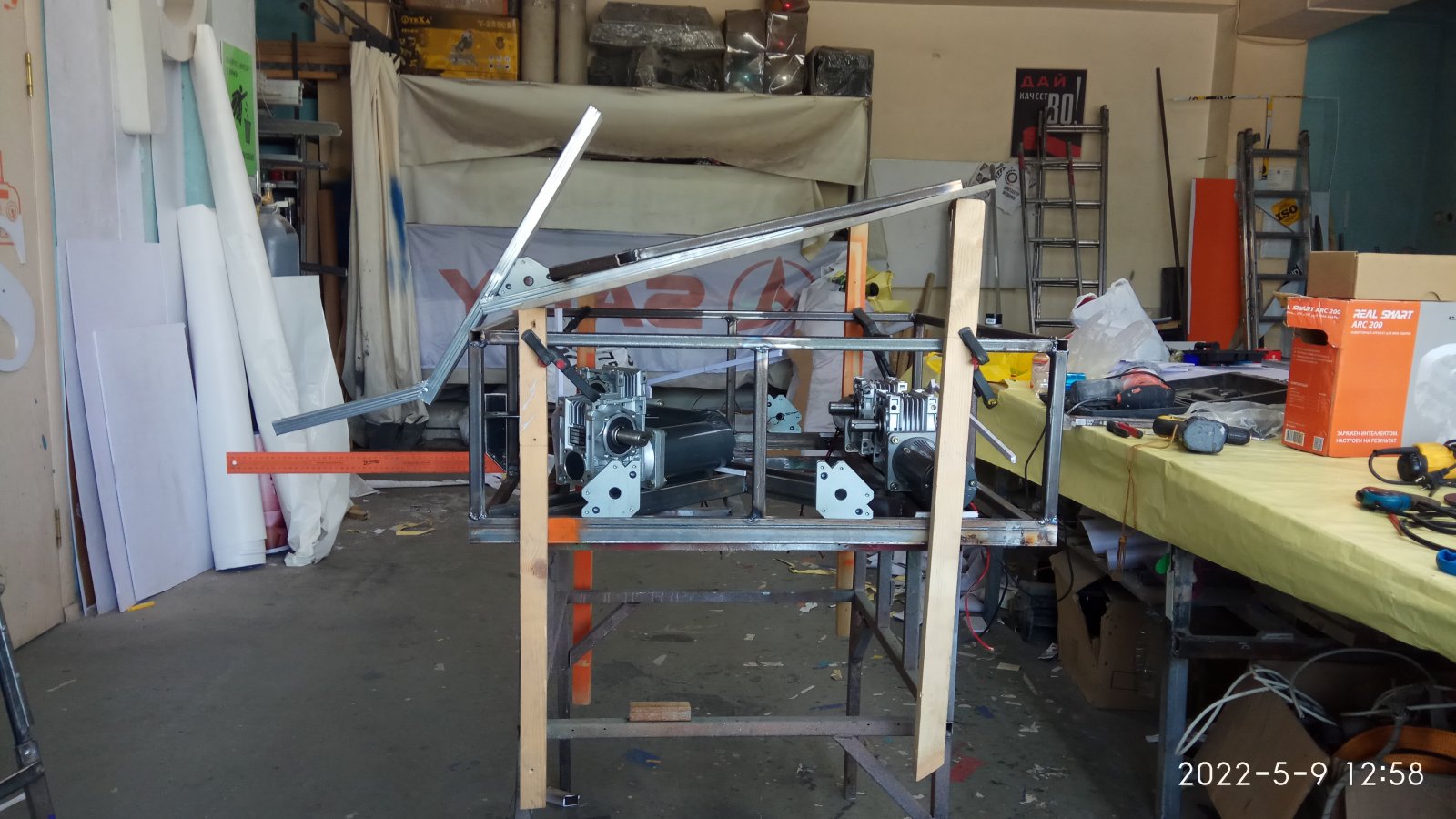

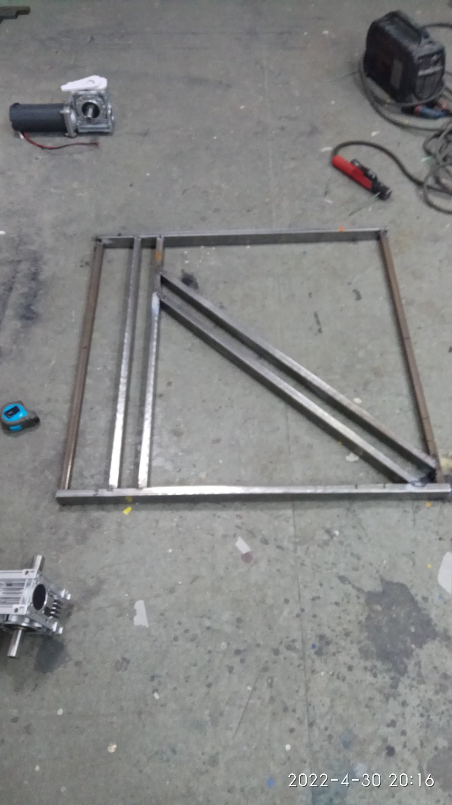

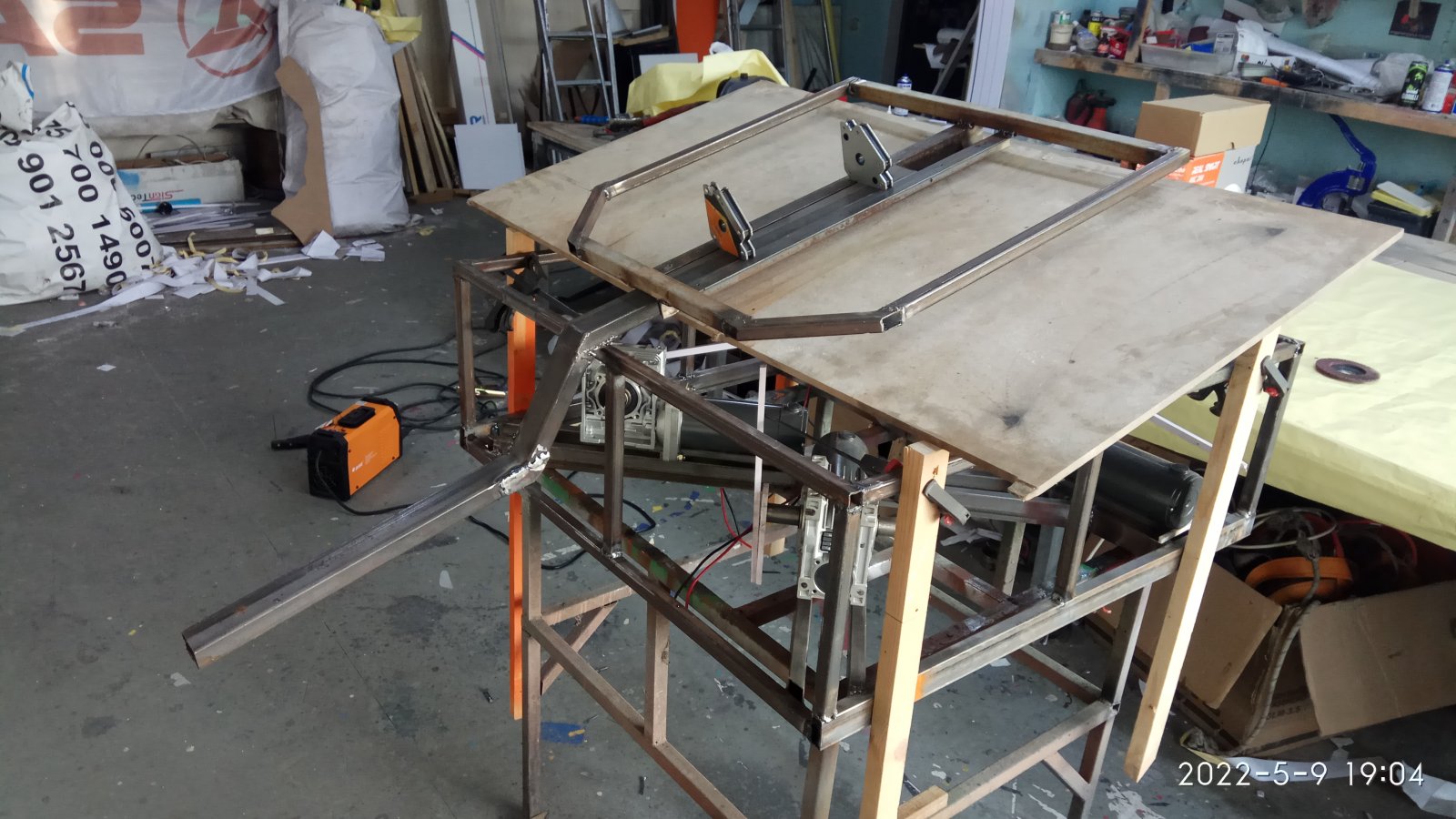

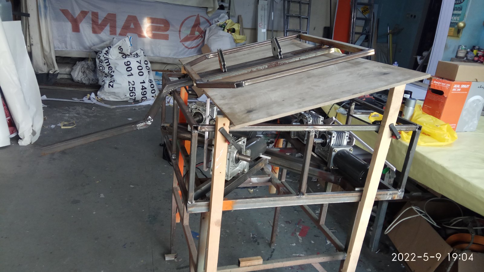

    On the third day, I prepared the upper platform, set approximately the upper point of elevation
  5. kalbasator

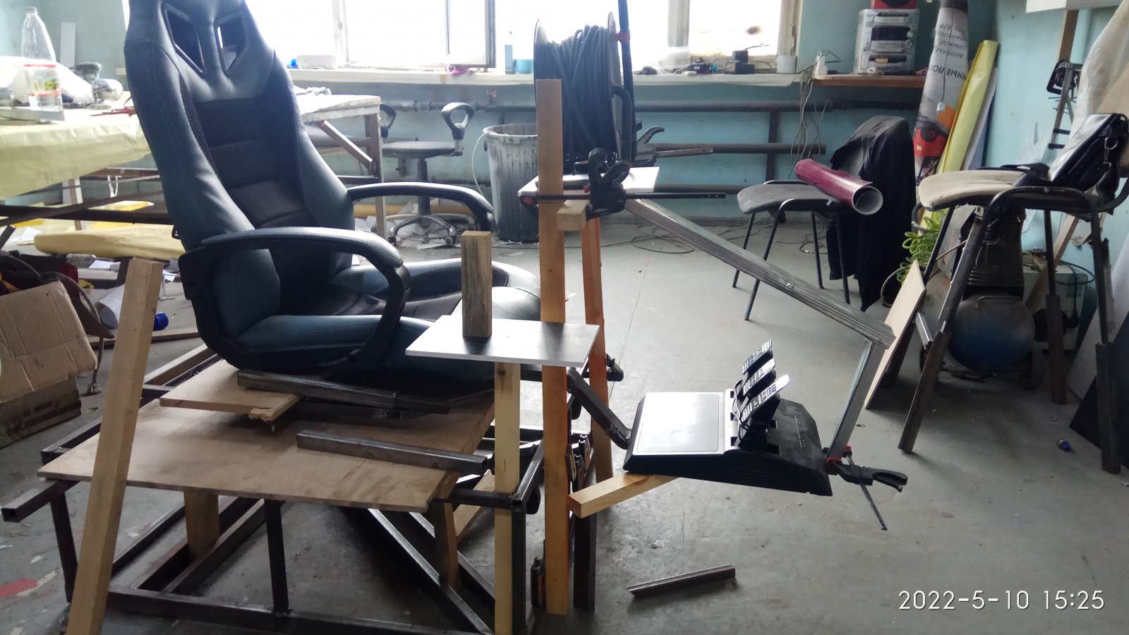

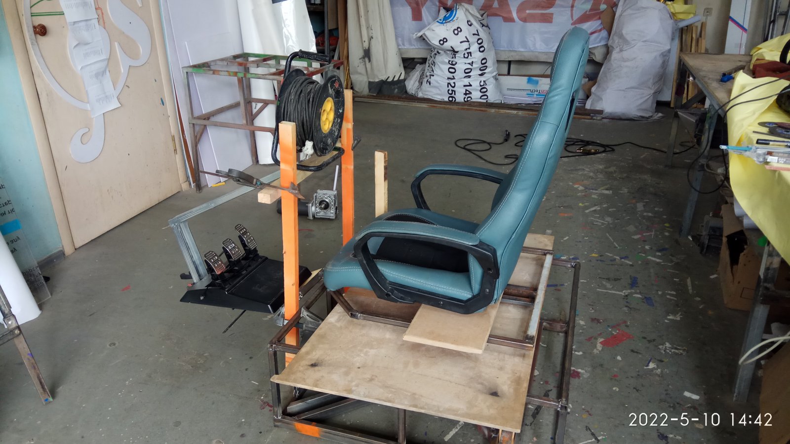

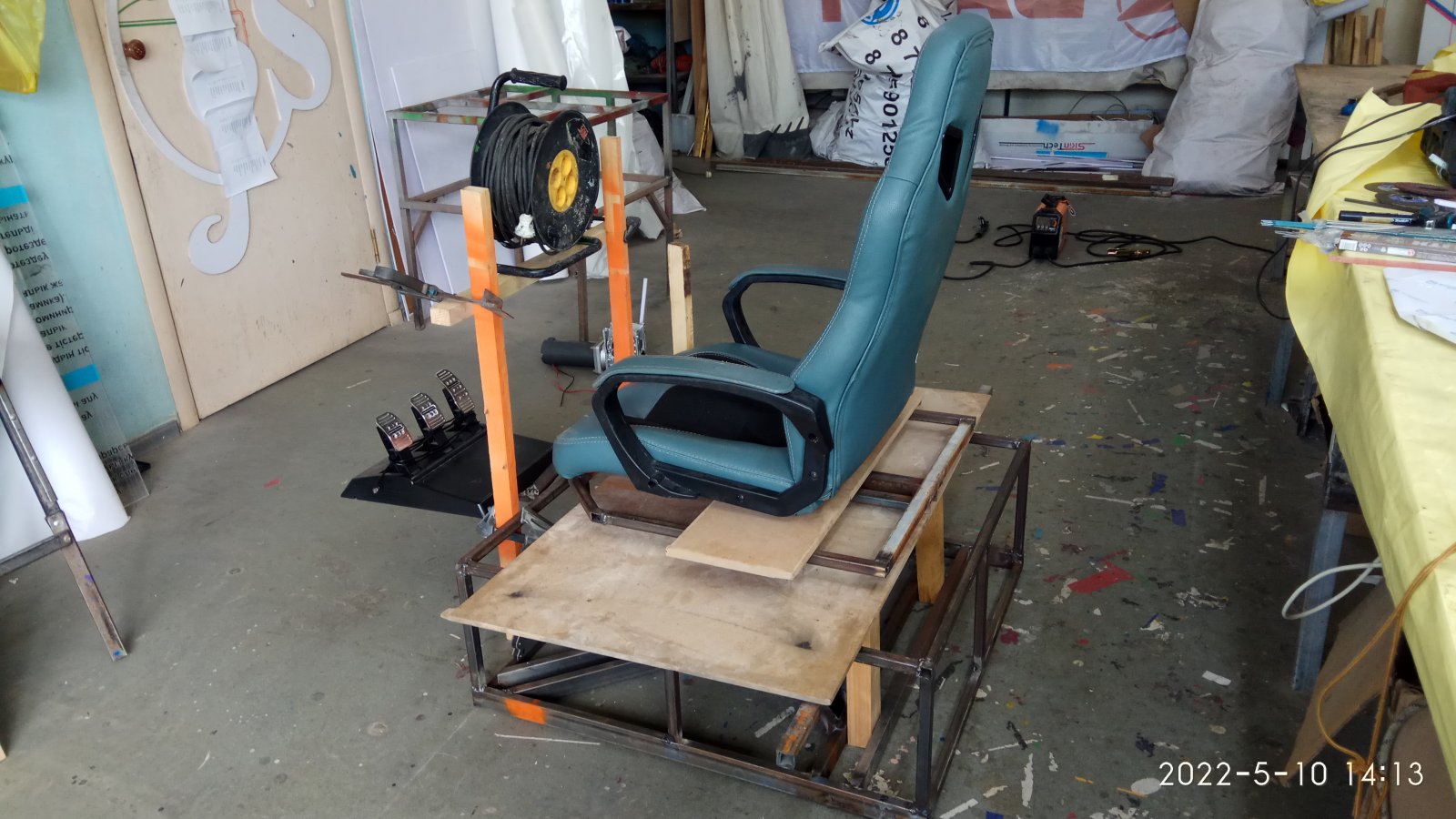

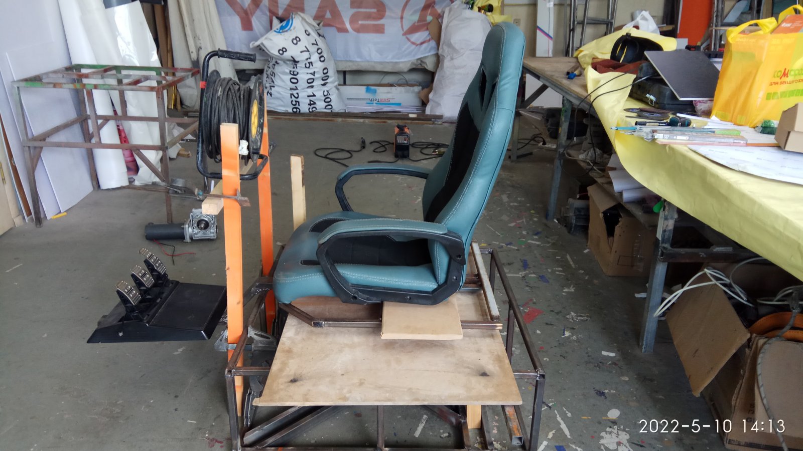

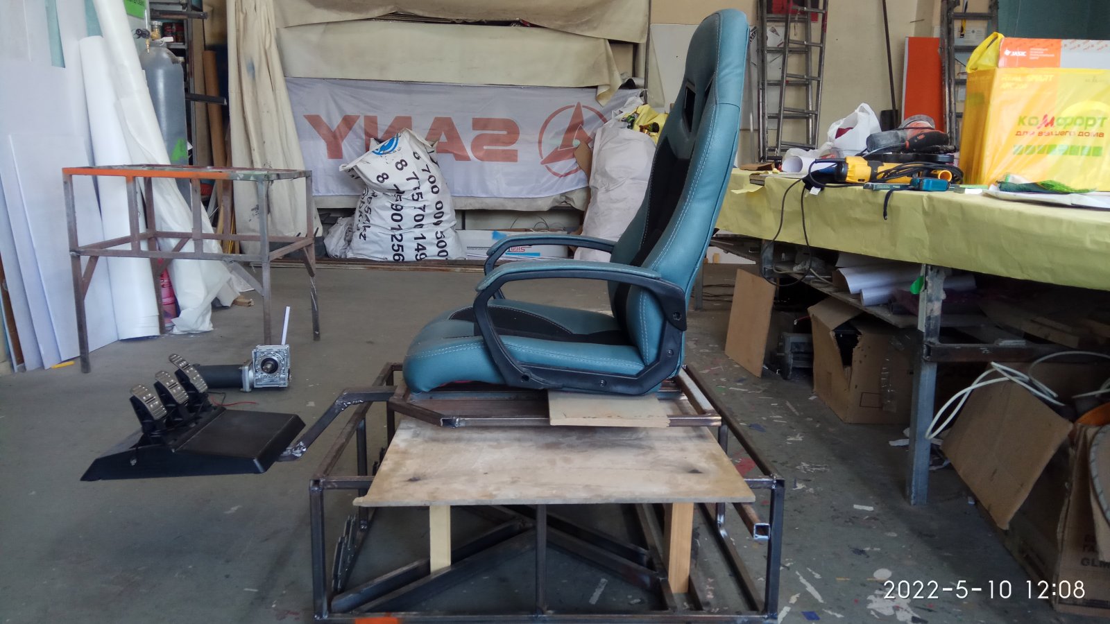

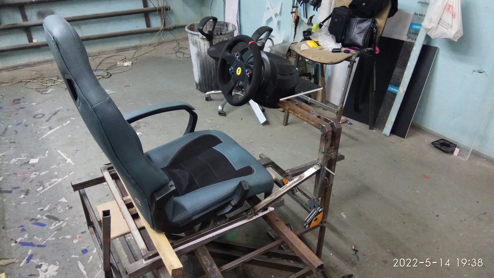

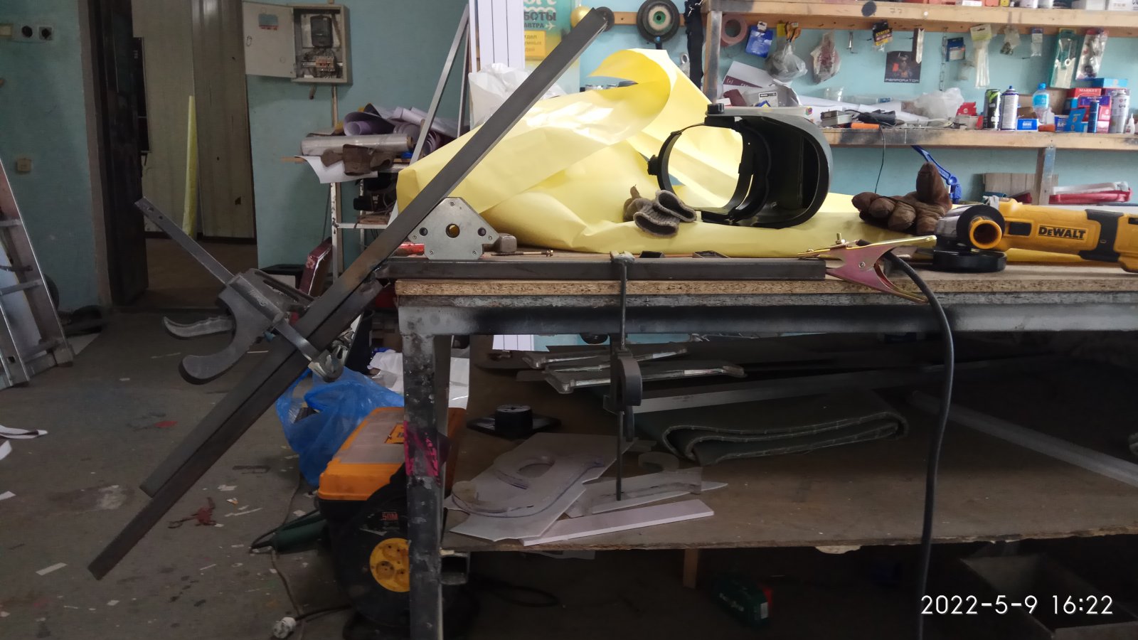

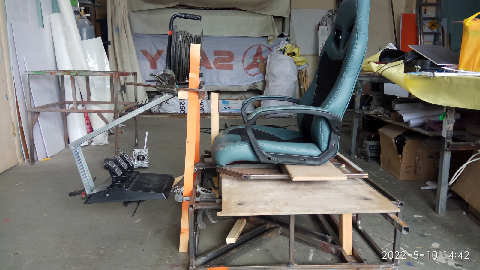

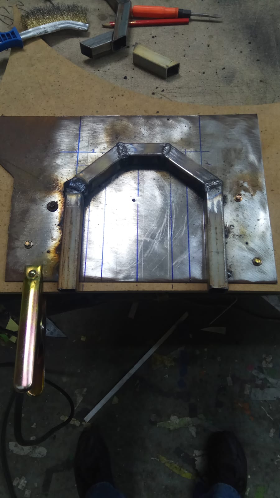

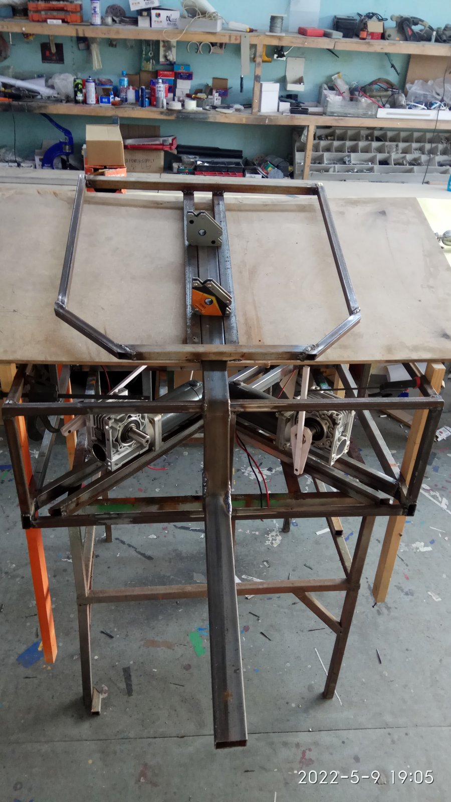

    Fourth day.
    Made a goose :grinfor pedals
    Approximately tilted the platform in order to visually understand what and how
  6. kalbasator
    Dec 28, 2021
    110
    Kazahstan, Almaty
    170Coins
    +39 / 0 / -0

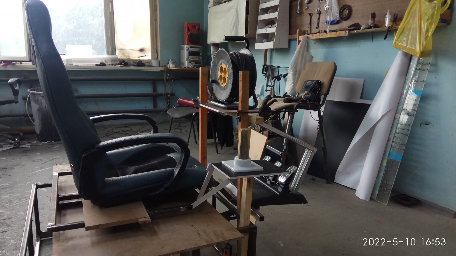

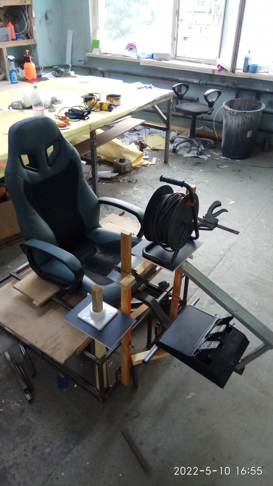

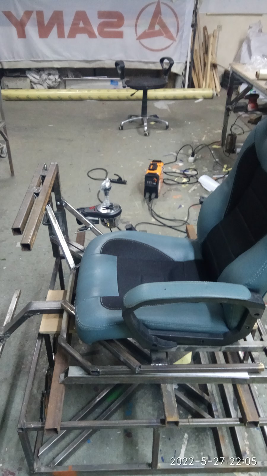

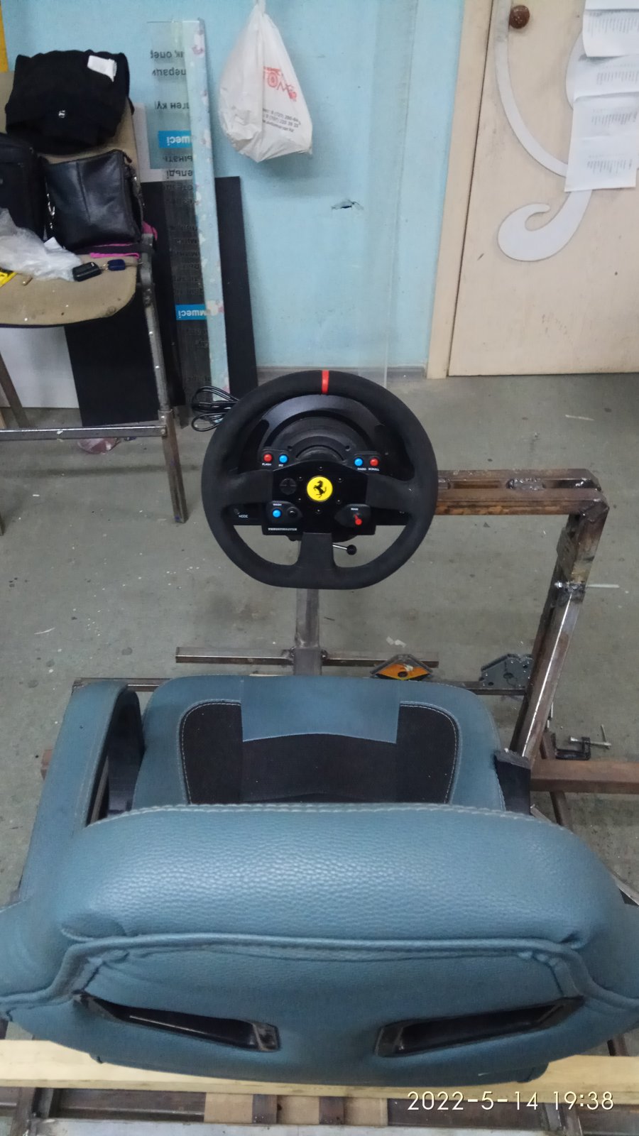

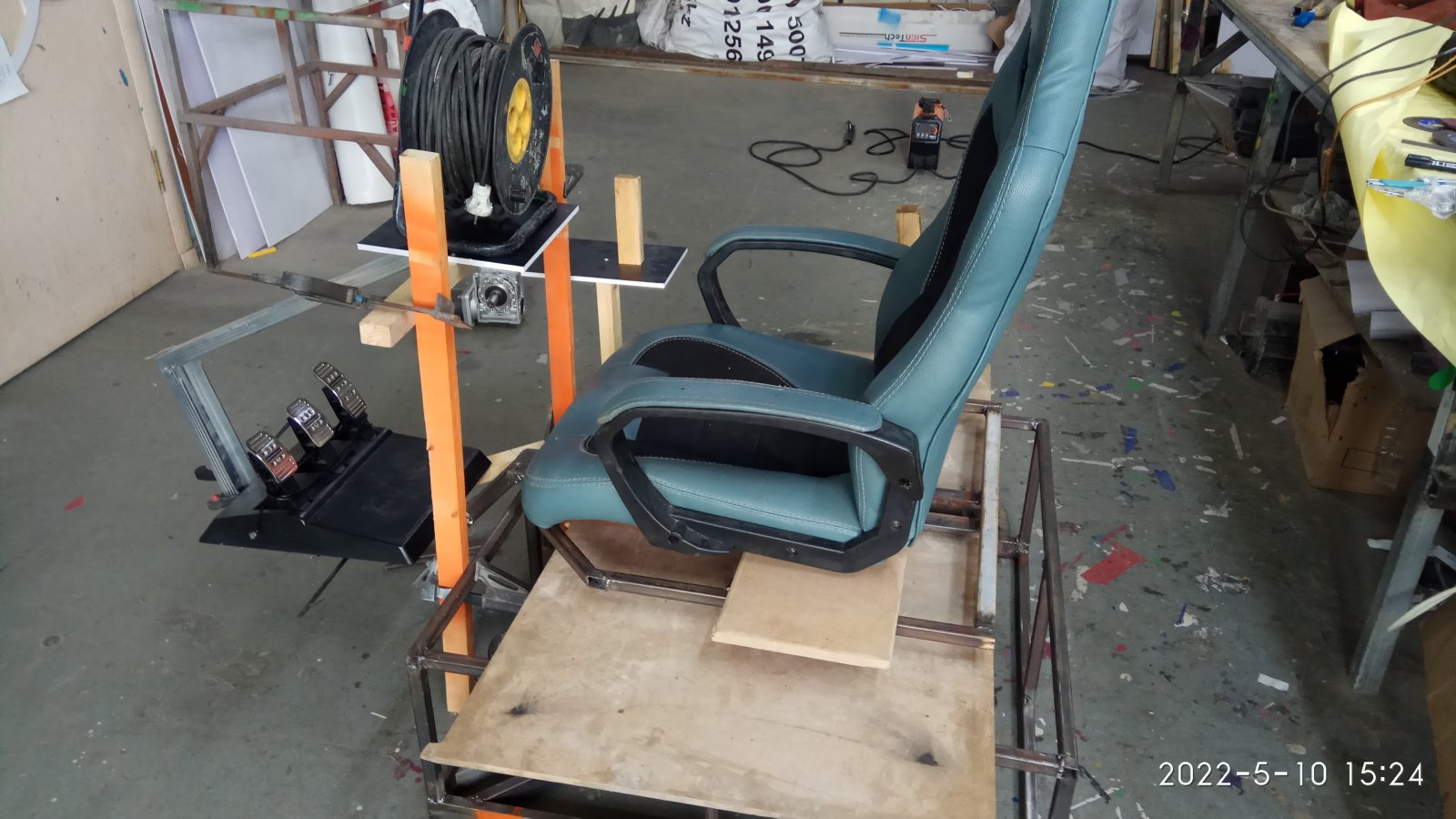

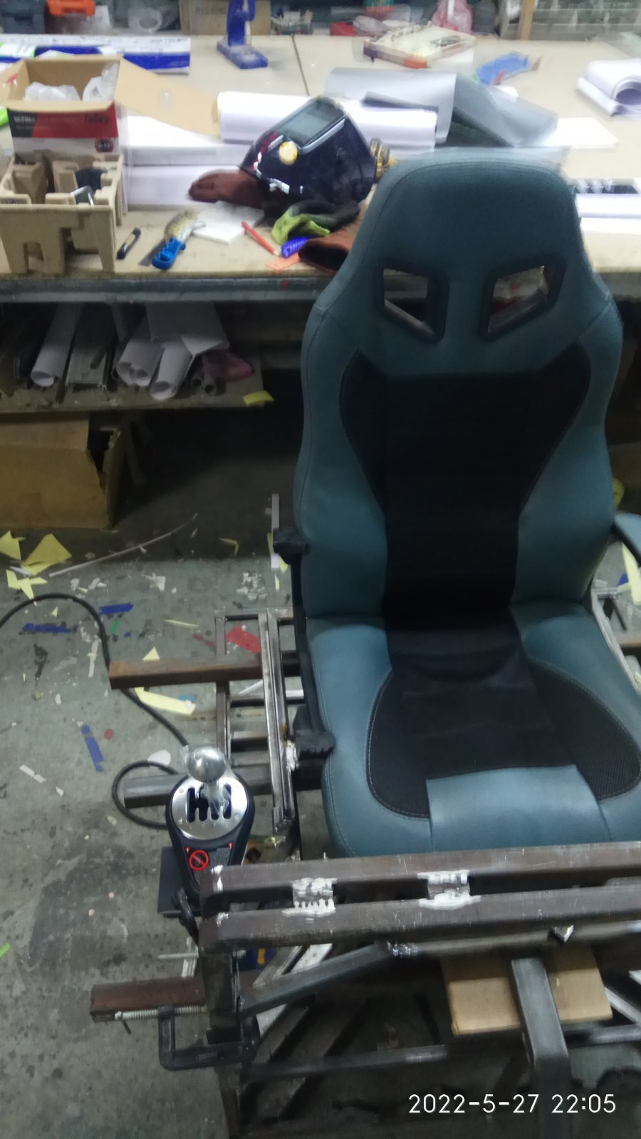

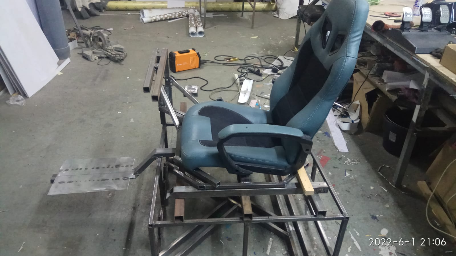

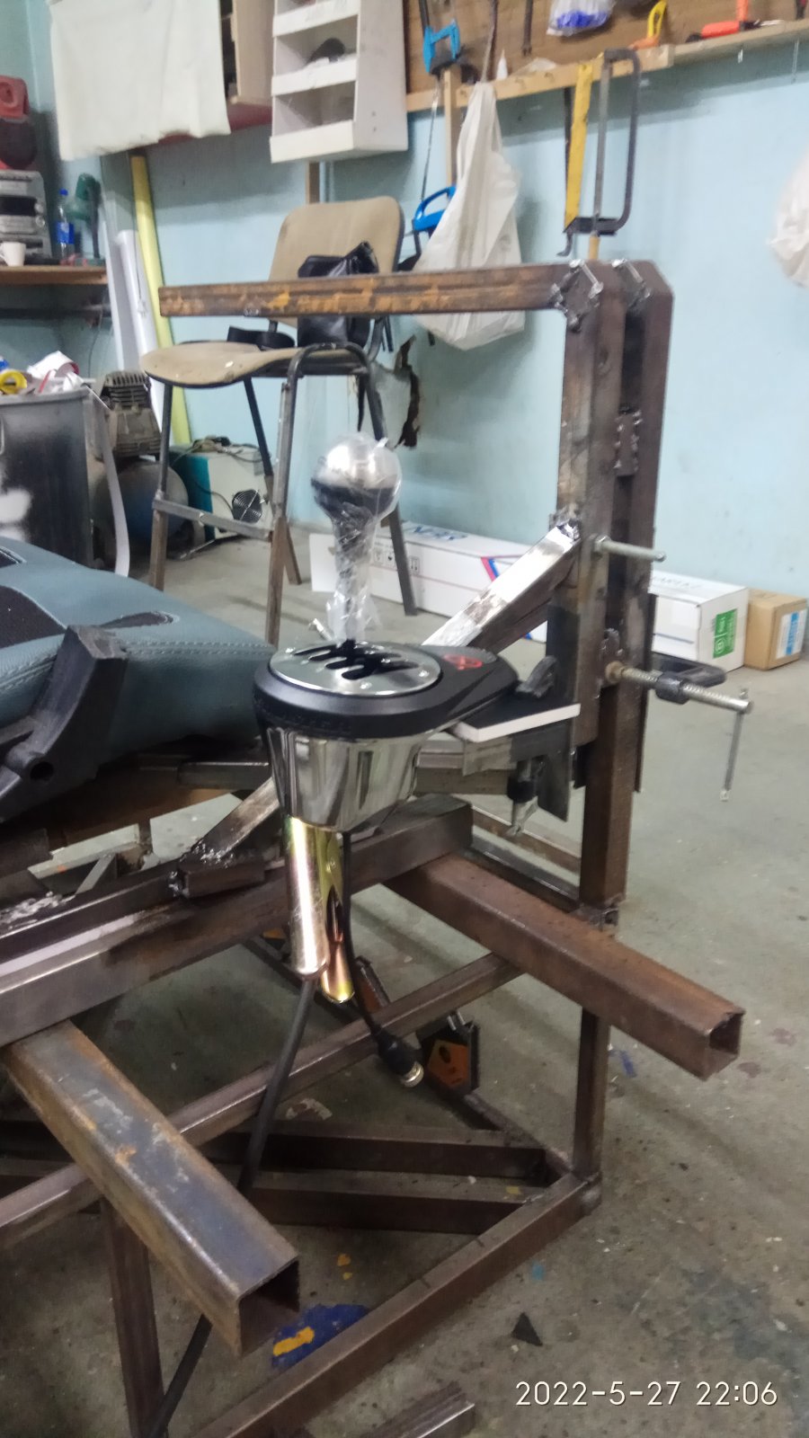

    Fifth day.

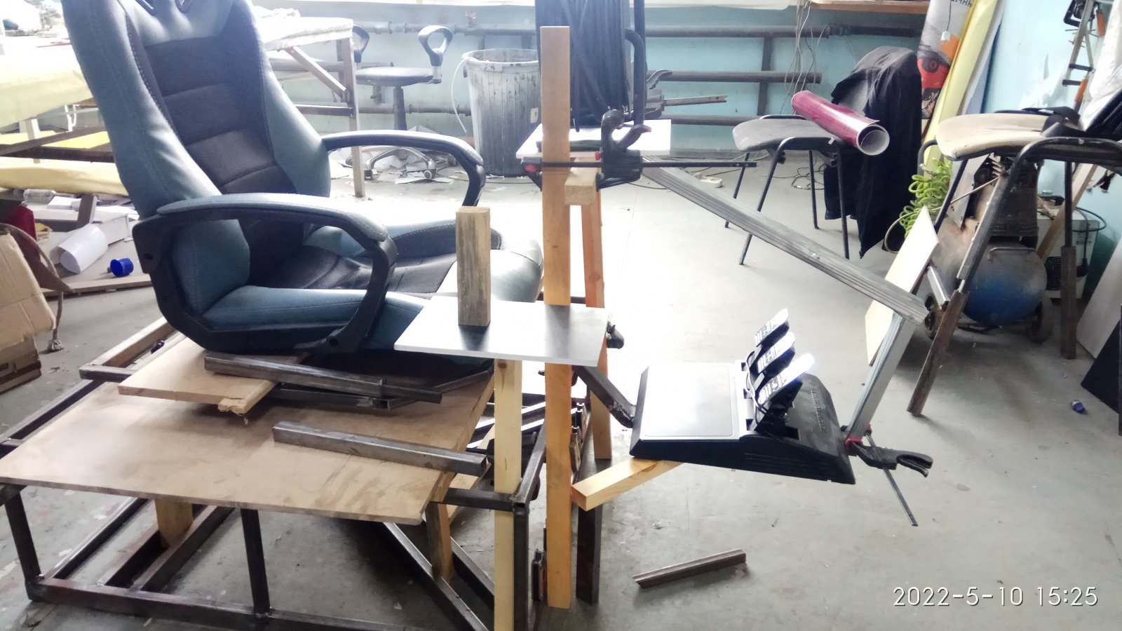

    I brought in a pedal, an office chair, for fitting without a cross.
    I assembled an approximate wooden frame, used an extension coil as a steering wheel))

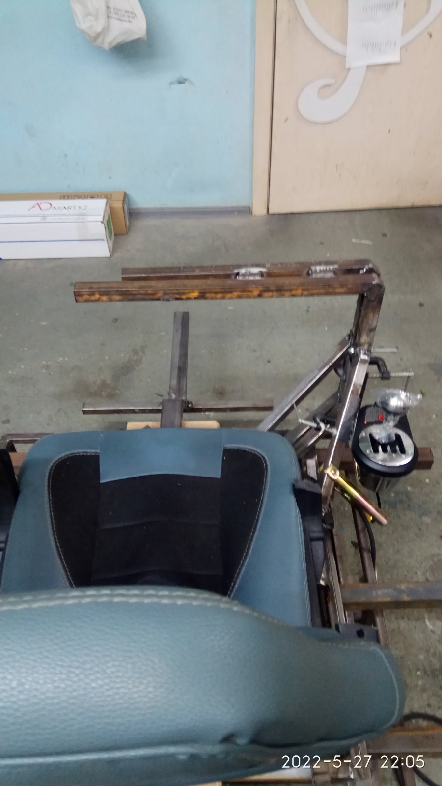

  7. kalbasator
    Dec 28, 2021
    110
    Kazahstan, Almaty
    170Coins
    +39 / 0 / -0

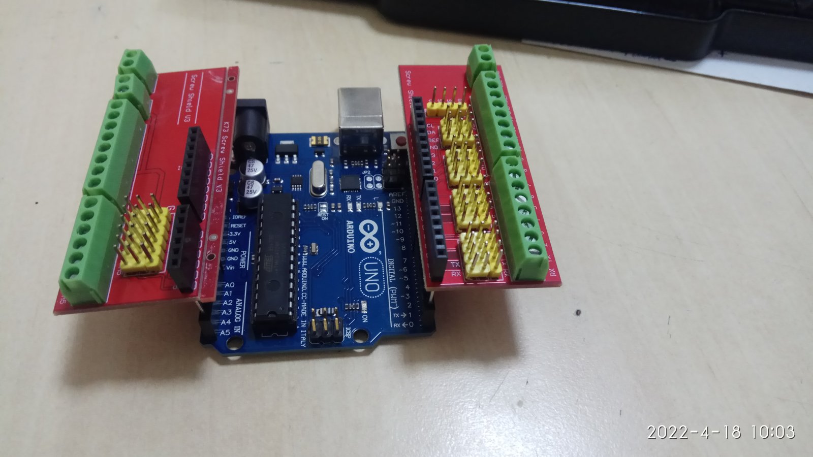

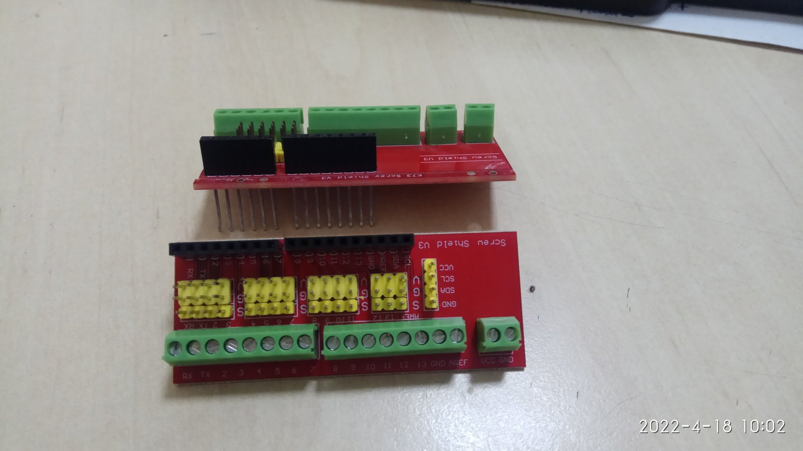

    For ease of connection, I will probably use shields:
      File size:
      162.2 KB
      Views:
      362
      File size:
      136.4 KB
      Views:
      338

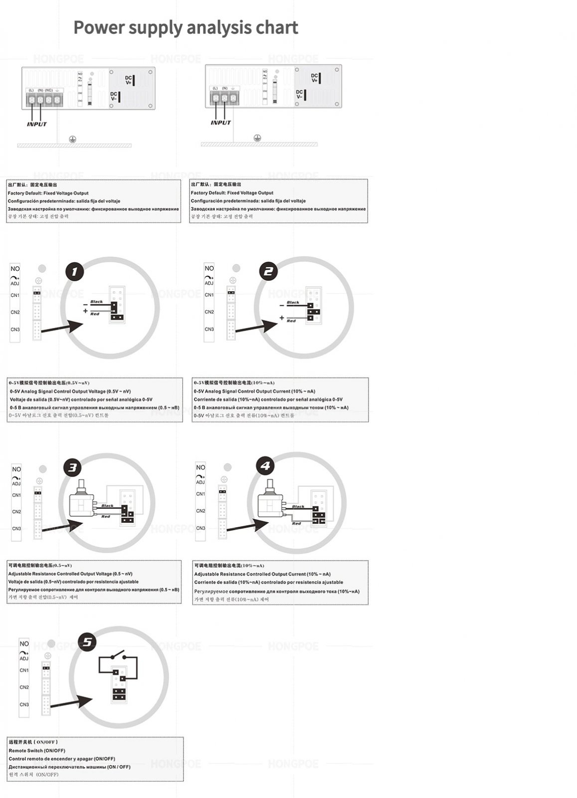

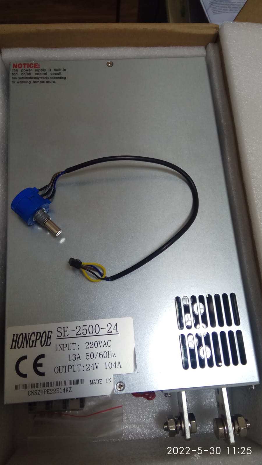

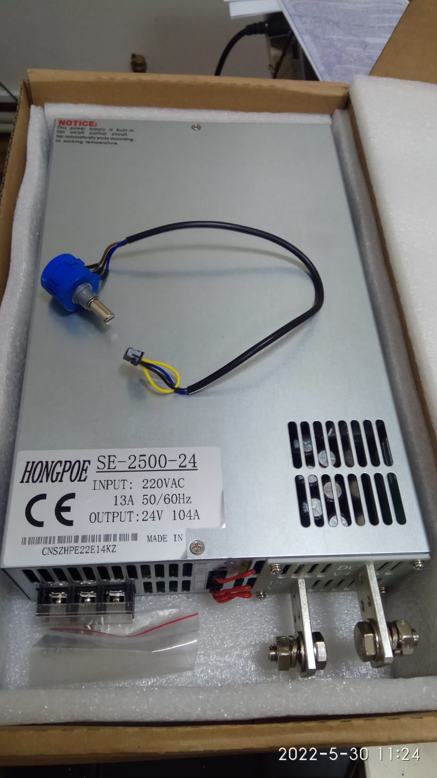

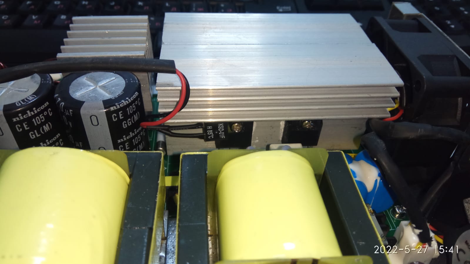

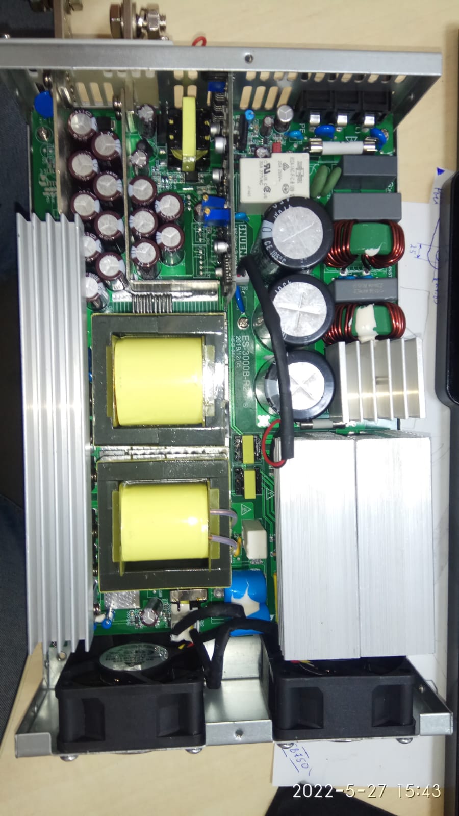

    The power supply has arrived, I think it's enough for 4 motors. I connected it to check without load, the fans are very noisy. I think how to reduce their noise.

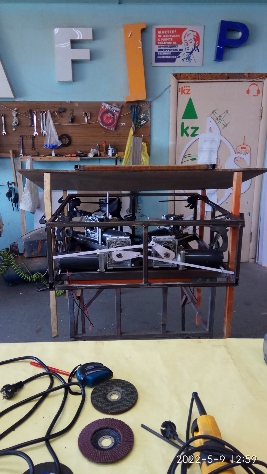

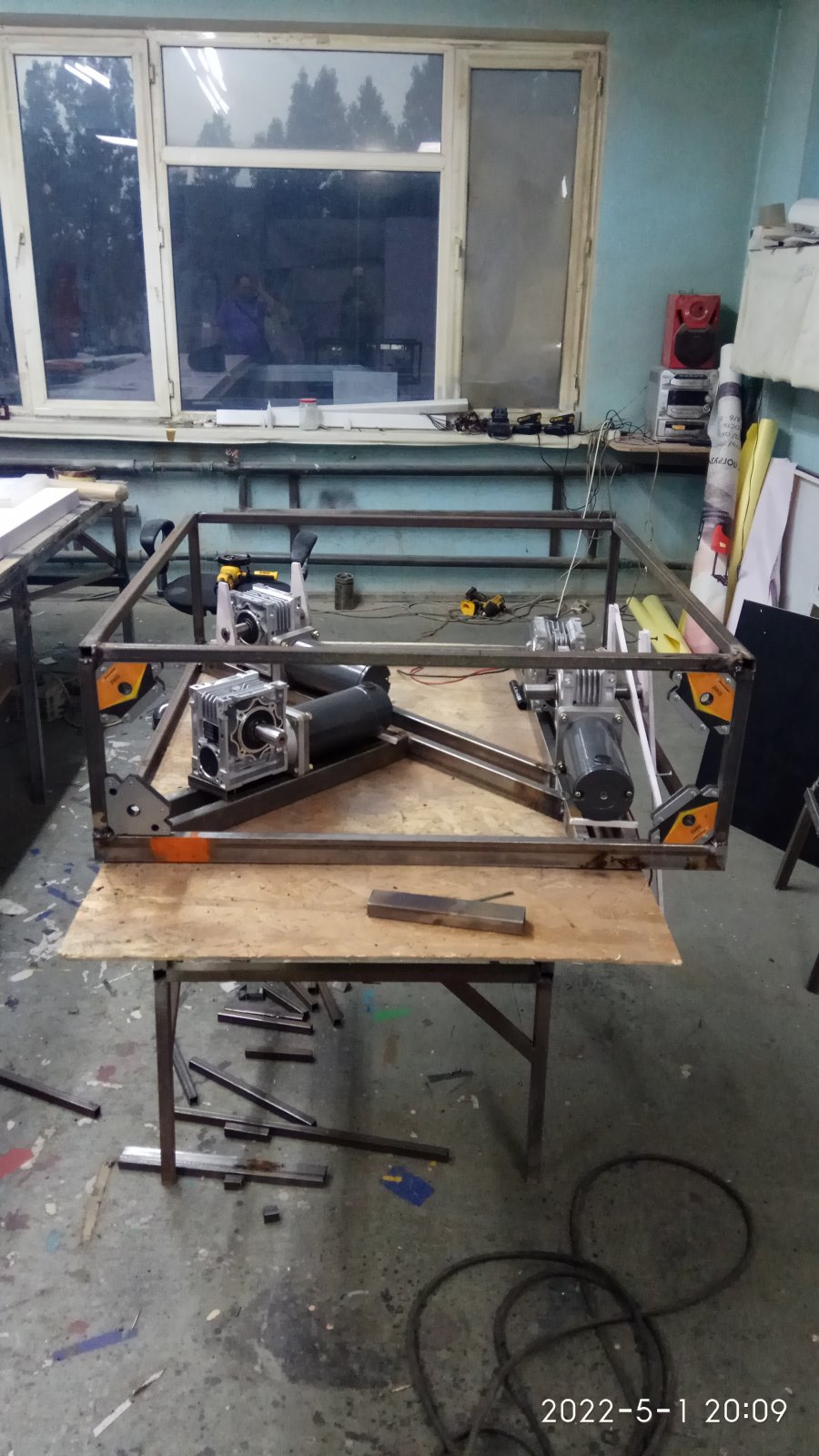

    The process of building the frame is going slowly but surely.

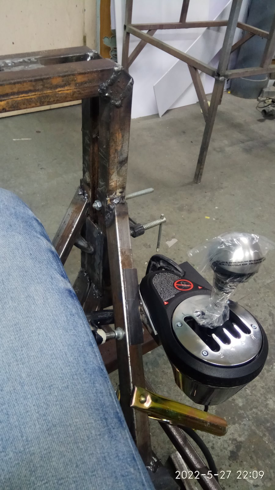

    Made a pull lever so to speak
  12. kalbasator
    Dec 28, 2021
    110
    Kazahstan, Almaty

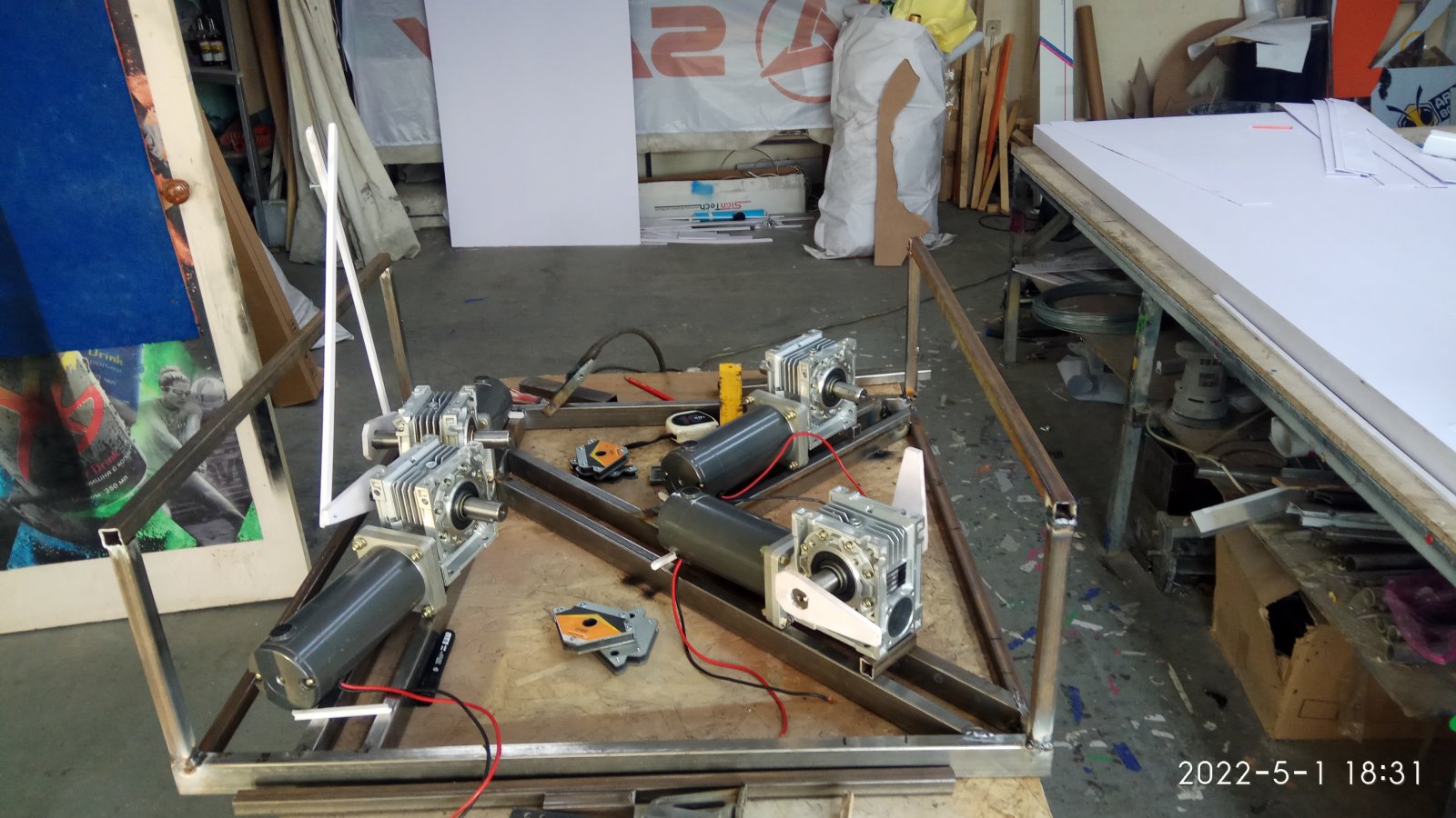

    170Coins
    +39 / 0 / -0
    Added pedal stand.

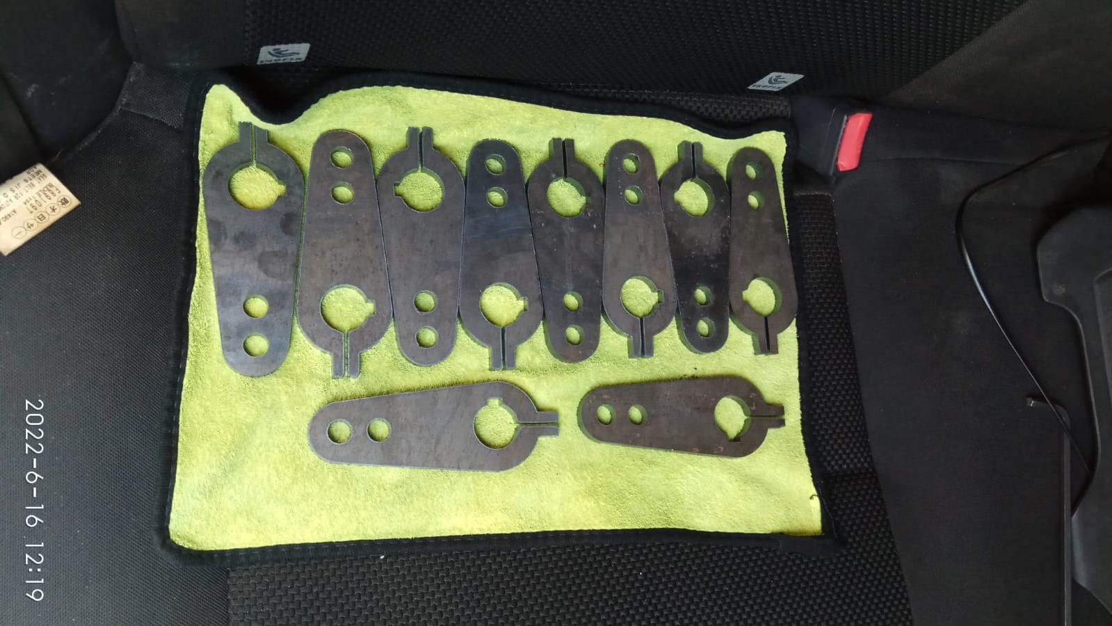

    I cut out Reactive levers on a laser CNC, they will be combined - two into one (this is if there is not enough rigidity). Metal used 8mm.

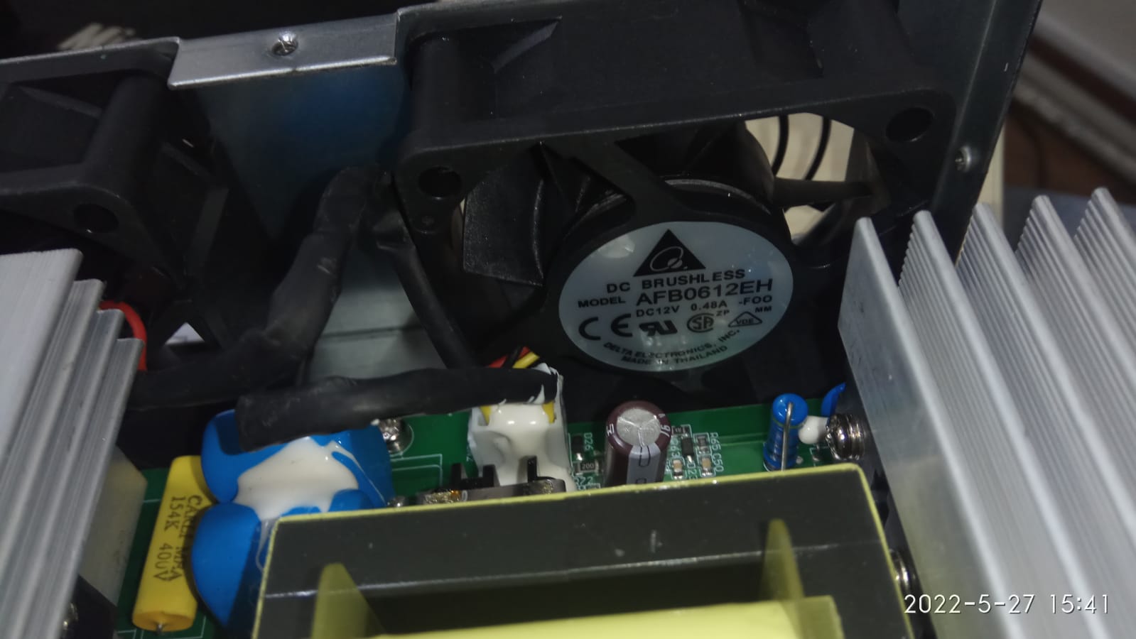

  14. SaintFrank
    SaintFrank Active Member
    Aug 14, 2021
    100
    Proces operator
    Nederland
    232Coins
    +39 / 0 / -0
    2DOF, 3DOF, DC motor, Arduino
    I got the same problem with my PSU (meanwell rsp-500-24) .
    If you have fighter jet simulator they are perfect :grin
    I managed to get my hands on second hand meanwell DRP-480-24 that is fanless.
    maybe there is a larger version of that series second hand available.
    Or https://www.meanwell-web.com/nl-nl/meanwell-uhp-2500/
    But these are very expensive and harder to get second hand.
    NIce solid build:thumbs , will follow your build thread.
  15. kalbasator
    Dec 28, 2021
    110
    Kazahstan, Almaty
    170Coins
    +39 / 0 / -0

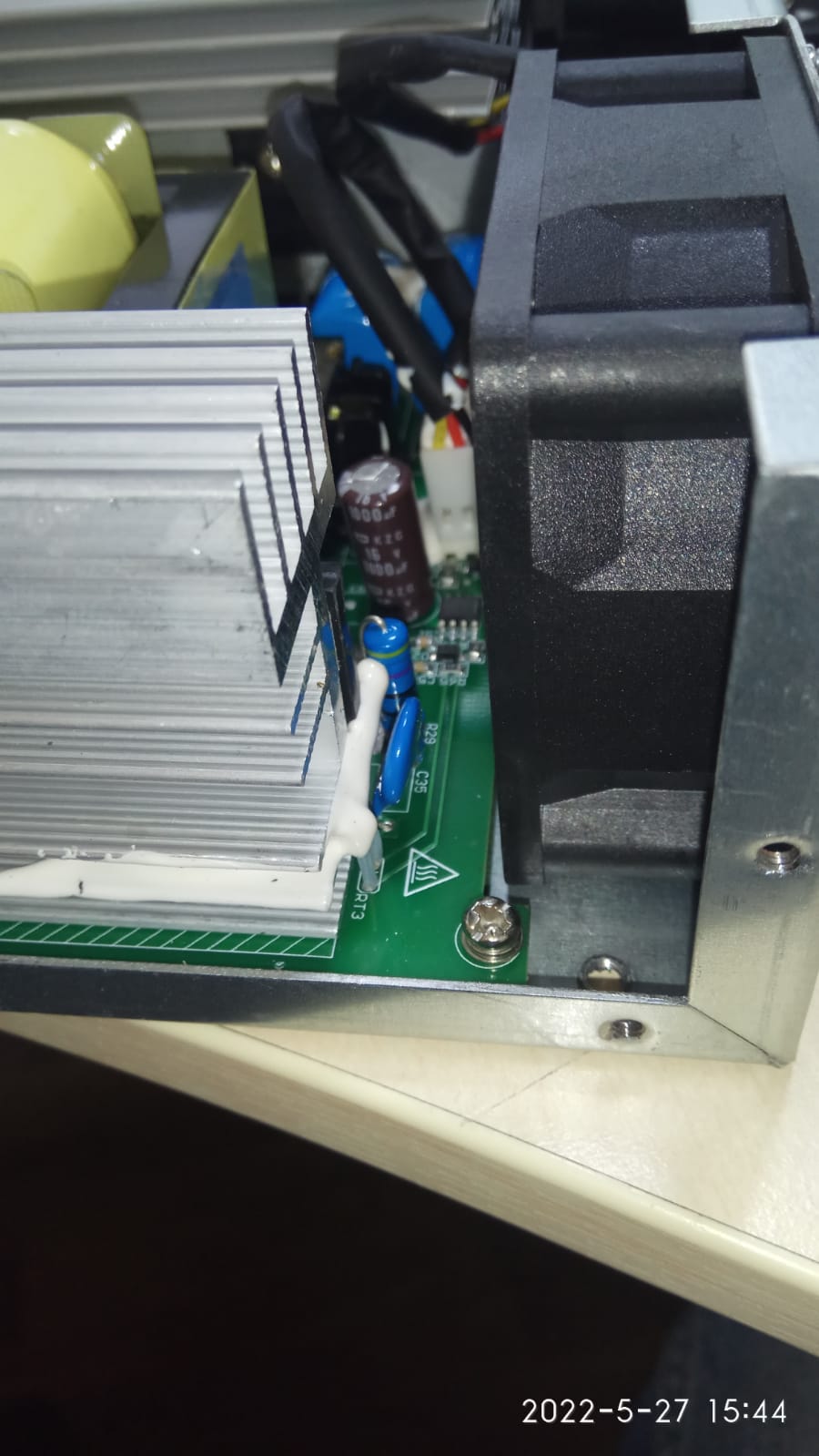

    Hello! It's very nice that someone liked my Frankenstein`s monster :grin.
    Regarding the loud fans on the power supply, even without load - I'm still looking for information on how to reduce noise without losing performance.
    If I find something I'll post it here or in a new thread.
    I disassembled the power supply there is a temperature sensor (KSD - 01F H 85C) at 85 degrees. The temperature of the components is clearly not 85 degrees.
    Then why do the coolers keep such speed?

    Power supply inside
    There is an idea to change the coolers to less resourceful, but not the fact that this will help reduce noise.
  17. SaintFrank
    Aug 14, 2021
    100
    Proces operator
    Nederland
    232Coins
    +39 / 0 / -0
    I tried to reduce noise by controlling the speed of the fans with a potentiometer.
    that didn't work on my meanwell psu .
    Power was cut off as soon as i put load on the DC side.
    But I'm no electrician, so maybe it is possible.
    Or maybe you could change the fan for noctua fan , they are very quiet .
    something like https://noctua.at/en/nf-a4x20-pwm
  18. kalbasator
    Dec 28, 2021
    110
    Kazahstan, Almaty
    170Coins
    +39 / 0 / -0
    Thanks for the noctua cooling fan recommendation, but I don't think that will fix things.
    Since most likely the manufacturer somehow supplies a certain voltage to achieve those revolutions that are currently available, and when a certain temperature is reached, the temperature sensor indicated by me will give a signal for an even greater increase in voltage. What will make the fan spin even faster
