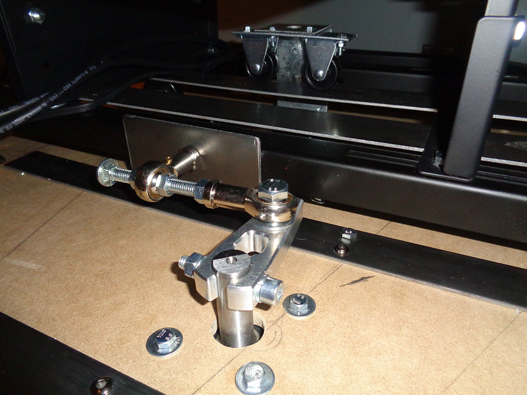

    I've finally got the traction loss and yaw system completed. It's been quite a challenge in term of design. Here is a little video of the first tests :
    I still need to optimize some aspects to smooth out the general behaviors of the structure but in general I am very satisfied. The yaw mechanism is very accurate. Dirt Rally and Assetto Corsa are now a whole other story with this new axis. How immersive!

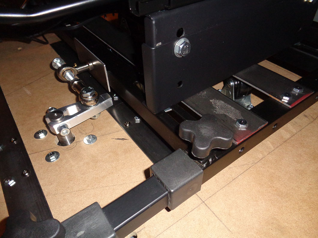

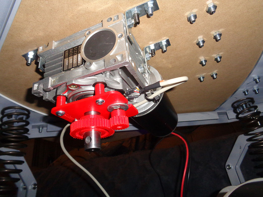

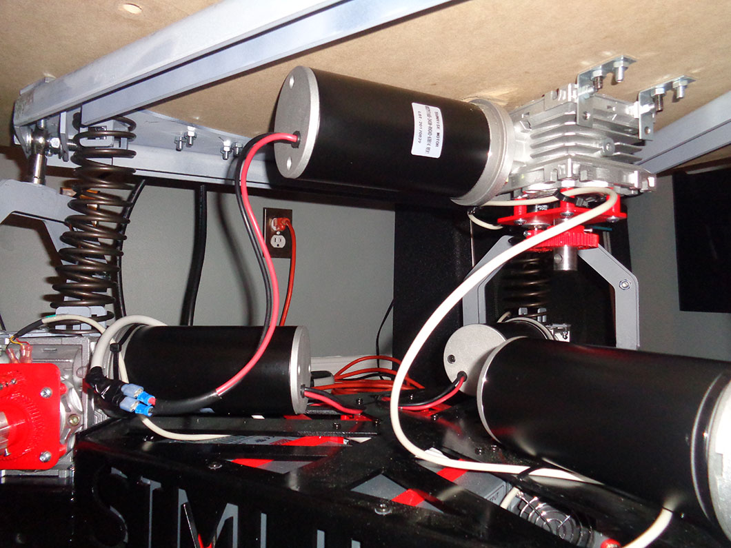

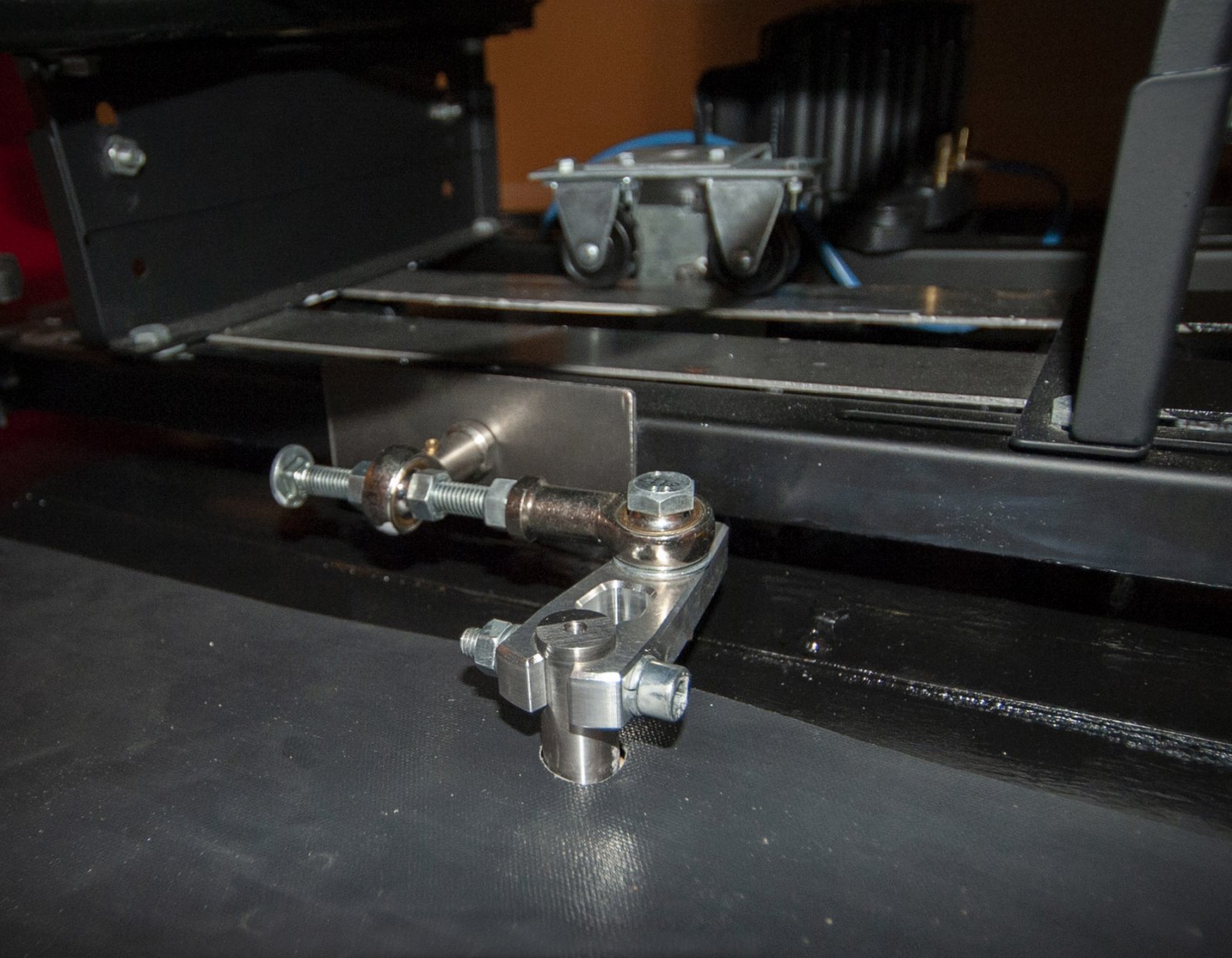

    Stargazer,
    Just to give you an idea, my room is 8x8 feet and my whole sim requires a free ground of 5x3 feet to allow for 4-dof motion, which is not that much, considering the fairly large size of my build. I still have several feet of free floor around the sim that I can use for a couch and home cinema furniture. When sitting in the playseat I'm 6.5 feet away from my TV.
    Below you will find pictures of the traction-loss setup. I don' have drawings nor schematics but the pictures will show you the main components. Aside from the motor+servo+wires that I ordered from Simukit everything could be found in a home hardware store: 90-pound wheels (*4), 20-pound wheels (*2), steel stripes for support, screws/nuts/bolts, wood, etc. The project is completed at 95%, and is fully working. The last step is to sand and paint the playseat's mdf floor-plate, add a steel sheet underneath the pivot point so it doesn't friction against the wood part in order to protect the wood and avoid squealing noises. And also add a strong nylon skirt around the motor base to hide everything and keep the kids little fingers from venturing in. My summer vacation plan!

    Hi jjanu,
    I just ordered an kit '3 dof 400w' and a kit sk3. To be able to do add the yaw system like yours , then I also need to order the 120w motor, correct?
    I am thinking of building the 3dof platform first. If it works then I will add the yaw system at a later time. By then may be I can gain enough experience to source the correct motor and hardware to add the yaw motion.
    I look at your cockpit and I am not sure where did you buy it from? You must have mounted it in such a way that it is free to move by the yaw motor, right? How did you provide the pivot for it? On ebay I saw a two sim cockpits 1. "Volair Sim Universal Flight or Racing Simulator Cockpit" (~$800) , 2. "GTR Simulator GTSF Model Racing Simulator Cockpit works w/ Thrusmaster T300 RS" ($440.99) and I don't know which one will fit better with the platform.
    My room is 12' x 10' x 7.3'. I guess my worry is the height 7.3', would that fit the sim that you have built?
    Thanks again for the info, it is really helpful for me.

    Hi Stargazer,
    When I ordered my SK3 kit I asked Simukit to add a fourth 400w motor to the package for the traction-loss+extra servo hardware (4th potentiometer, mount, etc). Send them an email that you want to add traction loss to your build and that you need to add a 4th motor to your order. I strongly suggest the 400w instead of the 120w in order to get better yaw response and torque. My cockpit is quite heavy and I wanted a motor that could sustain a fast reaction time and demand overtime.
    Your room height is fine. My whole sim is 5 feet tall from pleaseat head to SK3 base. You will at least have a headroom of 2 feet in seating position. My cockpit is a GTOmega and I strongly recommend it. It is really well made, robust and not as expensive as the other variants on the market. It is on the heavy side but the Sk3 400w can lift it--plus my own 180 pound--without any trouble.
    I need to go but I'll come back to you with more details soon. I suggest that you first send an email to Simukit to have them add the fourth motor to your initial order so you dont' have to pay for a second shipment.

    I am still unable to visualize how your yaw/traction loss system work after looking at the pictures. I mean where do you pivot your cockpit? Do you put it on a lazy suzan or something so that you can use the motor and shaft to move it around? For it to work, did you have to drill any hole into the frame? etc.

    Stargazer,
    My GTOmega is the ART version (https://usa.gtomegaracing.com/art-r...t-omega-art-racing-simulator-cockpit-rs6-seat). It weights about 100lbs and cost 400US, Very inexpensive while being one of the most robust option on the market. It doesn't wiggle nor twist. That's why it's heavy but for a sim equipped with traction-loss, sturdiness is essential.
    I indeed needed to drill into the frame for the pivot point and other mount points. But with a good quality drill the structure is really easy to mod. I'll make a sketch of the assembly over the weekend for you. Stay tuned.

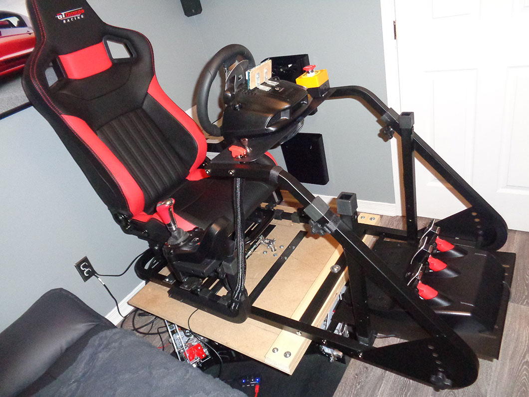

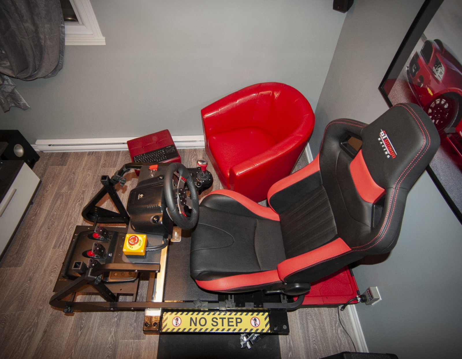

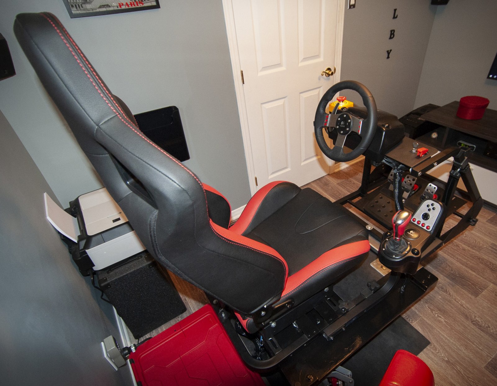

    Hi @momoclic

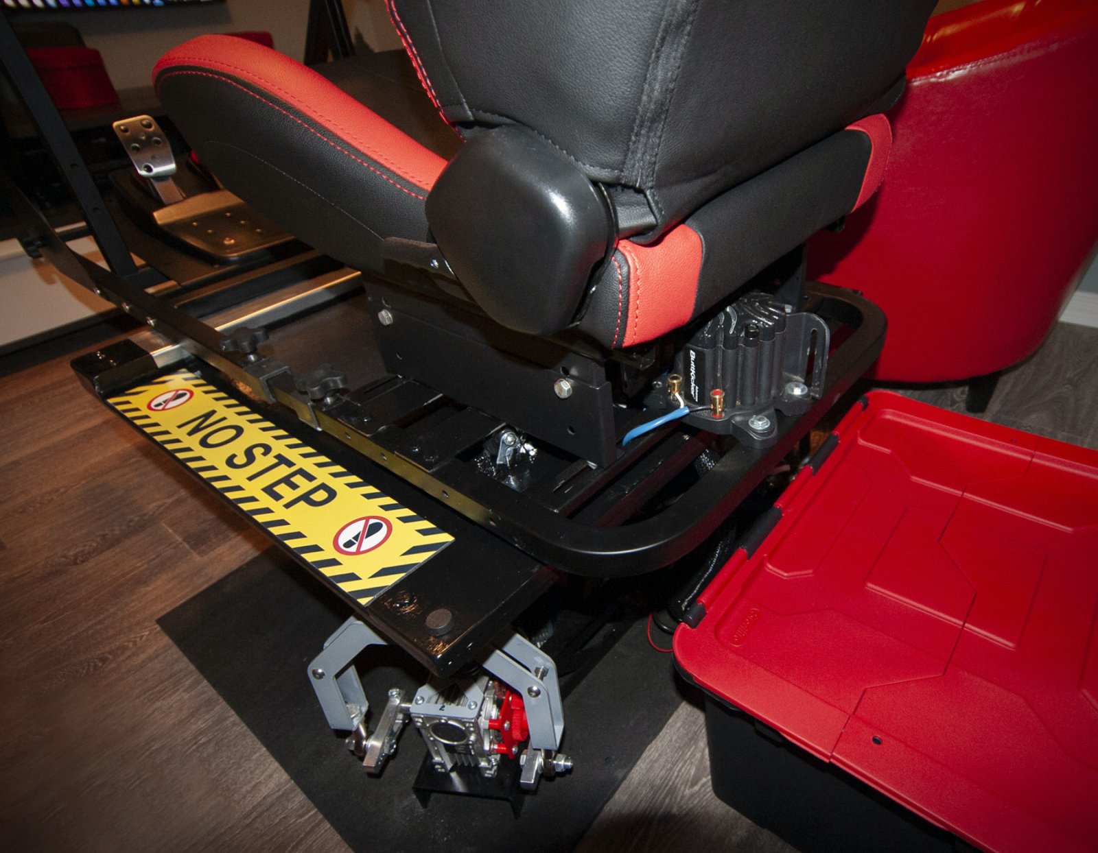

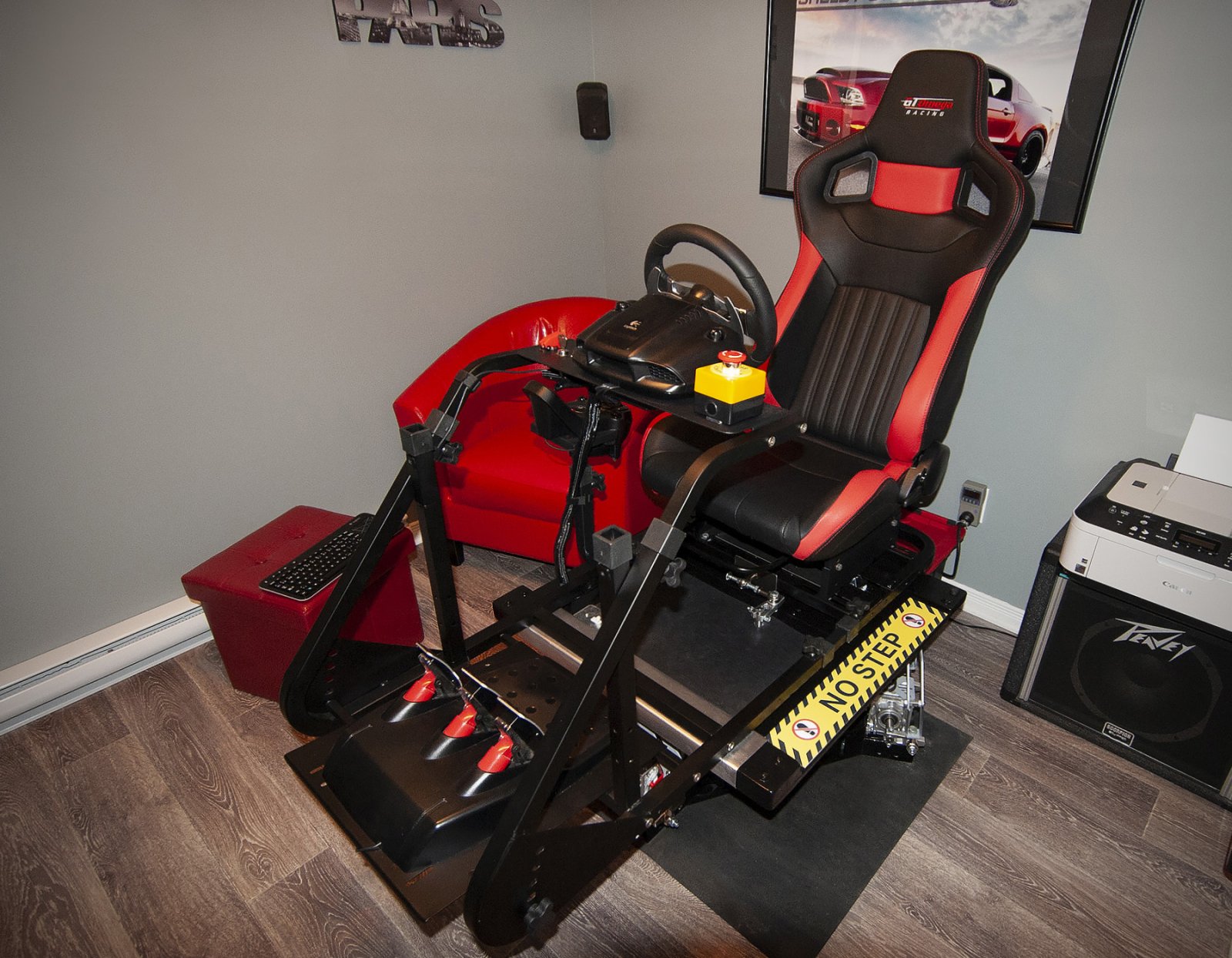

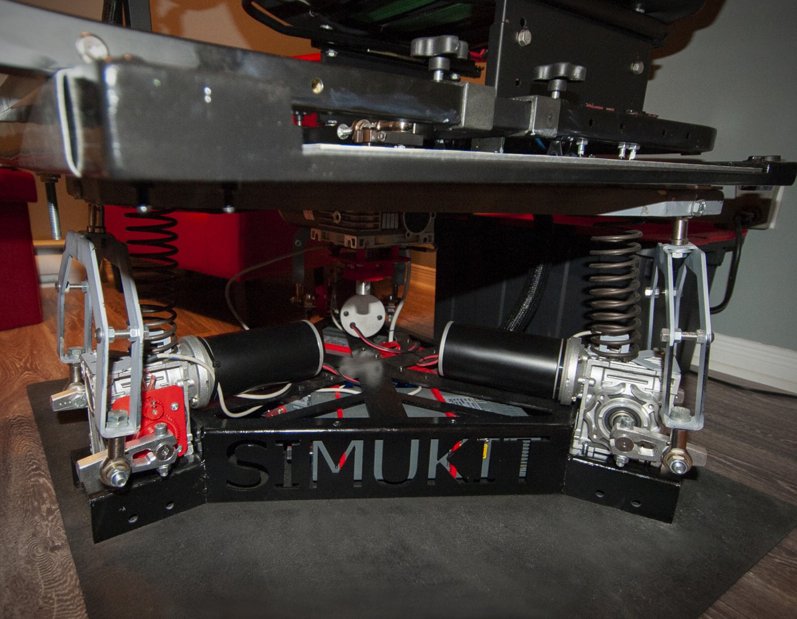

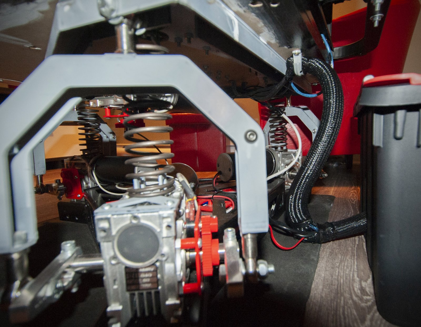

    Sorry for not coming back sooner on your latest comment. It was a crazy summer and I had to leave my sim project on ice for a while. I finalized the latest tweaks to the built recently and came up with some pictures.
    Details: 1-Black paint job on the main platform; 2-Installation of my old buttkicker to the seat structure; 3-Cosmetic improvements; 4-Better cable management; 5-New room configuration.
    Edit: I replaced the pictures with better quality ones.
    DSC_2542.jpg DSC_2546.jpg DSC_2548.jpg DSC_2549.jpg DSC_2556.jpg DSC_2559.jpg DSC_2563.jpg DSC_2568.jpg DSC_2569.jpg DSC_2572.jpg

    Next steps when the time allows:
    1-Publish a final video;
    2-Share game settings with the community;
    3-Install a hotas joystick setup on the seat platform for flight and space sims, and car handbrake (probably the Thrustmaster T16000m);
    4-Oculus hand controller mounting installation on the seat platform to allow for vr motion cancellation.

    love your cable management @jjanu. It is so clean I dont see much of a wire at all. I am looking forward to your video and setting. I am still in the process of tuning and it will be good to have yours as a reference. how do you plan to attach the flight stick and throttle for your planes?

    Thanks @stargazer
    For the hotas I'm planning to use L-shape steel plates screwed onto each side of the seat base. This way it wont be too invasive with regard to the actual design and the controllers will be well within reach. In the end it should look pretty similar to what you did with your joystick setup. Will keep you posted :)
