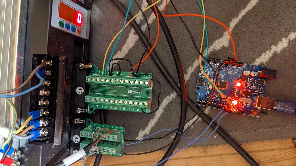

    Hi ! I am trying to use a AASD driver with an arduino Uno, and I can't rotate the motor (the test though FN002 works). The code is simple, I repeat :
    digitalWrite(StepPin1, HIGH);
    delay(10);
    digitalWrite(StepPin1, LOW);
    delay(10);
    The wiring is the following
    DB connector :
    3 pulse
    4 dir
    5, 6, 10, 14 GND
    9 5V
    And it doesn't move at all... Any idea @cubexxx ?
    By the way I used your idea about inverting the linear bearing for my SRT100 actuators (stepper based actuators), great idea !
    Without touching the motor, I have :
    SigOUT1 (Servo ready) =0
    SigOUT2 (Alarm detection) =0
    SigOUT3 (Positioningcomplete)=0
    SigOUT4 (Zero spee)=1
    When I turn the shaft, sigout3=1.
    Is it normal ?
  12. cubexxx
    cubexxx Member
    Oct 4, 2019
    69
    557Coins
    +41 / 0 / -0
    3DOF, AC motor, Arduino, 4DOF
    Code looks ok. Maybe something wrong with the "enable"? You can set it to be permanently "on" with aasd param Pn003. And while the "digitalWrite/delay" approach should work in principle, it's not very suited for good motion because these methods are too slow and don't have timing that is exact enough, that's why I used timers and registers to set the output pins directly. Bet these are dependent on the type of arduino, so different for uno and mega.

    thanks a lot for your reply ! I checked PN003, it is on 1. When I try Jog0, it shows error when I press the button...
    Yes I just used digitalWrite to have a very basic code. For the SRT100, I am using the port manipulation, it is already far better.
    I rode your code a little bit, and it is far more advance than mine. I don't know if it does a difference in the end, I must study it.
    If you want to take a look at mine.
    I mounted the seat mover today with a stepper motor. It works but the motor itself isn't suited... I have to debug the servo :/
    EDIT : with PN003 at 0, JOG0 works.
    EDIT : it seems to work !
