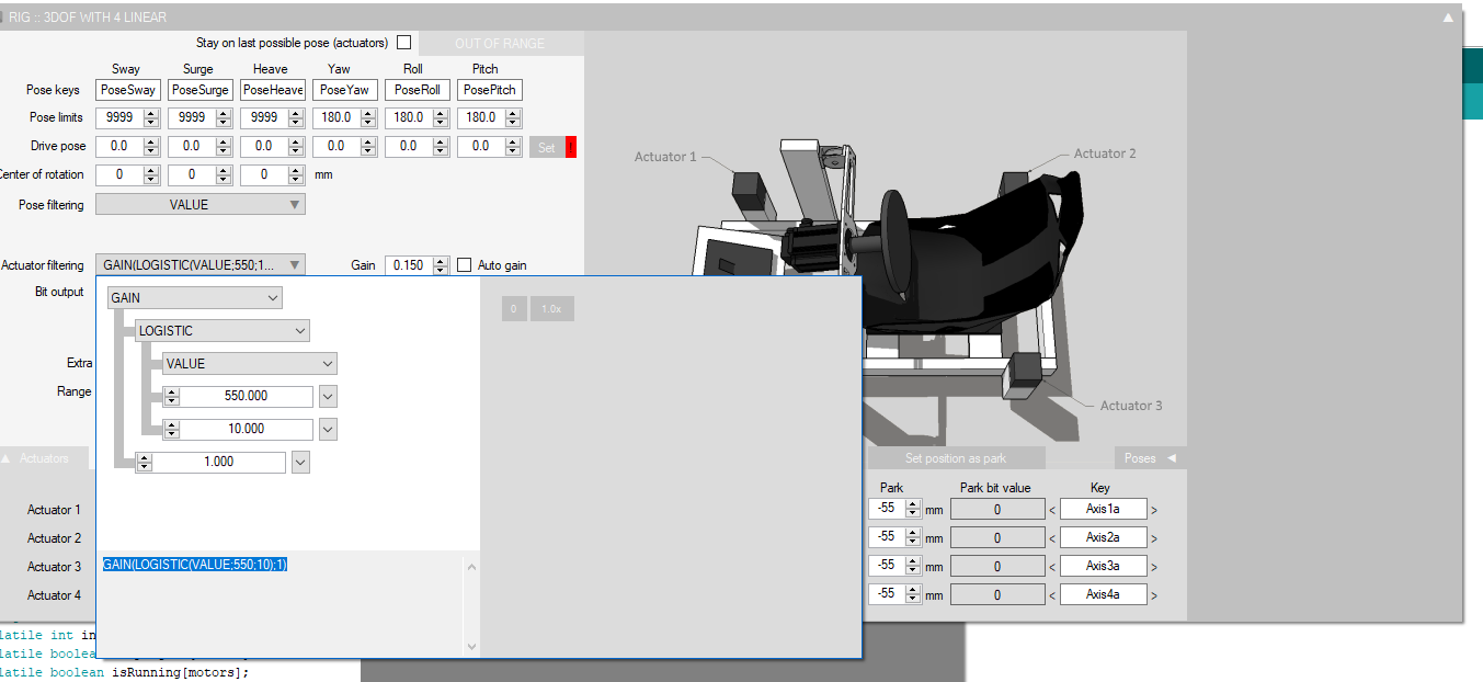

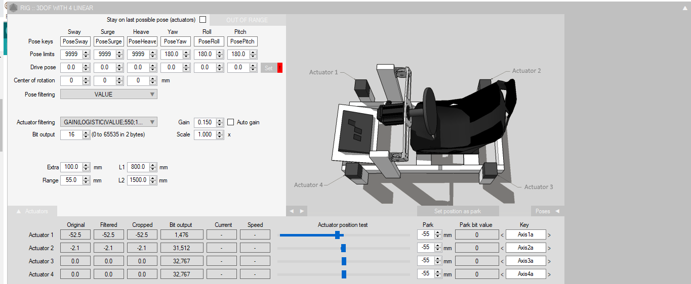

    I need to adjust so i get 150mm throw. Do i just do that in the Mover rig gain settings or do i need to modify the sketch? How does these values end up being 0 32 65?
    In relation to that i have an issue too. I get a Gain(logististic/value;550;10);1) There's missing a 0 from your picture. It dont feel at all correct for me. Should it move that much with so little movement of the position test? If i keep the gain/log to 550 and just 1 on gains they move normally with no extra gain
    If you wouldnt mind briefly explaining how things relate id be most grateful.

    Not sure what you mean by latency? I use 2ms calculation time in mover, the aasd drivers themselves have a bigger latency than that. As soon as the data is received from mover output of pulses starts.
    For the pins I have no picture, in the code there are comments which pins are used:
    // pulse 0
    const byte ocr1bPin = 12;
    // pulse 1
    const byte ocr3bPin = 2;
    // pulse 2
    const byte ocr4bPin = 7;
    // pulse 3
    const byte ocr5bPin = 45;
    // direction
    const byte dir0 = 30;
    const byte dir1 = 31;
    const byte dir2 = 32;
    const byte dir3 = 33;
    So first pulse pin is 12, first direction pin is 30, etc
    Explanation for maxPos: These are the number of pulses needed for the maximum elongation. SFX-100 has about 110mm stroke, one rotation of the motor is 1000 pulses (encoder resolution / pn98 = 10000/10), one rotation is 5mm (pitch of ballscrew) so (110/5)*1000 = maxPos = 22000 pulses = 110mm. centerPos is just half of that.
    Now in mover I use 16bit = 65535 maximum. I divide by 3 (in the code "mapToRange" so that max input from mover is close to 22000 ~ 65535/3, that's just to be able to use the whole 16 bit range.
    That "Gain(logististic/value;550;10);1)" or whatever it was exactly was just a try to have a soft limit, you can use whatever you like there, has nothing to do with the controller code.
    Hope things are clearer now

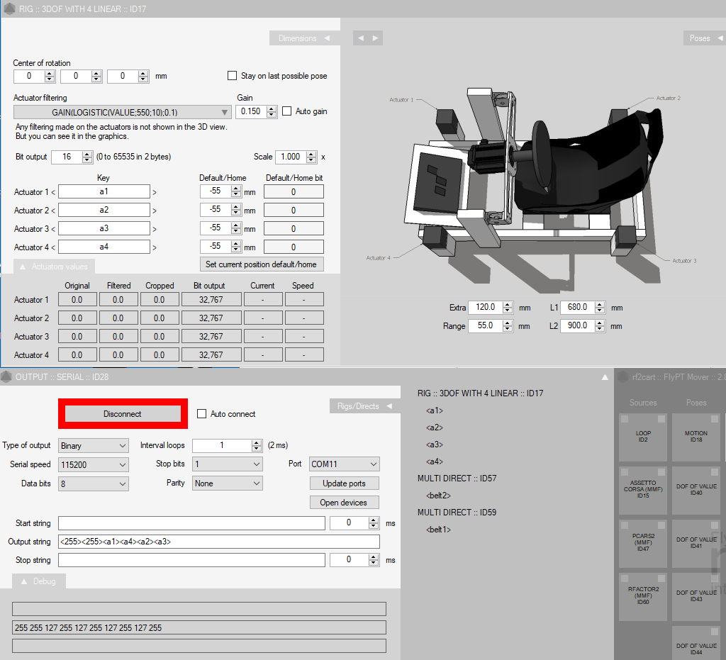

    I recently modified my sfx100 to 140mm stroke. The 140mm stroke needs 140 * 200 = 28000 pulses range, nearest bit value for mover is 15 bit = 32767. Now in the current version of mover (2.9.9) you have a "scale" value but that doesn't change the center, i.e. with 15 bit the output value for center will always be 16383.
    So I had to make a few adaptions the code:
    // for sfx140 with pn98 = 10 (pulse multiplier)
    const unsigned int minPos = 2383;
    const unsigned int centerPos = 16383;
    const unsigned int maxPos = 30383;
    in setup():
    for (int i = 0; i < motors; i++) {
    targetPos = minPos;
    currentPos = minPos;
    and
    unsigned int mapToRange(unsigned int pos) {
    unsigned int mappedPos = pos;
    if (mappedPos > maxPos) {
    return maxPos;
    if (mappedPos < minPos) {
    return minPos;
    return mappedPos;
    The scale value for mover is 28000/32768 = 0.854
