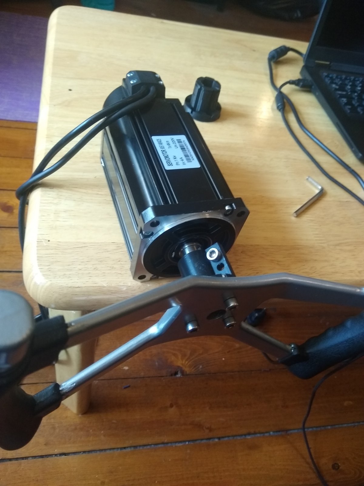

    My 90ST-4025 is getting shipped. Mega excited to try this! I'm planning to use a 3d printed pla shaft adapter to attach a wheel to the motor, should I be worried about material strength?

    My plan is a 3D printed shaft adapter, but I was thinking of going with petg because it's got a bit more give to it and the high-frequency bumps and shakes of the motor might eventually cause a cracking pla.
    It should be strong enough though, if you make it heavy duty enough in terms of plastic and don't over torque any nuts

    I used PETG and ABS for adapters for my 90st-04025 servo. I've broke ABS one because of not using clamp. PETG one seems to have some gap after 2 weeks of use. I think that it's better to use ABS for adapter because my servo shaft heats up to 60-70 Celsius degrees.

    Started making an adapter for my 40mm m6 bolt pattern gokart wheel.
    The 90ST has 16mm shaft diameter right?

    Ok so my stuff is here. But I realised I gave all my bar clamps away and I have nothing to bolt the motor onto..
    Gonna try to make a mount with my friend in our spare time the next couple of weeks.
    Motor feels quite strong i stupidly started jog testing it while holding in my hand and it almost jumped out of my grip :D
    I made a pla shaft collar, will see how long it takes for it to melt!

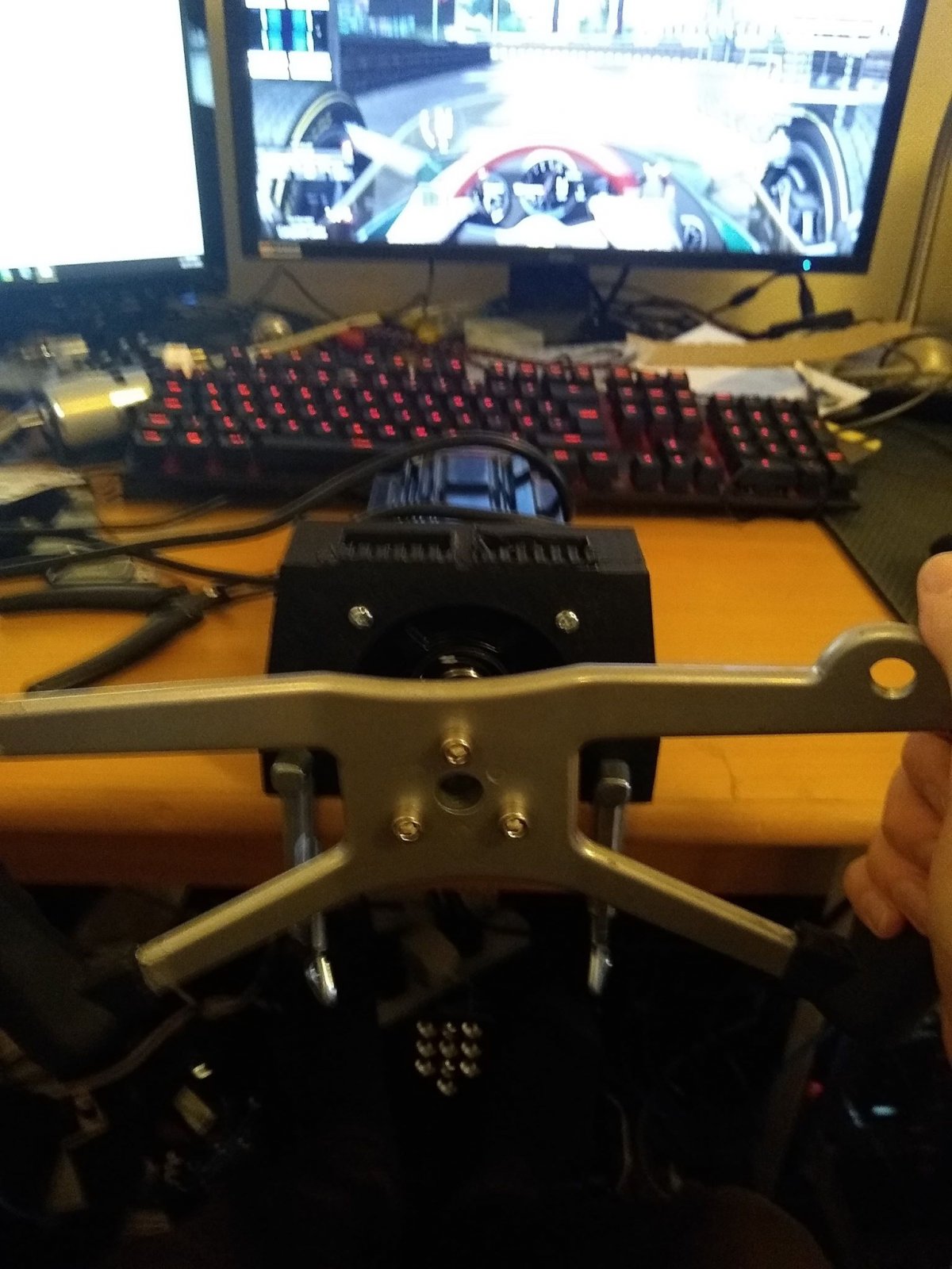

    Well, I moved the usb hub from the front panel to the rear and I no longer get usb issues seemingly.
    But I'm only running 15% force as I haven't got the desk clamp built yet!

    I ordered a sleeve adapter from 16mm to 19mm
    https://www.ebay.com/itm/5-8-to-3-4...er-Sleeve-Bushing-With-3-16-Key-/264601441495
    So I can use the Ascher racing servo clamping set + 70mm adapter I got...
    https://www.ascher-racing.com/shop/clamping-set/
    And perhaps add a quick release as well :
    https://www.ebay.com/itm/143634821596

    started designing a 3d printable bracket using some bessey tk6 clamps. will probably warp due to heat on higher ffb % but does the job for now and I will be adding a 120mm cpu fan.
