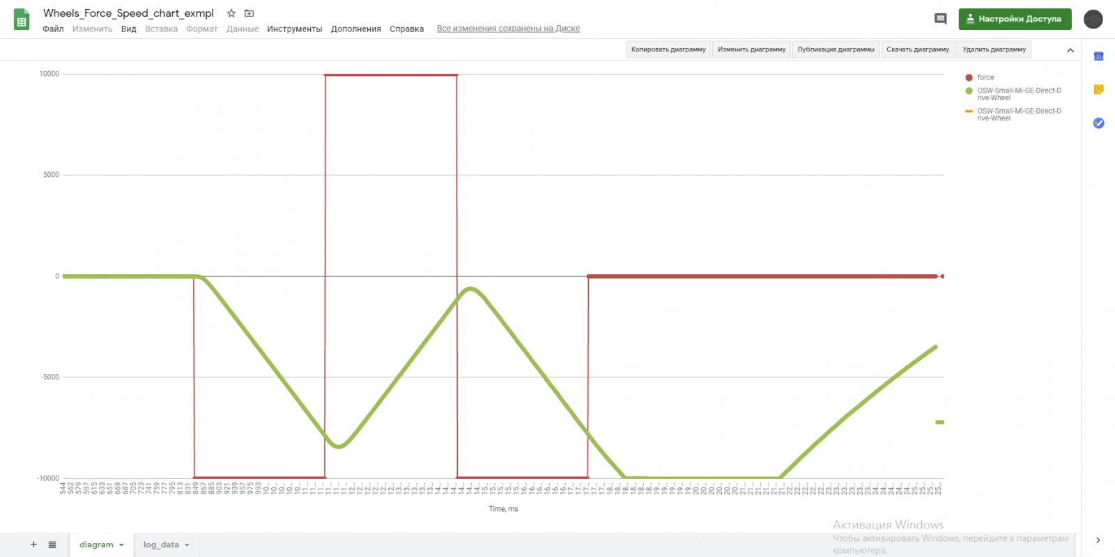

    The graphs data:
    And if you want to compare to OSW-Small-Mi-GE-Direct-Drive-Wheel from here
    The logs:
    https://www.dropbox.com/sh/n5mpw0qw6km2wg8/AAA9sqJHvl_Bg1rrqPTsKDsea
    Thanos, one of the suggestions just to try, to use a bit lighter wheel, but that's cool with this too. And give a try with EMC on arduino. It's kinda powerful then MMOS.

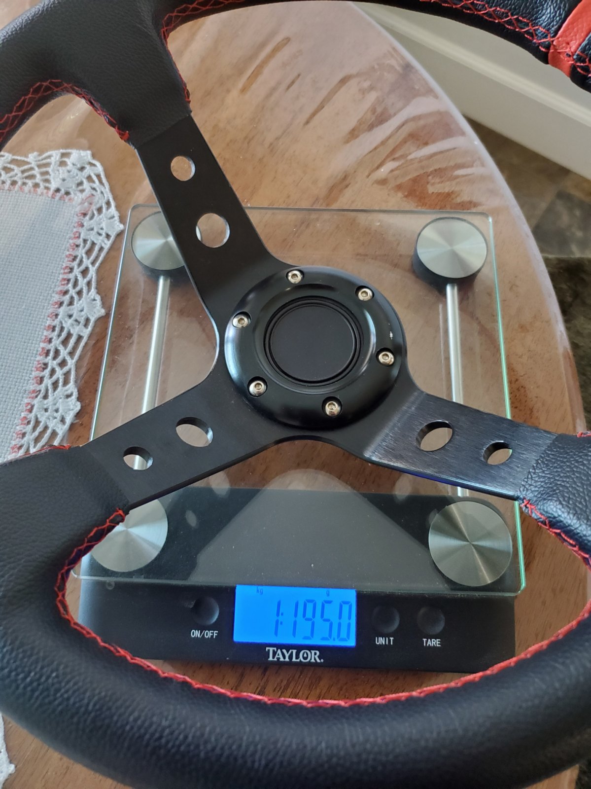

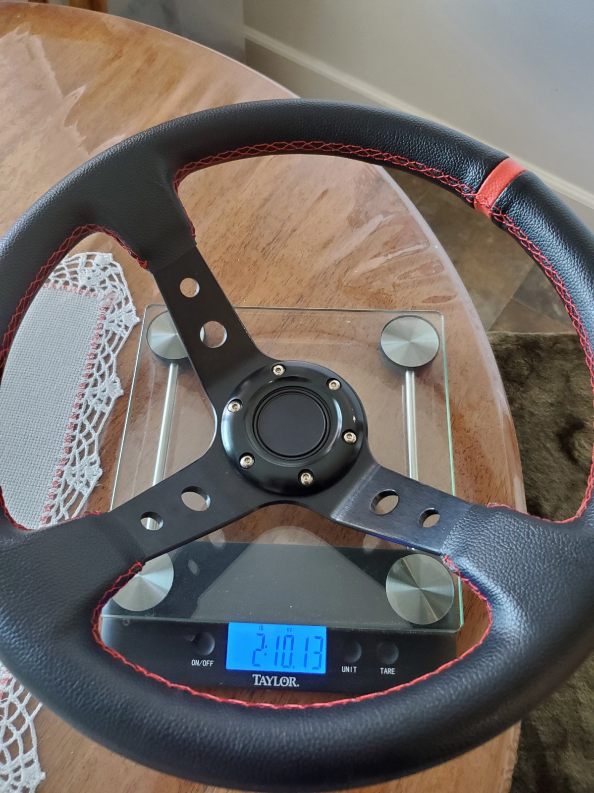

  13. Thanos
    Jul 6, 2017
    1,379
    Electronics Engineer
    United States
    2,917Coins
    +1,079 / 10 / -0
    2lbs and 10 ounce, or 1kg and 195grams...
    Feels heavy and solid...
    How much is the weight of that mige rim?
  14. Sieben
    Sieben Active Member
    Nov 6, 2018
    395
    2,241Coins
    +115 / 2 / -0
    1.2 kg is alright. I don't know. Generally recommended to hold it lightweight.

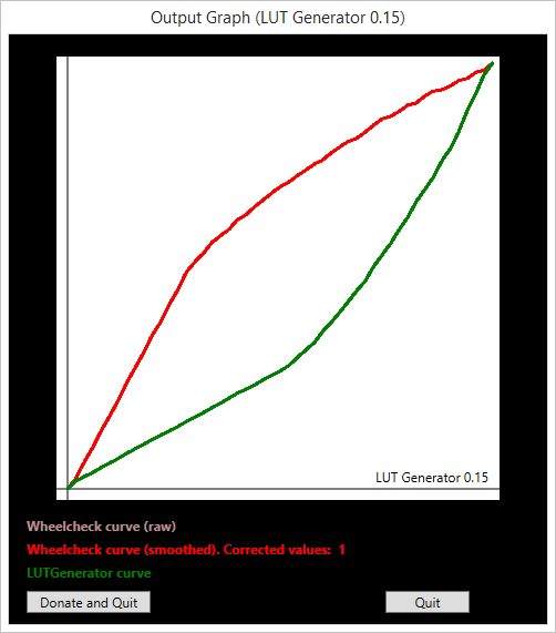

    The speed limit seems too low for LUT generator.
    OSW is about 200 rpm.
    Squeaks are normal sounds of industrial ac servo speed limits.
    You can see it by setting it extremely low.

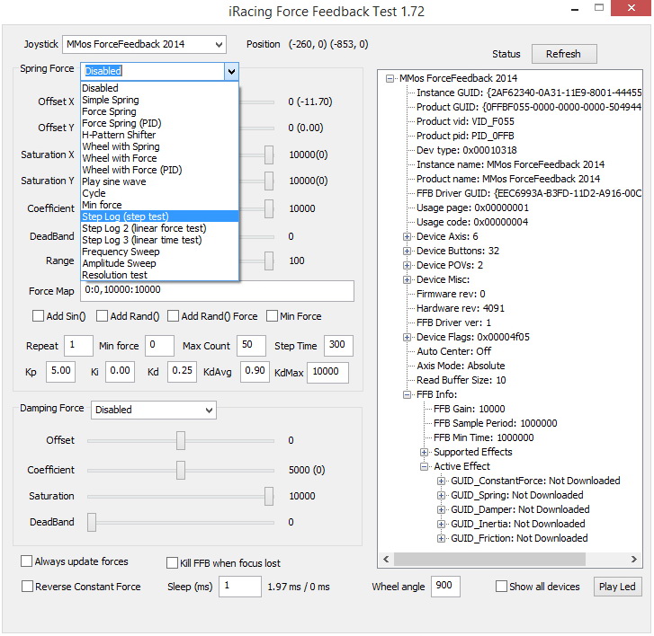

  18. Peacemaker105
    Jul 18, 2017
    197
    Perth, Aus
    2,005Coins
    +362 / 2 / -0
    hey mate i'll do a step test on mine now if you want. :) Any other settings i need to change?
  19. Sieben
    Nov 6, 2018
    395
    2,241Coins
    +115 / 2 / -0
    Hello) always interesting in this of course.:) No settings generally on default. Just as is will be fine.

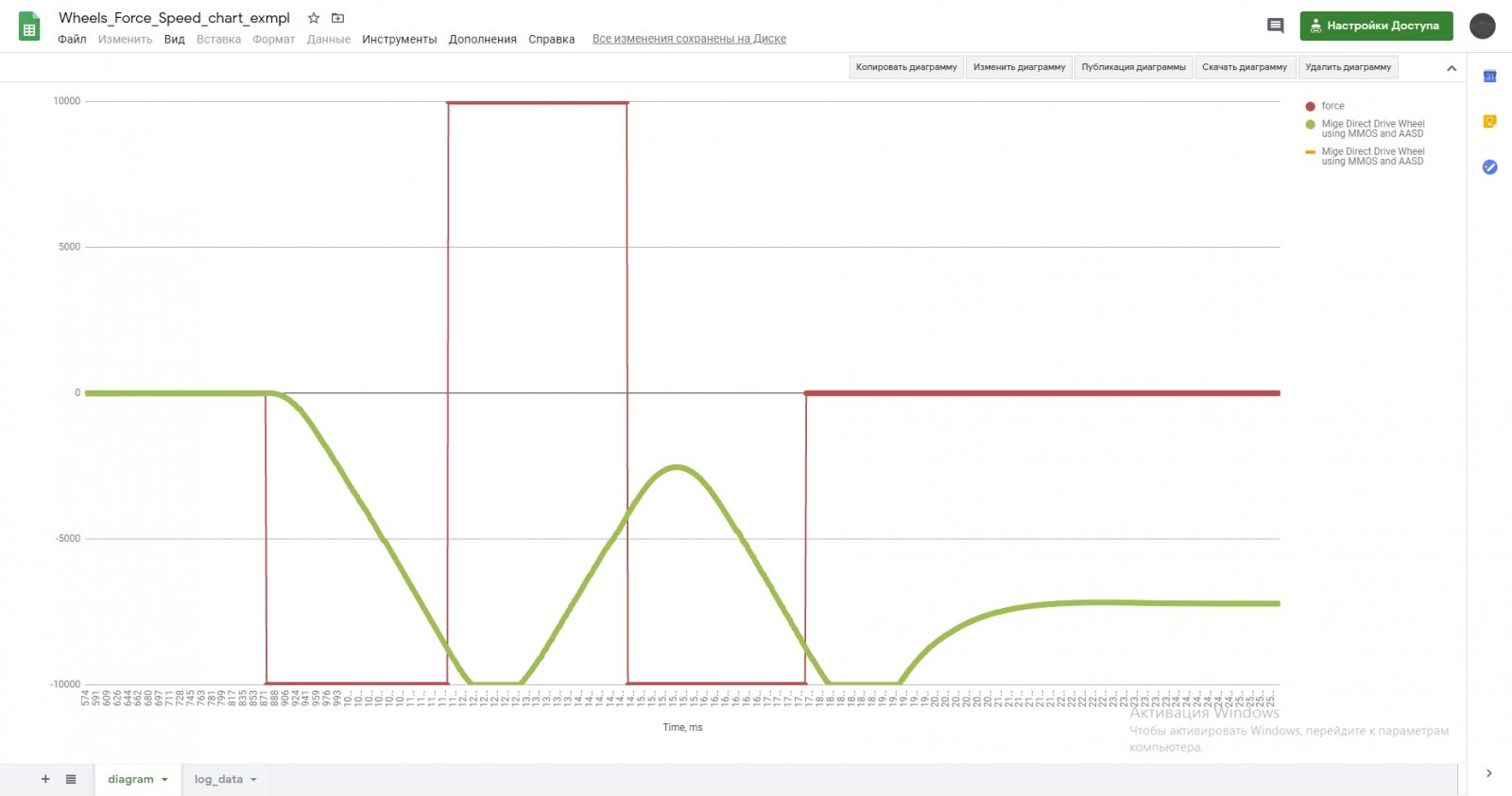

  20. Peacemaker105
    Jul 18, 2017
    197
    Perth, Aus
    2,005Coins
    +362 / 2 / -0
    @Sieben Here's one at 100% force @ 600ms and 300ms... What is this testing? the wheel speed?
    edit: added 300ms one like the video above
    Please interpret this information for us and what it means haha
