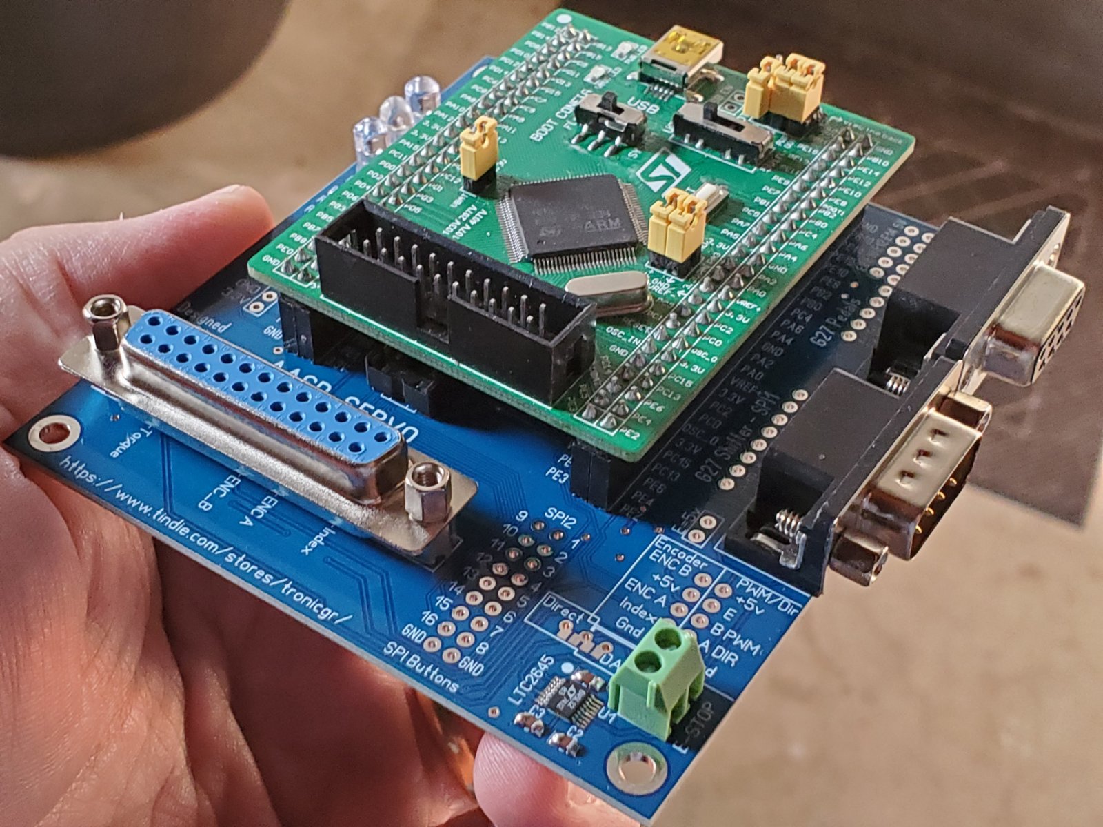

    will the board have bluetooth / wireless connectivity ?

    Not on board, but there are connections to the SPI2 port to attach an NRF52 bluetooth pair that is supported in the MMOS firmware.

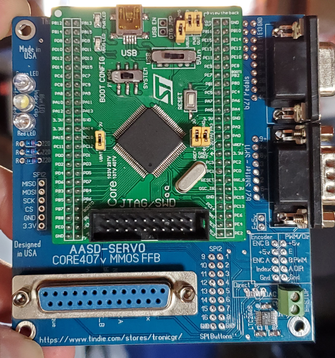

    I'd be interested in picking up a board as well. I don't need the G27 peripheral connections so I could just use a Discovery board, but the DAC circuit would be tough to implement without a daughter board of some sort...

    Yeah that's what I mean, the whole point of using this board is the DAC and the more compact Core407v. And the DAC is the second most expensive part actually after the Core407v...

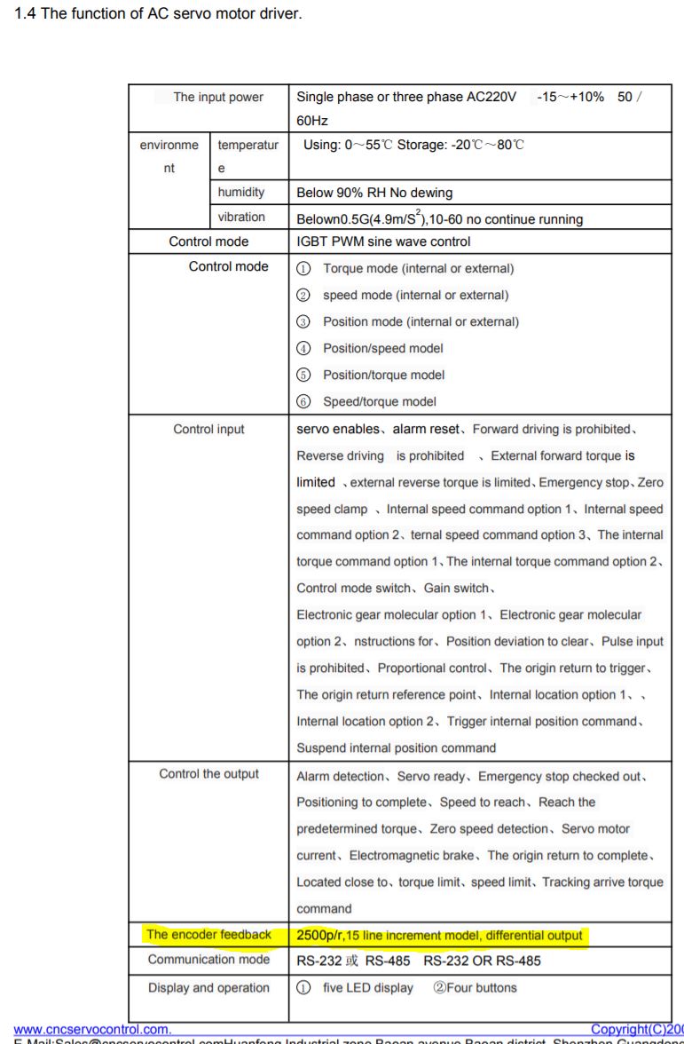

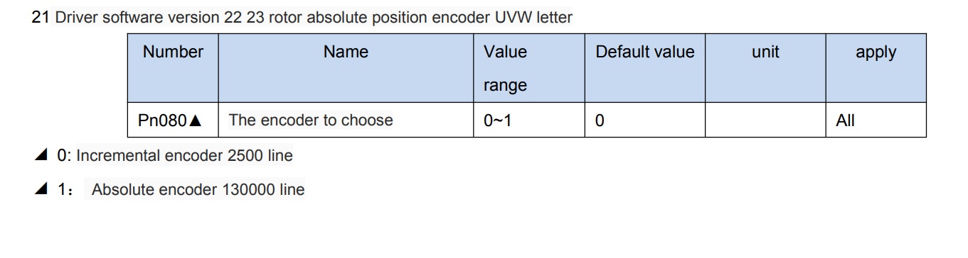

    Another thing i noticed while reading the manual.. When selecting encoder type it mentions 2500PPR.. i'm wondering if thats the only encoder or maximum encoder that the AASD would work with? Or are they just using it as a reference? Would there be any reason if you wired up a higher resolution encoder that it wouldn't be able to read it?

    That might be a deal breaker this drive. Also from the drive specs in the manual they specifically call out the 2500p/r encoder.

    I count 10000 pulses per 360 degrees, on my servos. The 2500 is quadrature resolution and useful for internal PID positioning in the drive, but does not really represents the actual resolution used by the MMOS controller!!! I'd say is not deal breaker, considering the low price of these servos.

    The MMOS firmware does not benefit from using higher resolution encoder than 10000. The actual resolution used is perhaps 4096 points in the games (12bit).
