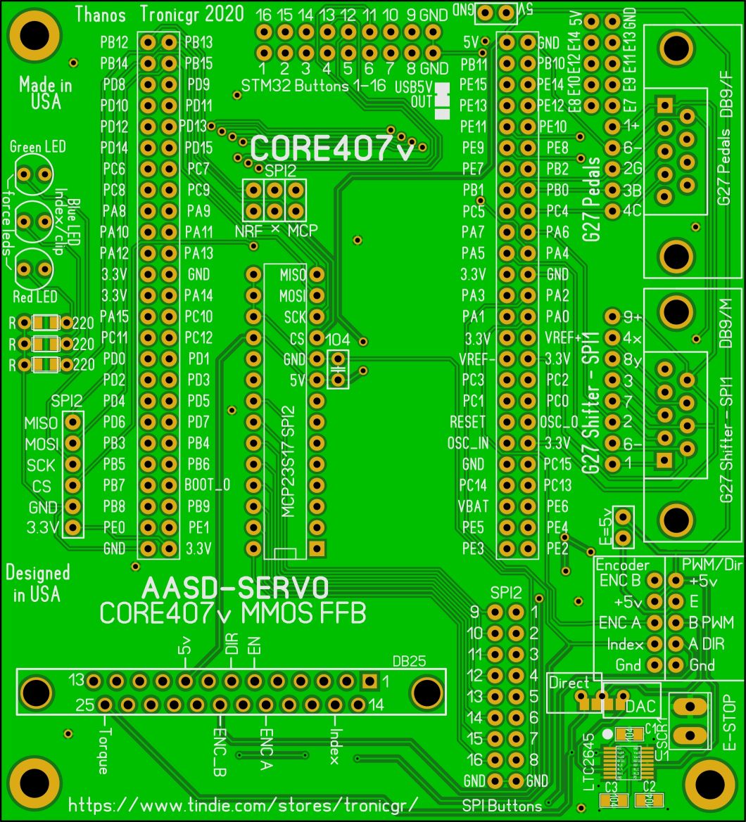

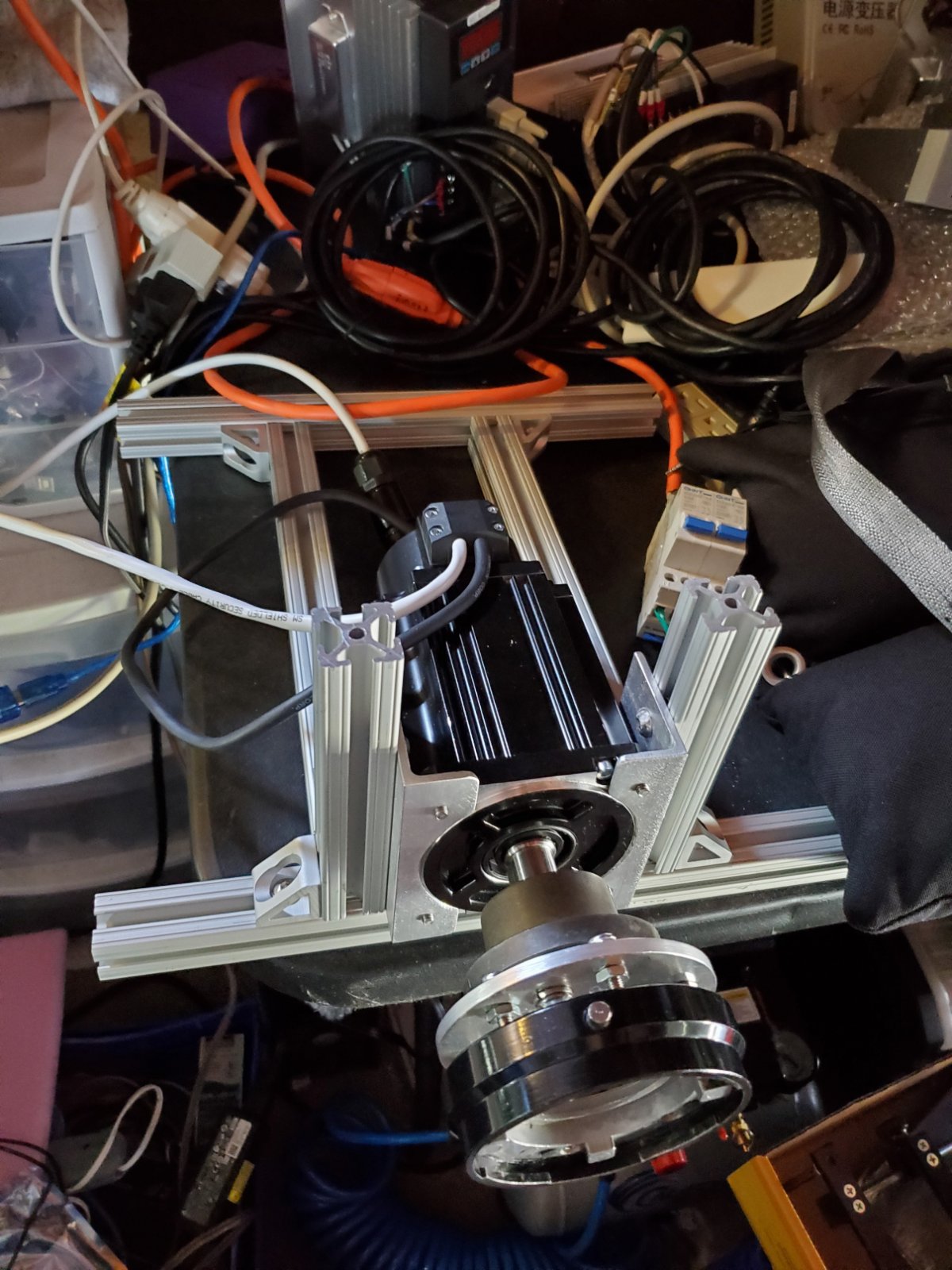

    Ok, preparing my 90ST motor, seems it has enough torque for my needs lol.
    Can't wait for the PCB for the MMOS controller to arrive and test!!

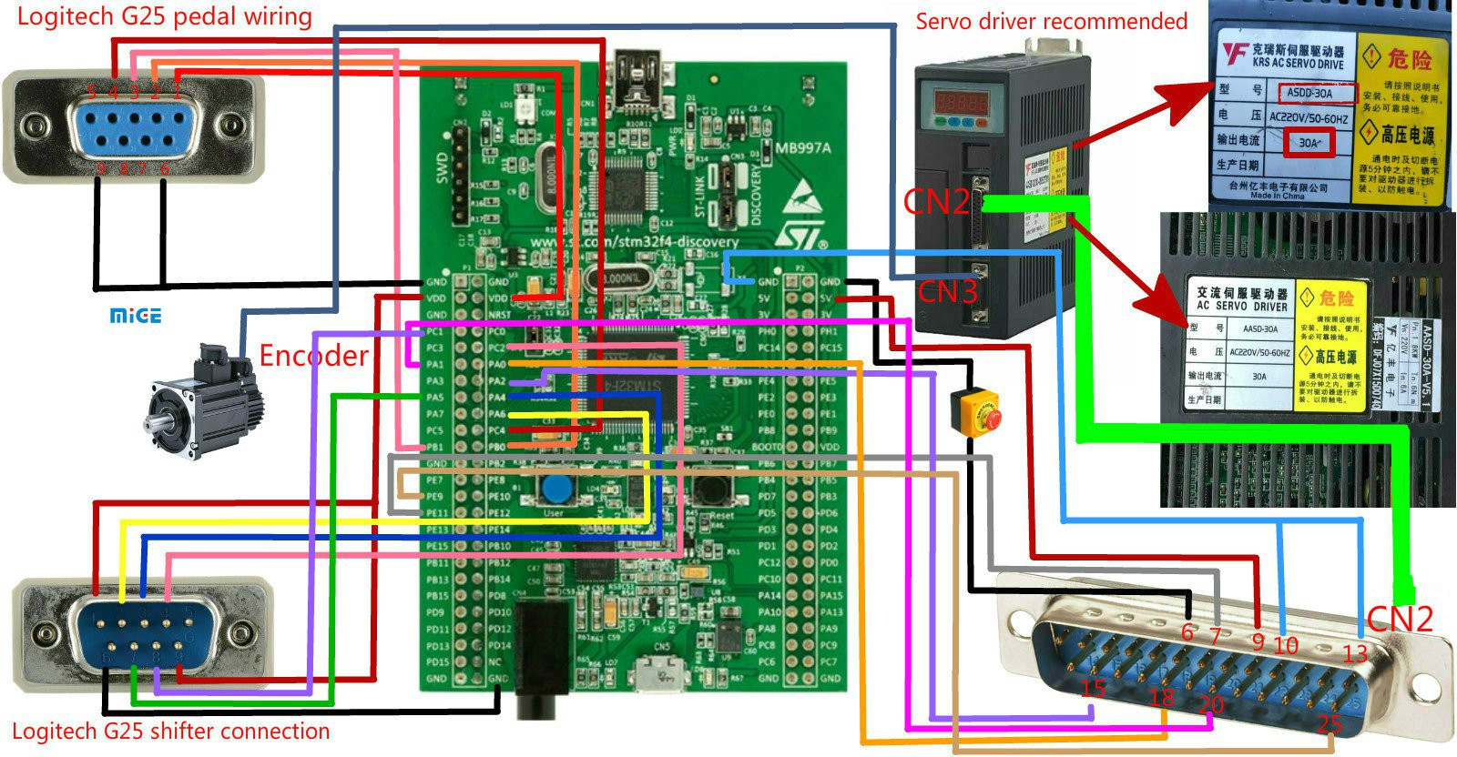

    how exactly does a 240v servo motor work
    from my understanding
    1. it converts AC to DC (some are induction motors)
    2. its basically a AC/DC motor with a built in sensor
    3. the driver is a bit like a brushless controller
    what exactly does the chip/disco board do to control the motor ? Is it telling it which direction and how much pwm to apply - like an H-Bridge ?

  13. Thanos
    Jul 6, 2017
    1,373
    Electronics Engineer
    United States
    2,871Coins
    +1,075 / 10 / -0
    The custom pcb I designed, uses these DB9 connectors for original G27 shifter and Pedals. I happen to have these. But you can wire other type if you need to. But please give it some time to build and test a prototype first, I'll make available Gerber files, no worries.

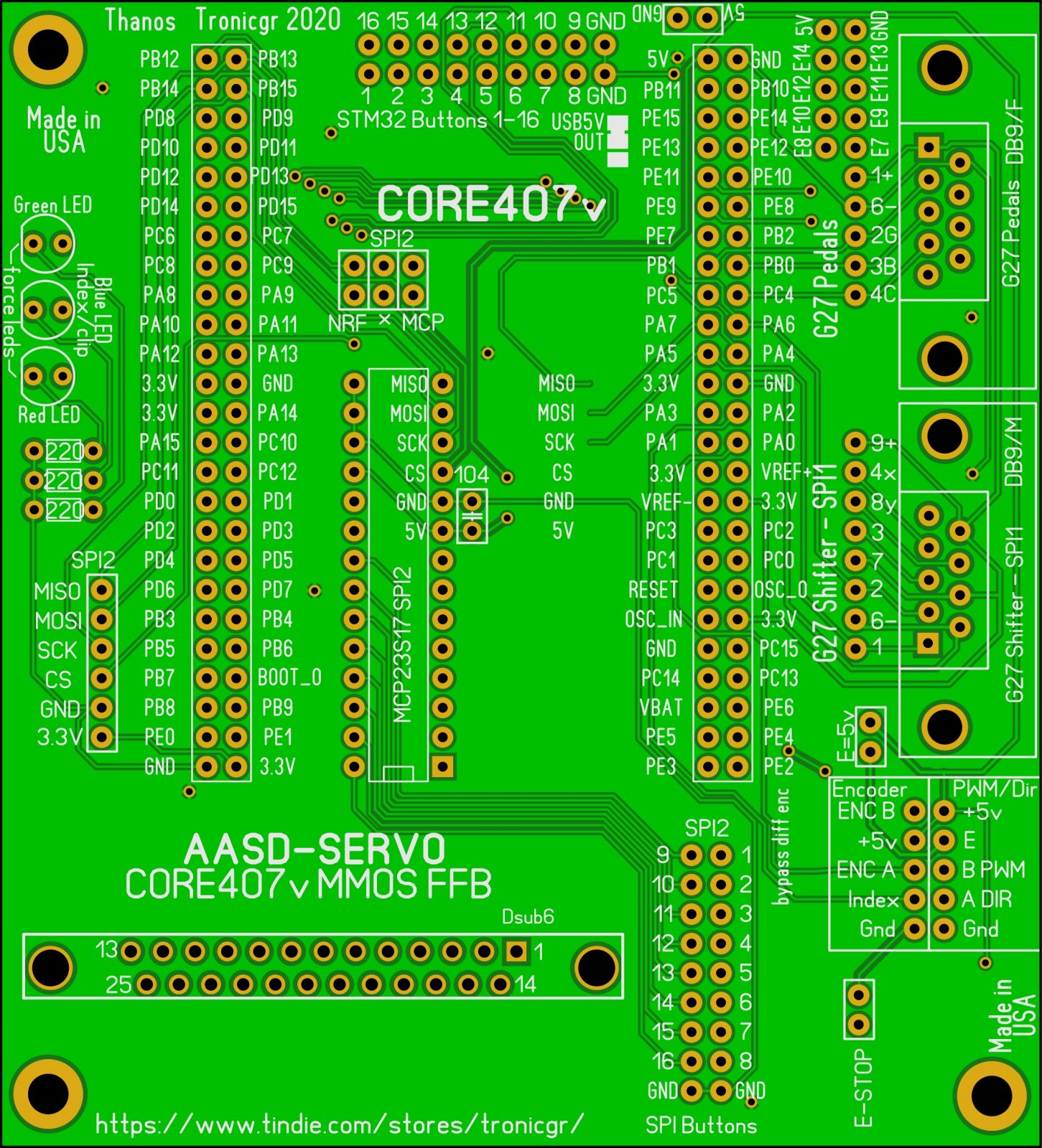

    Hi @Thanos quick question while im hitting E-bay , when the now DDFFB pcb is released i notice you moved from through hole to surface mounted devices , You mentioned you'll possibly supply the just the board and or PCB & parts as kit , or ready built would be preferred but you may not have the time to do this ready assembled option in volume , is there a pic of an older populated R&D sample so that i can see what extra items will be needed to add to my shopping list , The wave share board wont be here in time so 1st draft will be using my STM32 discovery from my other DD FFB project so i cant use the new PCB till the Waveshare version arrives
  20. Thanos
    Jul 6, 2017
    1,373
    United States
    2,871Coins
    +1,075 / 10 / -0
    There are not many parts on it, you may not even want to use the G27 pedal and shifter connectors if you use something else...
    Anyway see this update:
