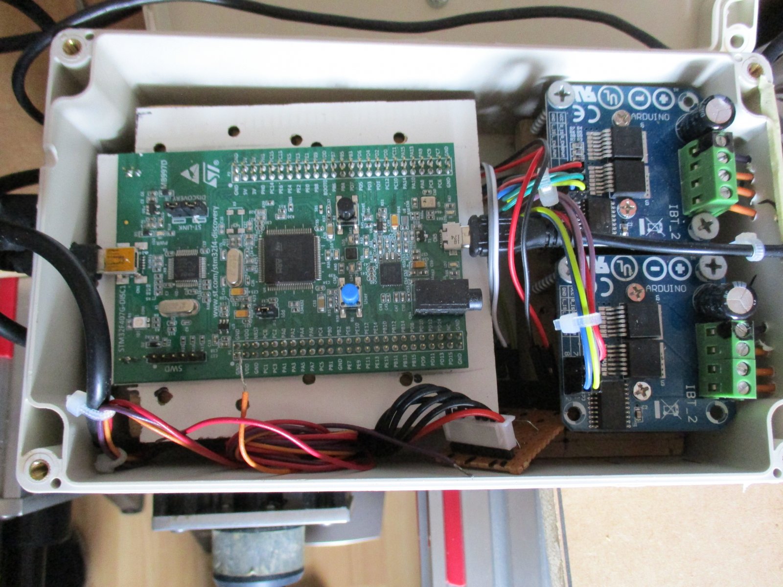

    Oh mate, you don't mess around do you @Thanos haha. Hell yeah! The pin header spacing should all be the same though, yeah?
  2. Thanos
    Jul 6, 2017
    1,378
    Electronics Engineer
    United States
    2,911Coins
    +1,079 / 10 / -0
    The Core407v board has different pinout from Discovery board... Its just hard to find discovery boards anymore.
    Plus the core407v is more compact! It will be easier to design 3D printed enclosure for it.

    That would be just my luck :(
    There's hundreds of discovery boards available from element14, rsoline, mouser etc. (STM32F407G-DISC1) yes a tiny bit bigger but because it has ST-link programmer built in.

    Well, at least you can still use the ST-Link programmer on the Discovery boards you have to program the firmware into the Core407v...
    https://www.waveshare.com/core407v.htm
    No need to buy extra programmer...

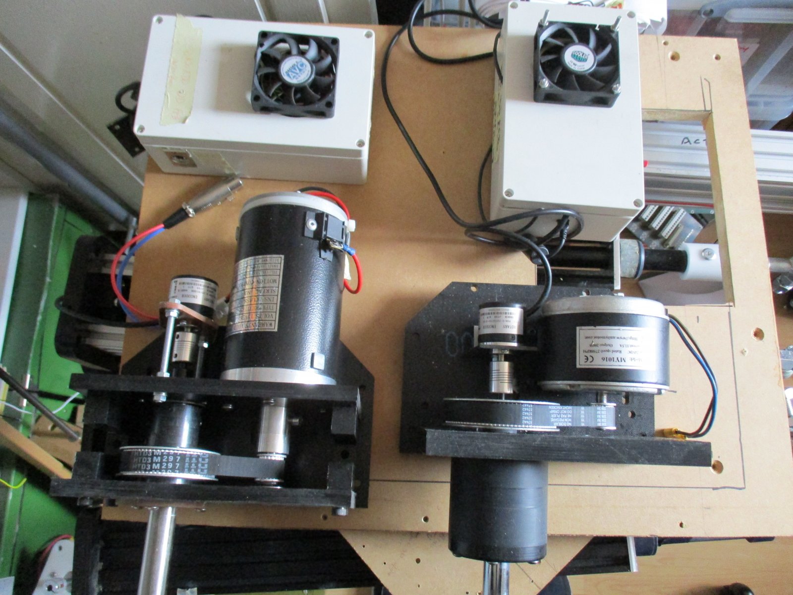

    3DOF, DC motor
    Good to see someone else that has used different servo driver despite what majority of people think that granite's simucube is the ONLY driver that can be used.
    I said long ago that granite are laughing their arse off because of all the sim people think that it only works with their "special" driver. The only reason that they use <50v is because their driver cant handle 310v(mosfets vs IGBTs.
    Peacemaker you will probably need to tweek a few timings to get rid of the jitter from pwm input.

    can you explain - would it be suitable as a 6dof motor

    The link had only the motor, without matched driver. Never buy them separate, it will be impossible to find matched servo drive and if you do, you will have to build the encoder wiring to match and find the correct parameters of the motor model and calibration information, which from my experience, its not easy task and its not worth it, to try save a few dollars.

    Mige don't use AASD drivers so very possible the pinouts are different.. Not to mention a 130st (130mm flanged motor) is way too big for a 6dof unless you're building something epicly large. 80-90st is what you want.
