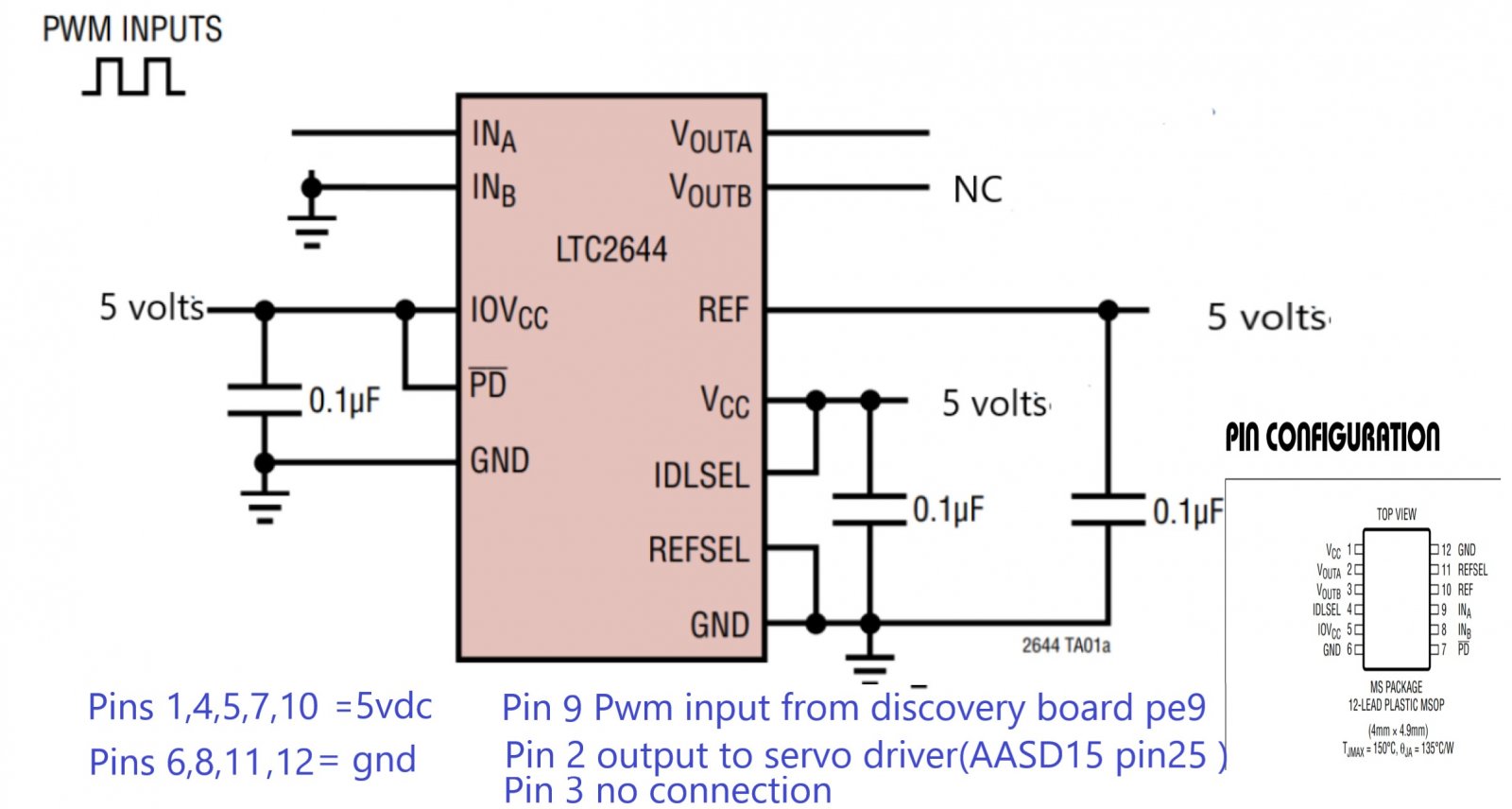

    I am currently also building this setup using a Big Mige (130St-15015) and a different Servo Drive as well as a Disco Board. I am now trying to convert the PWM signal of the Discovery board to an analog one by using the LTC2644 DAC. Can someone give me the schematics used to accomplish this? For example like the DAC from @Thanos . Also I want to boost the output voltage closer to 10V. Is an Opamp good for that purpose? Of yes, which one and how should I wire it up? I would be very happy to get some answers and am really looking forward to finally hooking up my Servo Drive to my Disco board.
    David

    AC motor, 6DOF
    Welcome to the forum !!!
    Do you have the LTC2644 ?? It is so tiny it is not easy to work with..
    Not sure about the opamp..

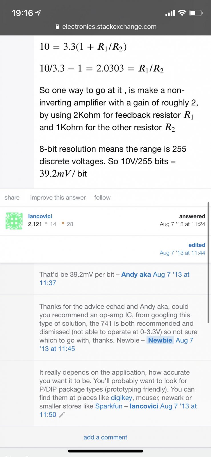

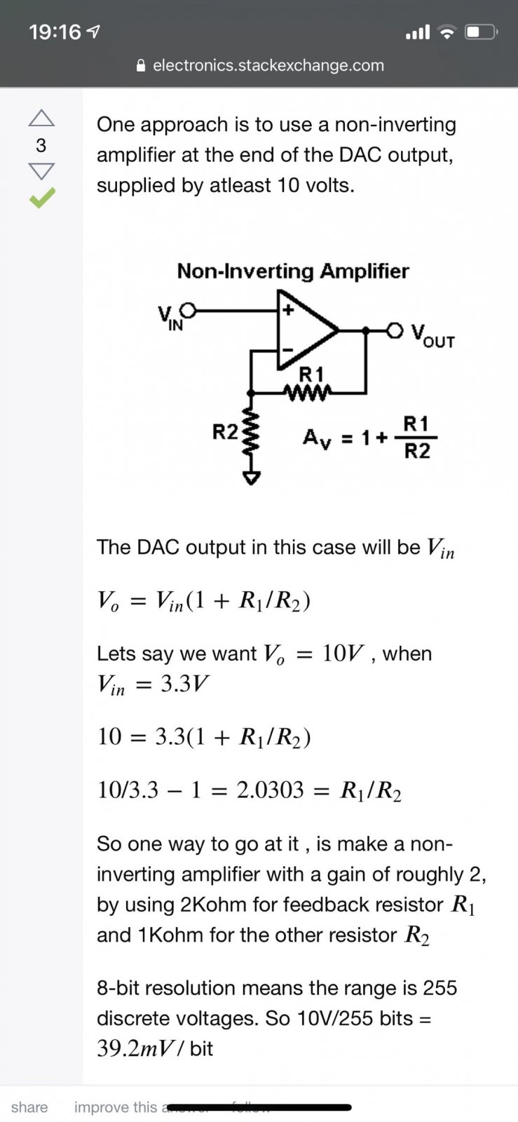

    First of all, thank you for your fast answer.
    Yes, I have the LTC2644. I have no problem soldering it to a board with TSSOP pins ($0.5) and then using its bigger connections to create a circuit like shown in your picture. I just wondered, whether it was the right circuit for this application (which you now confirmed, thank you again).
    I found an AD711 Opamp and hope it will be able to handle this job, as I have no experience when it comes to choosing the right one for a certain application. I will try a circuit like the one shown in the picture below and keep you updated. Do you see, whether there is anything wrong with it?

    @David Böttger That looks good. I would think the schematic is missing some bypass caps and does not show how to hook up the vcc ect.
    I too have never played around with opamps other than to solder them into other peoples circuit designs...
    However you have sparked my interest lol
    I ordered these pre-made circuit boards to play around with..
    This stuff is very cheap on Amazon for us here in the US..
    Yes, keep me informed.

    The Vcc of the opamp is usually never shown in schematics for the sake of simplicity, but very simple to hook up.
    Thanks for your tip with bypass caps, I totally forgot about them. I found a great Website that explains why you need them in case someone is interested.
    Now I’m just waiting for the parts to arrive and give it a go.
    I’m glad to hear that I sparked your interest for Op amps and that you even ordered the same ones as I have. I hope they will work fine.
