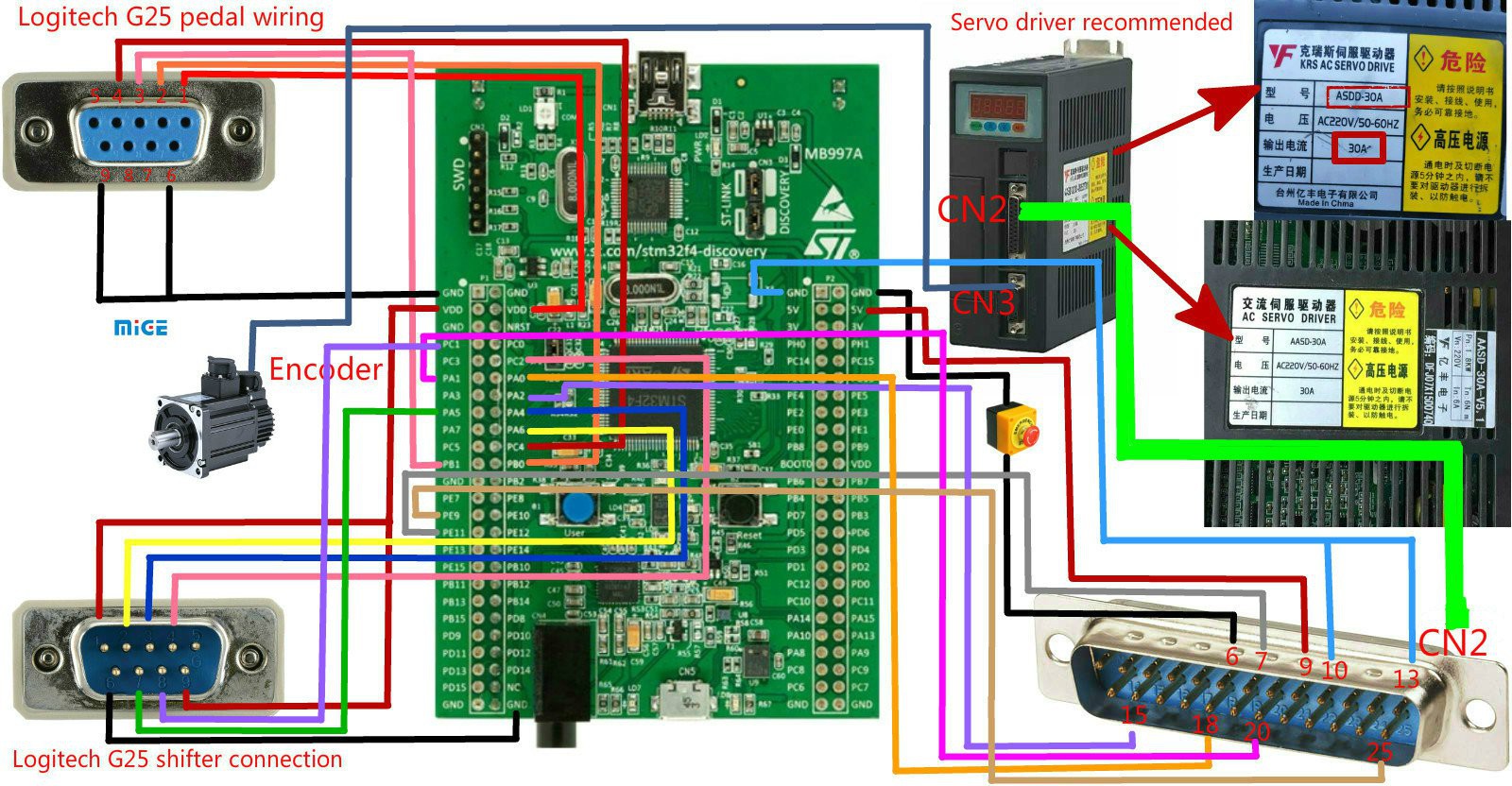

    @all. The pedals and shifter from the G27 can be connected to the STM32 board. What about the CSL Elite pedals from Fanatec? I think it's the same wiring?
    Ground / +5V and the pot measurement?
    I do have the small black RJ12 connection box from Fanatec. So I think about soldering the RJ12 cable (which goes to the wheelbase) to the DB9 connector.
    Please share me your thoughts.

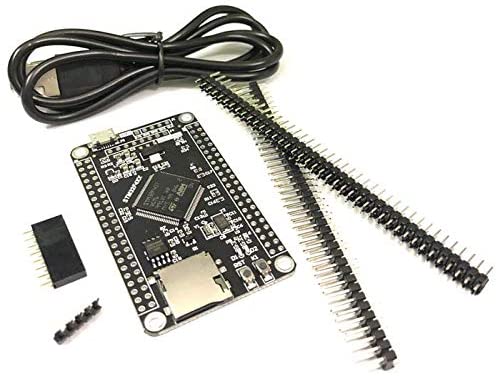

    Just a FYI This board seems to work fine with this project and its cheap and available from amazon. It does not use a stm programmer but instead uses a dfu file which is sent via the usb jack on the board The programming software is available from ST.com
    www.st.com/content/ccc/resource/technical/software/demo_and_example/93/55/e0/89/d1/e3/40/d5/stsw-stm32080.zip/files/stsw-stm32080.zip/jcr:content/translations/en.stsw-stm32080.zip
    Google drive link https://drive.google.com/file/d/1lcHjFLZAo4nqiLp407oG2OF-sguk0sID/view?usp=sharing
    www.amazon.com/gp/product/B081BCXST2/ref=ppx_yo_dt_b_asin_title_o04_s00?ie=UTF8&psc=1
    ADDED> The converted firmware Hex to DFU file..
    I forgot to mention... you must short the BTO pin (next to the usb socket) to 3.3v to get the board into the DFU mode

    He Guys, Quit busy with preparing all the stuff.
    Anybody an small drawing how to "drop" the DAC between the stm32f4 and servo signal?
    TIA
    Bakhol

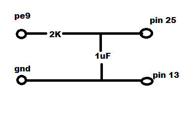

    @vicborder . I think I mean something else:
    This piece needs to go somewhere?
    TIA
  11. vicborder
    vicborder Vicborder
    Nov 6, 2019
    37
    - 529Coins
    +7 / 0 / -0
    i don't know what it is, if you want to put an DAC to buffer the noise of the engine is the scheme you passed
  12. JonBakhol
    JonBakhol Active Member
    Mar 16, 2018
    107
    Netherlands harderwijk
    443Coins
    +46 / 1 / -0
    I think you are right about the noise. But the conversion from PWM to a smooth Analog Voltage isn't needed?
    TIA
    Bakhol

    @JonBakhol The input pin (pwm) on that chip I believe is pin 6 the analog output voltage is pin 2. There are actually 4 separate converters on that chip. PE9 coming from the STM board goes to the input pin6 and the output of the chip goes to pin25 of the db25 connector... Please understand that chip is extremely small and cannot just be soldered to. It needs to be mounted on what is called a breakout board before you can solder any wires to it... You would need surface mount (SMT) equipment to do the job and a microscope would help too.
    www.digikey.com/htmldatasheets/production/1615665/0/0/1/ltc2645.html

    @T R Para
    Thanks that's what I wanted to know. I'll try by hand. (Soldered alot of smallest SMD components by hand)
    Will post the outcome when all is arrived and running.

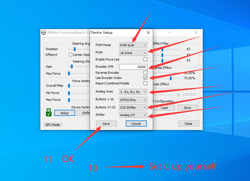

    When I enable "Use Encoder Index" my pedals stop working. When disable it. My pedals come back to life. Anybody an idea?
    TIA
    Bakhol

    JonBakhol
    When using "Use Encoder Index",
    mmos will not start until the z signal is input.
    Is an encoder signal connected?

    @sedesa tatasa . Thanks for the reply. I already thought something like this was the problem. I'm waiting for the motor. So I thought to get everything prepared in front. The encoder isn't attached as you can see. I'll see when the motor arrives.

    without Encoder, it's not gonna work
