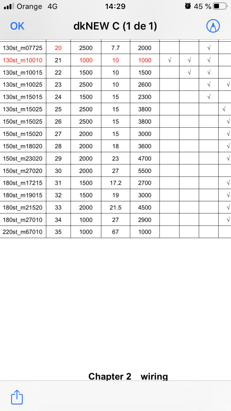

    hi, I had an M15015 engine, I got a problem with the engine vibrations when I put the STM32 to 16.8khz, when I put it at 4 khz, the vibrations decrease, but the engine screaming, someone would know to tell me where this problem, thank you very much

    thanks for your answer, pn190. I've got it tight. I think if I lower it or raise it right. It starts to turn left, I got it to -90, if I can turn up video

    probably due to the different inductance this motor has. it has much higher inductance than 130st-m10010 so it will behave differently on same pwm frequency. pn190 won't do anything about the noise it just helps getting rid of the left-right wiggle when the motor is "idle".

    i have it set up according to the engine manual with PN001 to 24, would you have to change?
