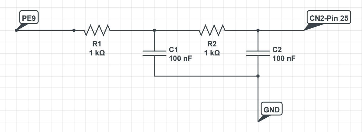

    Great write-up @Peacemaker105! I got this setup and working well following your instructions on it.
    To address the humming I used a pair of low pass RC filters with Pn188 = 1 and they completely eliminate it. It's a simple and inexpensive solution and most people may already have the parts on hand. From some filter simulations it should add about 1 ms of latency for large sudden changes in torque but in practice it will be less because the torque commands typically are smooth transitions over a few milliseconds rather than large steps.
    Here is the circuit for this filter. The filter frequency is about 1500 Hz. The values are not critical and close values can be substituted.

    I didnt have issues with encoder calibration but my other usb devices would trip out and my loadcell brake pedal was jittery. I just put ferrite chokes on pretty much all my computer cables and ran a ground wire from the motor's flange to the AASD's exposed ground. solved the problem for me.
    I'm using one RC filter with 2.2k resistor and 100nf cap and seems to be adequate.

    Latency is not bad.
    Modern ffb is 60hz-400hz.So there are 16ms-2.5ms interval steps.
    The rise time rounds those edges.
    simcube2 and fanatecDD also have the same purpose filter.
    I think that Pn188 has the same effect.
    As a result, the smoothing(overall filter of mmos) value can be reduced.

    Awesome man! thanks for the schematic, will help a fair few people out that's for sure :)

    Did you not need a DAC to clean up the signal to remove the humming ??

    Yeah that's what they've been reporting.. :)

    a simple rc filter can do the job, but you will get less latency (under 1ms correct me if I'm wrong) with that specific DAC on the TDD board. it's also 1 to 1 conversion between the 12bit pwm of the mmos and the 12bit output of the dac chip.

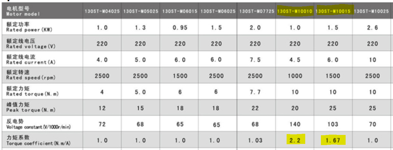

    Hi, I am shopping for a servo motor for this project, and found a webshop that sells a 130ST-M10015 (1500 rpm, 1.5 kW, 10Nm) and a 130ST-M10010 (1000 rpm, 1.0 kW, 10Nm). Looks like they produce the same torque, but as far as I can see from you post, the one that has the lowest RPM is the best. Is that correct?
    Also, a more general qustion: When selecting a motor, is the rated torque the most important factor, or are there other specs that also are important?

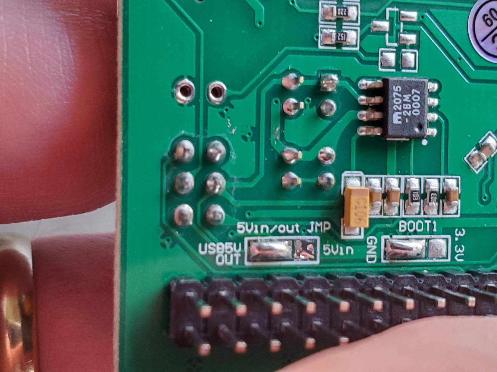

    Hi @Peacemaker105 just wanted to give ya update that i got my Wheel working at last , @Thanos gave me a pointer that i missed out, because i bought my Core407 board independantly ,theres and solder bridge that needs to be made on the underside of the Core407 board , once done , the system seems to be working just as you both intended. so gonna go buy another wig cos i ruined the last one wondering what i missed LOL :) cheers as always mate for great work and support . its really highly appreciated ..gonna go try and tame this beast now :) Thanks again for bringing this option forward for us tight gezzas :):cheers
  18. Thanos
    Jul 6, 2017
    1,379
    Electronics Engineer
    United States
    2,917Coins
    +1,079 / 10 / -0
    Its the 5v jumper, should be set to 5v OUT !!!

    Did a bit of research, I think I found out why low rpm servos are better.
    This table is from the link in the original post (https://www.aliexpress.com/item/32868662195.html?spm=a2g0s.9042311.0.0.67274c4d5qpWWV)
    The servo that is rated at 1000 rpm has a torque coefficient of 2.2 N.m/A whereas the one that is rated at 1500 rpm has a torque coefficient of 1.67 N.m/A. So the servo that is rated at 1000 rpm can deliver more torque with a lower current (Ampere), it will give you more bang for the buck, so to speak. The servo that has a higher rated rpm can deliver the same torque, but you will need a more powerful servo driver that can deliver a higher current. At least that's how I understand it, let me know if I'm wrong

    you should get the 130st-m10010. this the motor they call "small mige" in the opensimwheel community i think.
    better torque coefficient, lower current rating = less heat. rpm does not matter as much as you will not even reach 500rpm in a driving simulator.
