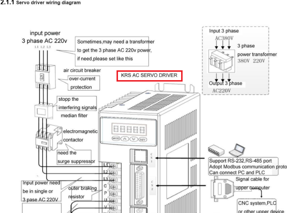

    hey @Peacemaker105
    you might like this even better
    Have a look at the cncservo2015v4 pdf, it looks like you only got half the manual.
