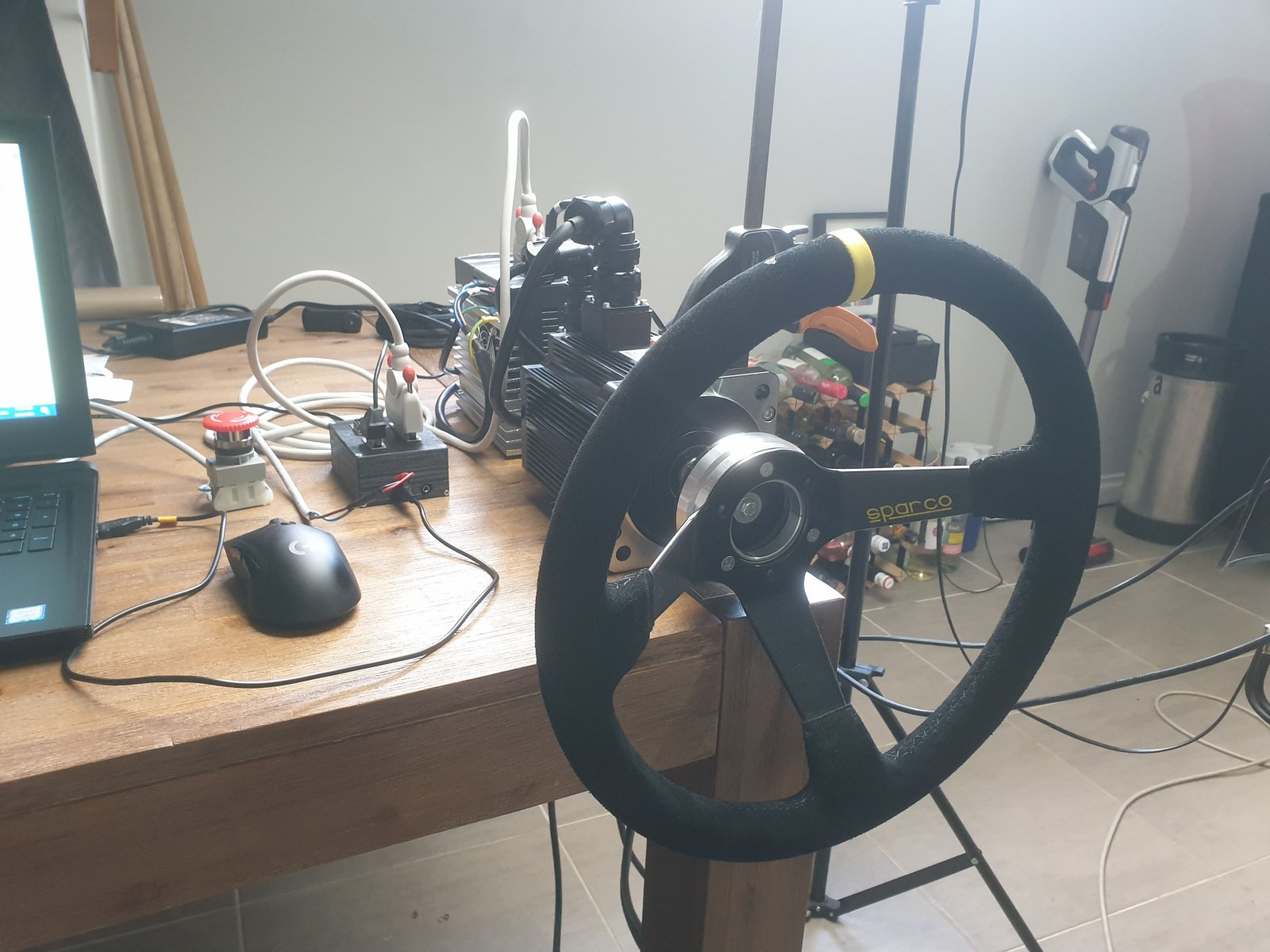

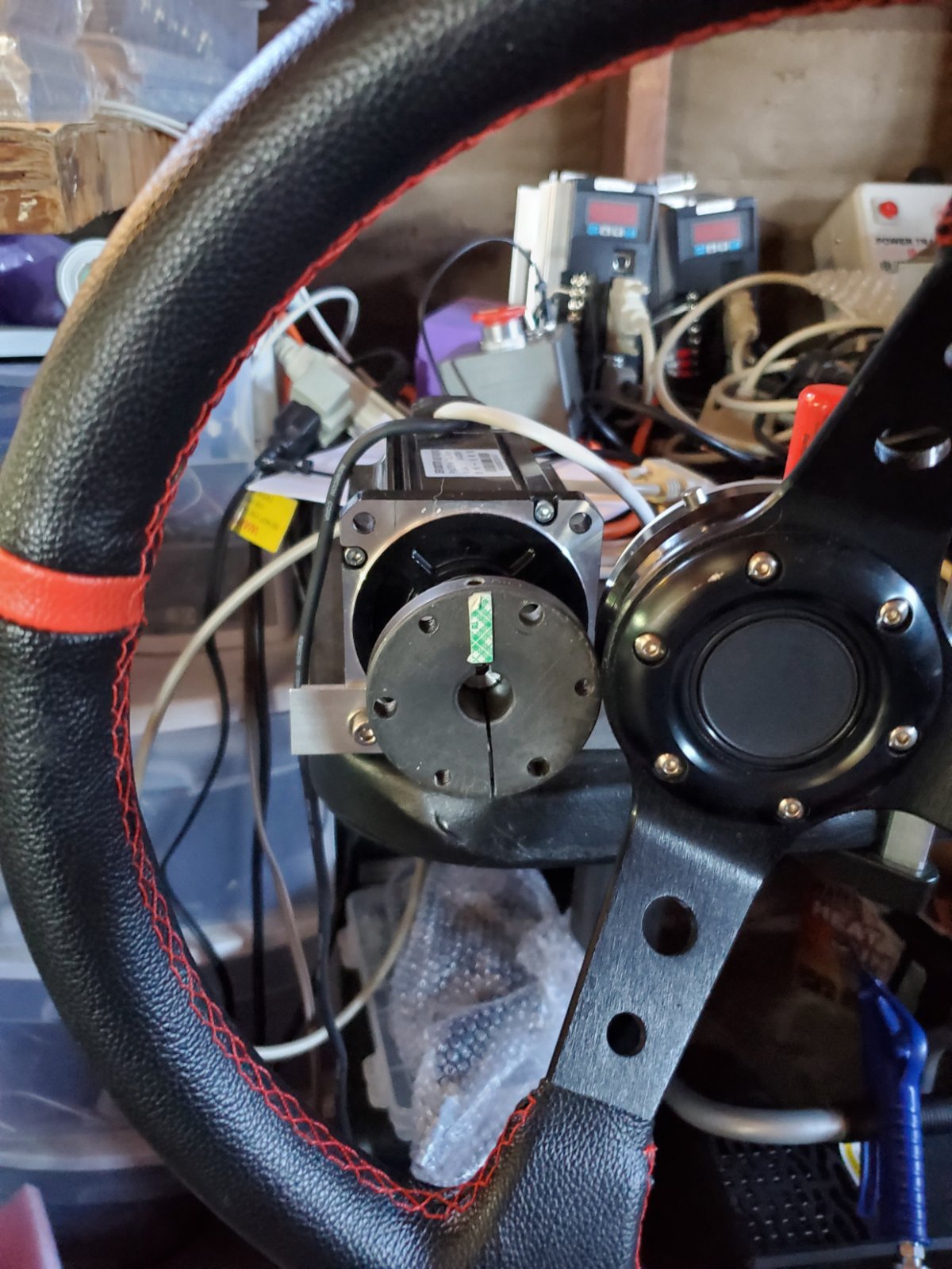

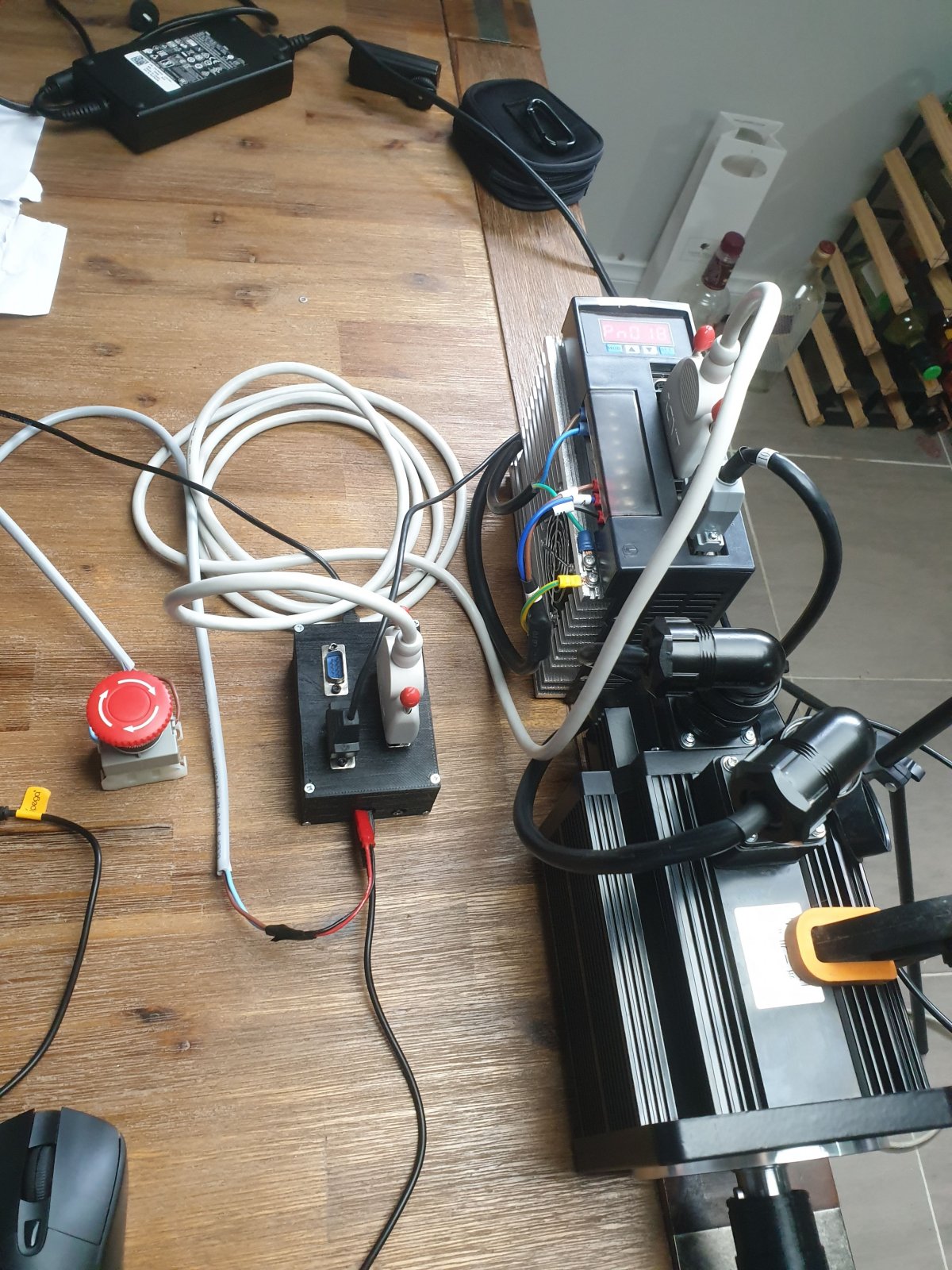

    Hi there,
    So after using the AASD servo drivers for my rig and with how cheap you can get them bundles with servo motors i have been wondering if anyone would ever be able to get a Direct Drive FFB Wheel up and running with one.. Then i stumbled upon a post on Hackaday.io and someone had done just that! . Using an STM32F407 Discovery board and running MMOS he was able to achieve this. I then set out to try and build one myself. His post is in Chinese and i had to work with google translate to figure out what was needed but with the help of his pictures i was able to make some sense of it.

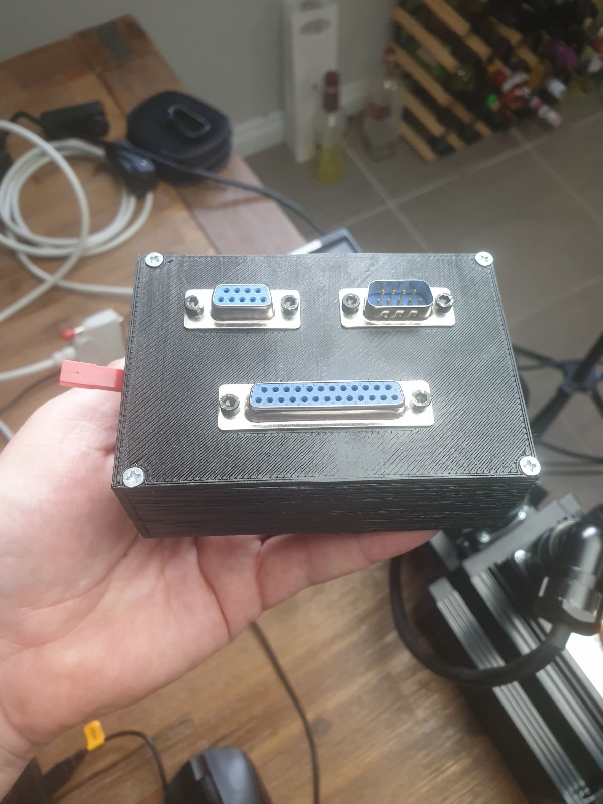

    Here is the wheel all connected in its working state and the stm32 control box:
    20200506_111646_compress23.jpg 20200506_110928_compress84.jpg 20200506_103931_compress91.jpg

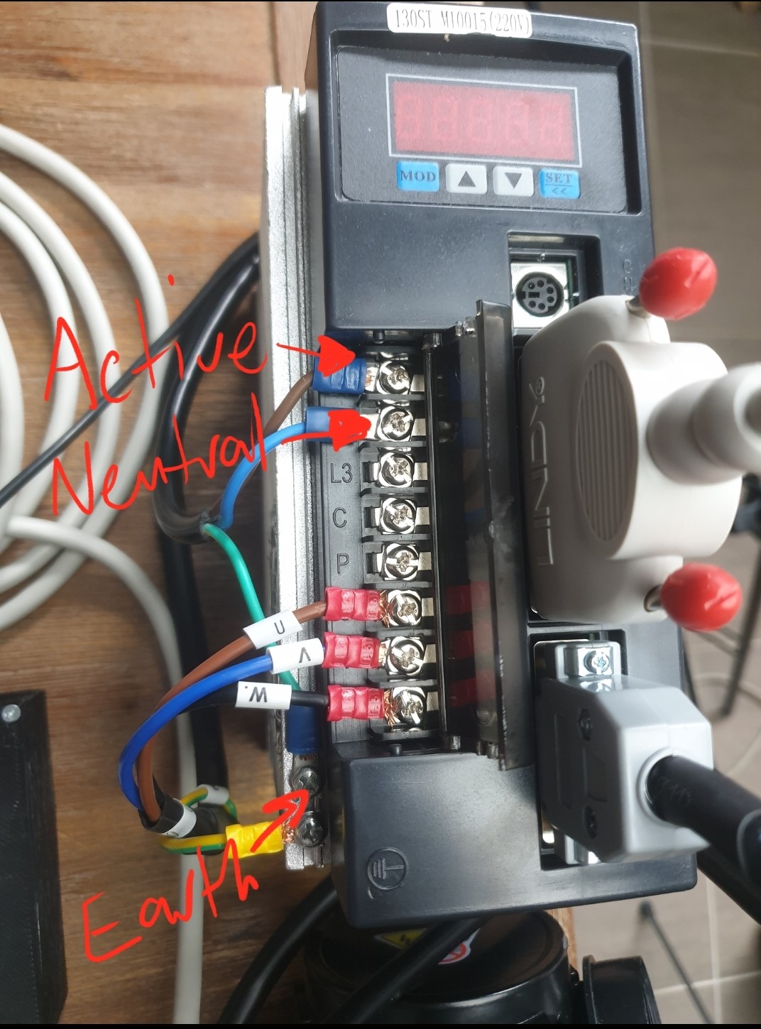

    Connect the AASD drive to Mains power (220v). If you search @Thanos Youtube account i think he talks about how to get it working with 120v somewhere. make sure you know what you are doing or get a trained professional to help you!!
    L1 - Active
    L2 - Neutral
    Powering with 110v -

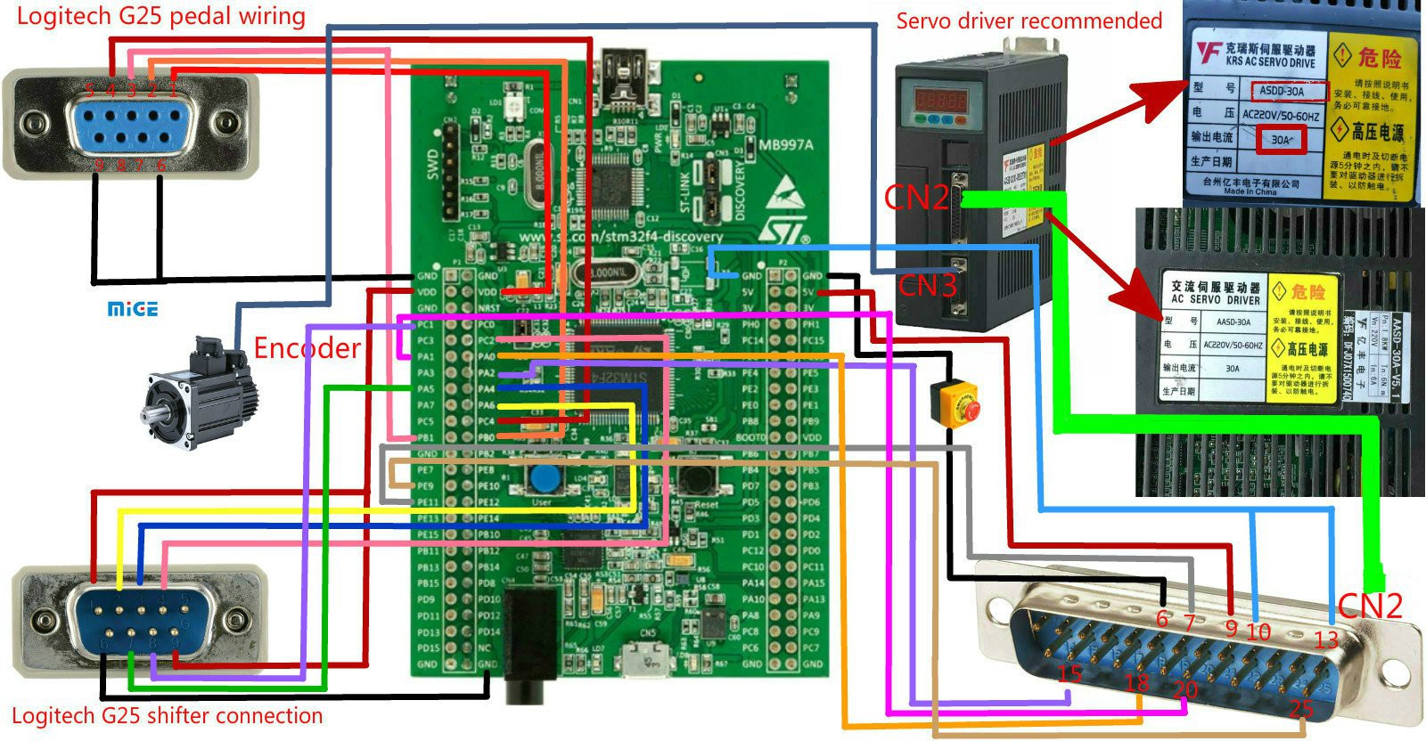

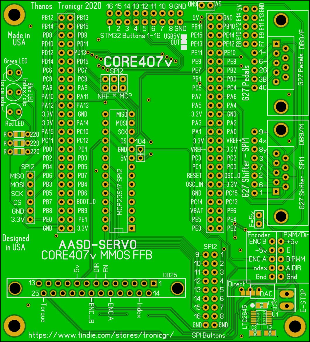

    Next you'll need to wire up the STM32 discovery board. The motor bundles come with a DB25 connector so you can just wire up the pins to the connector using some cable and plug it in and away you go.. but i opted to design a board and use a db25 connector along with the 2 x db9 connectors for logitech wheel and shifter support. Yes the MMOS firmware and stm32 board allow you to plug in your logitech shifter and pedals allowing for a cheap USB adapter as well, all in the one package! Not too shabby.
    Now you want to Plug in the Mini-USB to the stm32 board (this is the ST-Link programmer side). Install ST-Link Utility software onto your computer and then run it.
    Click connect to target
    Click full chip erase
    Click Program Verify and select MMOS Firmware (FFB2014-0.99.2.hex)
    Click start
    Done.
    Connect your AASD to your motor with both power and encoder cables. The power cables are usually labelled with ID tags so its straight forward. The encoder only fits in one spot on the AASD and then plug in the stm32 board using the db25 connector.
    Now plug in Micro-USB end to other side of stm32 board (you need them both connected to run)

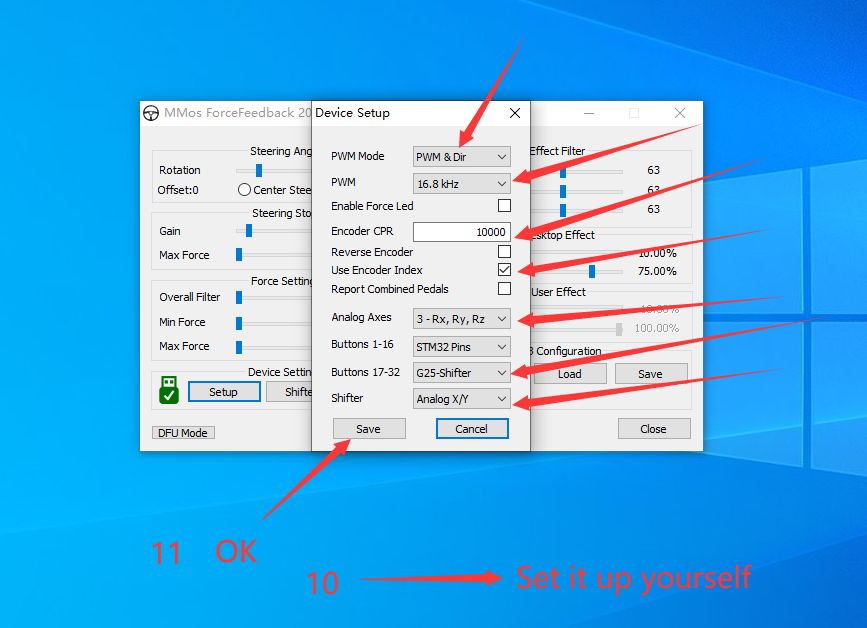

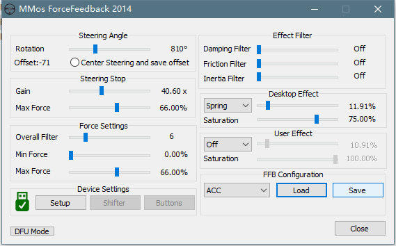

    Now open MMOS Tool (MMosForceFeedback2014.exe)
    Ensure the connected symbol is lit up green.
    Click setup
    Enter the values below:
    Now you can configure your MMOS Force feedback settings.. Save it to a profile name and when you want to use the settings load the config and save to the EEPROM. So everytime you want to change game profiles save it to the EEPROM to load those settings (well thats what i ahve been doing haha). Here's an example for Assetto Corsa Competizione:
    Setup the wheel direction and FFB settings in the game and go for gold.
    Verdict: This was a cheap way to get into a Direct drive wheel without breaking the bank. It was suppose to tie me over until i can afford a Simucube controller and is doing its job nicely. A few things worth noticing are..
    1. It is using a 2500PPR (10000CPR) encoder. Most if not all the OSW guys run 10000PPR (40000CPR) minimum these days and say the fidelity is a huge upgrade over the stock encoder. Mige can supply the motor with this encoder installed but after factoring in their shipping and then getting an AASD-20/30A and paying for their shipping it was blowing out. My thoughts were if it didnt work and i had to go simucube then i would order a Biss-C or Sincos encoder when i did as they are in the Millions! (MMOS wont support these encoders) But if all went well then i could try and pick up a second hand 40000cpr encoder off someone who has upgraded.. there should be heaps around really.. otherwise Mige themselves can sell you the 40000 encoder for $89 usd delivered. I also would like to see the difference between the 2 encoders myself so now i will go ahead and order a higher res encoder and do a comparison video or something on the 2 :)
    2. Having problems getting Project Cars 2 to calibrate wheel.. it detects multiple inputs.. still working on that, seems alot of people have had this issue before
    EDIT: Got it working, my joystick was getting picked up as well. Unplugged it and all is good. :)
    3. Experiencing small humming vibrations when turning the wheel, like when the steering force is applied. Not a big deal but maybe once i set it up properly and they aren't sitting next to each other it may settle down. I've only bench tested so far. Or this could be totally normal feeling as i have never use a Direct drive wheel before haha.
    EDIT: The E-Stop is a normally closed circuit. So when the estop is pressed it will open the circuit. I believe in my video is got this bit wrong as i was off the top of my head talking haha.

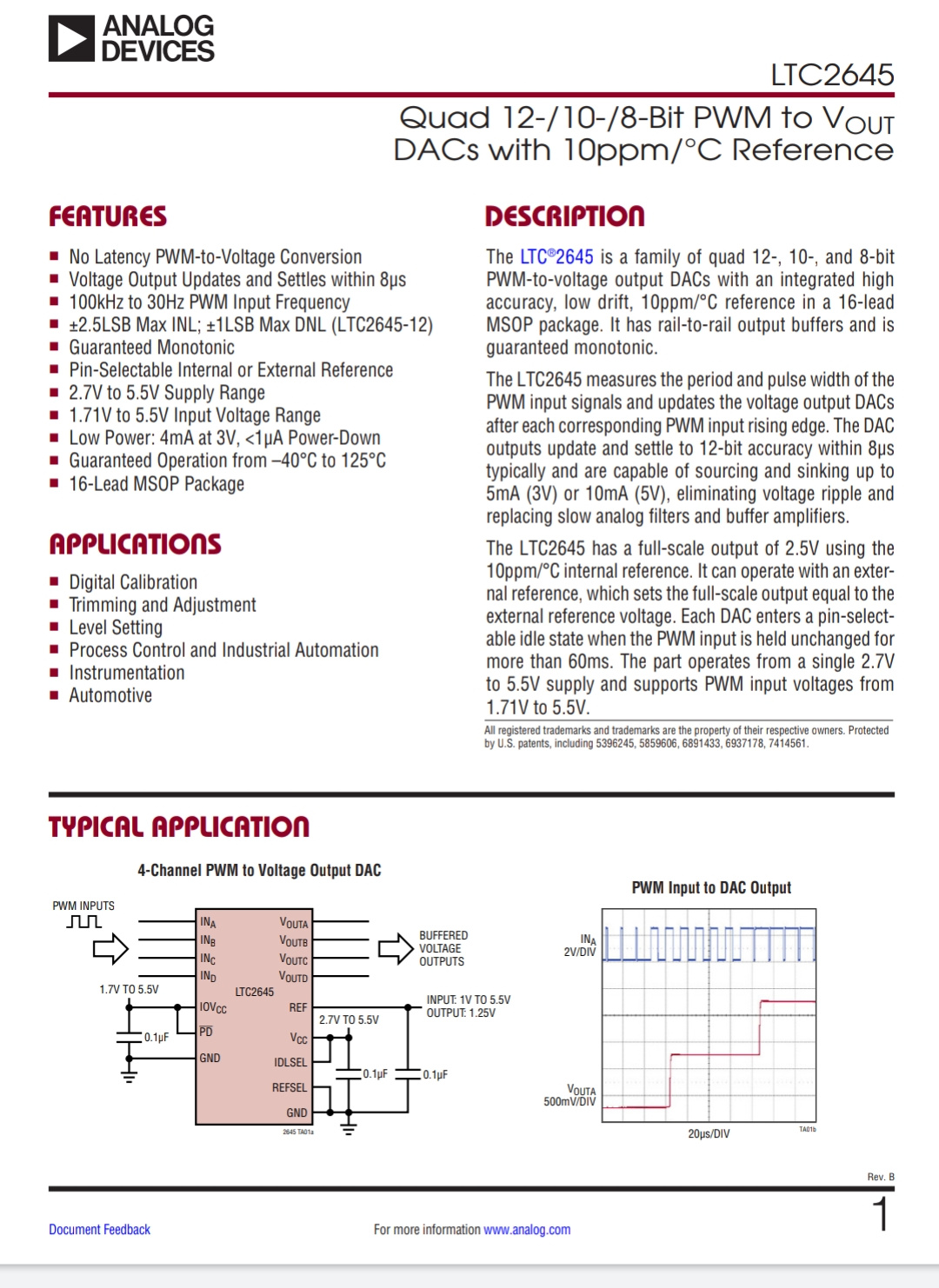

    Ok, I see where the issue is by using the PWM from the stm32f4 to analog input for torque on the AASD drive... it chops the voltage, so its not completely smooth...
    You need to add a converter from PWM to clean analog voltage. Here is one I used in the past on older AMC controllers:
    https://www.digikey.com/product-det...2645CMS-L12-PBF/LTC2645CMS-L12-PBF-ND/4931884
    Notice this is 12bit resolution DAC, meaning it will work fine with 12bit resolution pwm from the stm32f4 (4096 values) to output really smooth voltage for the torque and eliminate any noise you see!
    There are a few pieces on breakout development board as well to easy hook it up :

    Using capacitor adds latency if not very low value. Very low capacitor value is still choppy.
    Best way is with PWM to Analog DAC suggested above... easy as to just drop it between the stm32f4 and servo signal.

    You guys are awesome! This seems promising. So if i was to give the 5v DAC a go and see how it fairs then perhaps if i need in to be finer i could try the 10v solution. I have just gave it a good test in position, bolted to the rig, and it turns out the vibration noise is the actual quick release. It's amplifying the humm/buzz and making it sound and feel worse than it really is. Its only noticeable when you're wheel is forceless and going into force so like driving straight and initiating a slight turn will trigger it. most of the time i did not even notice it and you would hardly know if the quick release wasn't amplifying the vibrations and noise! Pretty damn happy with the outcome so far!

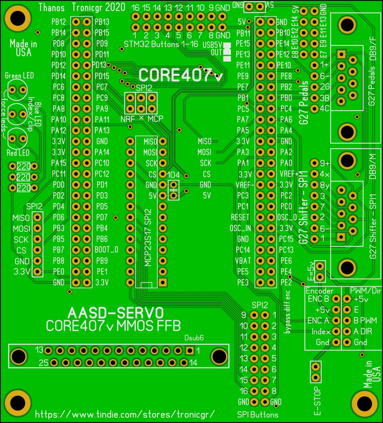

    Someone ought to make a PCB for this to be plug and play... no hustle with wiring (my nightmare lol ).
    But I know what to use for that extra 90st motor for now, not as powerful as 130st one, but will do for my weak hands... lol

    I did start mapping out a pcb then forgot all about it haha, never done one before so was working off tutorials, thought it would be a fun project. Then just solder on a db 25 connector and plug in the stm32 board and away you go.

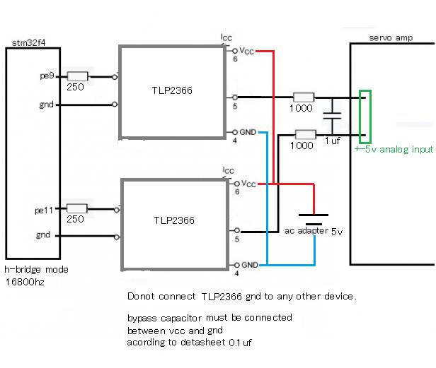

    The low level of the STM32 output may not be 0v.
    You can adjust pn190.
    But I don't think using pwm directly is a good idea.
    Dac introduced by Thanos,
    or you should use a cr low pass filter.2000Ω 1uf I recommend.
    I think Pn188 can be lowered to 1ms or less.
    Dac looks like a good solution, but I think you need to test if it's perfectly smooth to human hands.
    If you can't solve the point where the force switches or other problems,

    Ok, all done... I'll be ordering a few pieces made to try on my servomotor...
    I added in the circuit pads to install the DAC to try if its better with clean signal.
