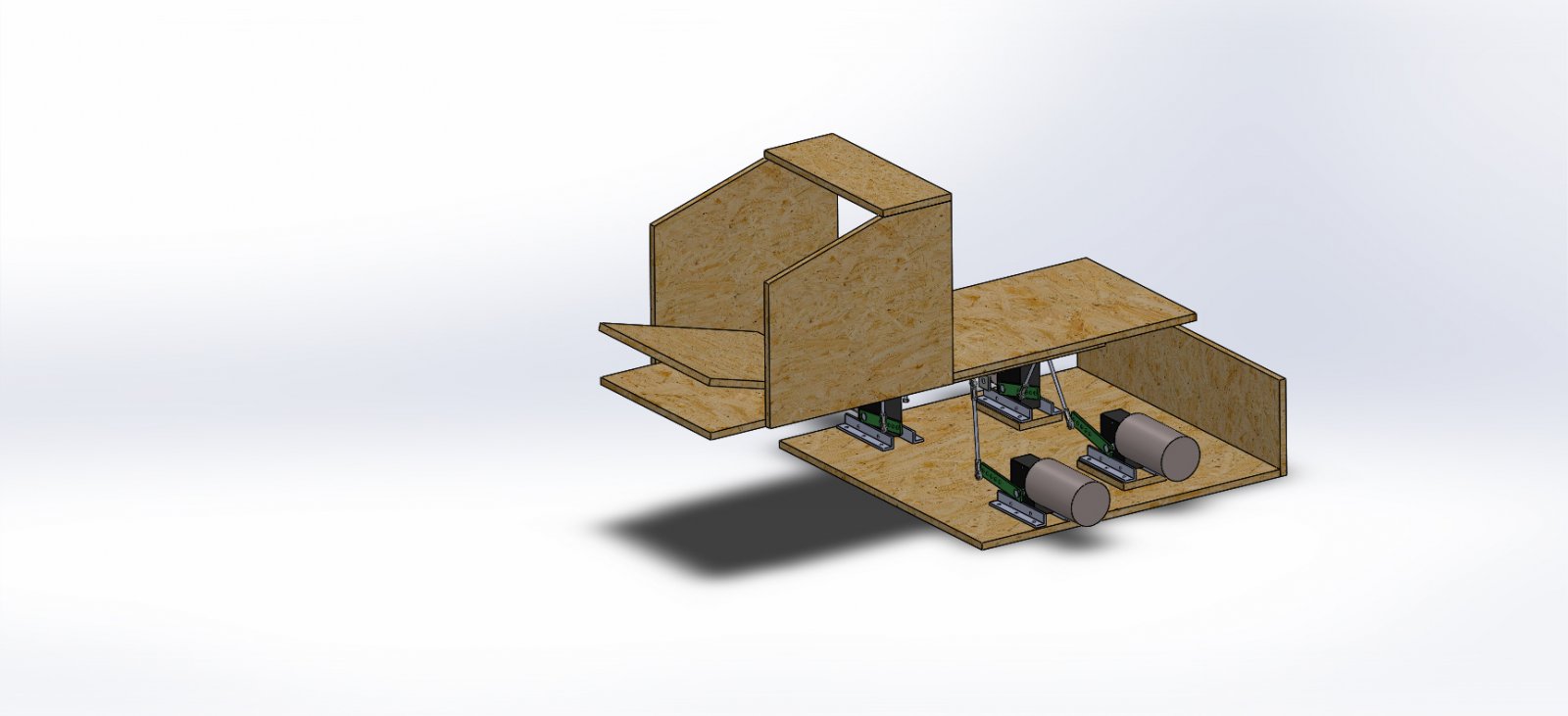

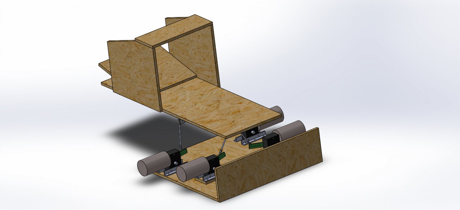

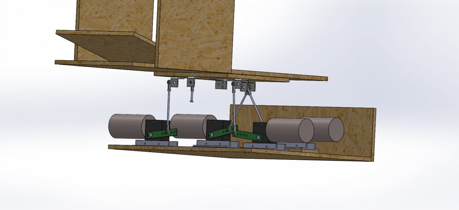

    Hello, the plans for my first simulator her almost completed and I am counting to share them with you.
    It still lacks incorporate a stabilizer bar system, I also work for installing a spring. The bench, steering wheel and pedals are not drawn but it is easy to figure where they will be located.
    Feel free to give me your impression.
    Bonjour, les plans de mon tout premier simulateur son presque complété et je suis comptant de pouvoir les partager avec vous.
    Il manque encore à intégrer un système de barre stabilisatrice, je travaille aussi pour installer un ressort. Le banc, volant et pédalier ne sont pas dessiné mais il est facile de figurer où ils seront situé.
    N'hésitez pas a me donner vos impression.

    A compact design will need a spring assist or very powerful motors.
    You could possibly gain a bit more leverage by extending the top base back a bit and spreading the motors a bit further apart.
    You will need to get the balance right, including with yourself and all peripherals.
    Keep the upper frame as light as you can get it without compromising rigidity.
    I have found I prefer motors that can't be back driven, as I have an adjustable assist spring that balances the user weight but exerts upward pressure on the motor when the sim is unloaded.
