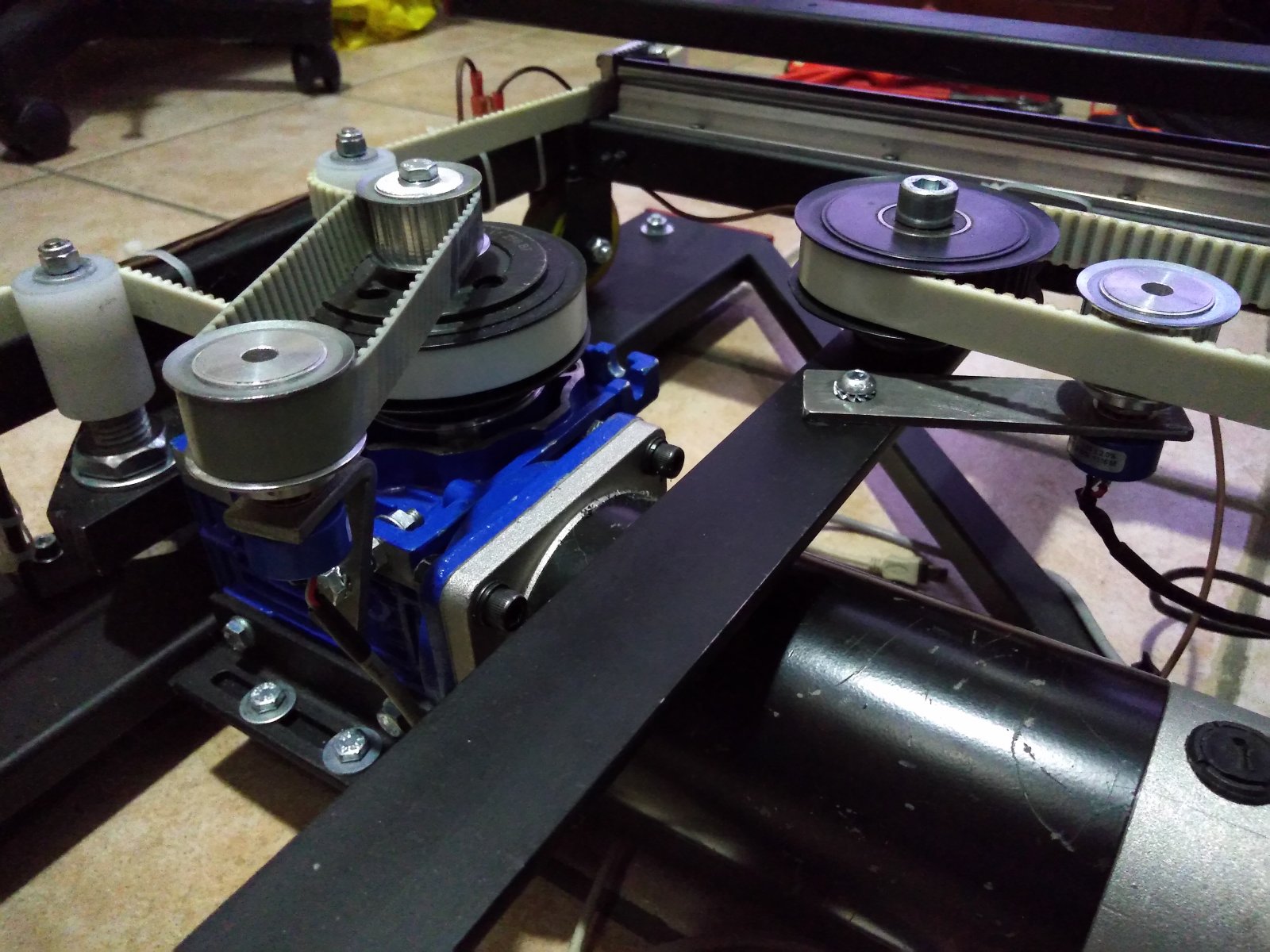

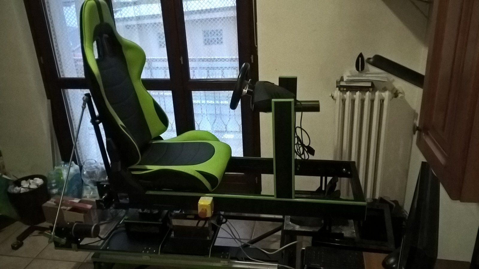

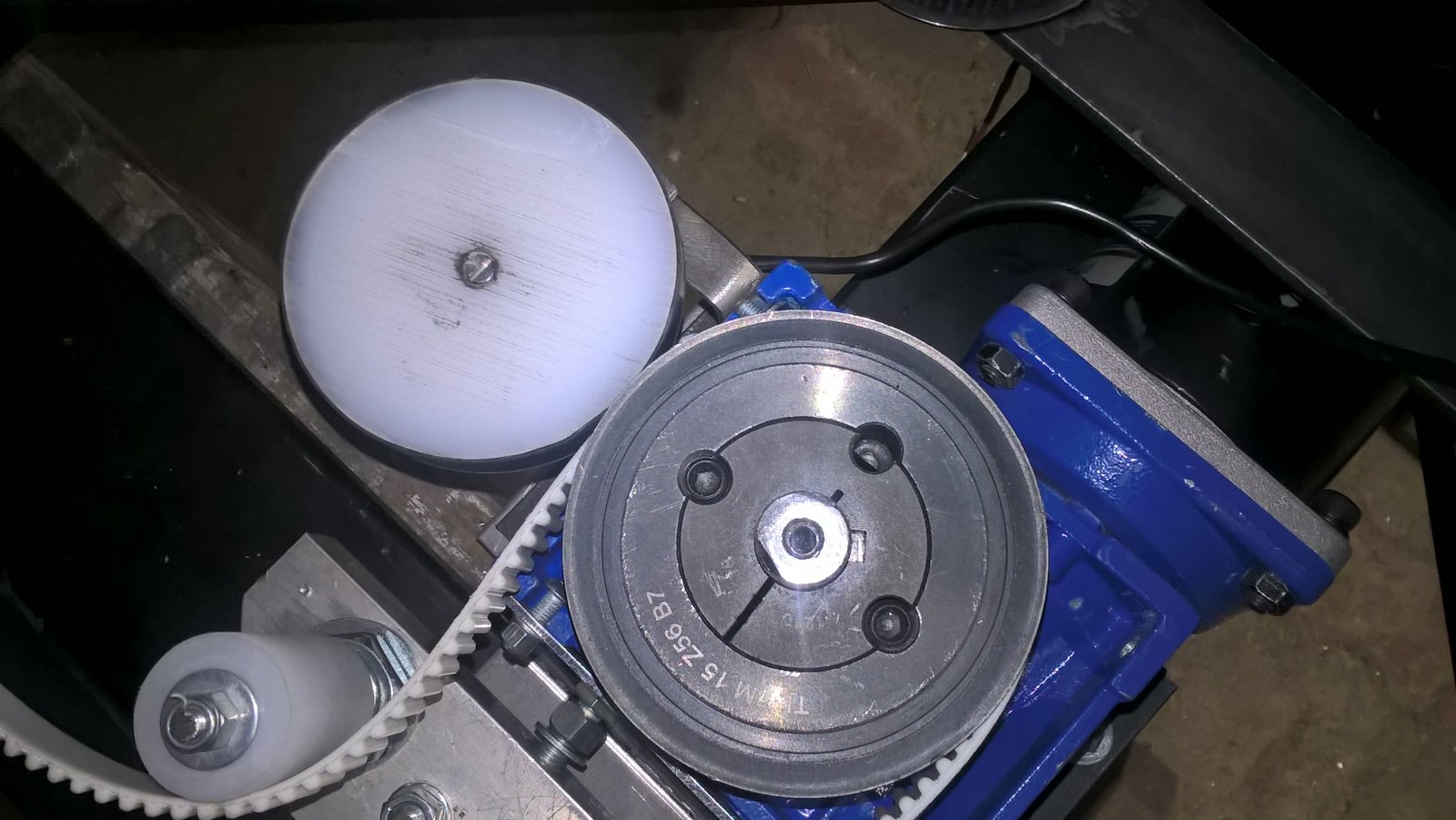

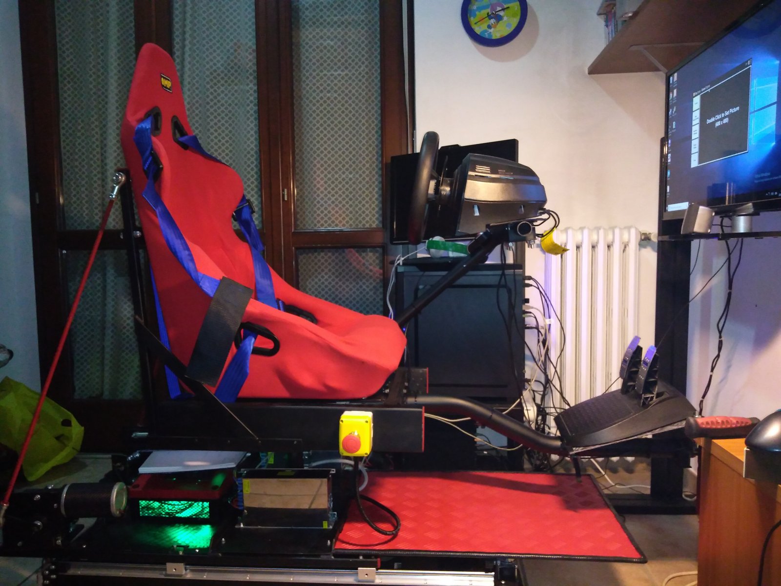

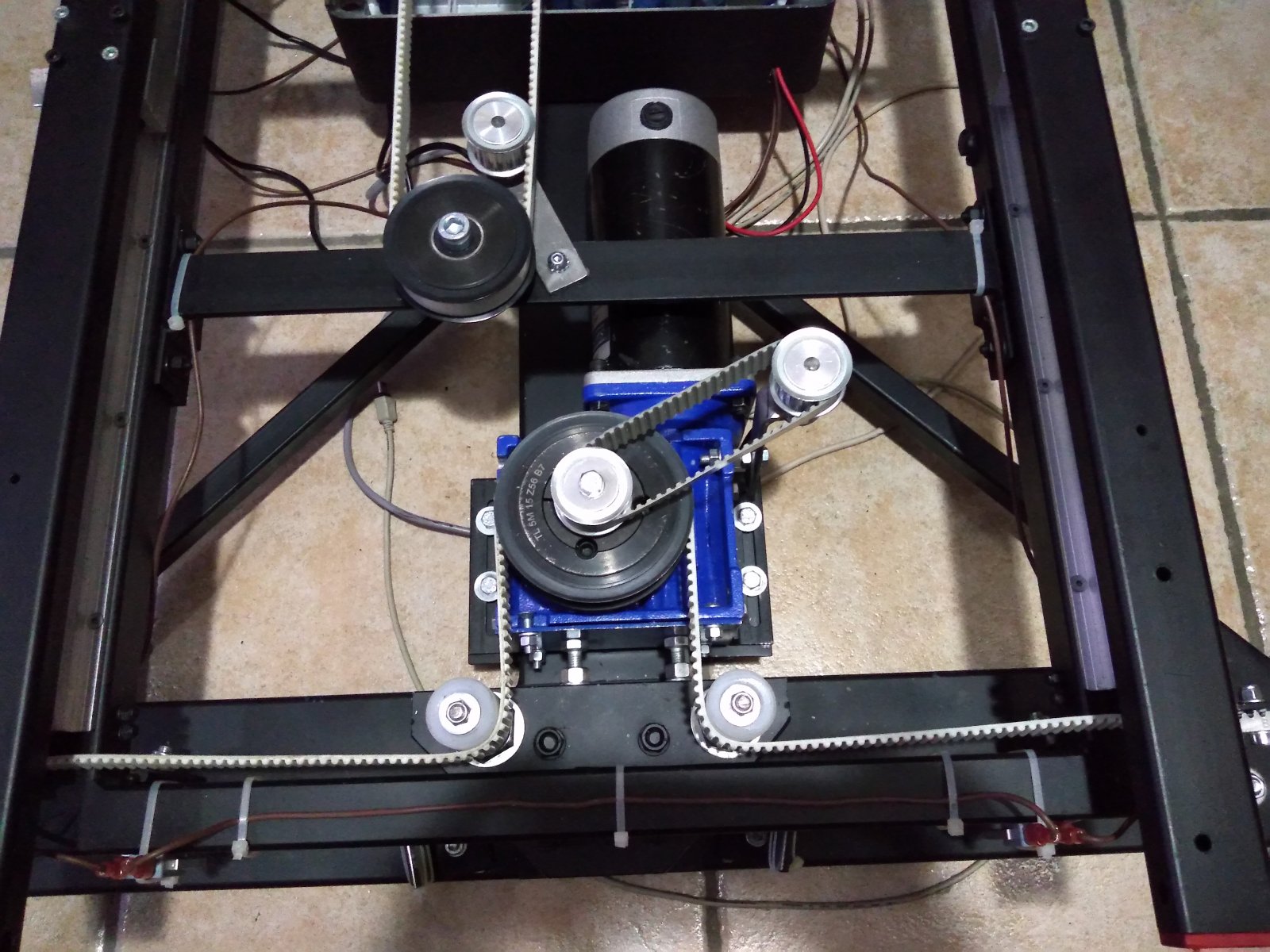

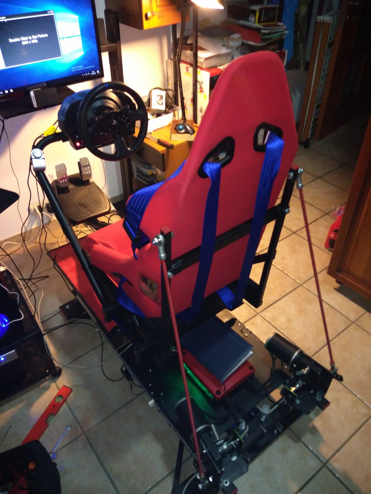

    ... then, before to post the settings a couple upgrade about the modify of the rig.
    This was the connection with the potentiometers:
    but didn't work well because to much slip between the wheels .
    This is the new solution
    This was the old rig
    This is the new one

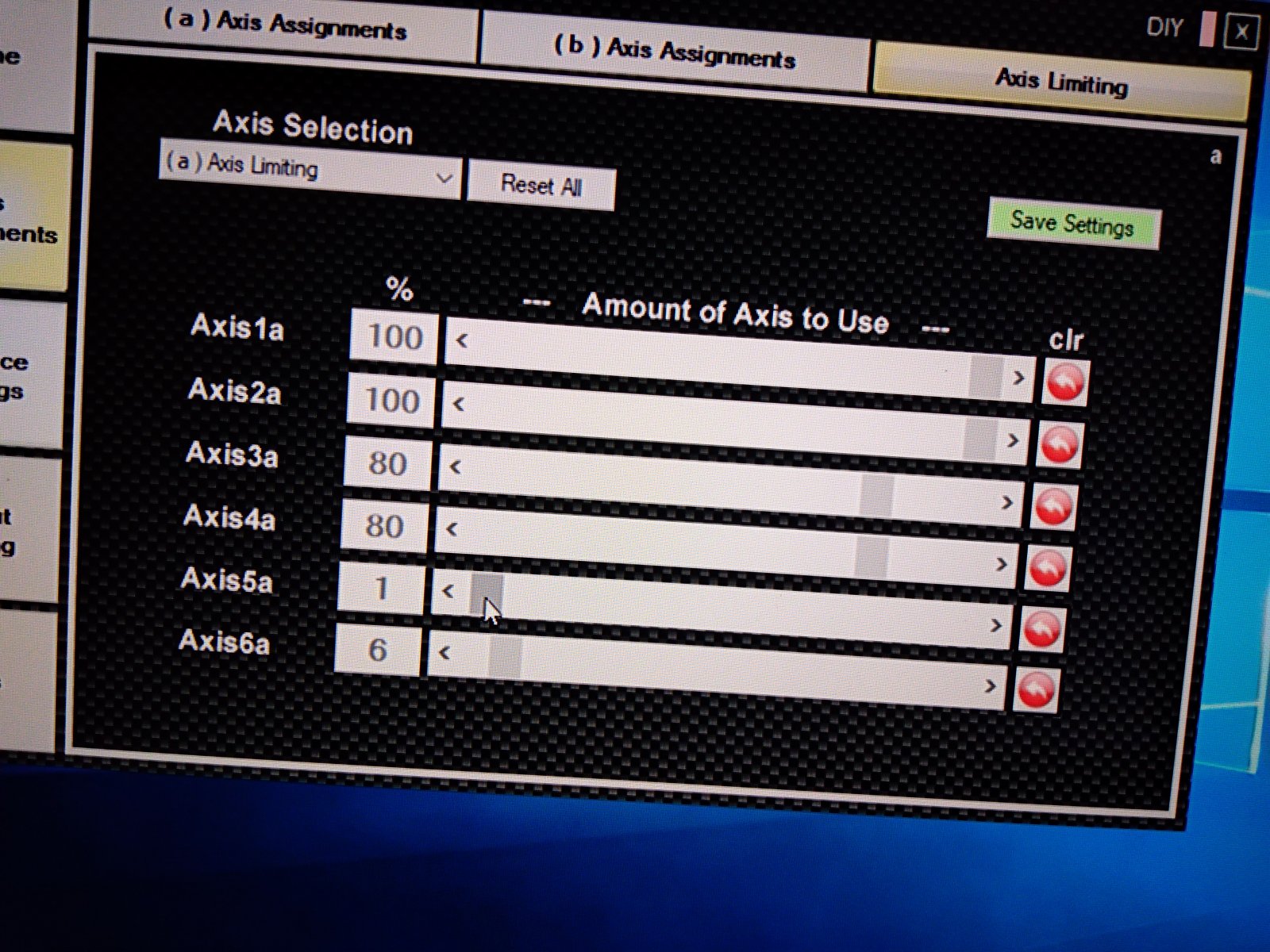

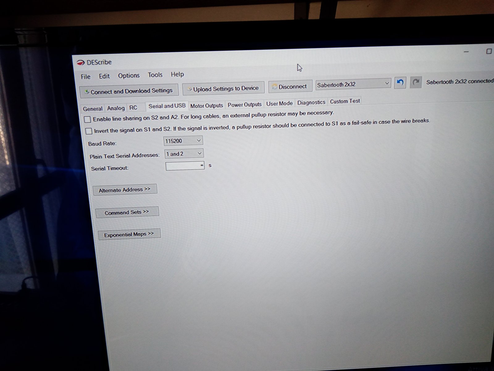

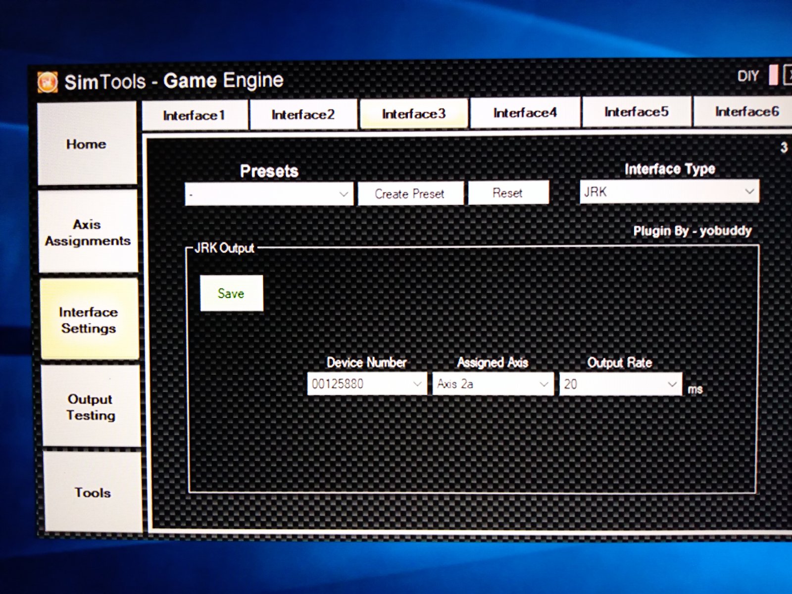

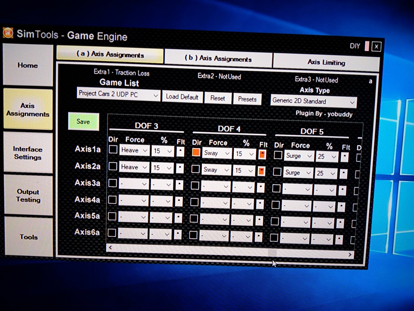

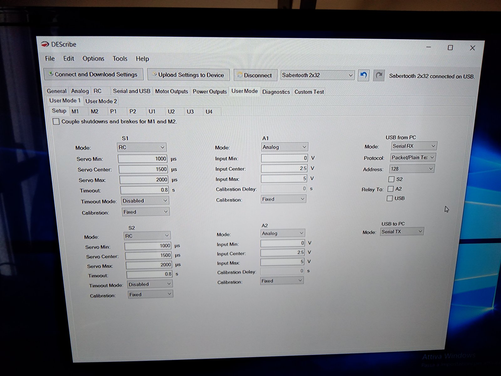

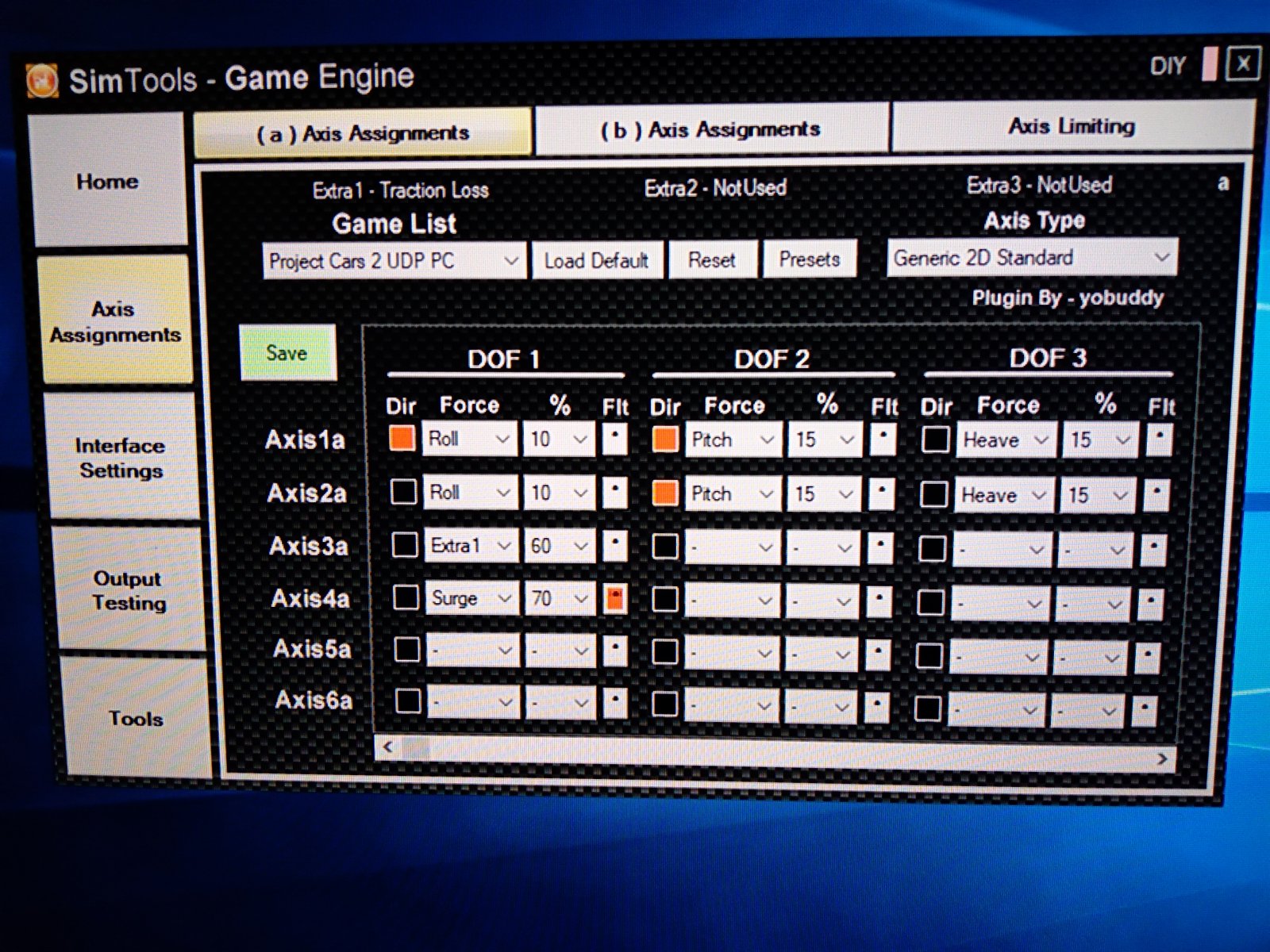

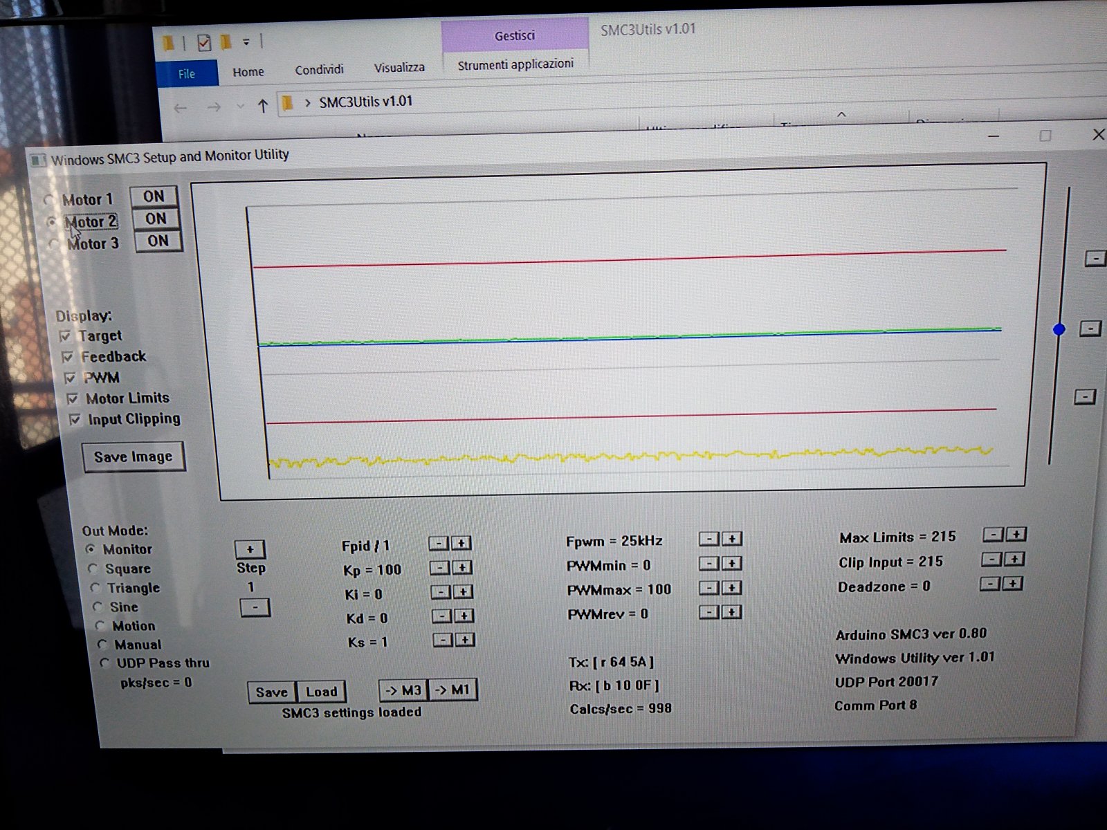

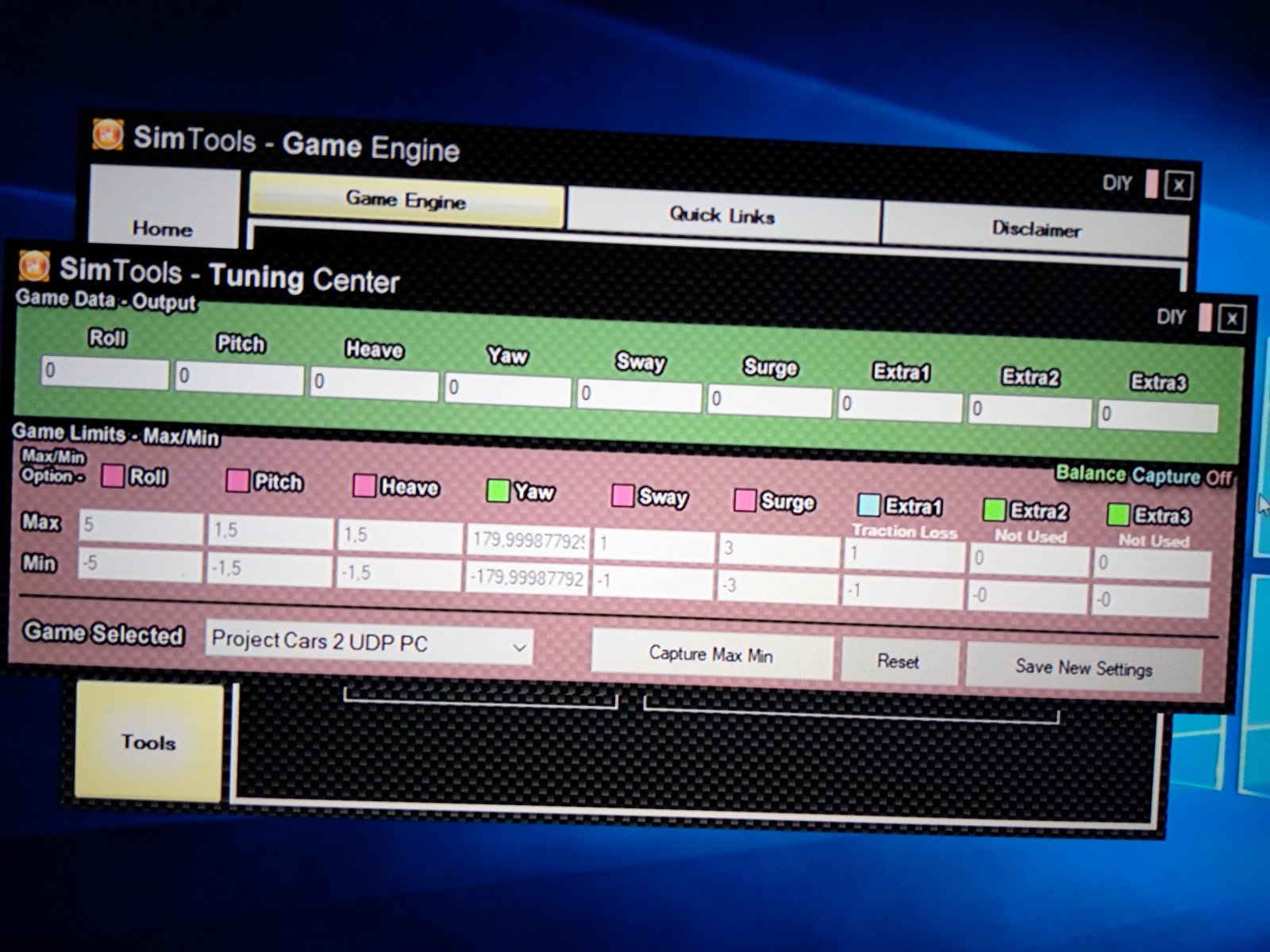

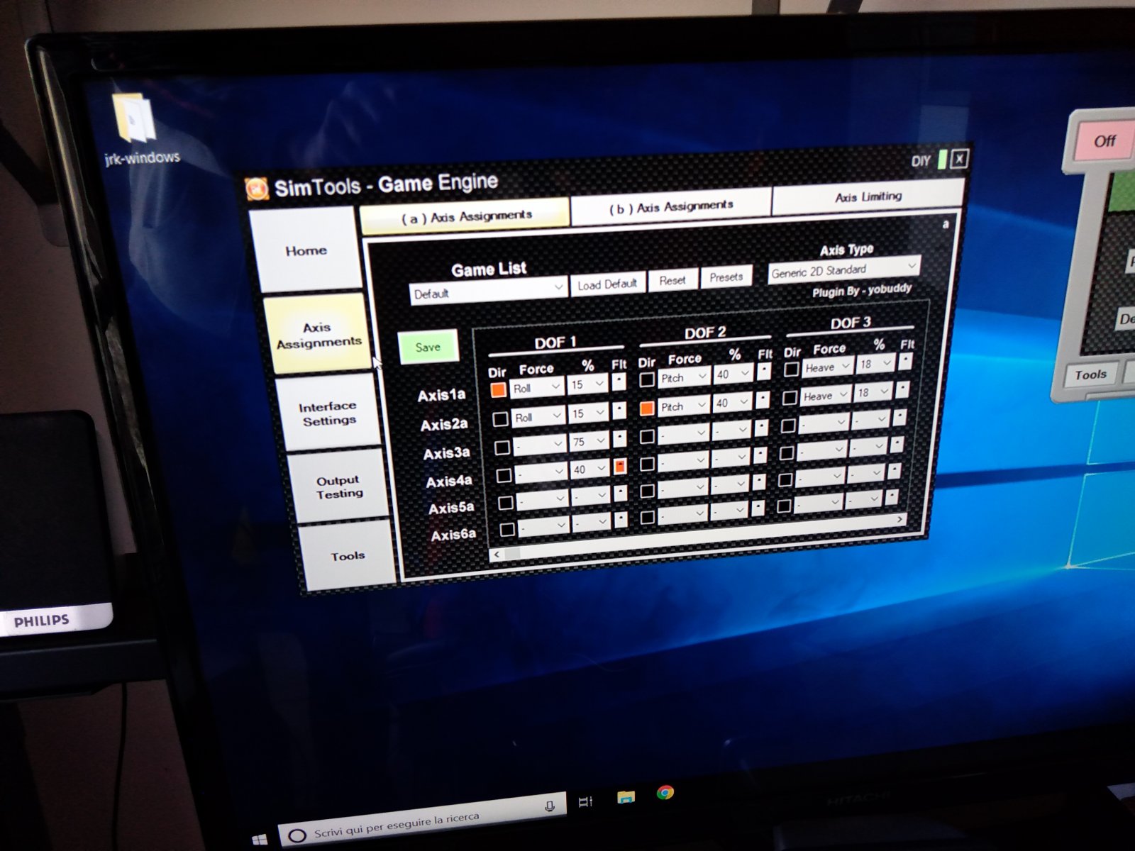

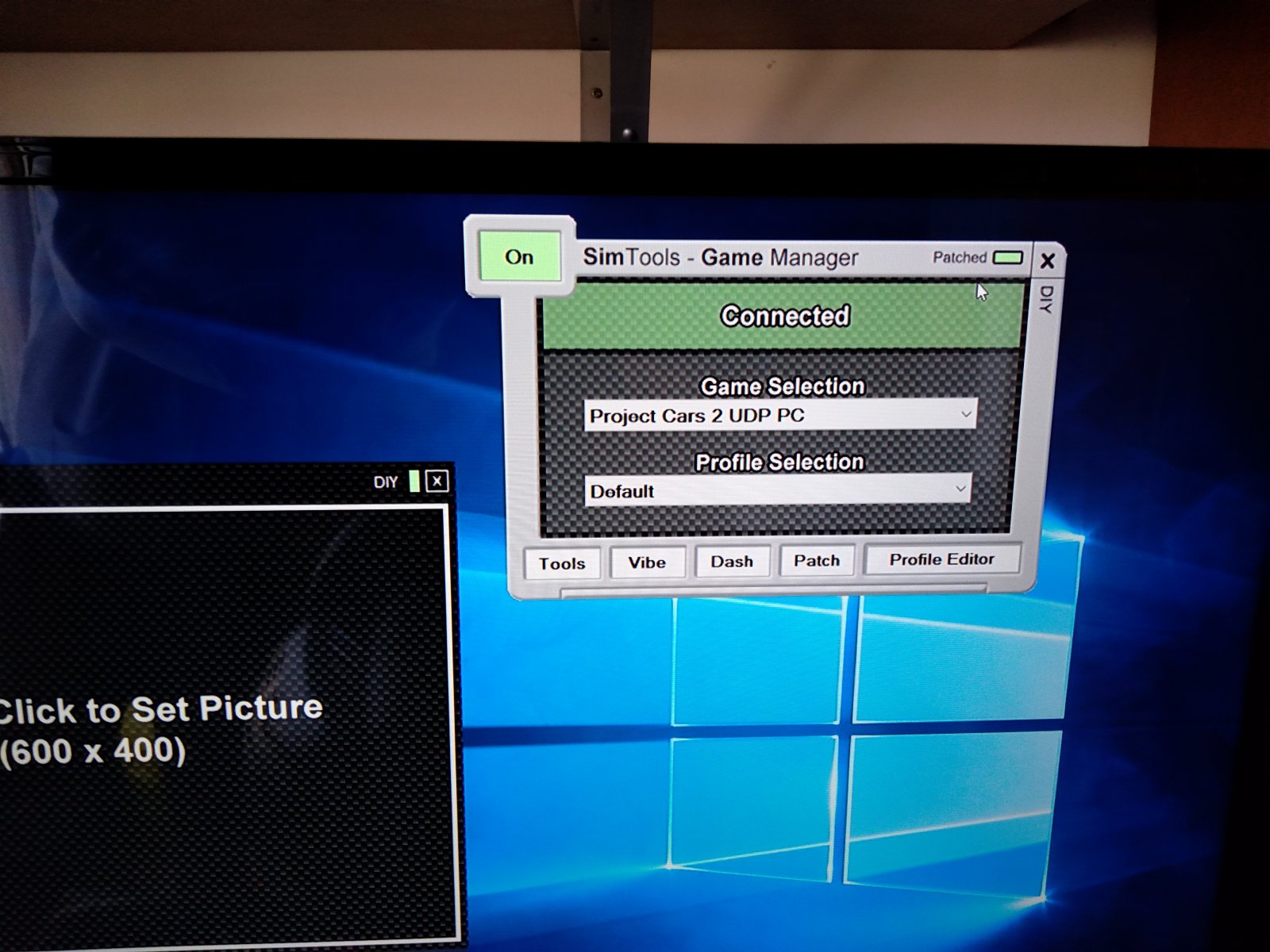

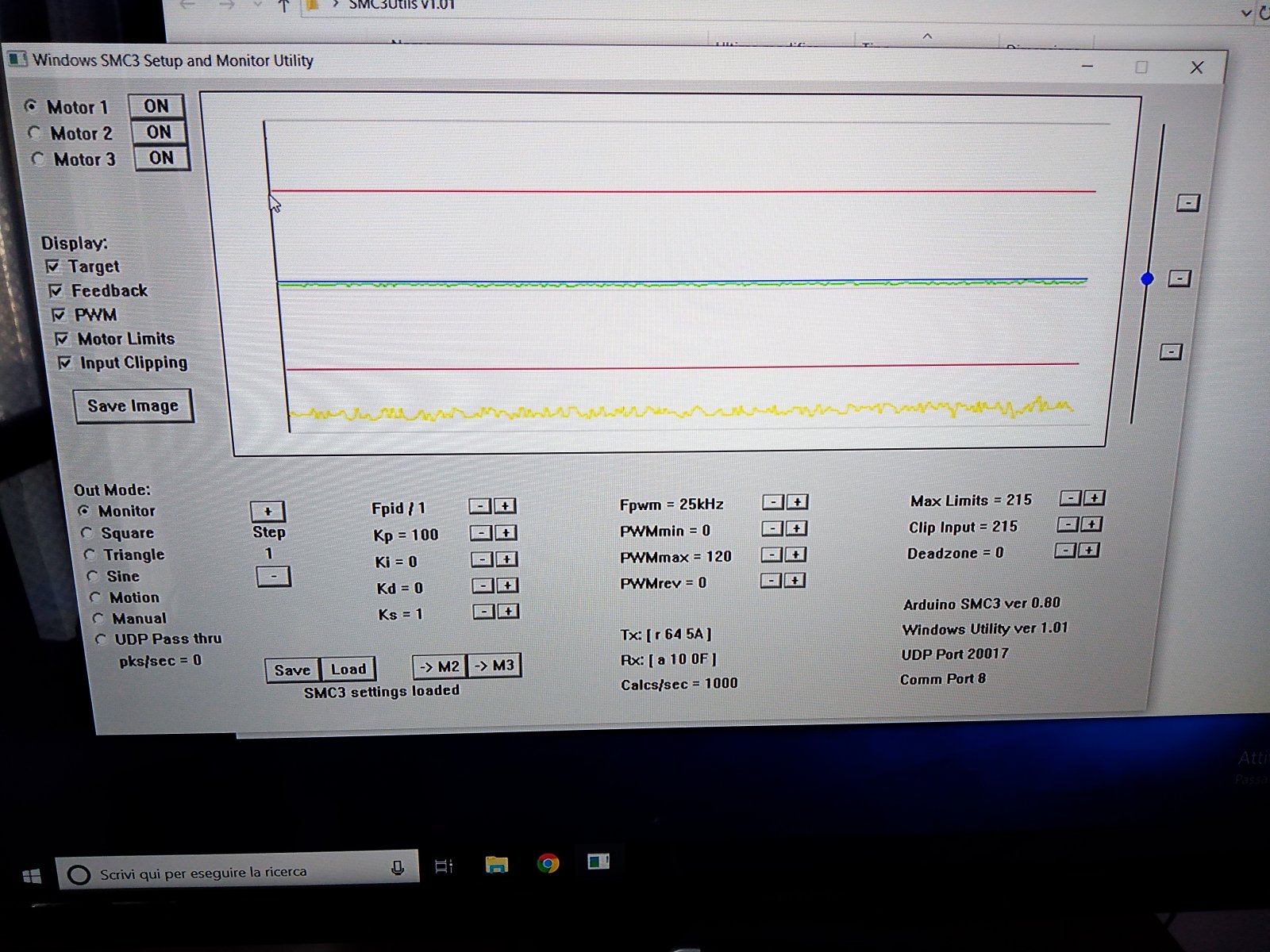

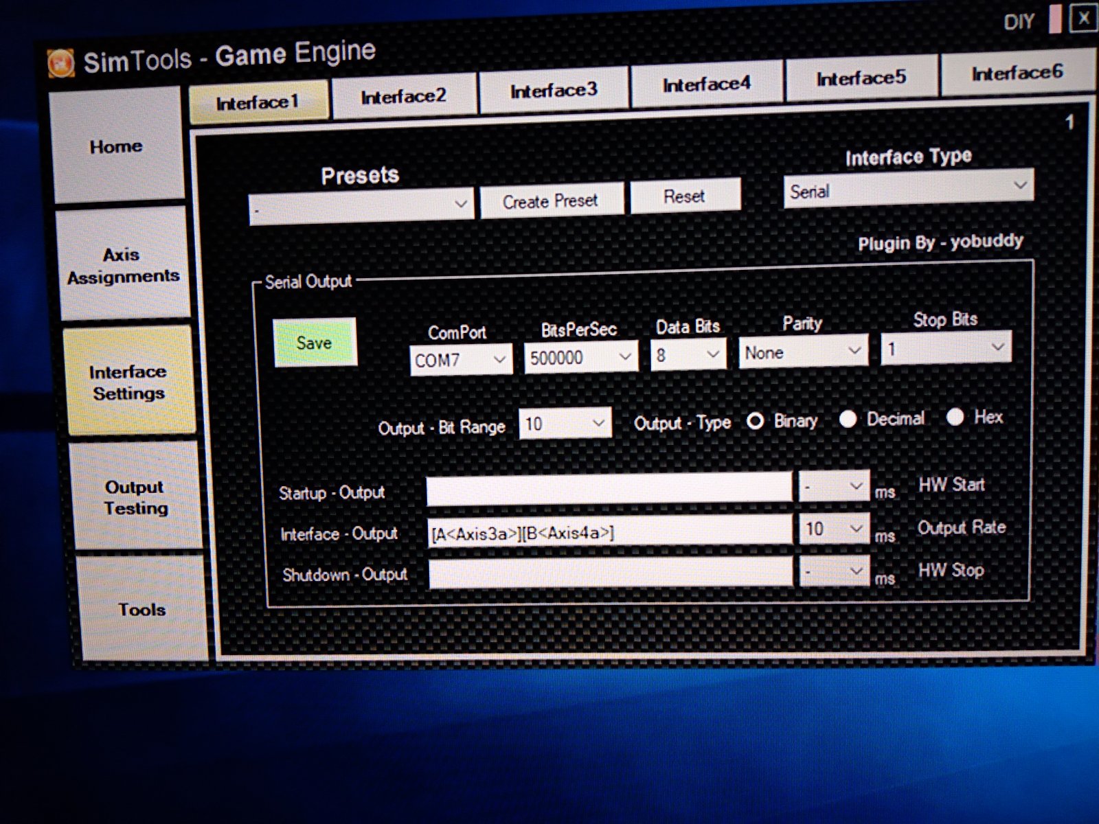

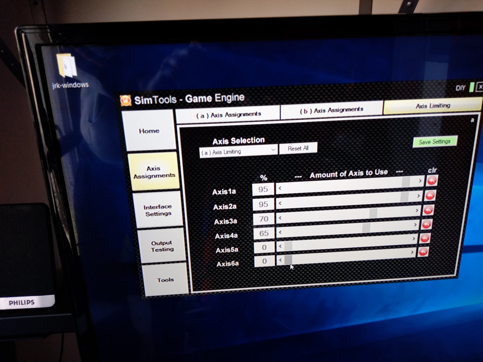

    Hi to everybody I have a problem.
    My sim use for the movements 1 arduino uno and sabertooh 2x 32 (surge and TL ) and 2 JRK 12v12 to move the seat on universal joint.
    Everything was fine and funny :grin.
    Yeserday, for my fault I have fried a JRK.
    Because I had another Arduino uno and another Sabertooth 2x32 I installed them instead the 2 JRK
    No problems moving both motors with SMC3 Utils V1.01 but when I test the movments via SIMTOOLS OUTPUT TESTING one of the motors answer with a big delay (this do not happen with SMC Utils motion)
    Have someone some suggestion?
    SIMTOOLS is version 2.4
    ARDUINO has SMC3 packet serial beta 8 soft start installed
    SIMTOOLS is:
    bit per second 500000
    data bit 8
    parity None
    stop bit
    Intrface output 10ms (axis assignment is ok)
    I checked Sabertooth baud rate and is 115200
    Of course when run the game (PC cars 2) the movements are completly ...awfull
    I also changed language in windows 10 with english USA also if probably didn't need.
    Something else to check ?
    Thanks a lot
    22,048
    153,884Coins
    +11,154 / 57 / -2
    Could you please post pictures of all of your settings.

    Here some pictures ...
    IMG_20200119_140240_BEAUTY.jpg IMG_20200119_140311_BEAUTY.jpg IMG_20200119_140432_BEAUTY.jpg IMG_20200119_140508_BEAUTY.jpg IMG_20200119_140658_BEAUTY.jpg IMG_20200119_140717_BEAUTY.jpg IMG_20200119_141332_BEAUTY.jpg IMG_20200119_141347_BEAUTY.jpg

    A rapid upgrade.
    The problem seems to be solved changing the value of Fpid in Smc3 from 1 to 2. I will test better next days
