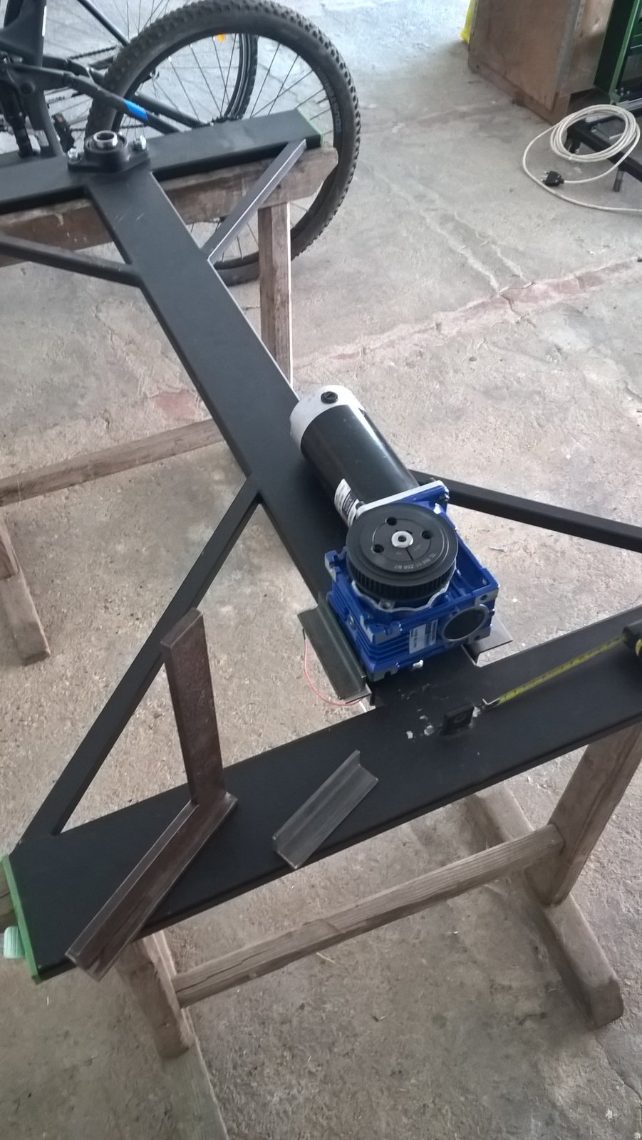

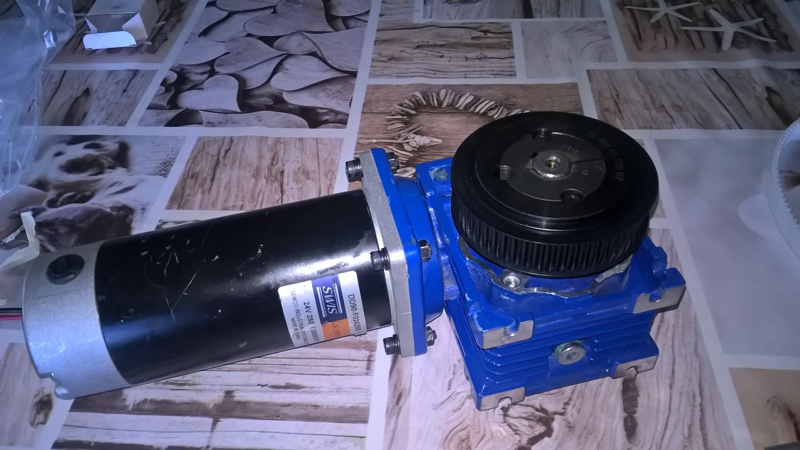

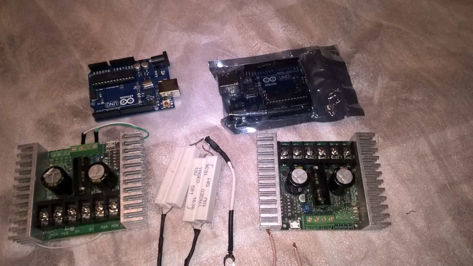

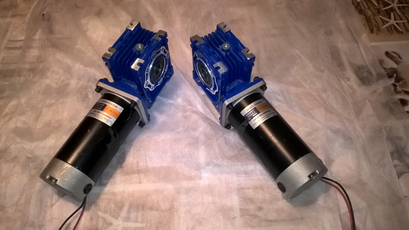

    Hi everybody,
    after more then one year finally I started with the add of TL and surge.
    I decided for Ard and sabertooth 2x32 and 2 gearmotors 24 V 60:1. I bought the stuff here on the Marketspace form WP_20190401_20_59_31_Pro.jpg WP_20190401_20_59_52_Pro.jpg WP_20190401_21_01_42_Pro.jpg WP_20190401_21_03_43_Pro.jpg My.stAr

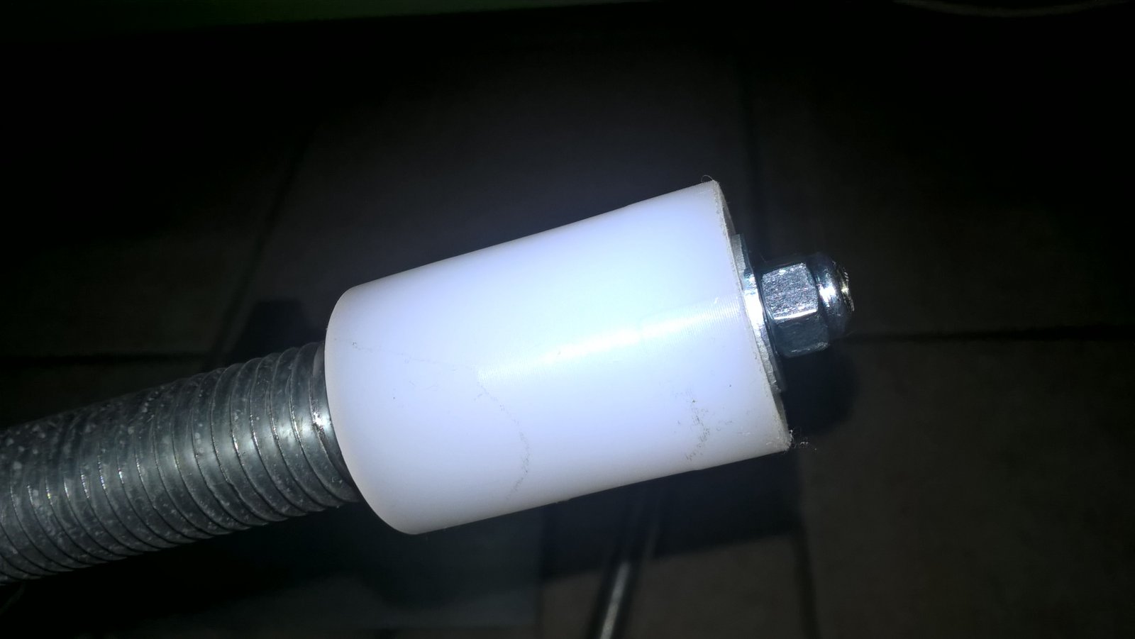

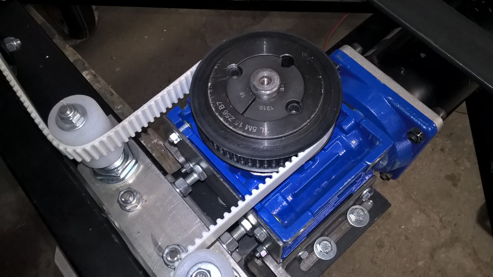

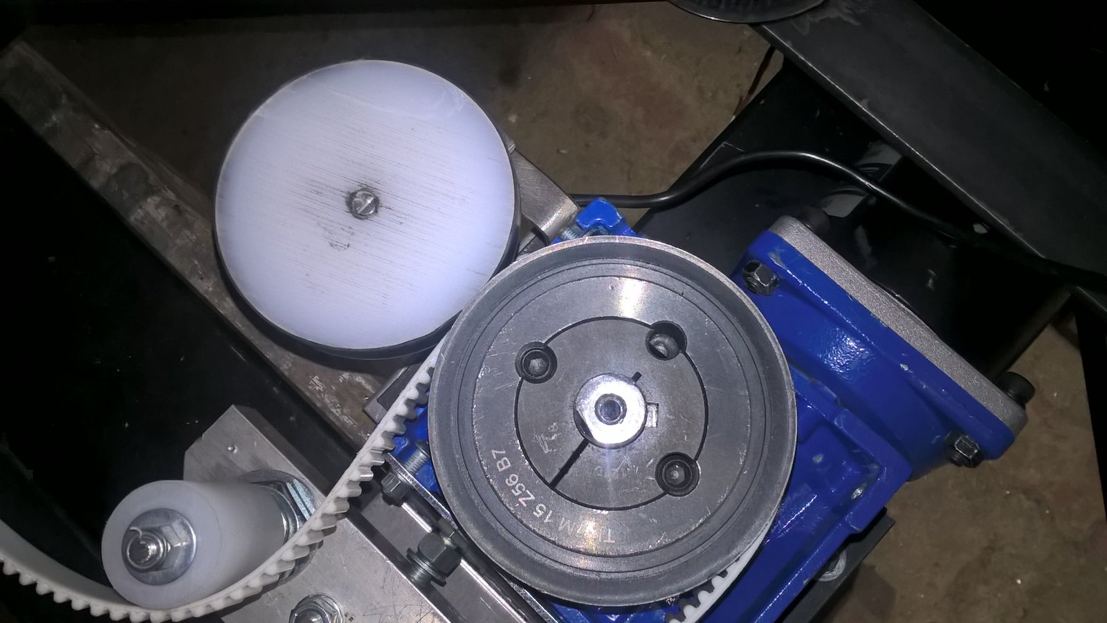

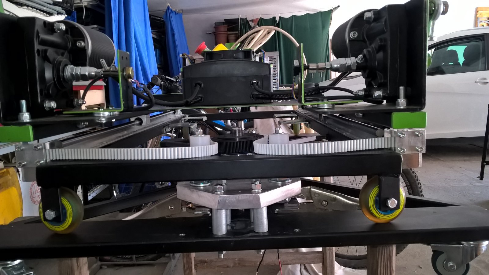

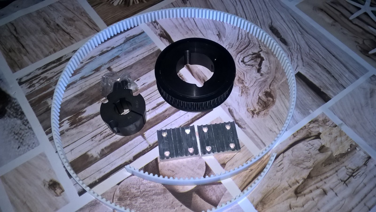

    Then, in stead of the levers I decided to use the timing belt, and bought some other stuff here, from a store near home .....

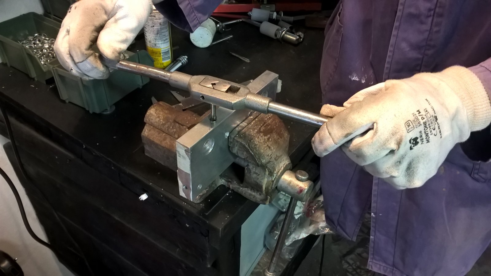

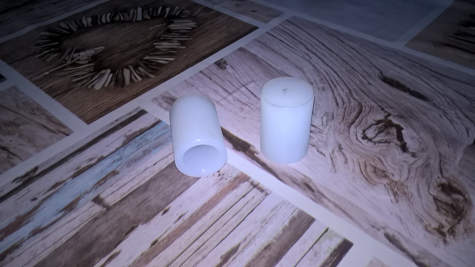

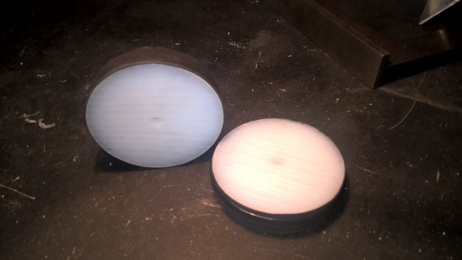

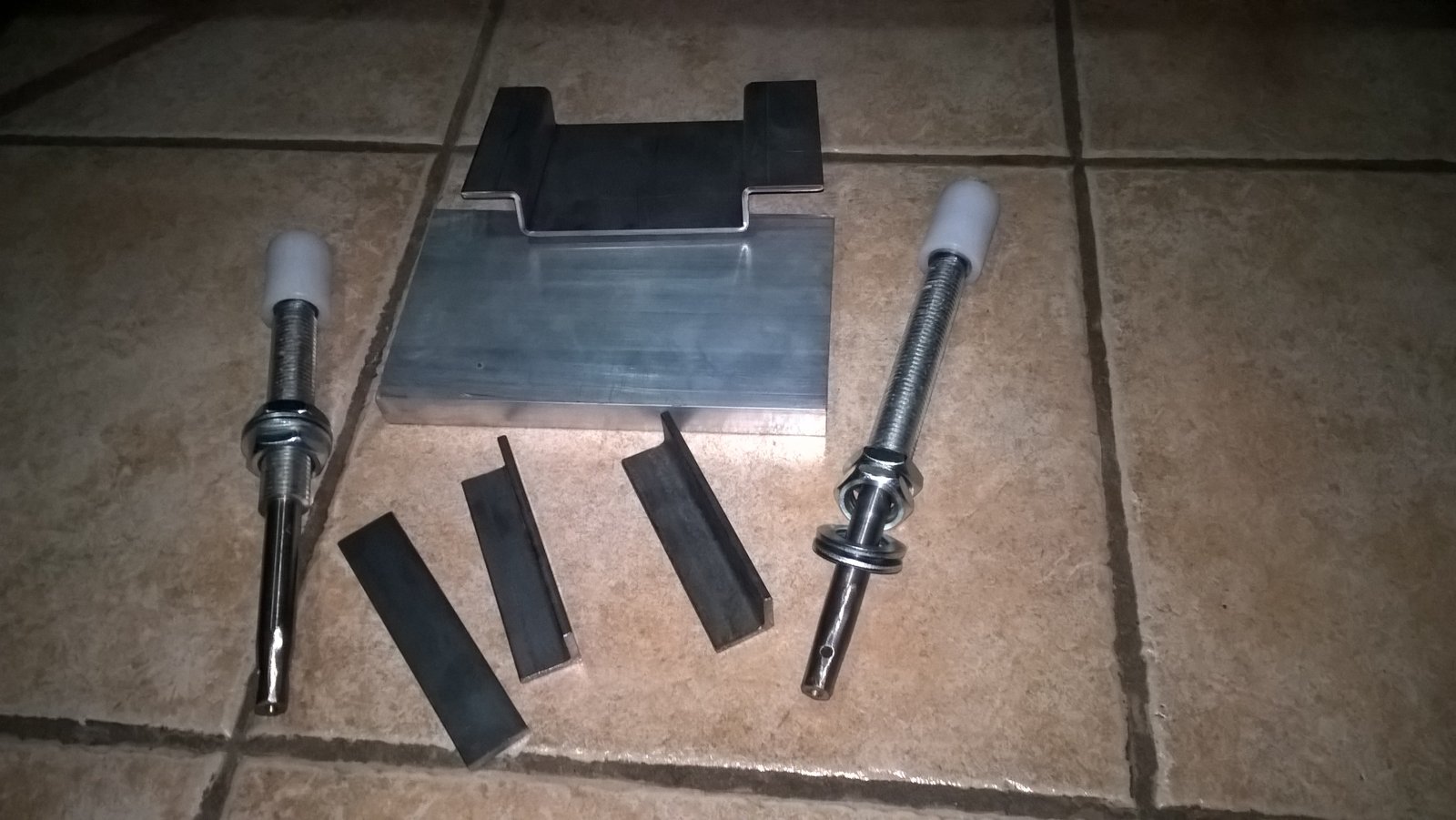

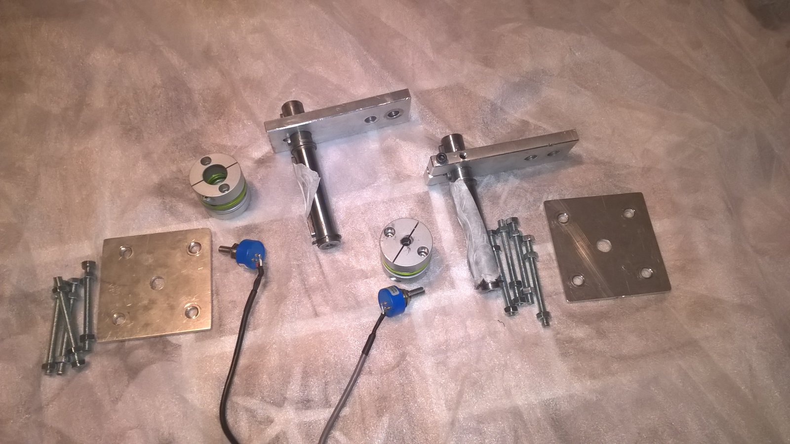

    ... and also have prepare some parts by myself.
    WP_20190412_18_44_03_Pro.jpg WP_20190415_21_09_05_Pro.jpg WP_20190415_21_08_19_Pro.jpg

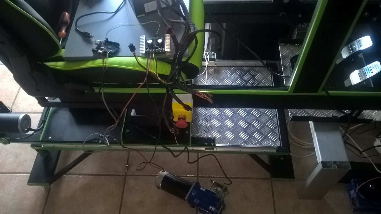

    ... in the afternoon played with Ard and Saber.
    Everything seem to be ok :grin
    Manual movements with SMC3 are ok and manual movements with simtool too. Of course these are first movements but I'm happy for that.
    For test I used the PSU of my old pc (12 V ) and it works if I change slowly the direction but if the changement is fast it shut down . But this is normal. The motor is 24 V 250W so....
    I'm ordering a PSU 24 V 1000 W. I think wil be ok for these motors

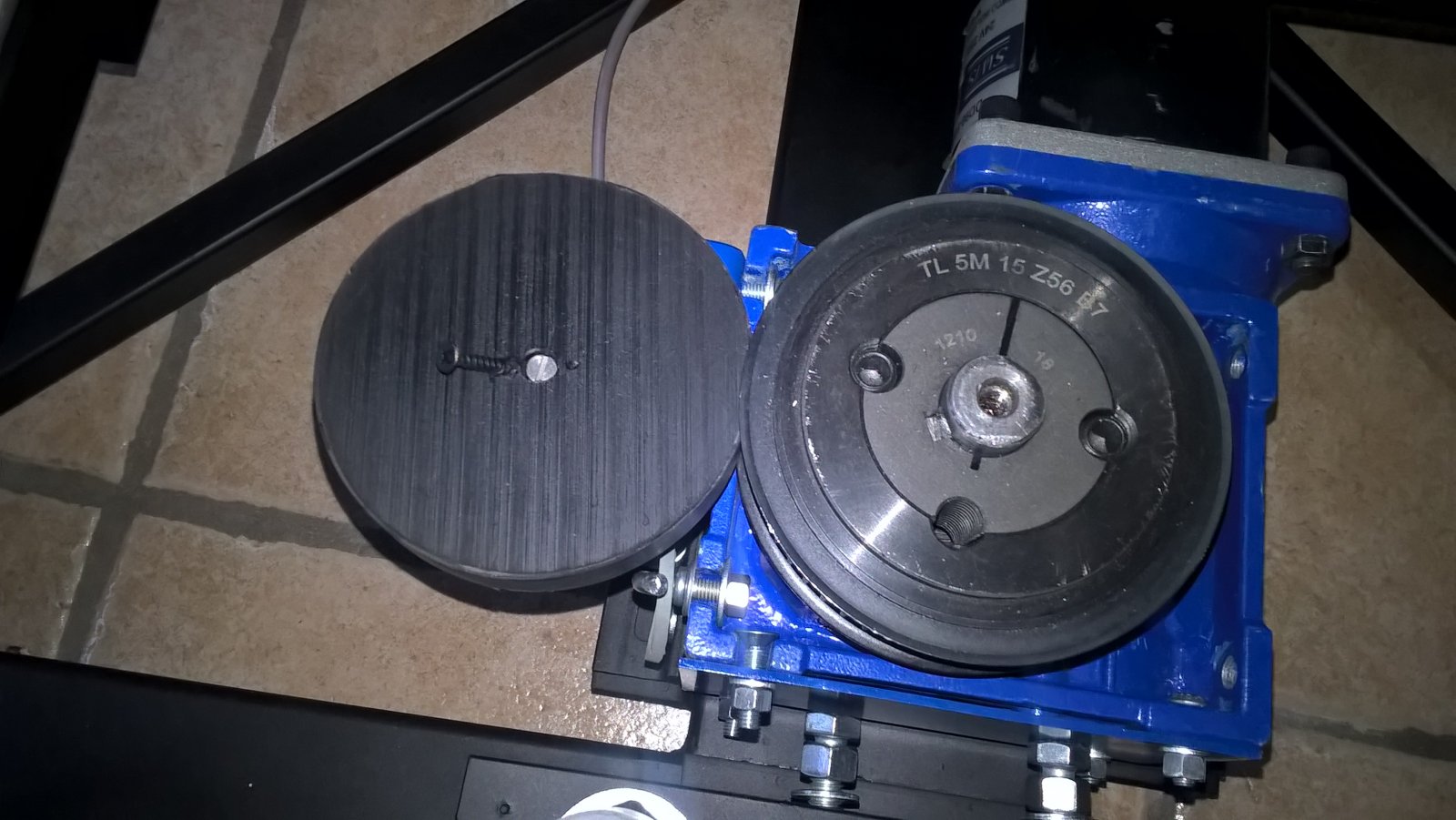

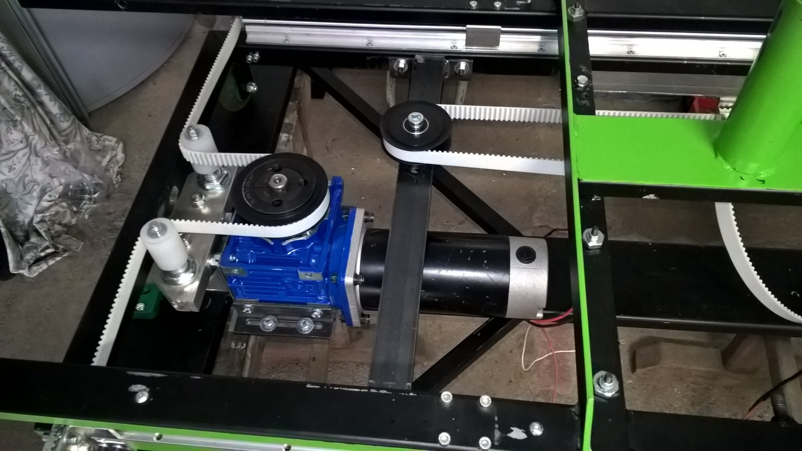

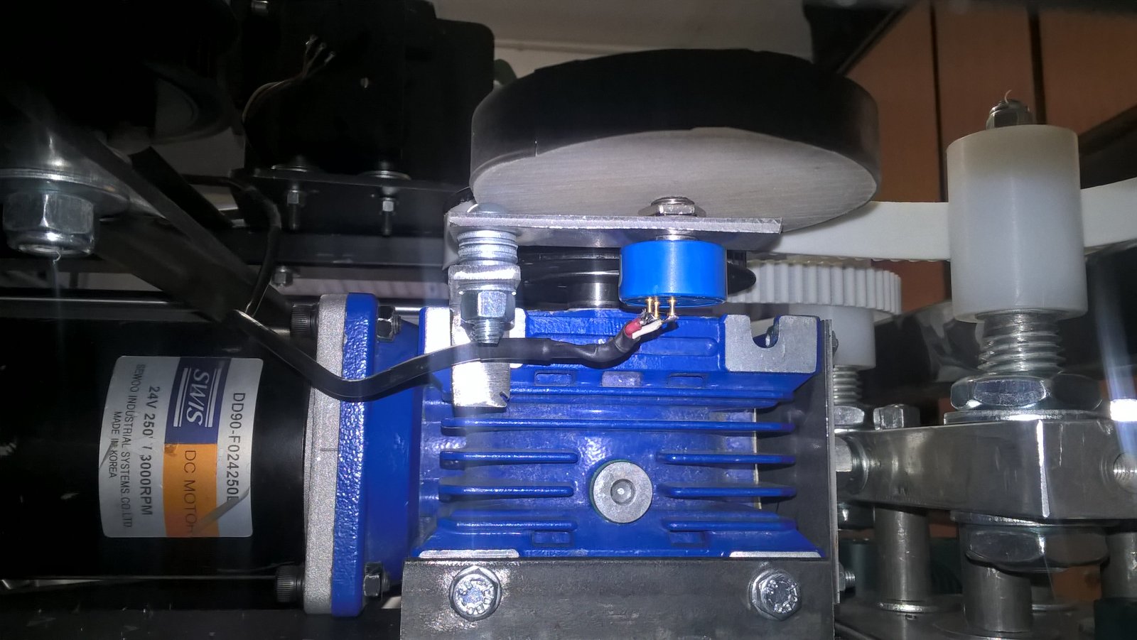

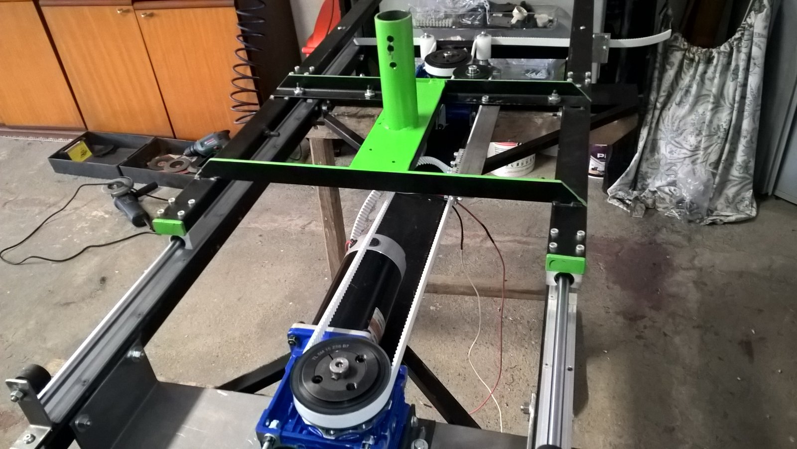

    .....then
    WP_20190426_10_59_38_Pro.jpg WP_20190426_17_19_21_Pro.jpg WP_20190427_15_54_41_Pro.jpg WP_20190427_20_47_01_Pro.jpg
    TL almost ready.
    A couple of thing to finish off and start to think about sourge :thumbs

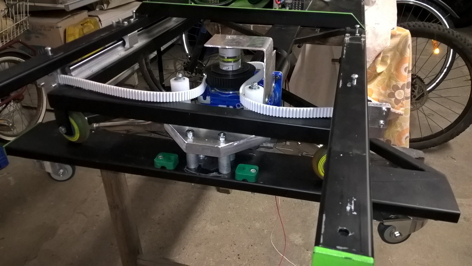

    Hi everybody, after a lot of time I'm almost ready for the first test with Arduino one and sabertooth but here some pictures of the work done
    WP_20190525_15_37_11_Pro.jpg WP_20190525_15_38_02_Pro.jpg WP_20190525_15_39_09_Pro.jpg WP_20190525_15_36_53_Pro.jpg

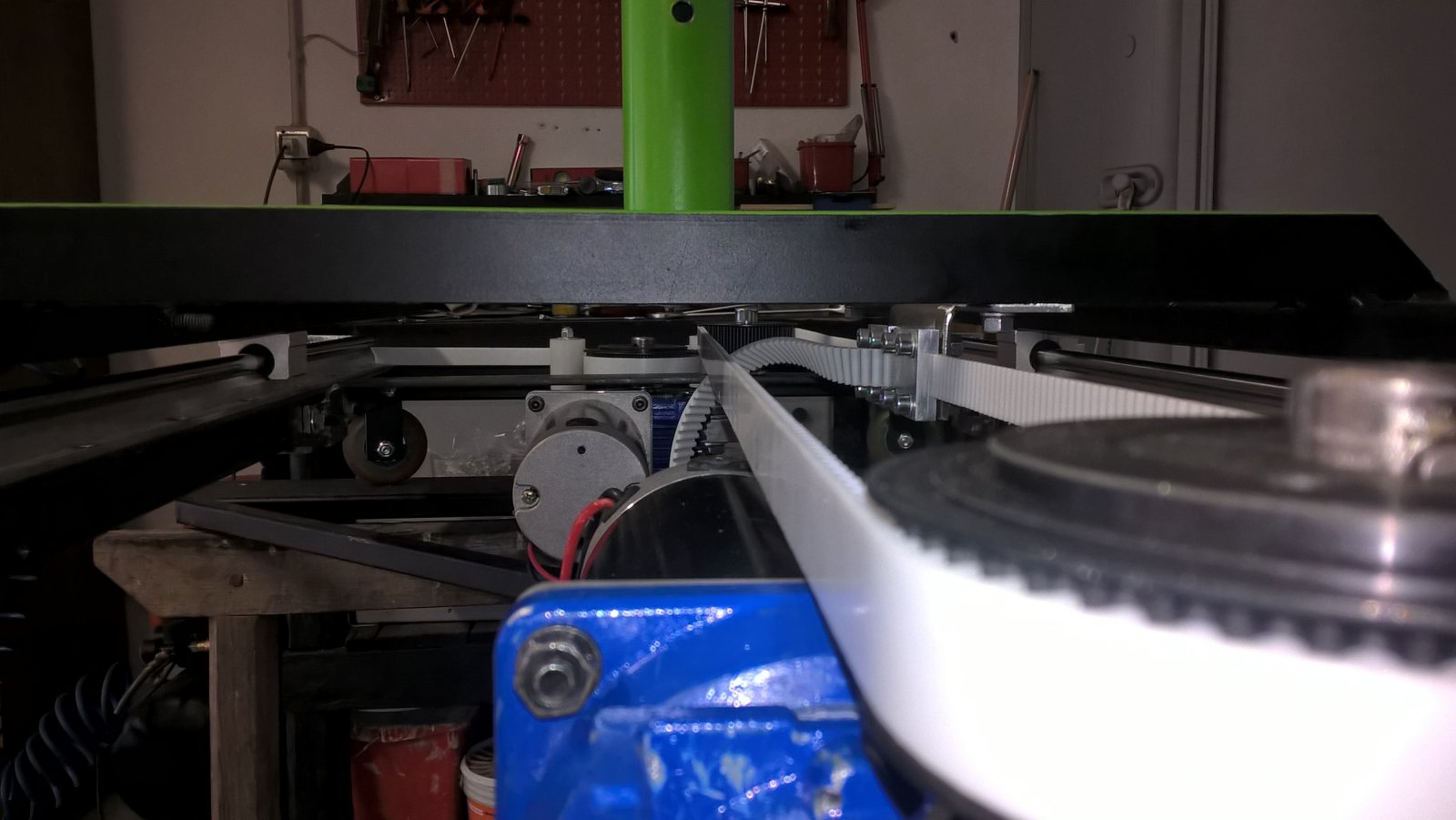

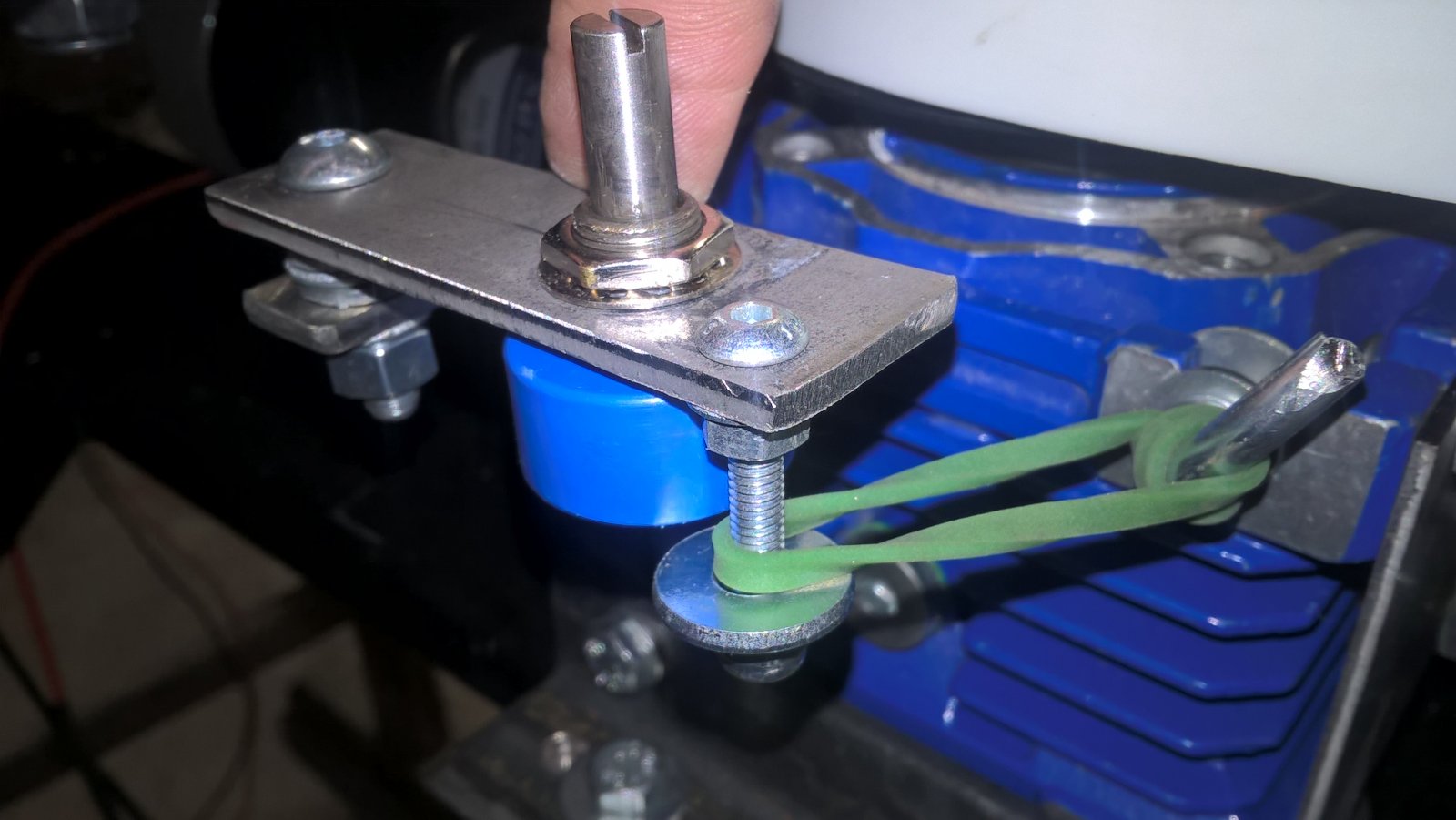

    ...also change the system to use the pots from this
  13. Enrico
    Enrico Member
    Feb 5, 2018
    123
    417Coins
    +28 / 0 / -0
    4DOF
    ...to this...
    WP_20190530_21_01_19_Pro.jpg WP_20190603_20_43_31_Pro.jpg WP_20190603_20_43_56_Pro.jpg WP_20190603_21_20_00_Pro.jpg WP_20190620_20_26_48_Pro.jpg WP_20190620_20_27_07_Pro.jpg
