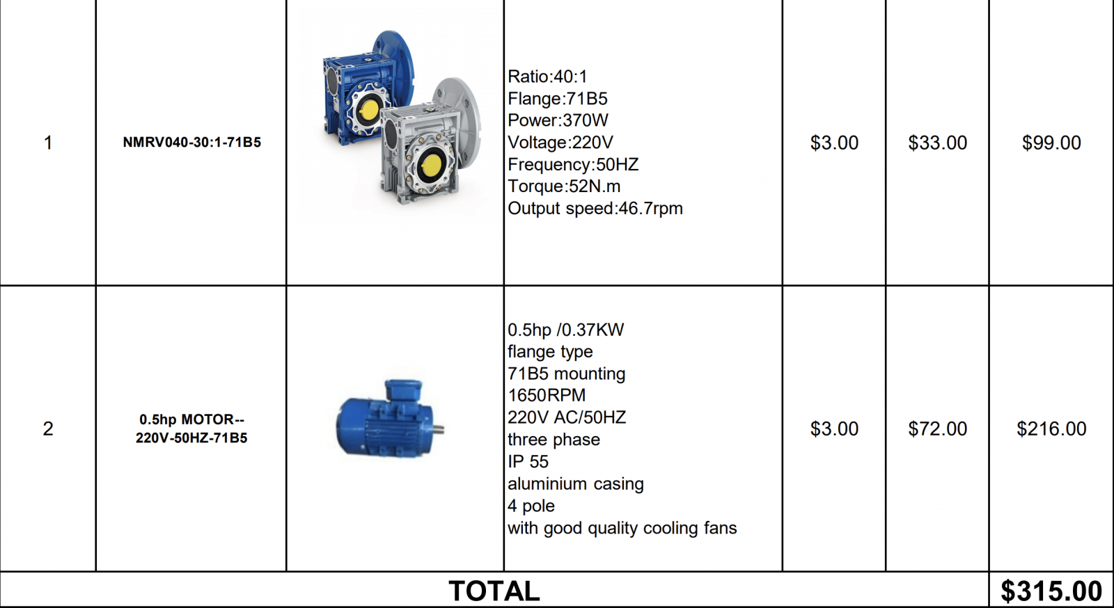

    I'm evaluating my options for my motors (3 motors- 3DOF flight sim platform).
    I have been quoted this from China:

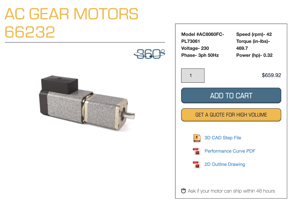

    This is gonna sound super naive to some of you probably but I've seen people paying 650$ for 1 motor with similar specs, like this one for example:
    The price I got from China is for 3 motors and 3 gear reducers.
    I'm confused. What am I not getting here?

    Depends if you want to take the risk? I have seen many people try to get these type of motors working properly and have ended up walking away as the accuracy of movement/noise etc were all issues. You could try ordering one set + controller and see how it goes? There are although proper AC servo solutions out there that are now not that expensive (relatively speaking to what it use to cost in the past) and are known to work great.

    Thanks a lot for your replies. This makes sense to me, but have you seen the video in my post above? I have checked with the manufacturer that quoted me and they said it was the same model except smaller, so I guess I should be good..
    Follow up question I had about AC motors for motion platforms in general, regarding their service factor/duty cycle.
    The motor/gearbox I had in mind has a service factor (sf) of 2.1, with 35RPM and a torque of 70Nm.
    Can anyone tell me if this service factor is a bad, average or good value? It seems to range from 0.8 to 2.6 sf depending on torque and rpm combo but how does that affect the continuous operation time of the motors?
