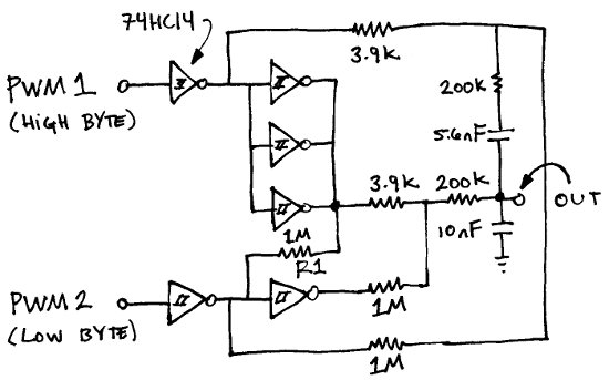

    Did you know about this simple dual pwm circuit? I didn't, but thanks to you I went googling for it :)
    With this circuit you can combine two 8-bit PWM outputs into one 16-bit PWM output. It was designed for audio applications but maybe it can be used for our kind of use as well.
    It's explained here: http://www.openmusiclabs.com/learning/digital/pwm-dac/dual-pwm-circuits/
    I'll look into the costs of creating three such circuits, can't be much as the components are extremely simple.

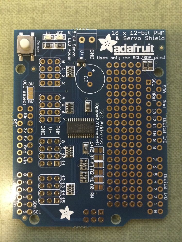

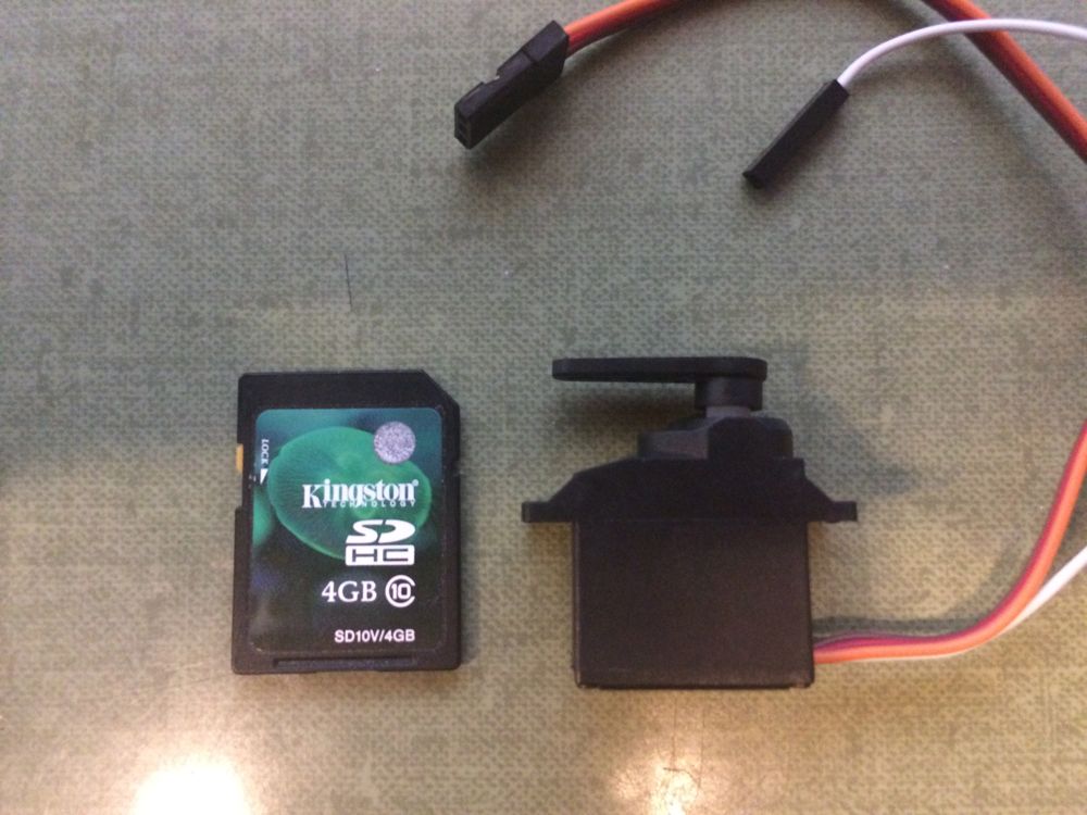

    Bought some new prototype stuff to figure out how to get SimTools to play nice with Arduino.
    First is a shield for the Arduino. It provides 16 PWM outputs, each 12bit. Should do the trick to offload the Arduino and bypass the limited PWMs the Arduino has.
    Second, I bought 6 miniature servos with feedback wire. Added a SD card in the picture to show how tiny these servos are.
    Why 6 servos? So I can also prototype for a 6DOF :)
