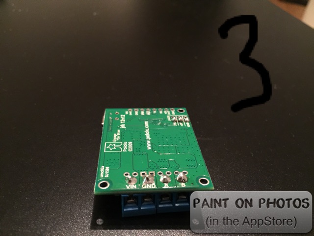

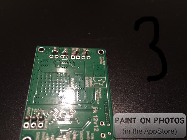

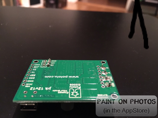

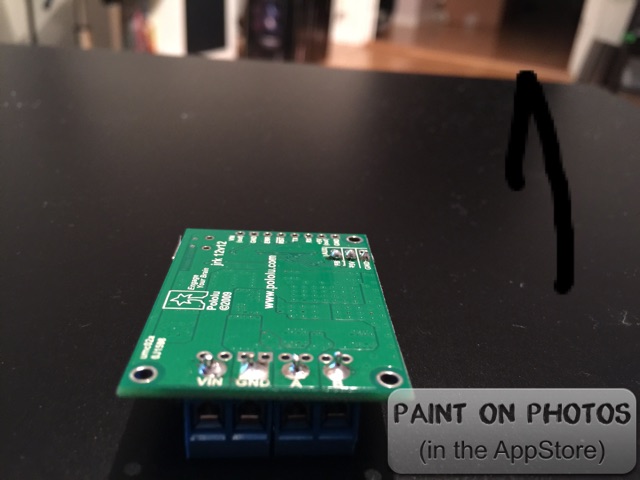

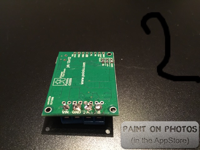

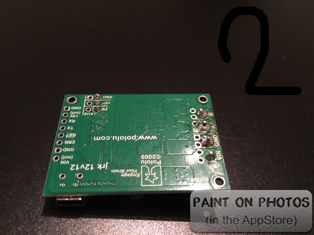

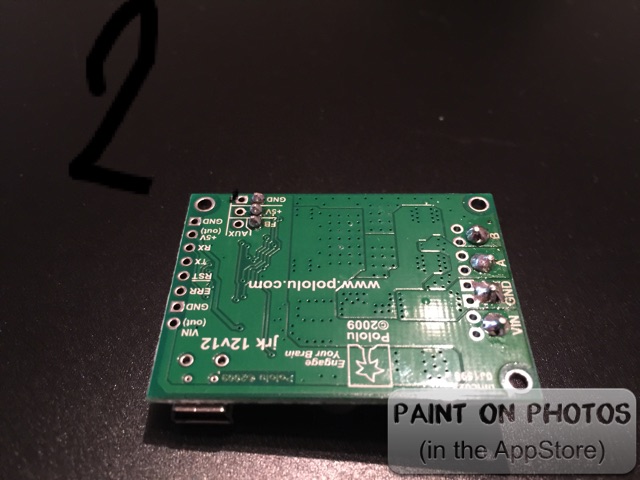

    Soldering all looks ok except for 1 joint, The bottom right JRK the A pin, Something looks a miss........This might only be the angle of the picture tho.

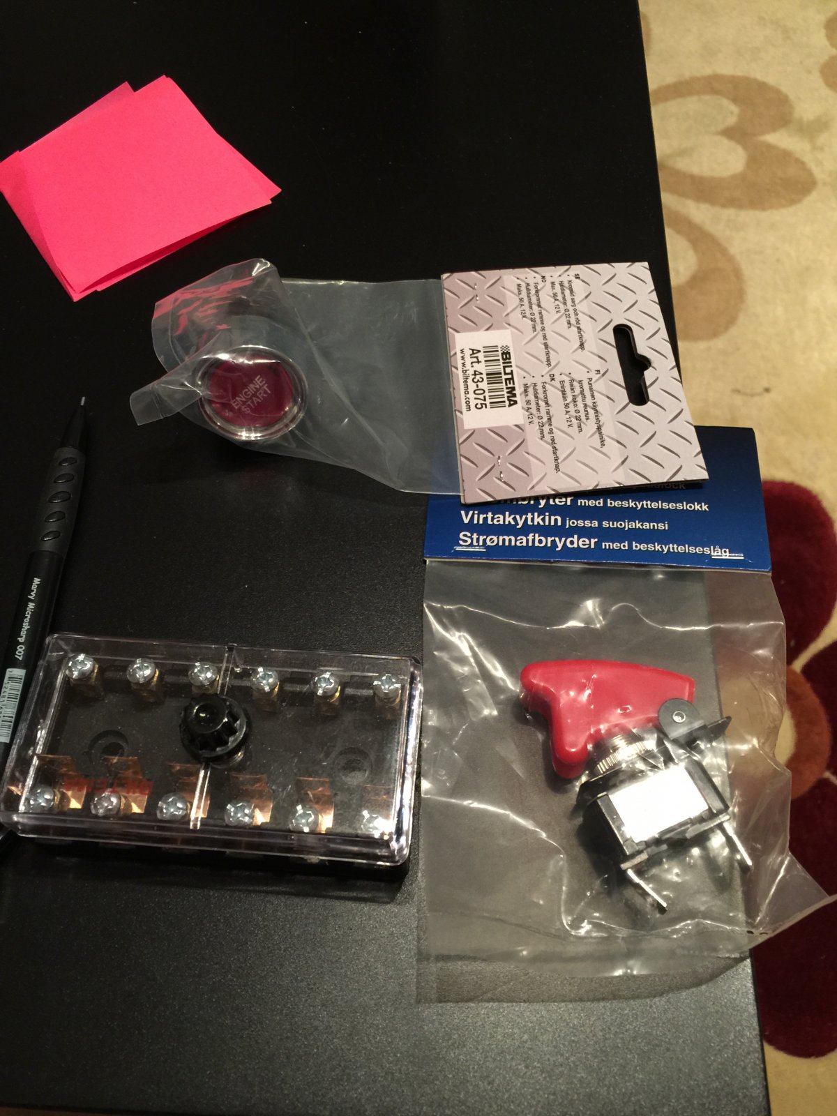

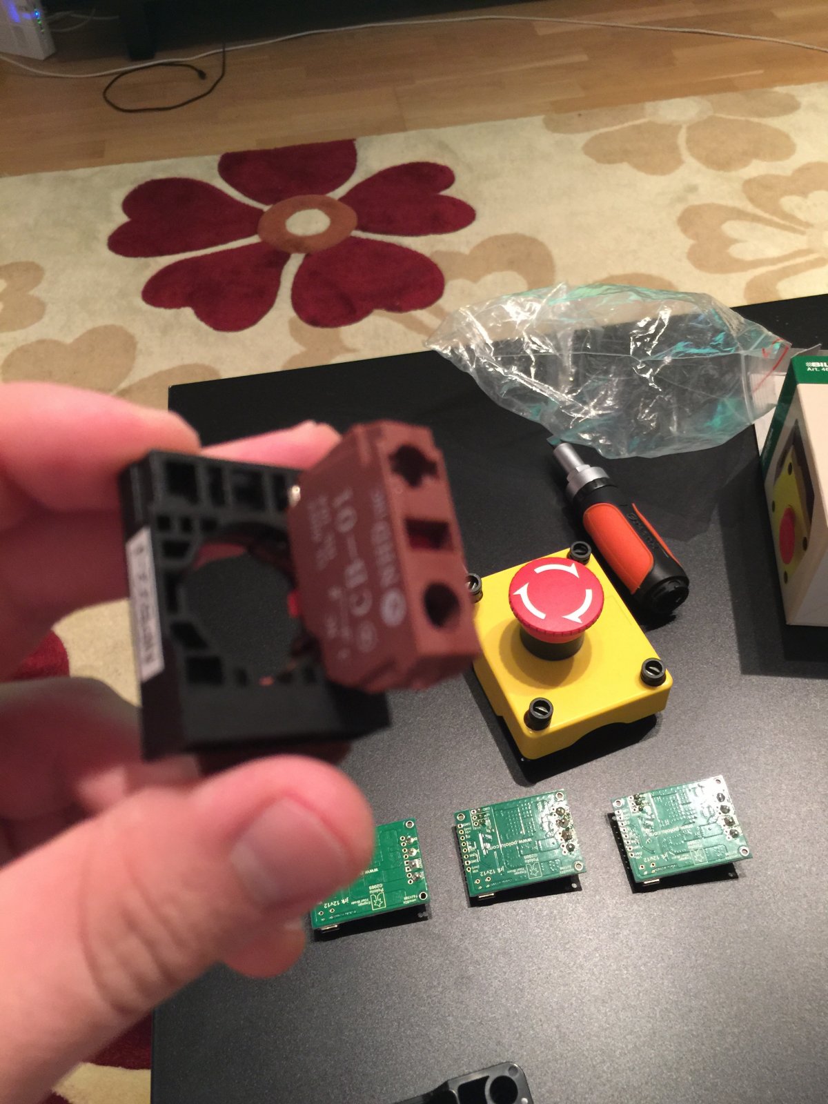

    Yes the Switch looks ok, from what i can tell its a standard 600v 10a NC switch emergency off switch. As to how you wire it to your China PSU's im not too sure. I'm sure other's can chime in on that.
  2. bsft
    top right hand jrk top pin still a blob, not soldered very well
    bottom right jrk definitely missing solder off the top right hand pin.
    Take it back and demand warranty from the guy if they blow up when they nuke themselves when wired up. Sure as hell I would be after paying 60 euros for what looks to be a crap job.
    As people have said, get some cheap kits , watch youtube videos and practice soldering yourself.

    image.jpg image.jpg image.jpg image.jpg image.jpg Ok which one should i go back with and what is wrong
  4. bsft
    Ok, all the bigger pins look good.
    Soldering on smaller 3 pins look a bit suspect, however, there is not as much current going through them. Should be ok, only way to find out is wire them up

    Ok i bought this things now plus the killswitch any ide how should i wire all of this aa yes and a fise box here is a picture

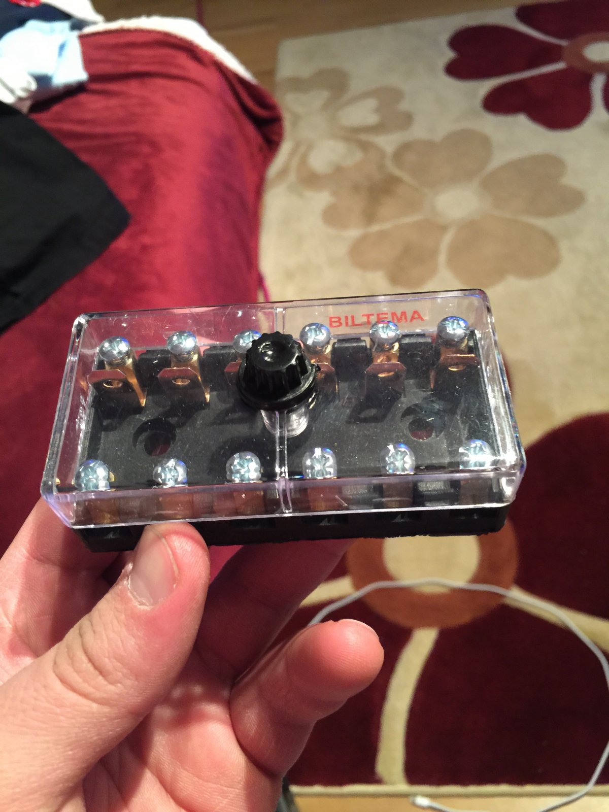

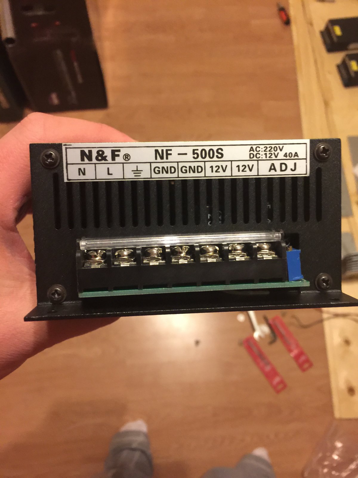

    Here is my psu

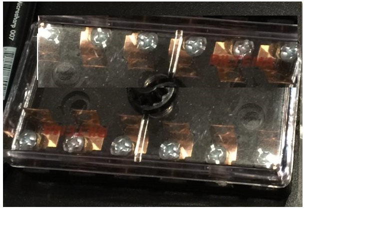

    Here is the fuse box the start engine button the kill swich and an extra on off button if needed

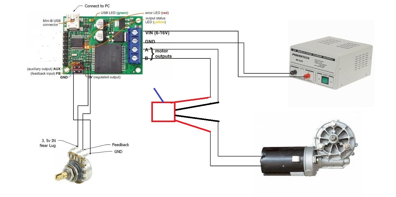

    And here is a picture of some wiring that i found but dont understand how to use it

    No clue how to wire all that, im sure one of the guys can break it down for ya lucian.

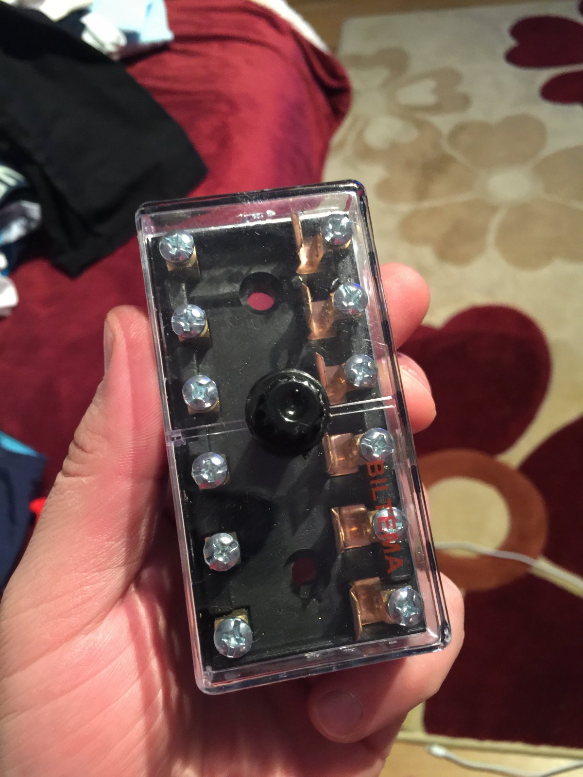

  18. insanegr
    insanegr !N$@n€
    Jan 14, 2014
    503
    Athens
    16,726Coins
    +499 / 1 / -0
    @Lucian i think something is missing and going wrong on the fuse-box. did you assemble it your self? do you have the fuses? can you post some pics with them?
    should be looking something like this

    No i bought it like that havent buy any fuse yet tomorrow
  20. bsft
    I got no idea either and I must be braver than most not running a switch and no fuses.
    When I used to run a switch, all 2 times I used it, I ran it between the motor power outputs wires
    Putting it there stops the power to the motors so the motion stops. But it does not allow the JRK to error out, unless of course the motor has overshoot or something broke. The you would have to reset the JRK in the utility program
    The 2 times I used the switch on mine was just to stop the sim from jerking or shaking in between races. In race 07 if you sit in the pits, the car should jump a bit when a new person entered the game. After a while I just didnt bother.
