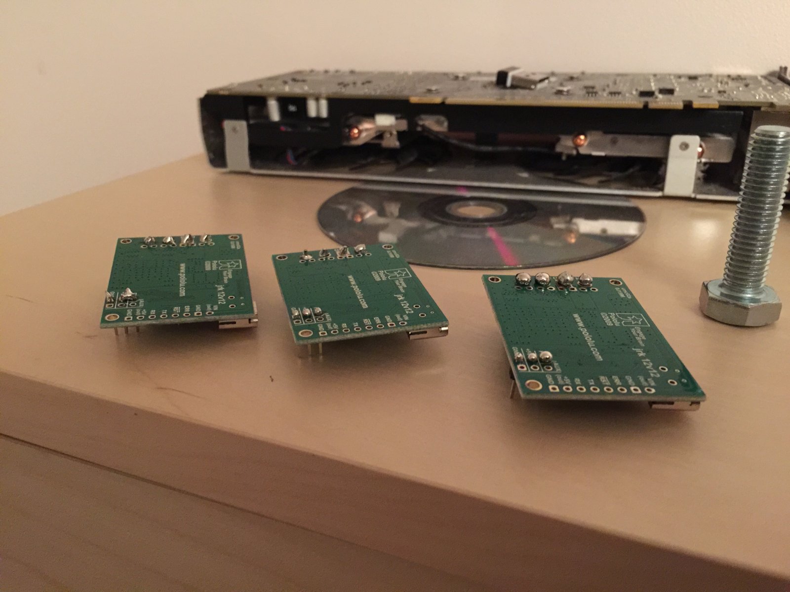

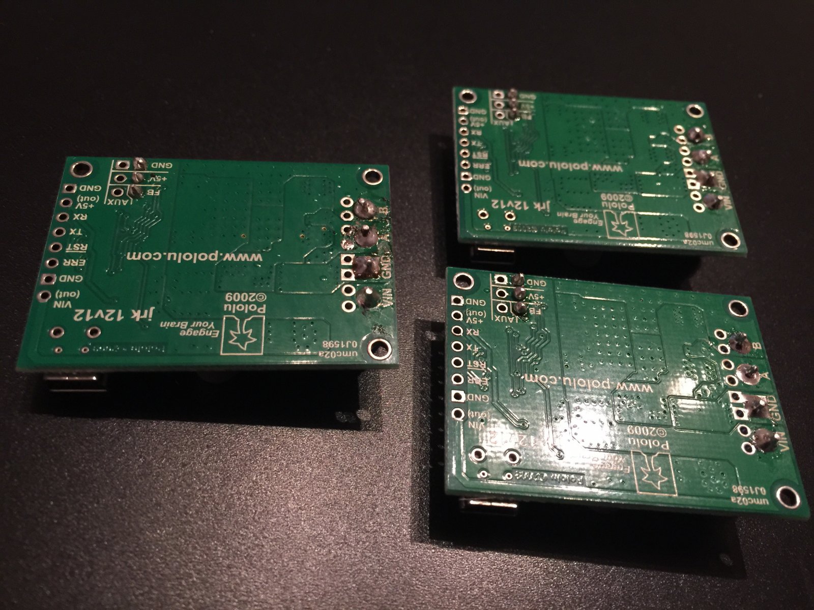

    Here is my first soldering hope its good

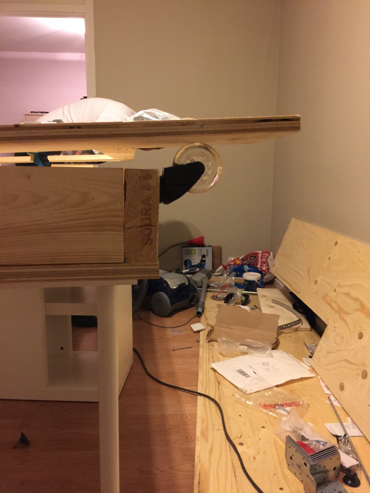

    Traction loss build

    Good welding :
    Bad welding :
    [​IMG] [​IMG] [​IMG]
    The reasons may be: too much tin or not hot enough ...

    have to agree with @Erwan960
    to be honest with you i don't like the way you have soldered the jrk's.
    it would be pity damaging them from a bad soldering.
    take a look here and watch some videos and you will be an expert in no time.
    just practice somewhere else and then go for the jrk's.

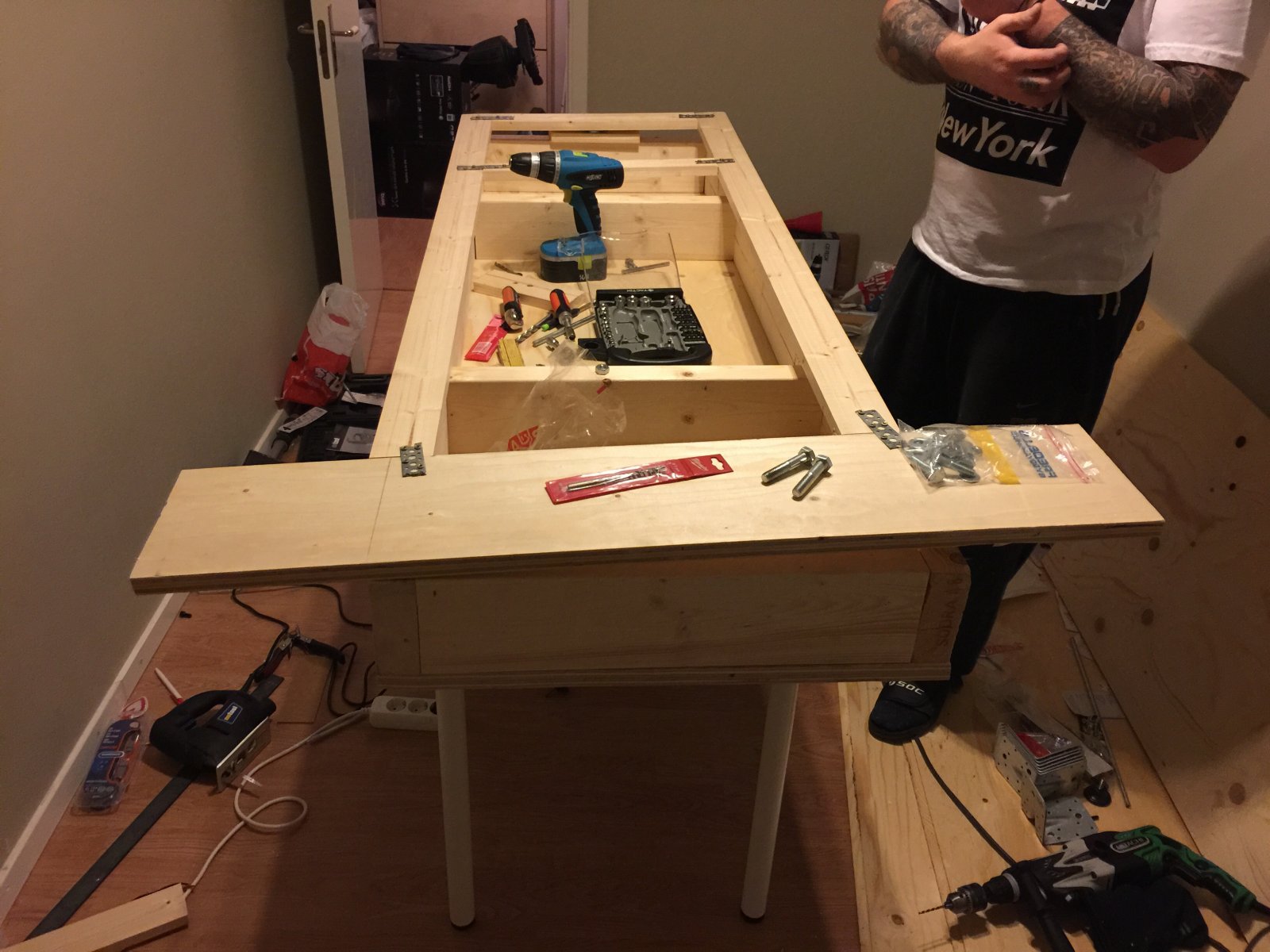

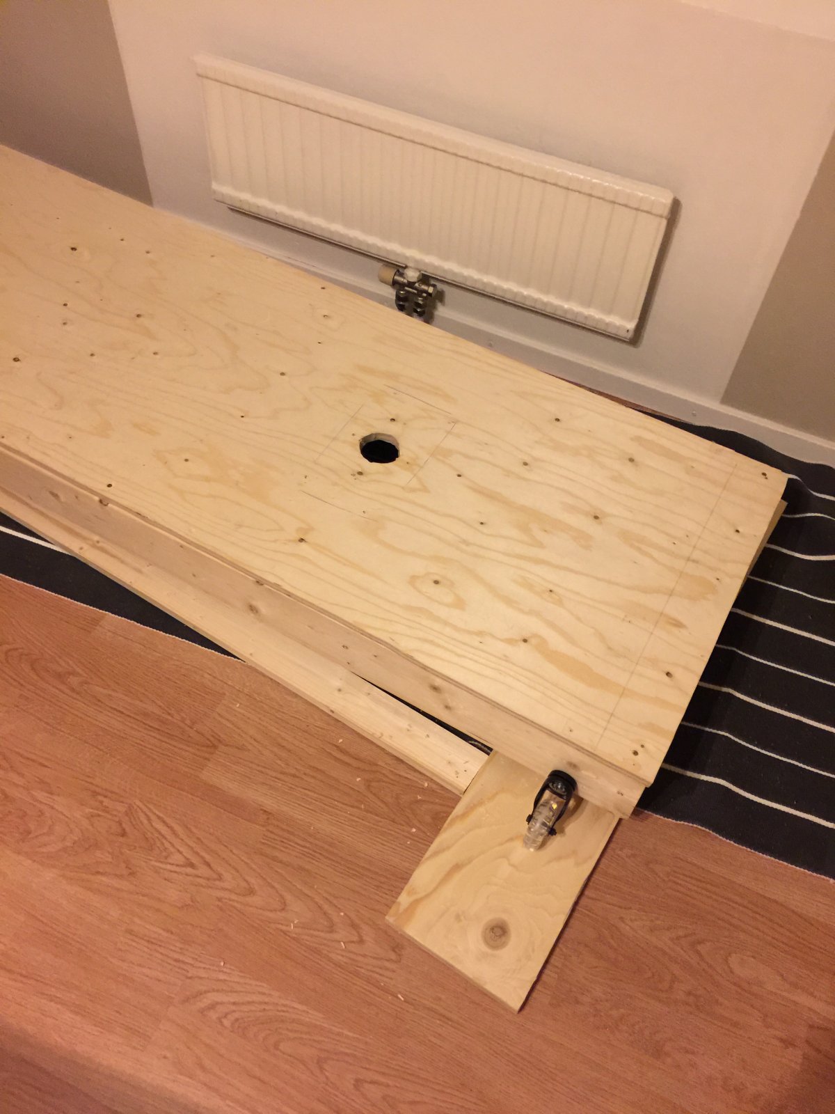

    One thing to remember the traction loss doesn't move "side to side" but rotates on a Large Circle Axis. So your Wheels on the base need to be Angled towards the front of the rig slightly or they will "scrub" when the frame tries to move from side to side.
    I also made this mistake but have a Fresh set of Extra large castor's that i have modified that Hold 10X more weight and have WAY beefier bearing's so Will make thing's that much easier to slide. Currently i can push it with 1 finger but does take a bit of force.
    Angle I need on the wheel, just need a custom L bracket to mount it to my "Motor mounts"

    nope, you havent allowed enough heat onto the circuit board. Its not a difficult thing to fix, but I suggest you find someone to fix it.
    Its a matter of holding the soldering iron onto the blobs and letting them re-melt and hopefully they sink onto the board more.

    Agreed with dave, but with that much solder on the post, I would be weary of it being too much and overflowing the joint once it flows.
    Also looking closely on the far left JRK 2 of the Pot pins are Shorted together. Lucian I Strongly suggest you find someone who's got some time behind a soldering iron to "iron" out these issues. Sorry for the pun Lol.

    Ok il try to find a pc store and ask them to make them properly hope they will help me.

    The angle that works for mine is shown in this picture, with the protractor on the castor frame this angle is 15degrees
    As to where you can get Castors like this i honestly dont know, I have a place that sells Only Castor's locally so i had quite the selection to choose from. As to how you mount them, Again depending on what style you get might vary on how you mount them.
    Everything looks fine for now, You will find the faults and small issues over time, There's no avoiding that. its all part of the game and you get better at fixing as you go along.

    Pretty scary soldering:). It even looks like you have bridged across two pins in the JRK on the left. You really need to de-solder with either a vacuum system or solder wick and start again. I completed the HRHS course (same as NASA uses) many years ago so maybe I'm fussy. Plenty of good videos on the Web to help you out, all the best with your project. Also FYI you can purchase heat sinks that will fit onto the JRKs which come with self adhesive thermal tape. JAYCAR has them in OZ. Update: Seems most of this has already been covered by the other members, if you cannot find someone to help then just practice on some scrape circuit board, and once you feel confident go back to the JRKs.

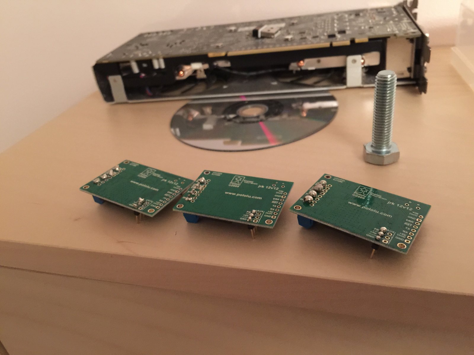

    Ok my new soldering is it ok now
