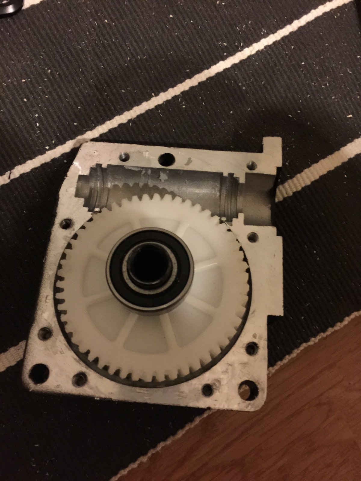

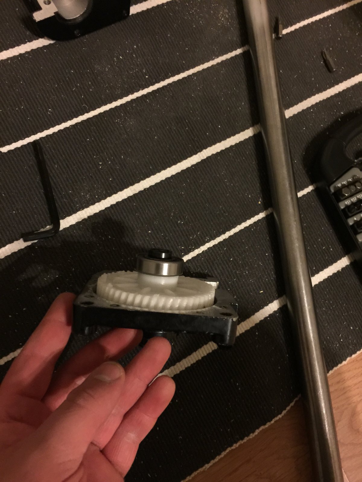

    How CAn i remove that round thing to rotate that white thing?
  5. Nick Moxley
    17,057Coins
    +2,507 / 30 / -2
    Just yank UP on that Big white gear, the whole gear and bearing's should pop out from the case, then just flip the gear. If its a little tight, Hold the gear box upside down and give the other side a tap with a screw driver or something. It should't be All that tight in there.

    [​IMG]I would recommend locating a bearing separator (see above), since the plastic gear is already damaged this is your best bet to get the bearing off without damage
    or use a jaw type puller (see below)... this style is more likely to cause damage to the bearing but should get it off of the shaft
    Here in the states our local auto parts stores rent these tools for free, not sure about Sweden, good luck!
  7. Nick Moxley
    17,057Coins
    +2,507 / 30 / -2
    Good idea but Total overkill dave, No need for a puller. The bearing's are just a press fit and are easily removed.
    PS what damaged gear ?
    PPS where in MN are ya. I do a bit of RC racing down in Foley/Staples in the summers.

    Nick never had a motor apart, appeared to be pressed wasn't sure how tight a tolerance :)
    I'm in the Twin Cities
  9. Nick Moxley
    17,057Coins
    +2,507 / 30 / -2
    Ya they aren't very tight. And he also doesn't need to remove the bearing's at all, Just flip the gear. Bearing's And all.

    Yepp did that Done and done ty

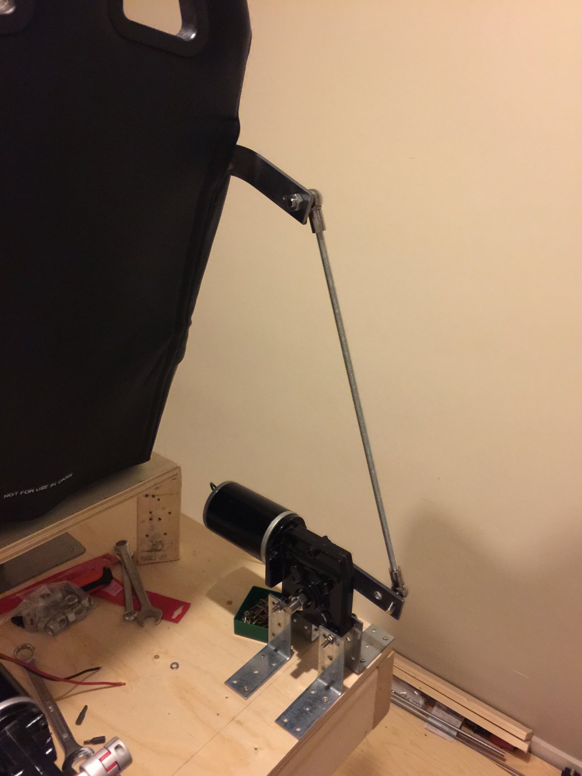

    The Rod is 47,7 cm

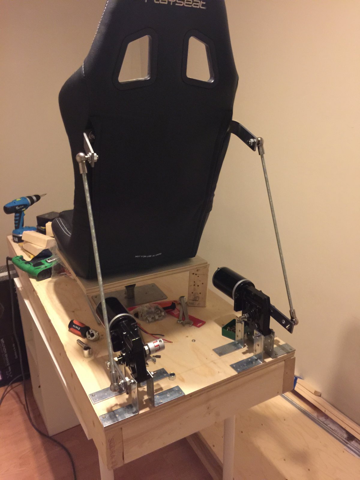

    How stiff are those brackets Lucian ? If you push Sideways on them, Do they move ? As in push from the Pot side and the lever side.
  17. dave w
    dave w Member
    Nov 19, 2014
    28
    Minnesota USA
    1,068Coins
    +12 / 1 / -0
    brackets look a little thin, I think I could ninja kick those off! :)
  18. dave w
    dave w Member
    Nov 19, 2014
    28
    Minnesota USA
    1,068Coins
    +12 / 1 / -0
    I would recommend at a minimum doubling them up and using nuts and bolts with a backing plate if "L" brackets are all you got
  19. Nick Moxley
    17,057Coins
    +2,507 / 30 / -2
    We can also Lower the motor's which will take off some leverage on the Brackets.

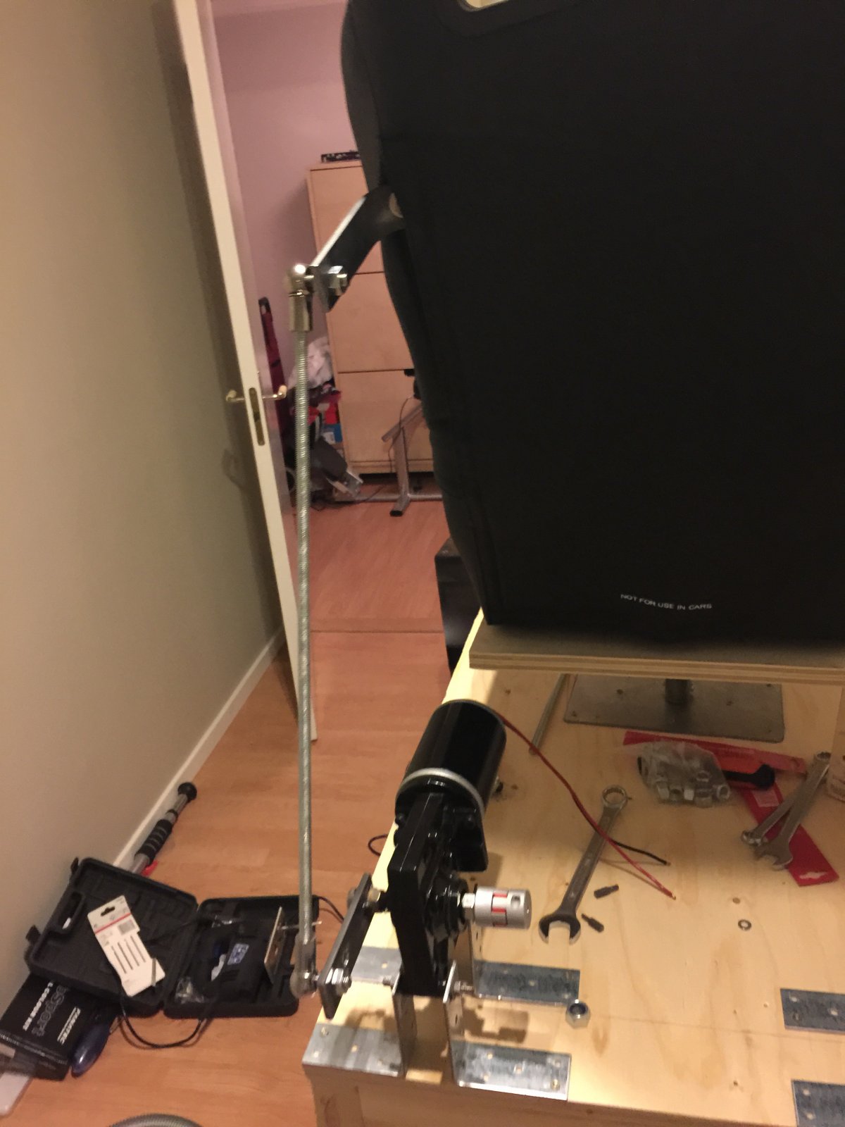

    IMHO, I would look at the shafts (w/heims) from motors to back of seat - under "load", there may be some undesirable flex...
    Nice project.
