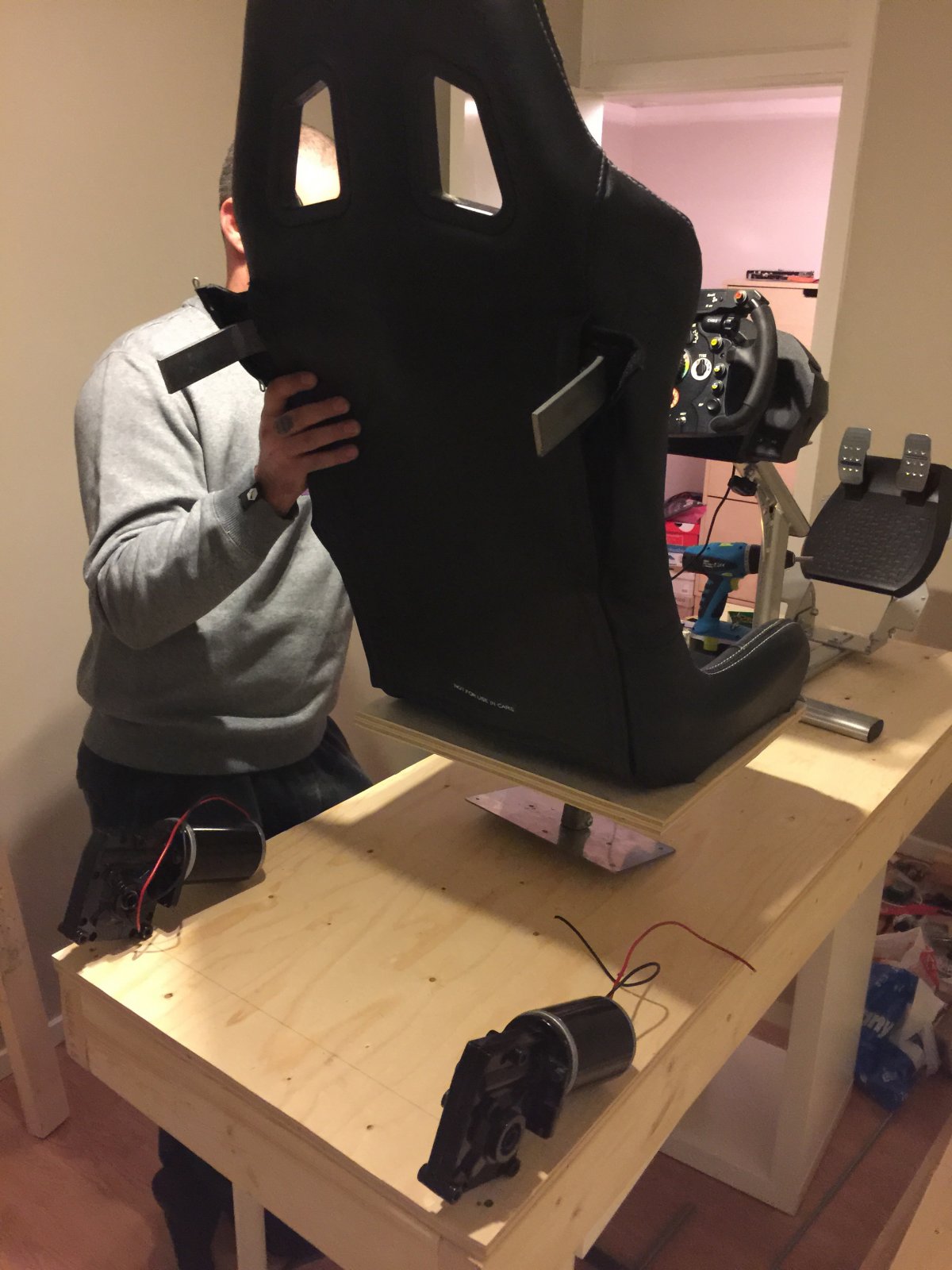

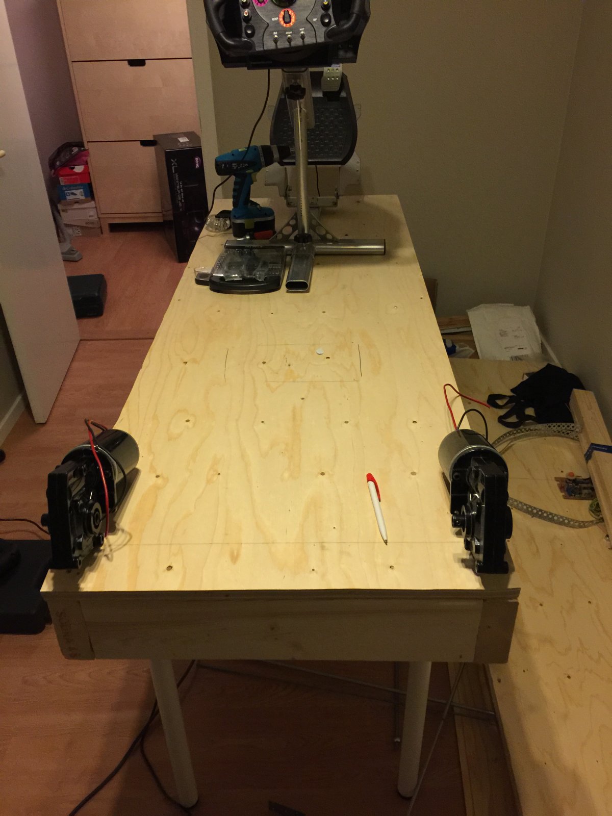

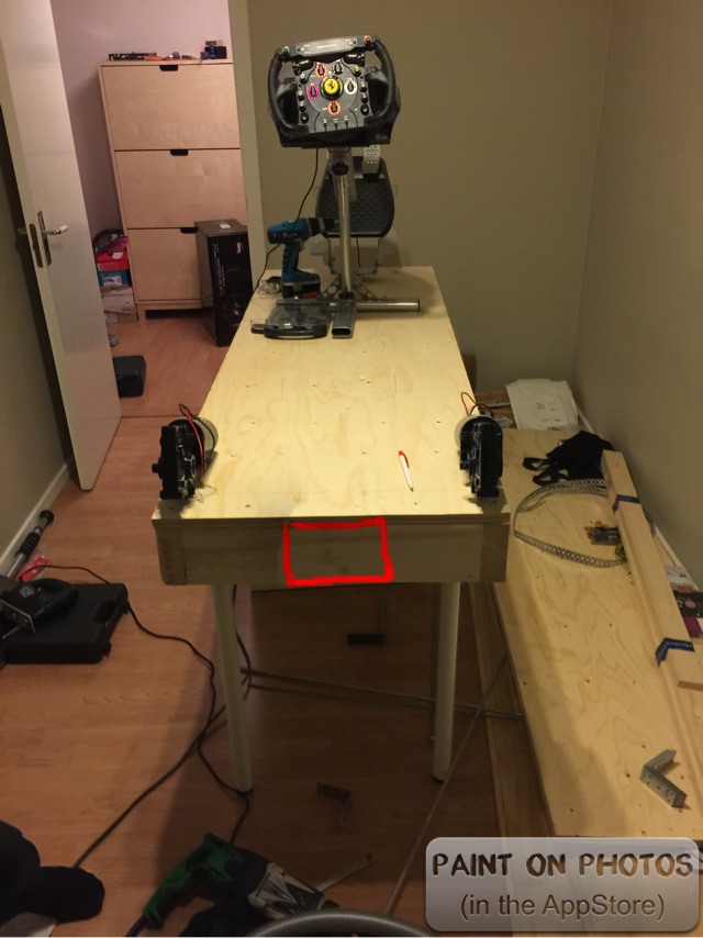

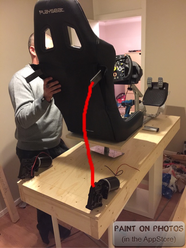

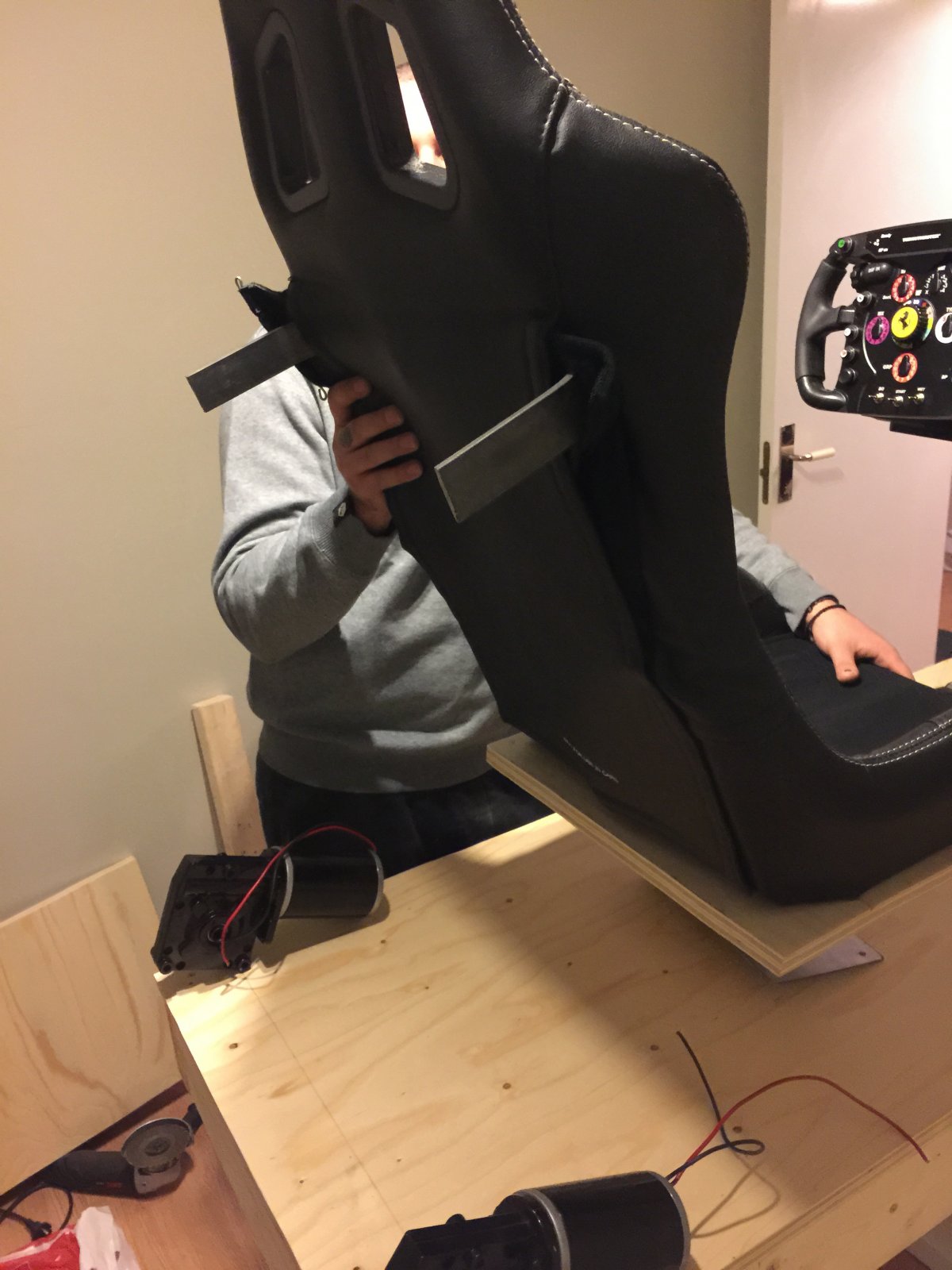

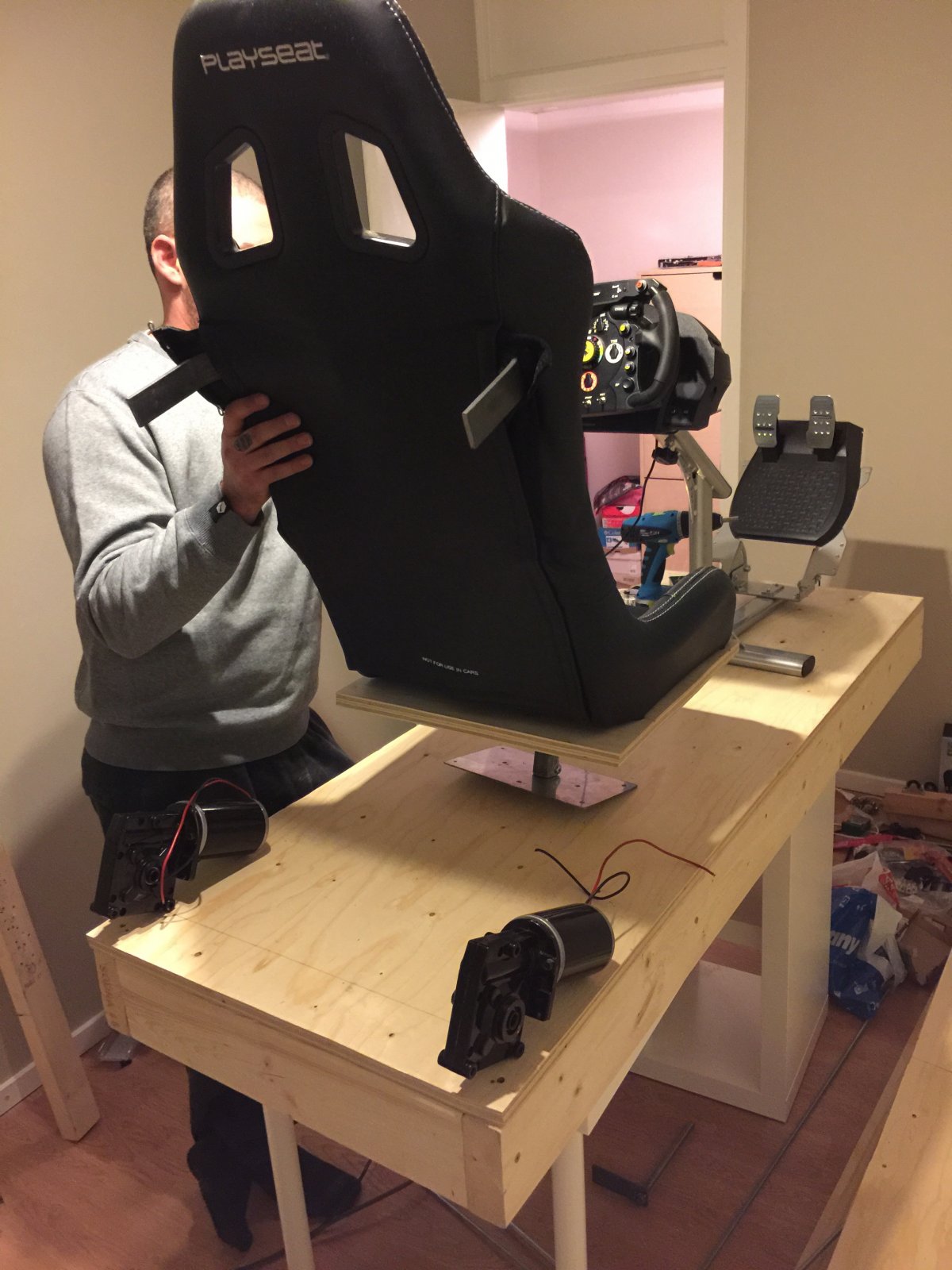

  15. Lucian
    Lucian Member
    Nov 5, 2014
    60
    Sweden
    363Coins
    +9 / 0 / -0
    From here to the center of the motor hole is about 57cm is IT ok or to low for the Rod? Else everything looks ok?
    Jrks will be put AT that square with same Box and fan as @Nick Moxley did with his jrks Will that be ok? Power supplys Will be put under the poolywood image.jpg image.jpg image.jpg
  16. bsft
    yes thats fine , the length of the actual rod arm from lever to seat is ok. I recall mine was near 700mm.
  17. Lucian
    Lucian Member
    Nov 5, 2014
    60
    Sweden
    363Coins
    +9 / 0 / -0
    I CAn put the seat higher IF thats the case. How about the angle is IT ok? Motors with space ok? Because they Will be a little closer when i put the L brackets on them
  18. bsft
    dont put the seat higher.
    Arm length from motor to seat is not critical in being shorter or longer. Its the balance of the seat/frame and where its being pushed at.
    You have set up the actual point of where the motors connect is correct. Motor spacing is fine as well and seat lean, as long as its balanced right.
