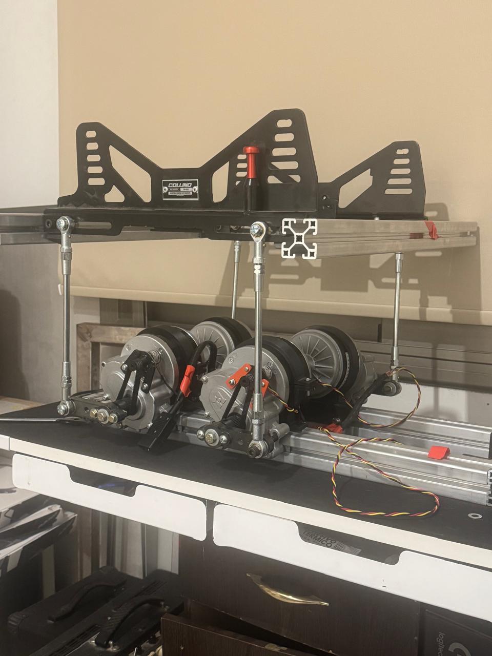

    I'm trying to build a 3dof seat mover with four scooter motors and crank & rod mechanism. However I'm finding stuck at finding a way to restrict the motion of the rod so they only move in one direction. My idea is to try to find some sort of rail with bearings so the movement is smooth but I can't for the life of me find anything close to it.
    I know that four motors is over constraining the system but I wanted to test the additional power provided by an extra motor. So right now I feel I'm stuck at figuring out the last bits of the mechanical aspect.
    I'm attaching a photo of my build so far for reference.

    This can create a significant amount of parasitic movement, which will place greater strain on some motors.
    An alternative would be a gas strut from a computer chair in the center with a joint attached to the top and a single Watt mechanism to prevent lateral movement.

    Indeed that is totally possible and I built my own adjustable version over a decade ago, without the need for a Watt mechanism: https://www.xsimulator.net/community/threads/dx-compact-simulator.5866/

    if you change the angle of the rods the platform will become stable
    consider a different layout of the motors
    raise the motors so that they will not hit the ground

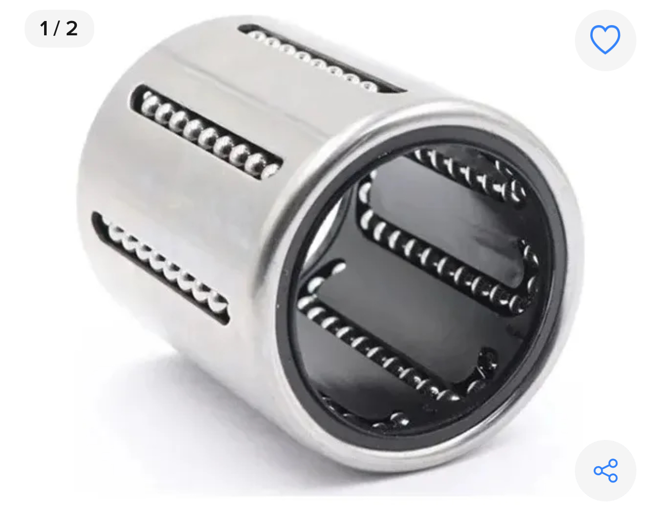

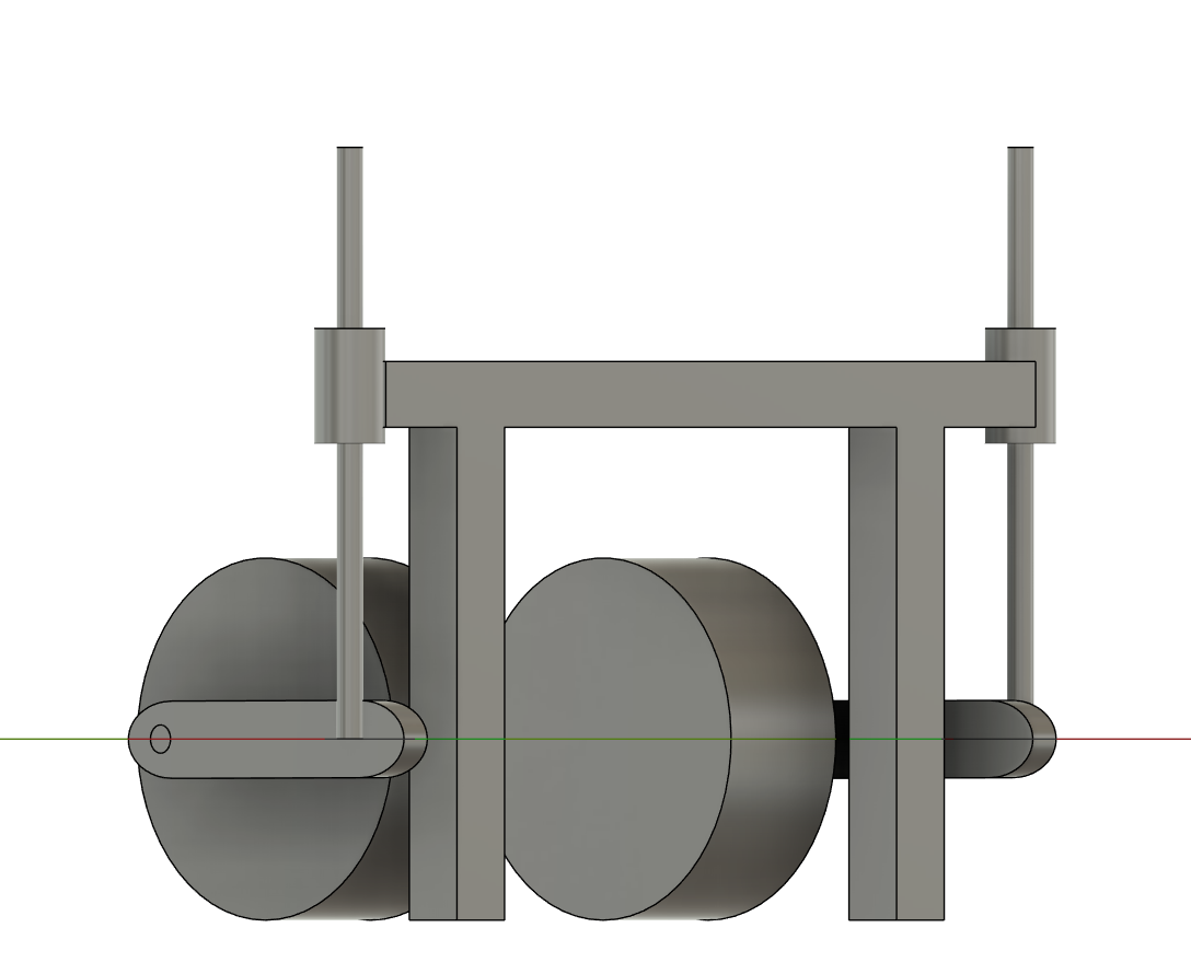

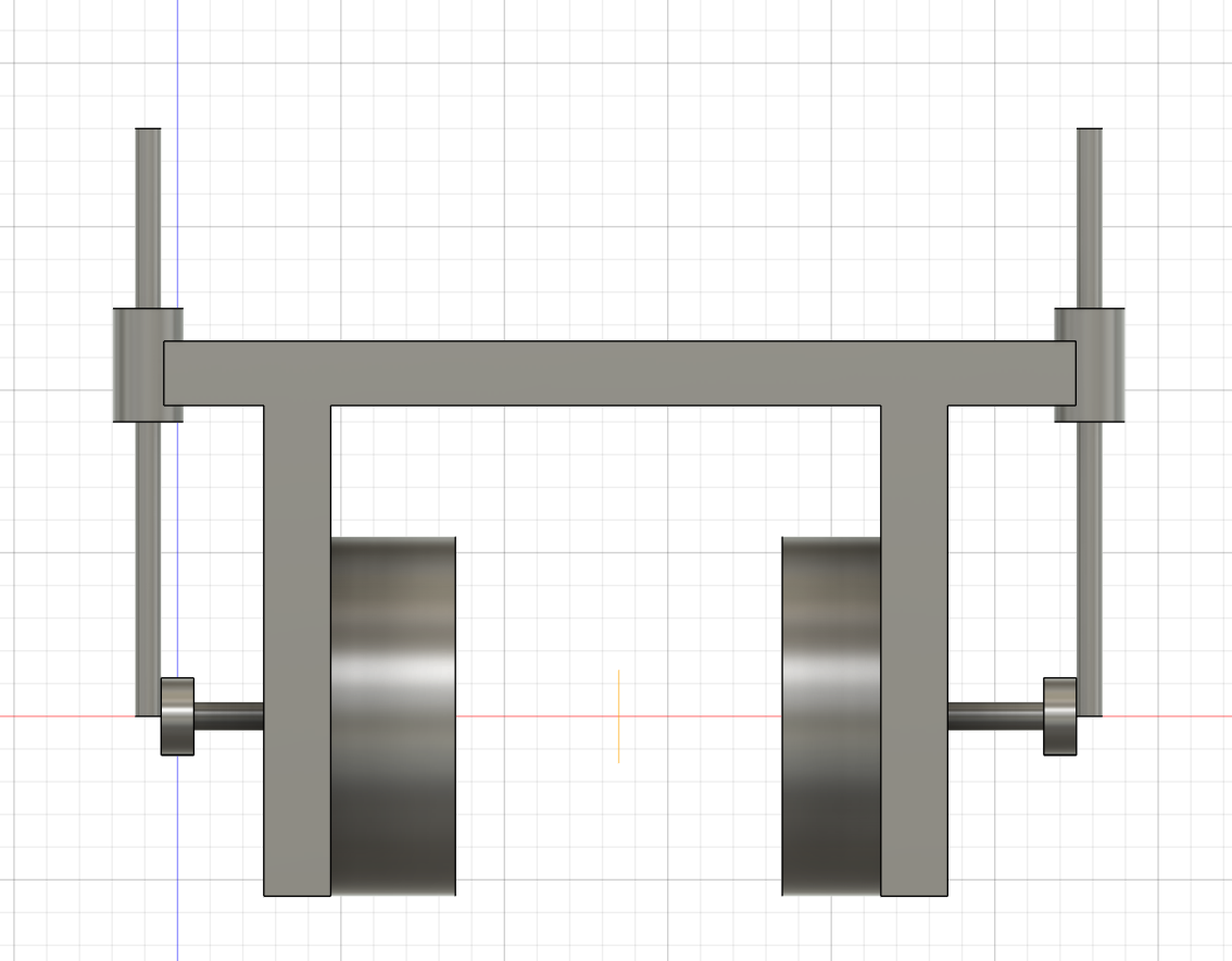

    I'm back at the drawing board and I feel I'm settling down to three motor layout and save the fourth one for traction loss on platform which is more standard configuration. However I do also want to try some new things out and was wondering about having this lineal bearing fixed (one per rod) to restrict linear motion.
    What do you think?
  14. Gadget999
    1,988
    12,132Coins
    +492 / 11 / -0
    Can you do a basic sketch of what you are planning - i am not really sure what you are proposing

    I am not sure in what manner you envisage implementing this particular bearing design, could you please sketch out, explain and post what you have in mind.

    I'm sorry should have provided a drawing too. Here it goes. Only modeled two because that's basically what it would take to restrict both lateral and longitudinal movement, but may as well be extended to all of them.

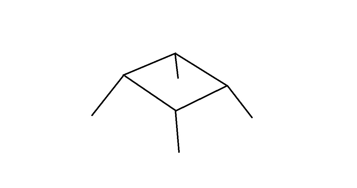

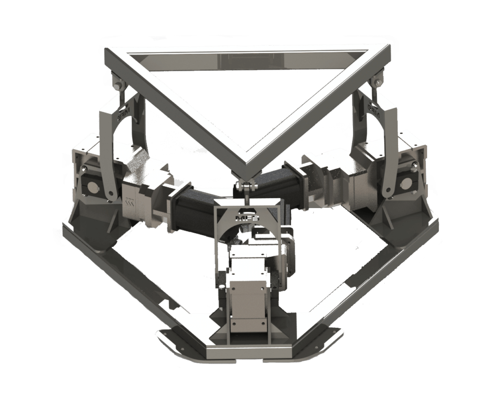

    if you look at most 3dof sims the actuator are hinged and can only move in a single plane
    there are 3 of them that are arranged to stop the rig from wobbling or toppling
    you may be able to get the rig to be stable if you position 4 rods that are angled like on a 6DOF sim
    you may need to experiment with the angles - I suggest you build a small model and see if you can make it stable - see attached pic
    the linear bearings you are suggesting may work - so may a pair of panhard rods
