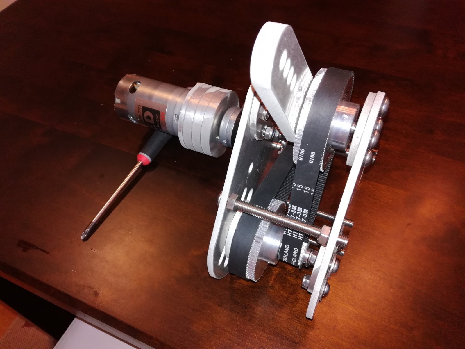

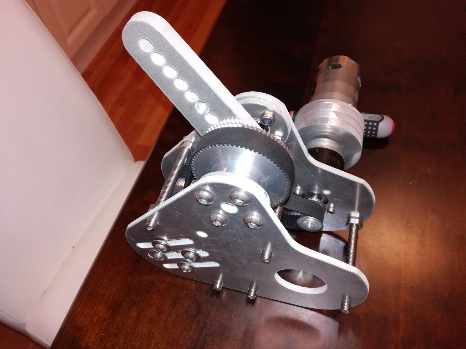

  7. hartsa90
    hartsa90 Member
    Sep 12, 2016
    30
    Finland
    111Coins
    +13 / 0 / -0

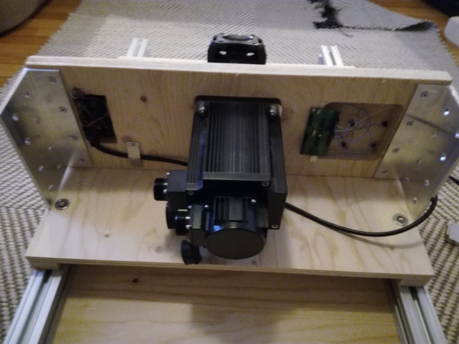

    I will Post Pictures of My actuators as soon as I am allowed to. Just did a quick test with a lab psu. Actuators seems to work. Motors and the planetary Gear seems noisy.
    I have to insert a limit switch to cut the motor Power in Case of motor run away. Also potentiometer Must be mounted to the motor shaft.
  8. hartsa90
    hartsa90 Member
    Sep 12, 2016
    30
    Finland
    111Coins
    +13 / 0 / -0

  9. Nick Moxley
    17,056Coins
    +2,506 / 30 / -2
    Interested, But very confused at the same time. Look forward to your next updates.

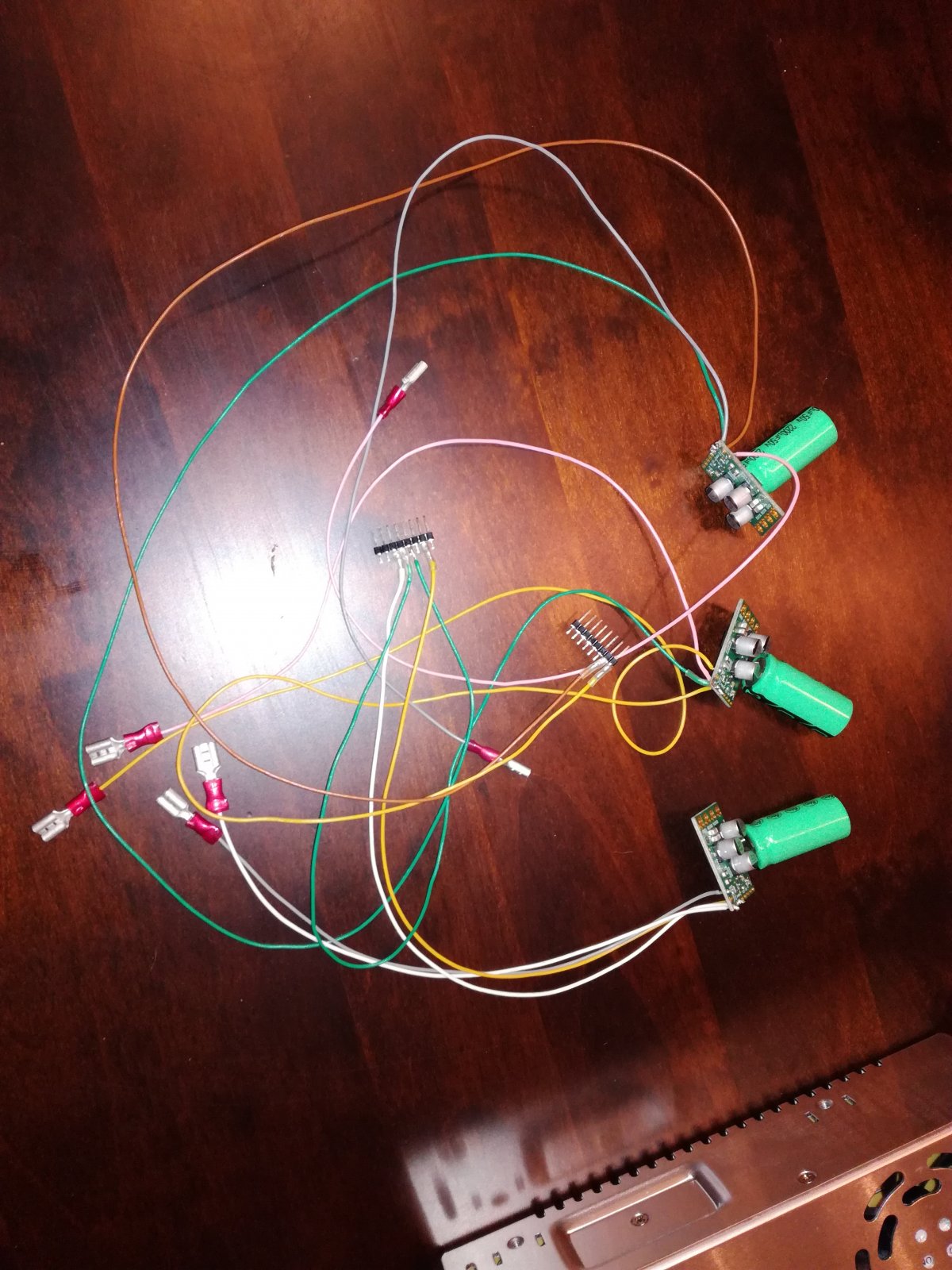

    Wiring almost done... Here's a picture of the pololu drivers.

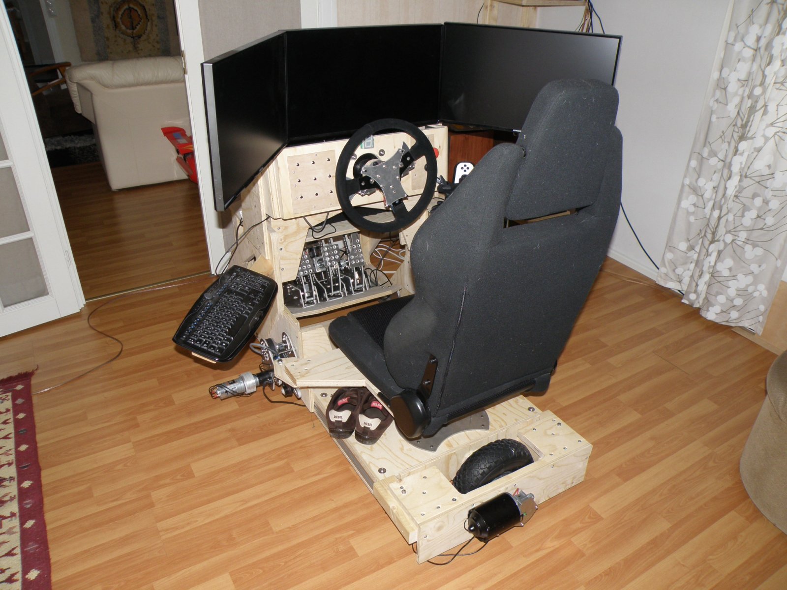

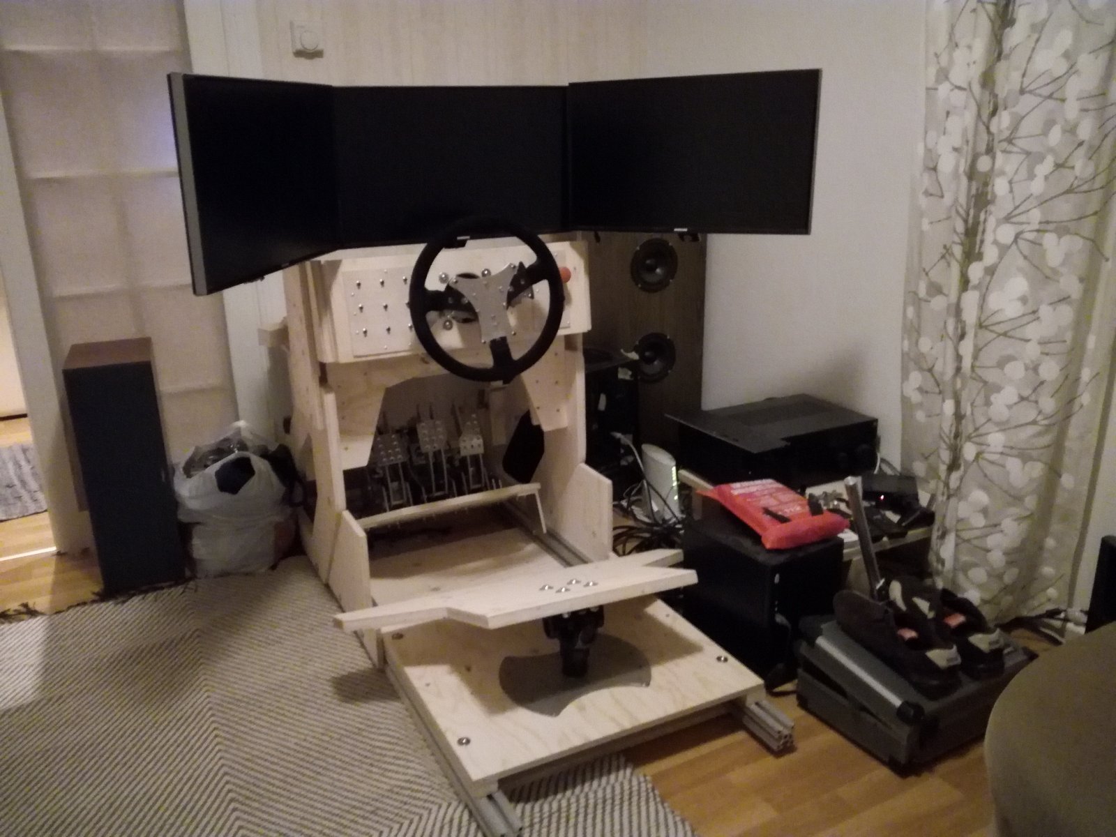

    Made some progress on the build.
  14. Blame73
    Blame73 Well-Known Member
    Nov 6, 2014
    1,215
    8,303Coins
    +1,128 / 4 / -0
    Are you going triple screens?
    That rig's gonna flex/shake A LOT. It seems a bit too thin to me
  15. Nick Moxley
    17,056Coins
    +2,506 / 30 / -2
    I would also echo Blame's worries....when the rig gets oscillating, it will surely transmit some of that up to the Monitor stand.....Beef up or build some legs for the monitor and have them independent of the rig itself.
  16. hartsa90
    hartsa90 Member
    Sep 12, 2016
    30
    Finland
    111Coins
    +13 / 0 / -0
    Yep need to add vertical supports and hopefully it will be sufficient...
    Back to the drawing board if it will not hold.

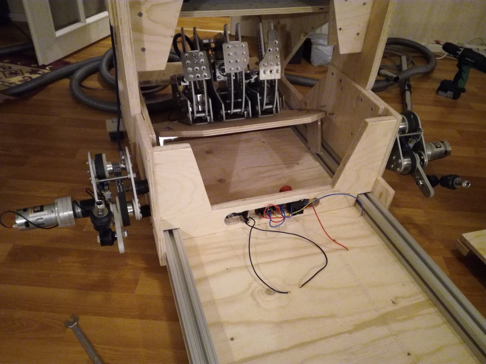

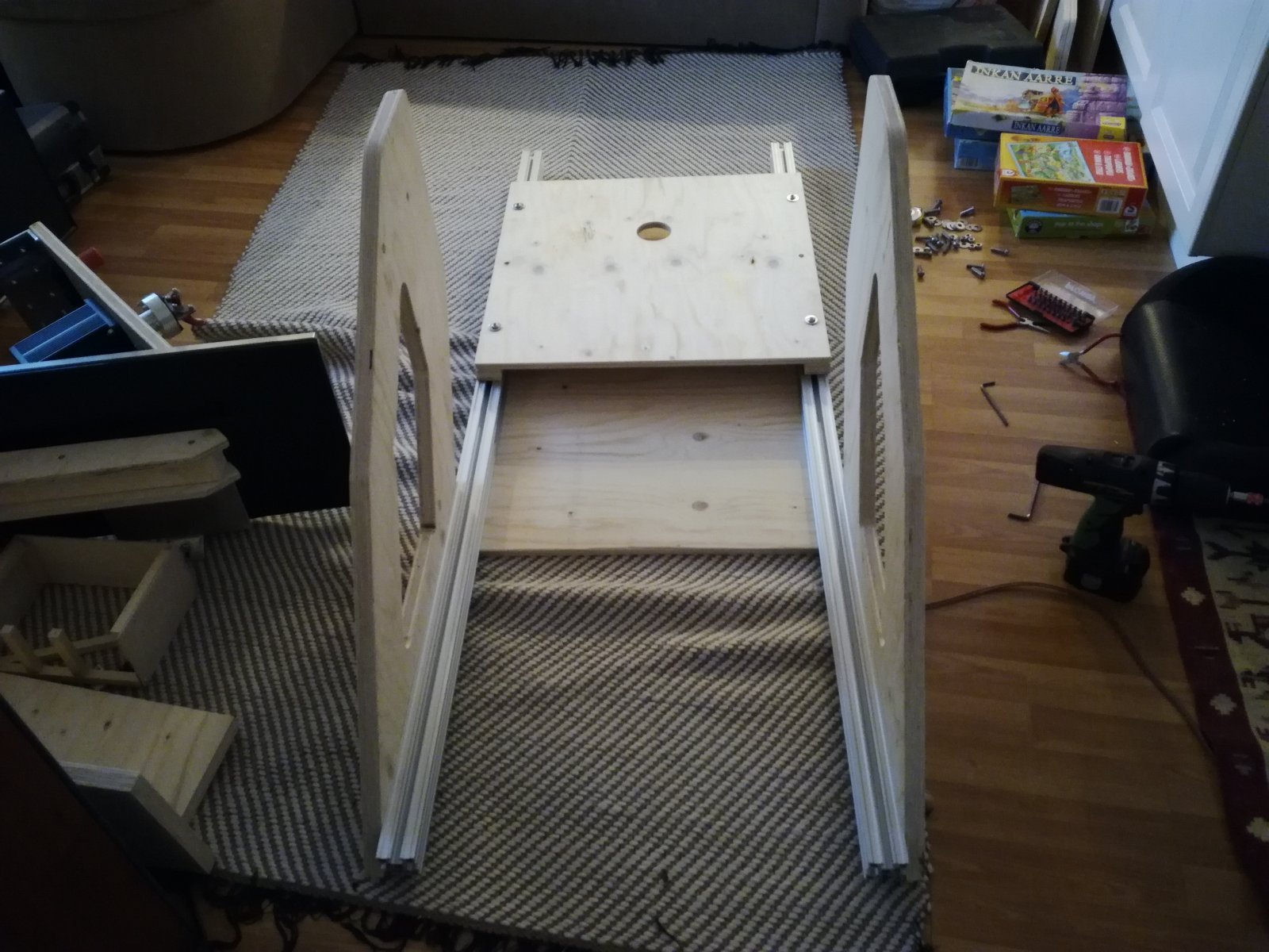

  17. hartsa90
    hartsa90 Member
    Sep 12, 2016
    30
    Finland
    111Coins
    +13 / 0 / -0

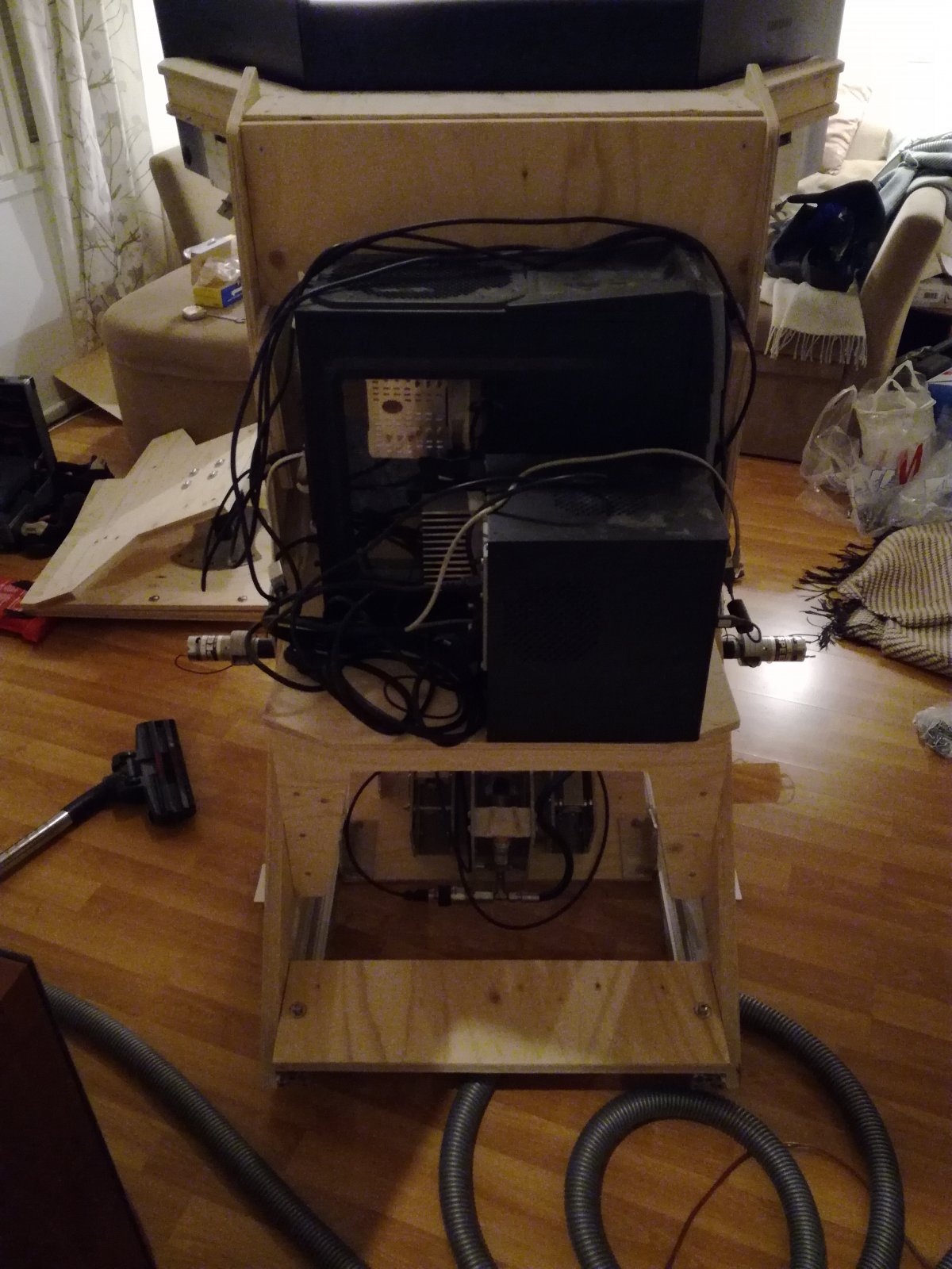

    It takes ages to get the parts done...
  18. hartsa90
    hartsa90 Member
    Sep 12, 2016
    30
    Finland
    111Coins
    +13 / 0 / -0

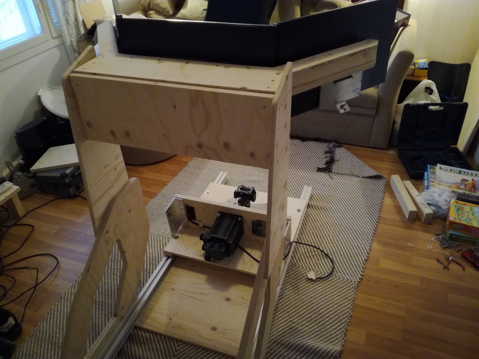

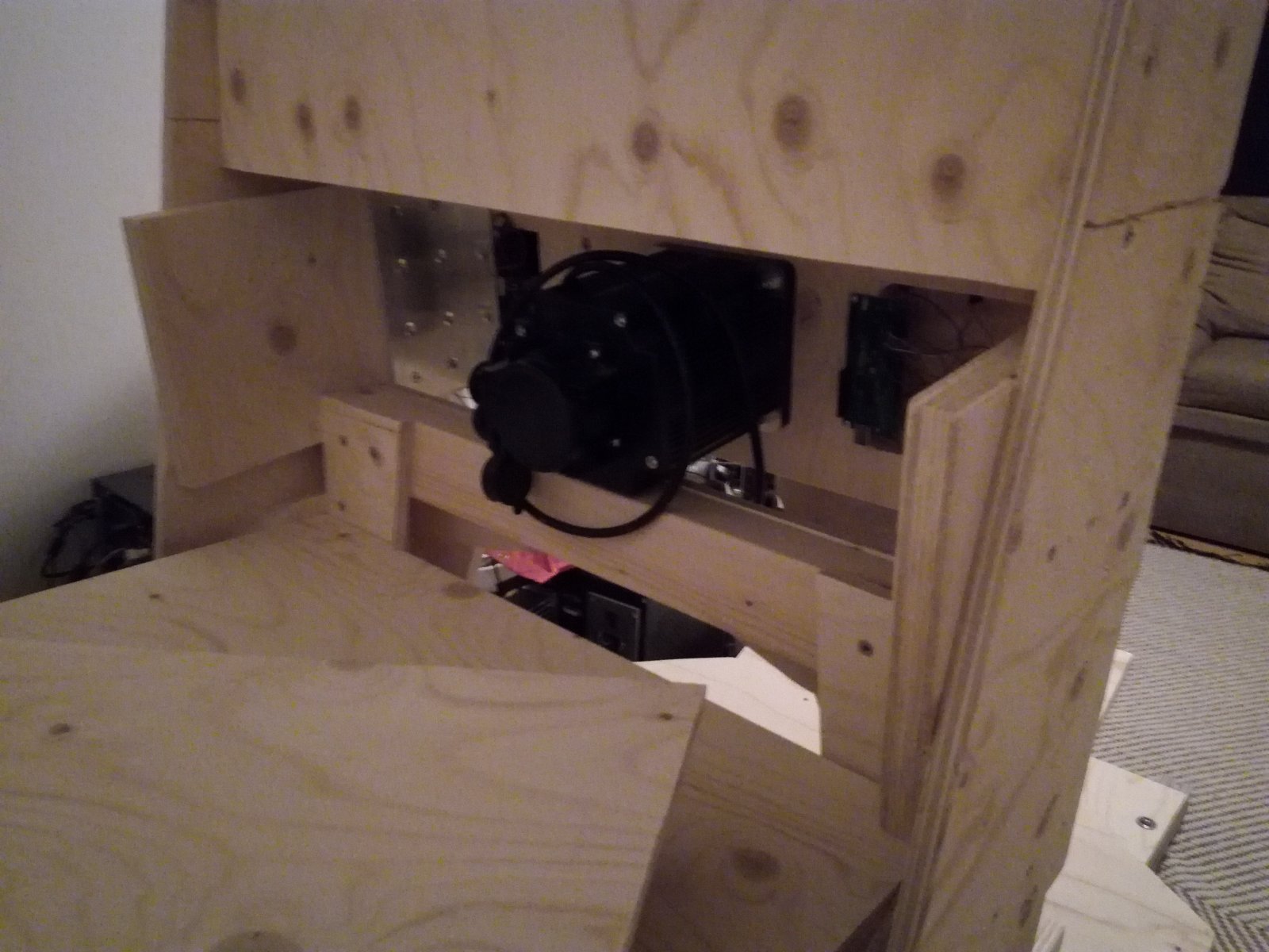

    At least something done. Feels guite strudy now...
  19. Nick Moxley
    17,056Coins
    +2,506 / 30 / -2
    Wow, Ill be amazed to see those weee little motor's actually pull this off..Seriously looking forward to seeing them move for the first time......And Kill switch underneath the seat ? Whats that for ? Wheel or Motion ...i see you have another on the Dashboard too.
