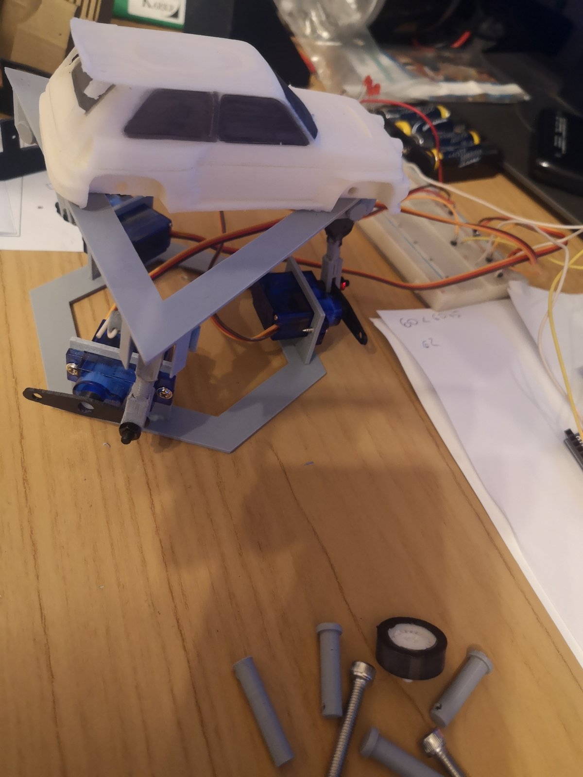

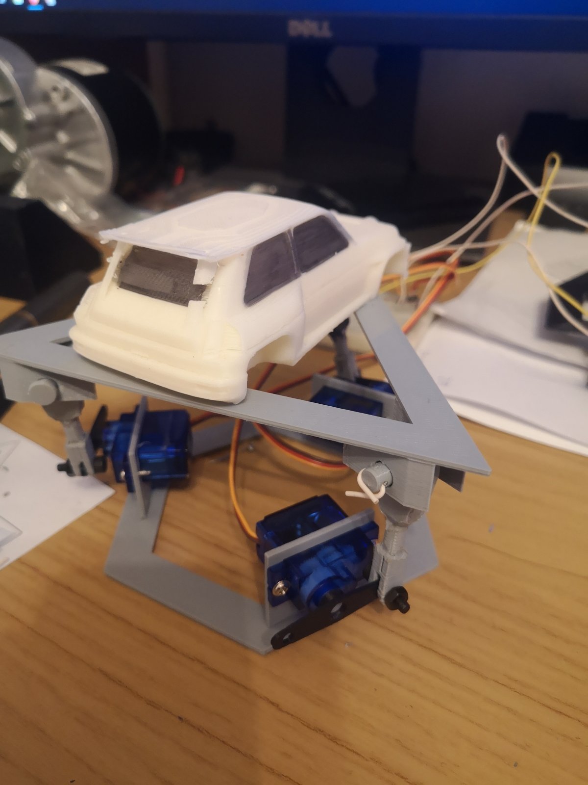

    I made a prototype 3dof simulator.
    I wanted to use roll, heave and pitch axes, but the results were not good. Then i tried to use surge, sway and heave and the result is in the video. I dont undestand why. For me, logic, for my hardwere in the first choice of axis.

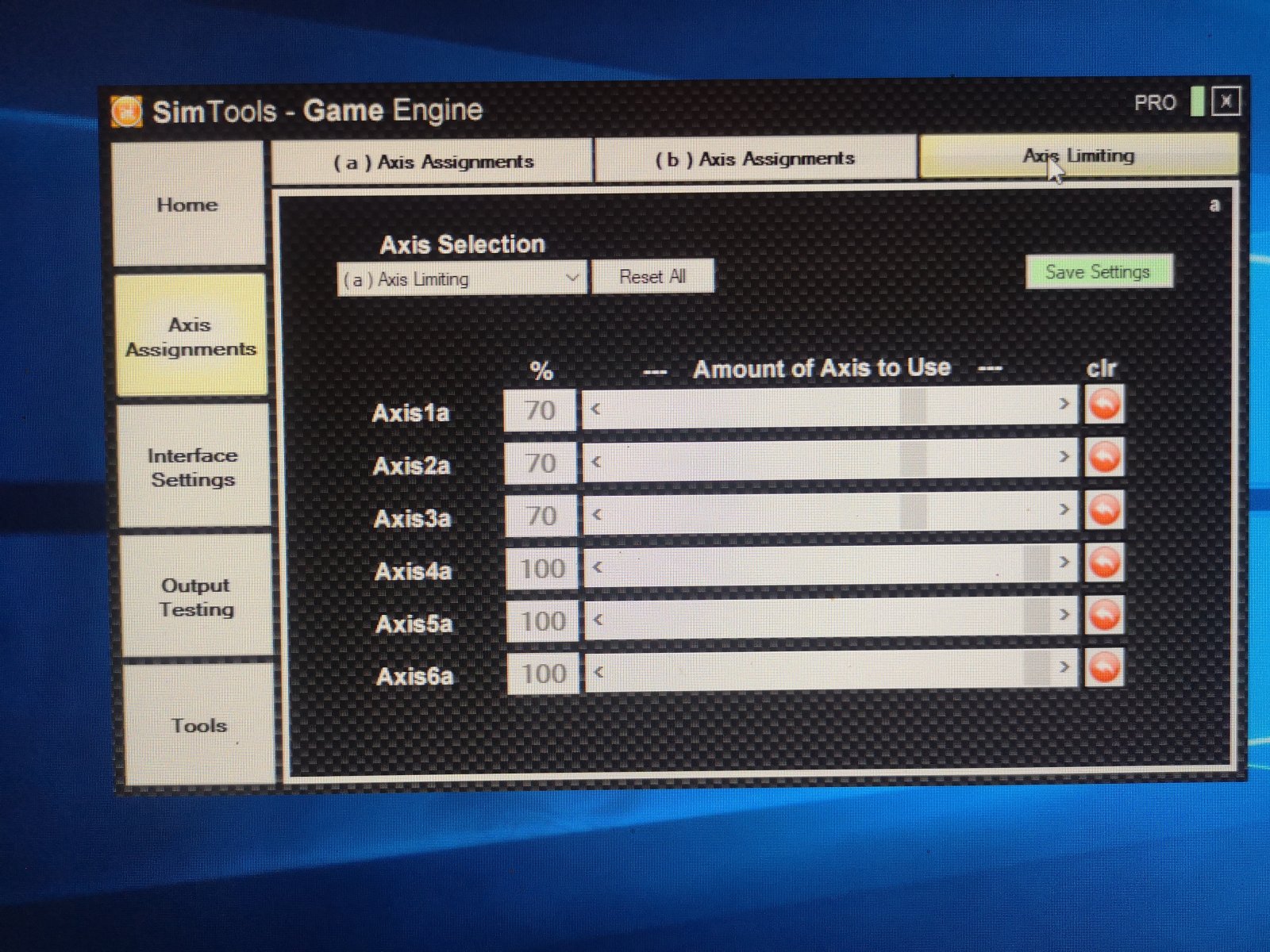

    And then i have another one question. I have problem with axis3... when it goes over some point in jumps to end and only in one way. I attached video. I solved it with axe limiting but it is not the best solution, because i lost a lot on movement on that motor.
    When it will work as I want, then i start to build the real one.
    Thanks for all answers.

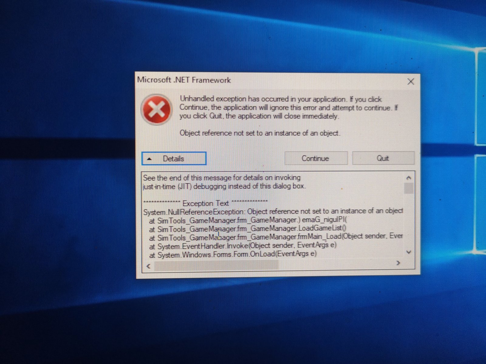

    Ok but now i wanted to add plugin for asseto corsa and i have this error and cant use game engine.
    The same happenned with rbr plugin.
    Where can i delete the plugin?

    Ok, i delete the plugin and now simtools running again. Whats is the problem with plugin.

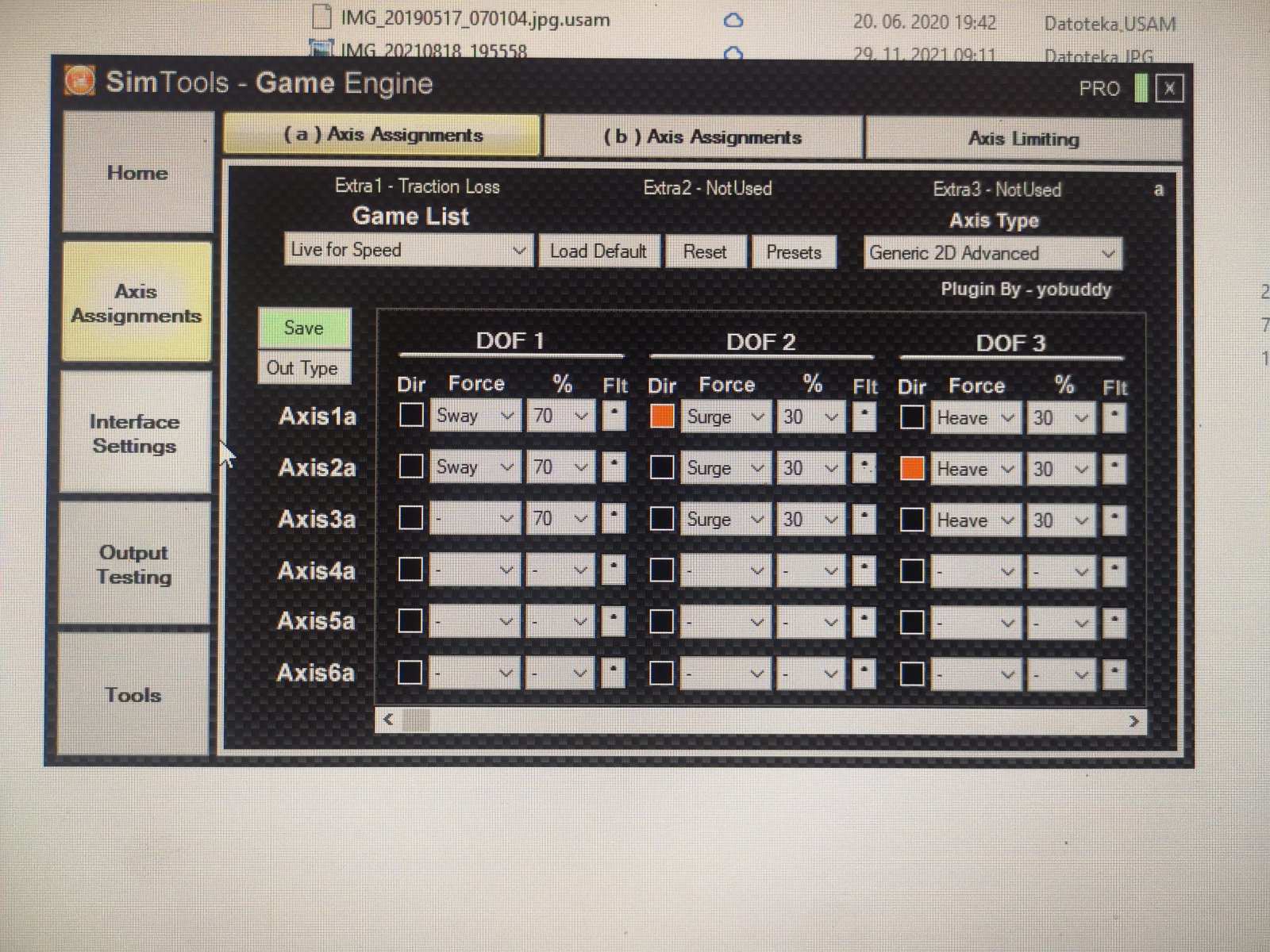

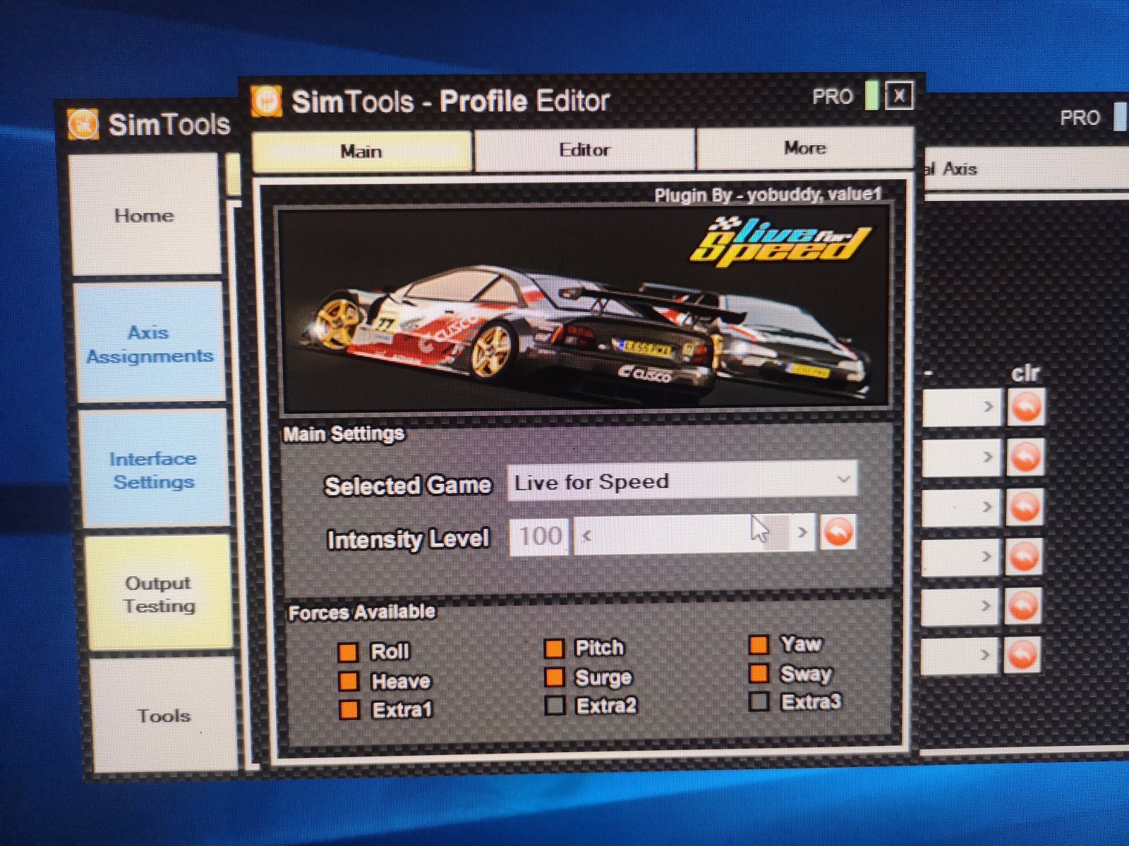

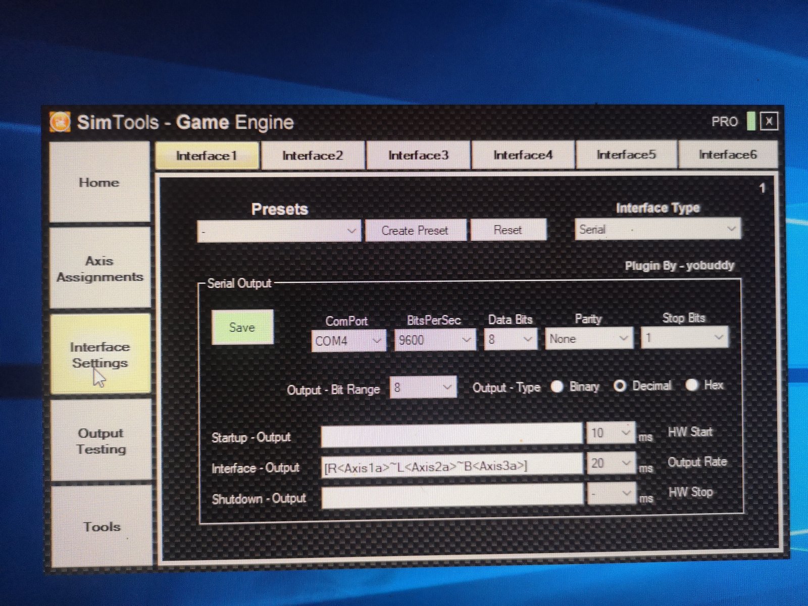

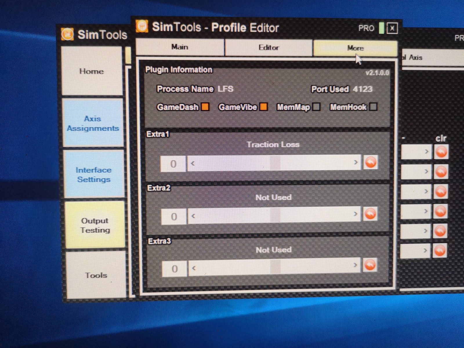

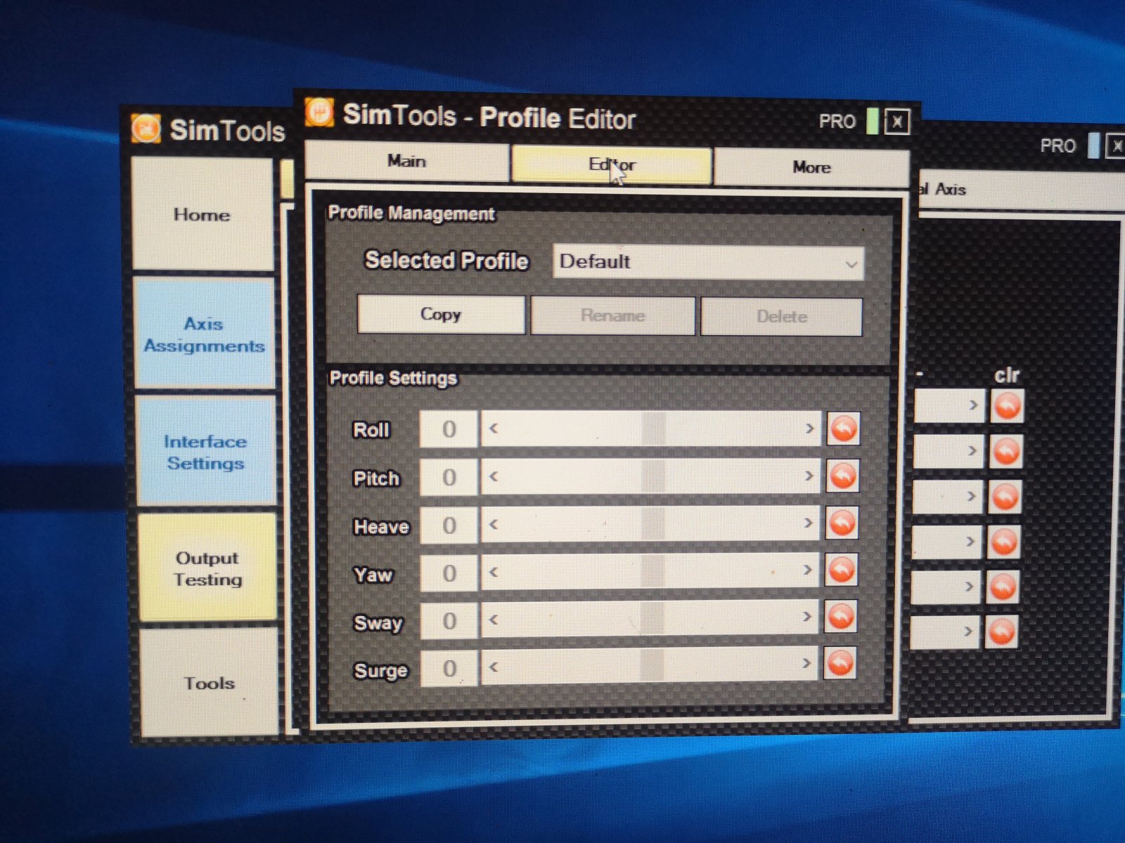

    Pictures of settings for live for speed in attachment. Is it wnough or do you need something more?

    Where did you get the plugins from?
    See here to delete plugin: https://www.xsimulator.net/community/faq/how-to-delete-plugins.319/
    Axis allocation total should be around 100%: https://www.xsimulator.net/community/faq/axis-assignment-percentage-totals.120/
    Before messing with any plugin verify that SimTools works as expected in Output Testing, using the properly configured Default profile.
