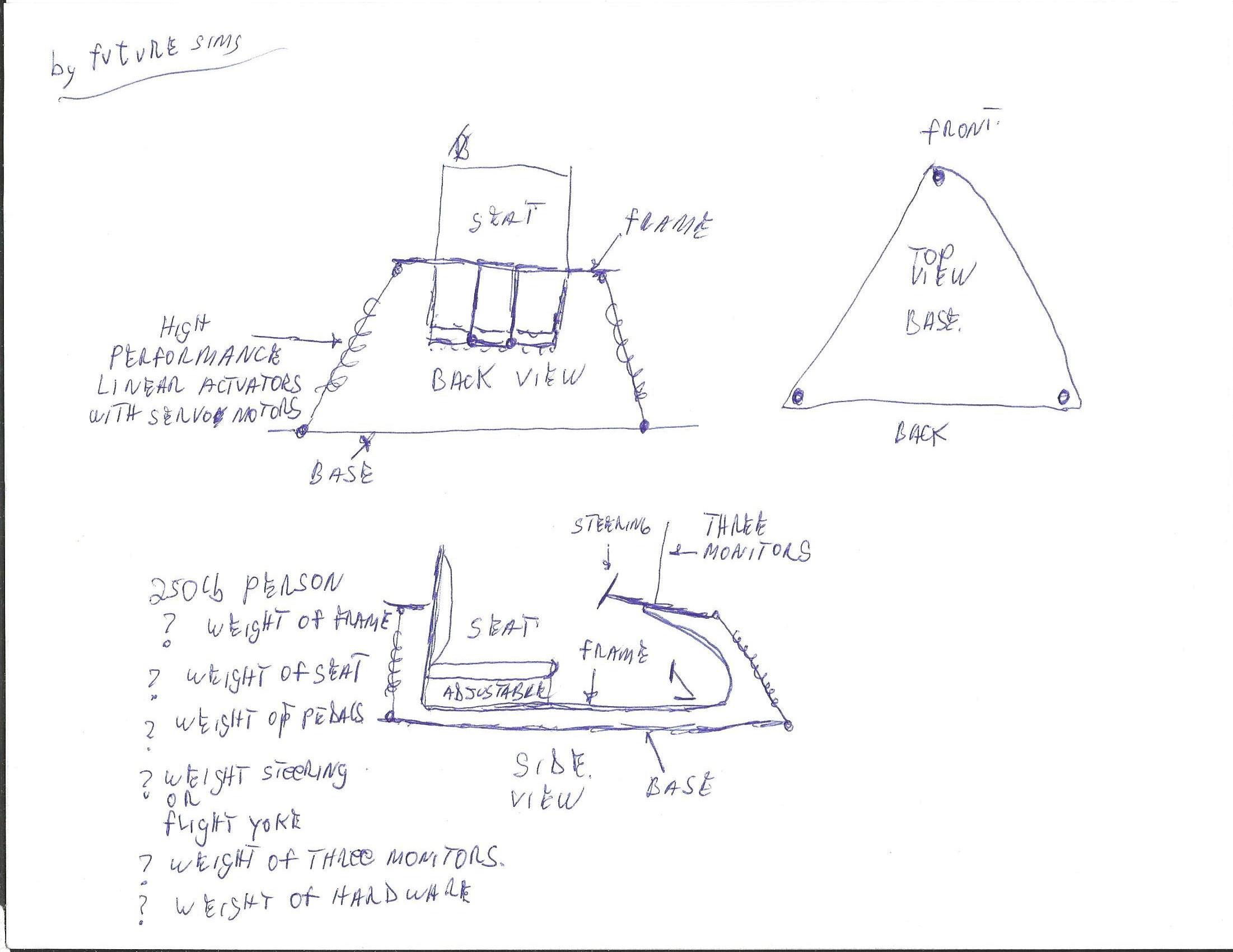

    Hi, can the X-simulator members help me with my project?
    I have made a very rough sketch of a 3DOF Motion Base.
    Two Linear Actuators in the back and one in the front.
    I made this sketch based on the Force Dynamics Simulator Principle.
    Can the X-Simulators members suggest High Performance Linear Actuators with High Performance Servo Motors for me to use?
    I would like this simulator to have very good and smooth movement.

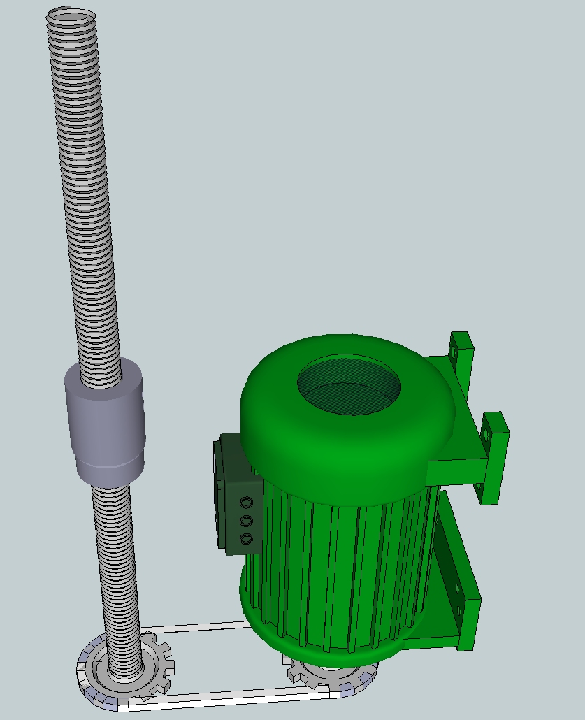

    What is your budget? If you want to build a Force Dynamics, you will need a lot of money. High speed, high load linear actuators are in the range of $5'000+ per actuator. :eek:
    The principle of the force dynamics is a threaded rod rotated by a 2 hp 230 V motor @ probably 60 rpm Drive Force Dynamics.jpg You can control the motor with a Variable-frequency drive (VFD) and will need a closed-loop controller that maintains the position of the nut – or, as you mention, you drive the ball screw with a servo motor.
    All in all a very nice setup - not cheap though. Again, it depends on your budget :)
    Edit: The tricky thing about 3DOF is that you have to move the full weight of the simulator while with a well balanced 2DOF you only battle with the inertia. The difference of power needed is substantial, at least a factor of 10!

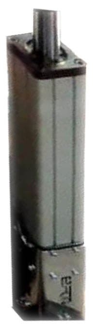

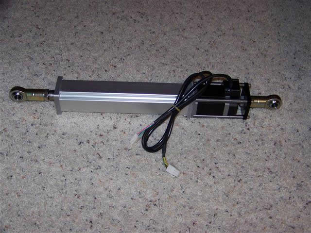

    This is what I have in have in mind to try.
    Can someone tell me where I can find this Linear Actuator?
    There is a part number on the image and I am hoping someone can tell me who's product it is and provide a web link.
    These Linear Actuators when retracted are approximately 3.5 feet long or approximately 1.0668m Long.
    These Linear Actuators are longer when they are fully extended.
    The image above is similar to this image.
    High speed Linear Actuators with 3DOF inline Servo Motors.
    Some comments that I have seen is that the first image could be the SCN6 or similar to it.
    The SCN6 images I have seen do not look like either one of the images I have posted here.
    I am also hoping to have some help in selecting a model for me to purchase and a controller to operate them.
    I already have the frame in mind.
    Thanks.
  7. bsft
    please post the part number here and any other details or numbers or letter written on the unit.

    Hi bsft,
    There is a partial part number on the vertical image name linear Actuator
    Click the image and at the bottom there is a partial number.
    I can't understand it but some one may recognize it in combination with its proximate size.

    do you actually have the actuators in front of you?
    I cannot read the number either........
    So, you need to get a PART NUMBER and or manufacturer details.
    No good posting a pic. I have actuators originally for moving bricks and I sent pics to suppliers, they came back wanting part numbers and dimensions, of which I had to supply.
    There are plenty of actuator suppliers on alibaba.com , but they will ask for part numbers and dimensions.
    For reference, ETH Parker Automation actuators are very fast and very strong and VERY expensive.
    http://onexia.com/Parker/Parker_ADD_ETH_Cylinder.html
    The actuators I was given BY CHANCE, are 120mm throw, but I had to re-motor them with 12v motors , but replacements are $2700 each less motors ;P , even a Chinese equivalent was $650 each ...
    Getting back on tangent....you need to find part numbers or dig through a catalog link like the Parker catalog. You may find what you are looking for and then , go to alibaba.com and contact chinese manufacturers.

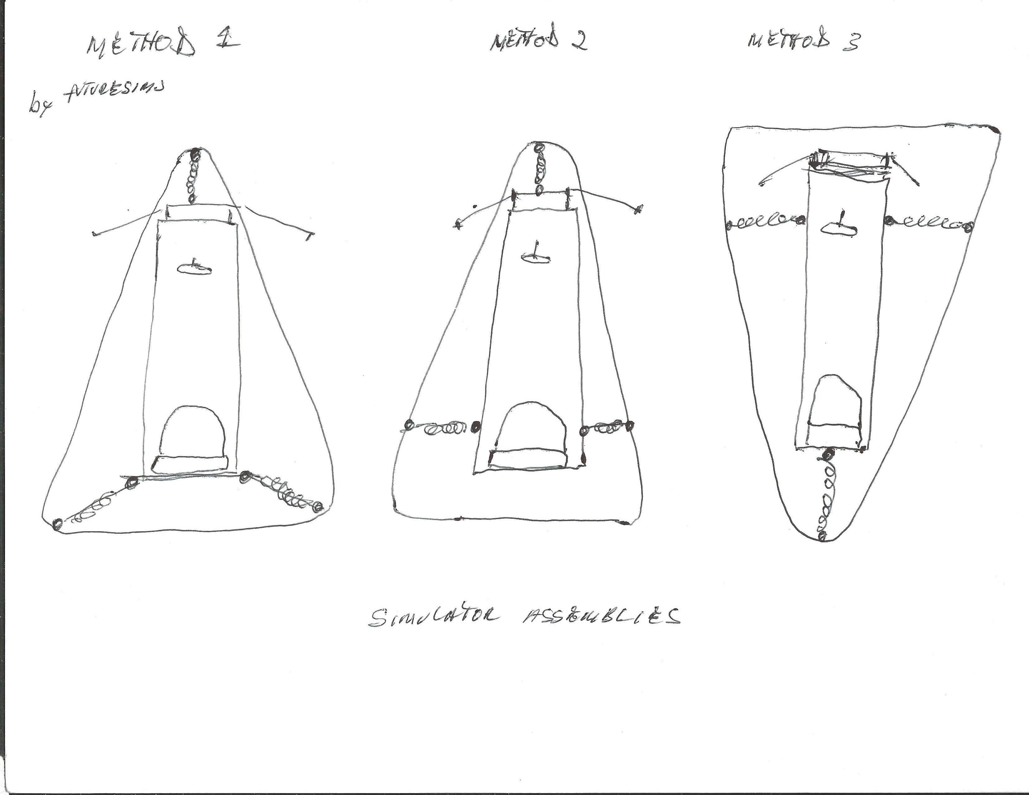

    I have seen several projects for the positioning of the three Liner Actuators.
    Method 1, Two Linear Actuators angled and positioned behind the seat and one in the front.
    Method 2, Two Linear Actuators angled and positioned next to where the armrests would be on the seat and one in the front.
    Method 3, Two Linear Actuators angled and positioned next to where the steering and or flight yoke would be and one in the back.
    Is any one method better than the other?
    I have seen these different configurations in the past and they all appeared to work quite excellently.
    Is there a formula for working out the positioning and the angle of the Linear Actuators from the base to the frame that will be moving with the person and seat?
    Now that I have costs comparisons underway I would like to move forward with the measurements of the base and the measurements of the frame including the seat, Steering and or Flight Yoke and the Monitors support.
    Is there a member here that could help me out with the measurements for assembling Method 1?
    Thanks.
