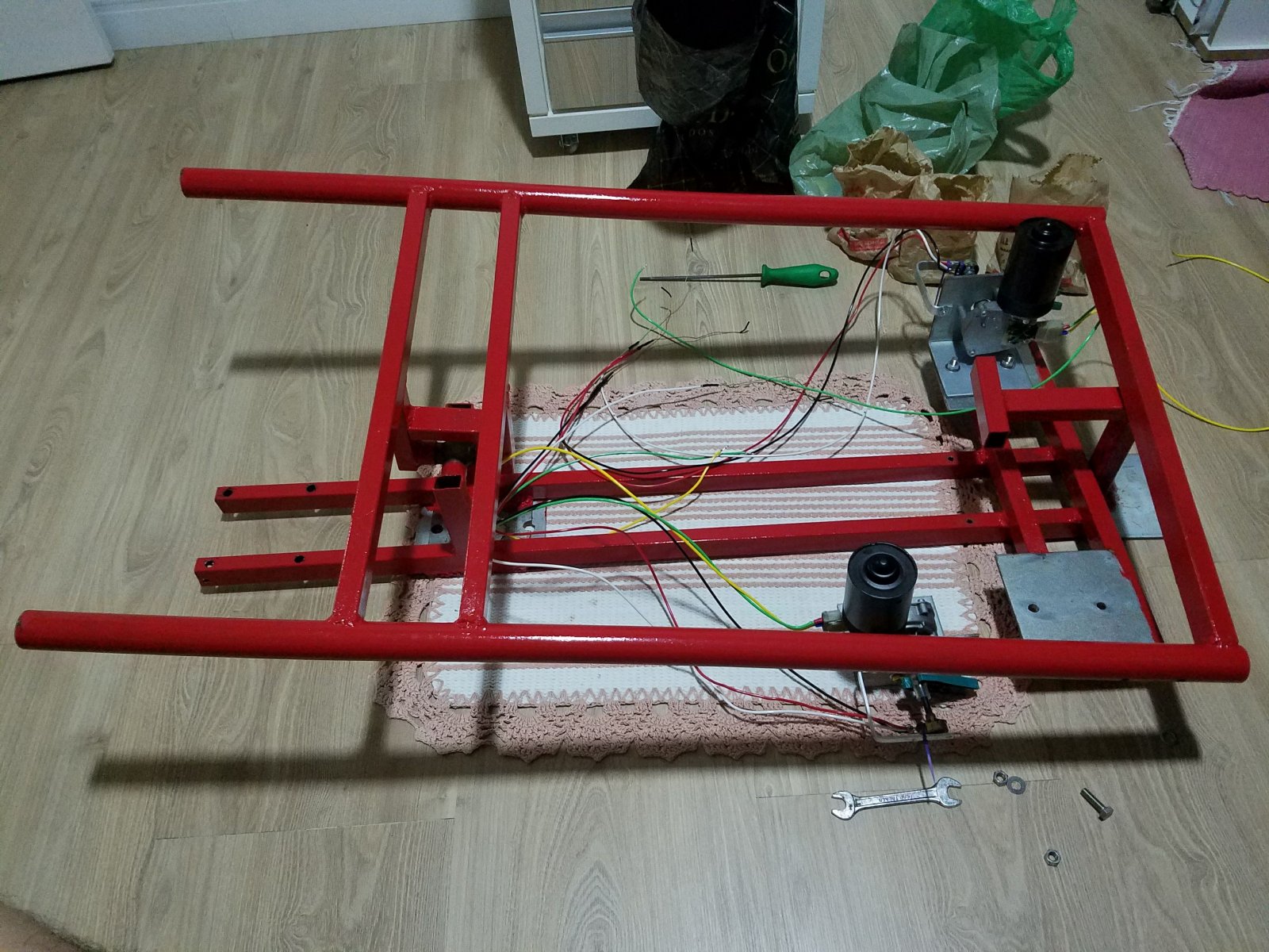

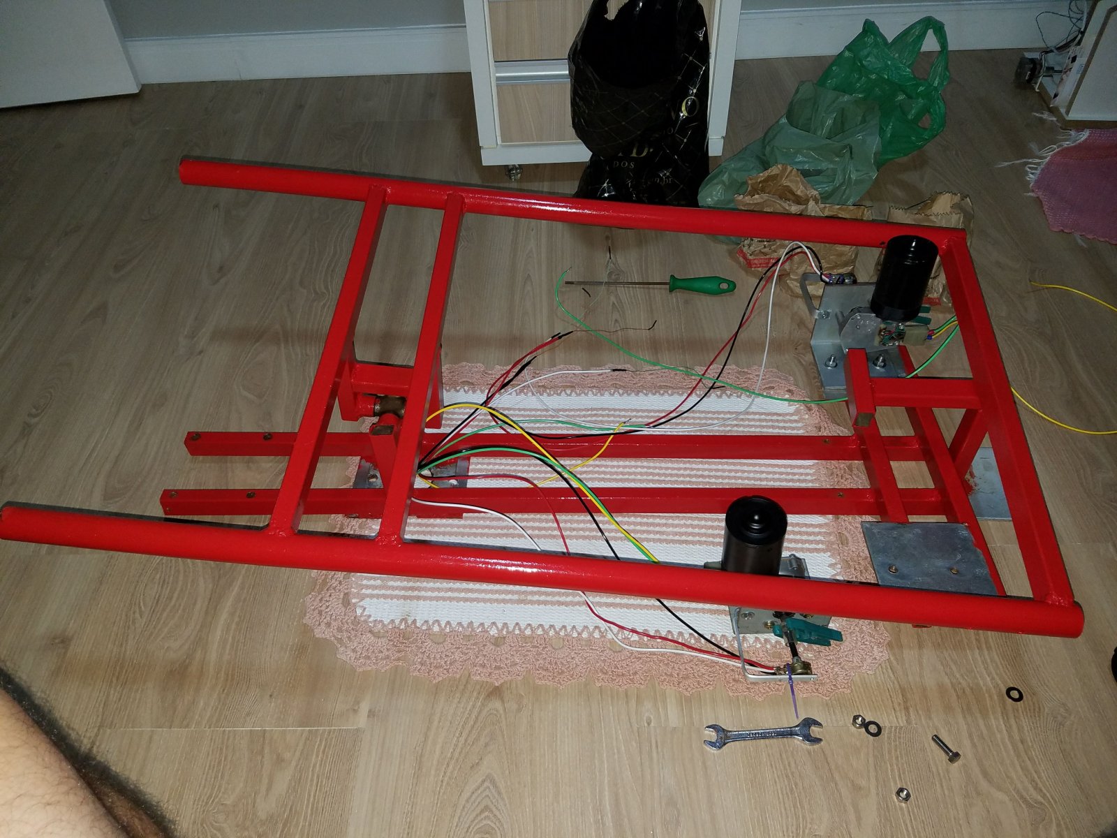

    This is my 3DOF project with Arduino and using Monster Motor Shield with wiper motor. First it will be 2DOF, but then it will be 3DOF with a 360 degree axis. The project is based on the RacingMat https://www.xsimulator.net/community/threads/2dof-arduino-simulator-with-rear-wipers.4896/

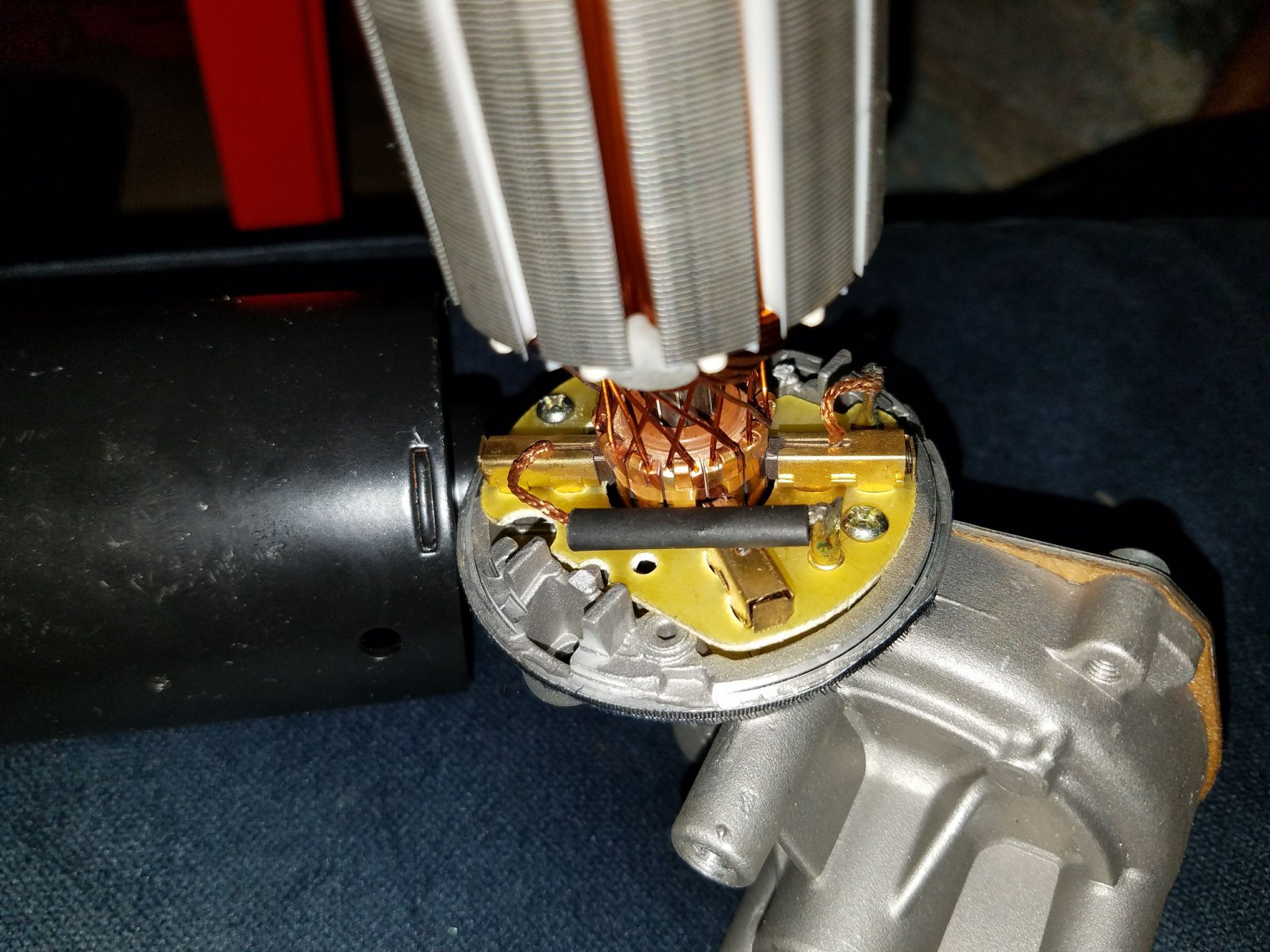

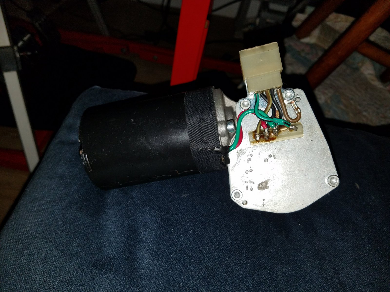

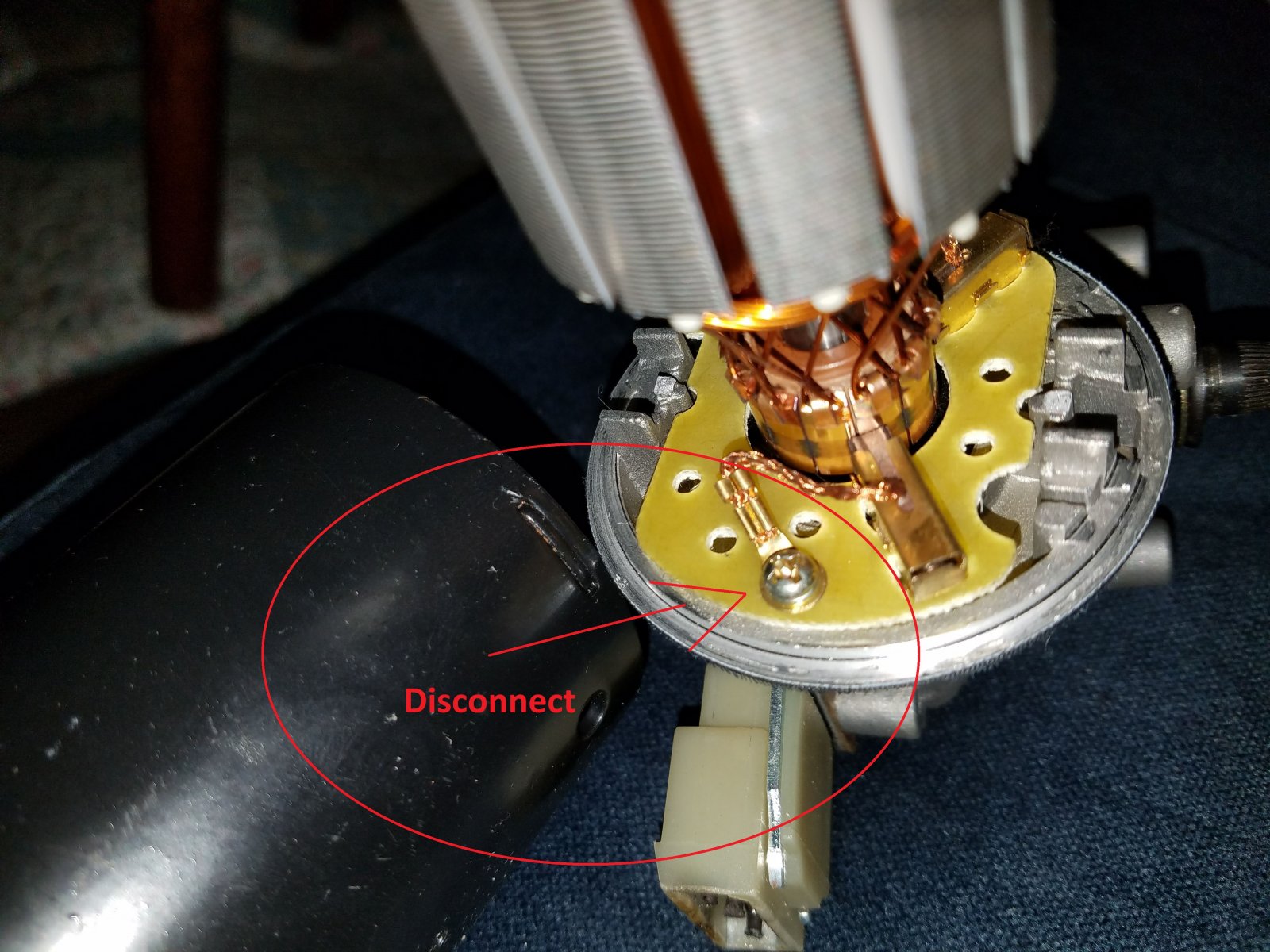

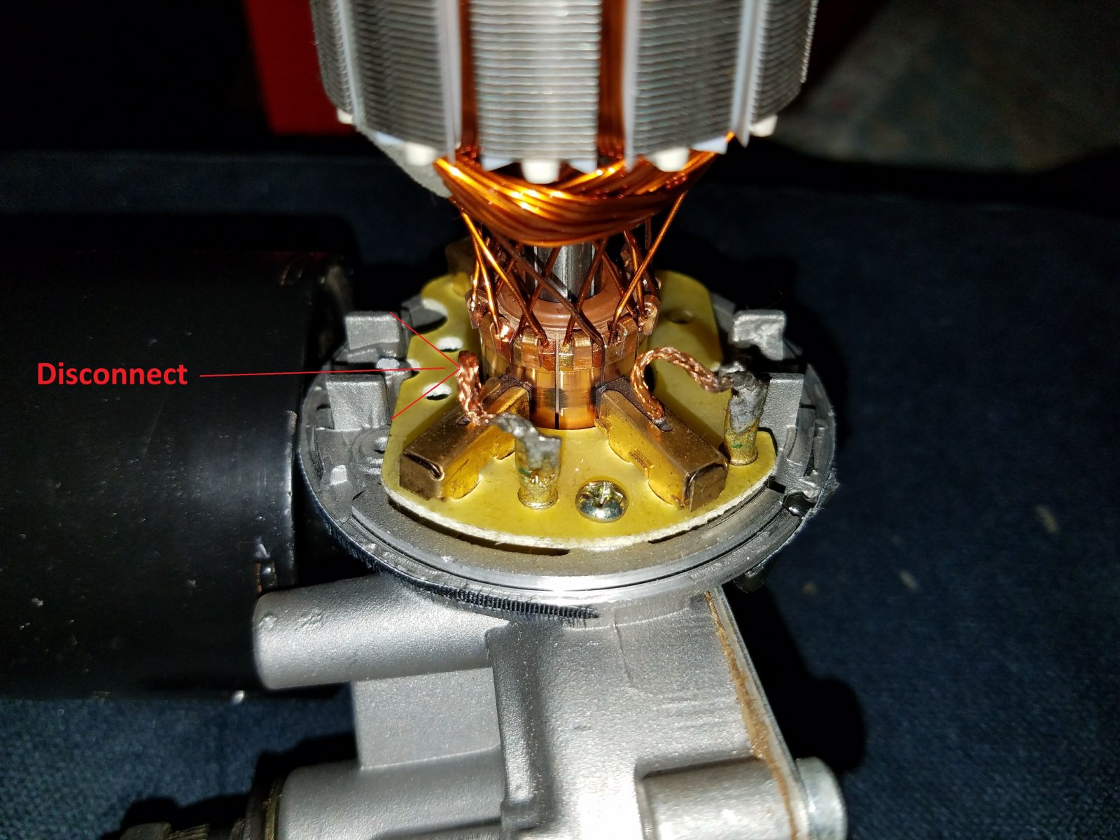

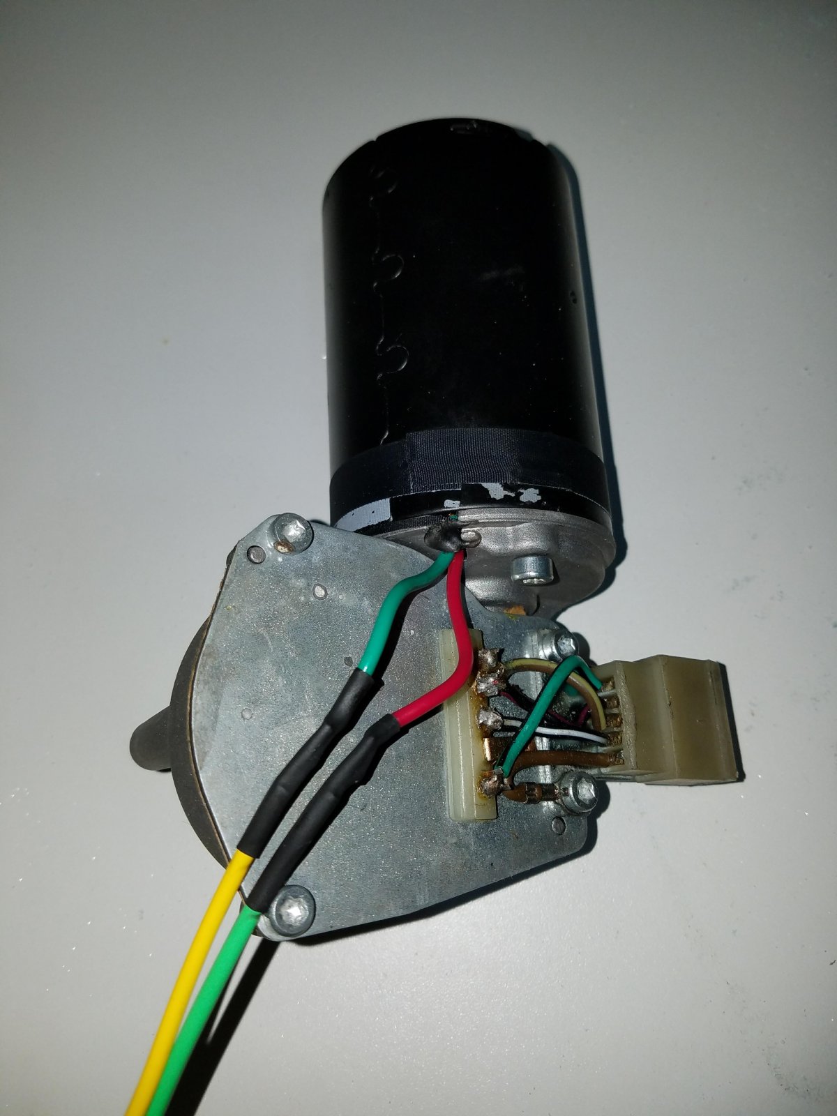

    Very Important!!!!
    Do not switch on the wiper motor without changing the internal circuit as it may burn your Monster Motor Shield.
    Open wiper motor and disconnect the wires:
    Connect us:
    Ready:

    As I understand, was the ground connect on the hull?
    Very useful. Thanks for the advice, I wouldn't know about it cause the number of channels out of motor doesn't
  8. fidocrespo
    fidocrespo New Member
    May 13, 2012
    6
    Full Stack C#
    Florianópolis, SC, Brazil
    19Coins
    2DOF, 3DOF, DC motor, Arduino
    In my case yes, the ground was connected in the hull.
    If you need help, I'll be happy to help.
