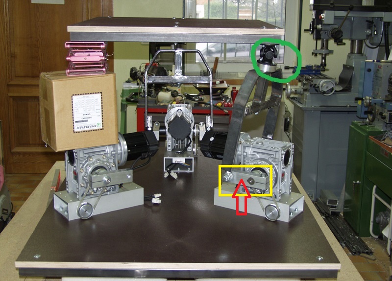

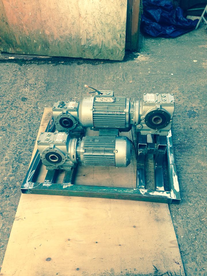

    My plan. is to do this like on picture:

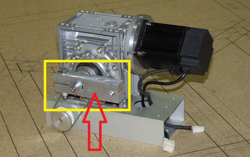

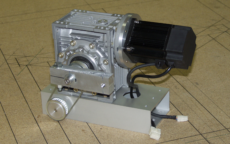

    You think your belt is a little loose and needs tightening? Just for the sake of more accurate actuator position readings. Would be best if it was directly connected to it via gears.
  6. misoswan
    misoswan Active Member
    Jun 27, 2014
    291
    1,032Coins
    +77 / 1 / -0
    3DOF, Arduino, JRK
    It is not mine. I will do alike.I thinks it's sufficient.

    Just make sure there's means to adjust it.

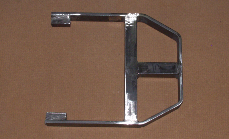

    Have you bought this lever for both sides of each motor and the Axes ?
    your motor gearbox have hollow axe .

    So far I've bought Aluminium Flat Bar
    Width 50 mm
    Thickness 25mm
    Length 1000mm
    It's still not ready...
    It should look as follows .I do not have determined length.

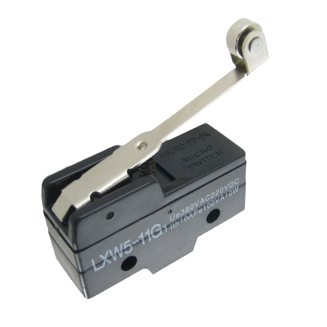

    Where did you get the idea of the limit switch ?
    thanks

    somewhere on the forums ....
    I feel like here something.... listed in forum within for @cthiggin but I'm sure.

    Hi :) @misoswan ... Feel free my friend to ask and know as much as you can for what is the best for your chosen platform ... and for information about the limit switch :
    They are used where there is any possibility for a mechanical damage if the control system fails .
    Look at this video and pause at the 00:05 & 00:08 for the upper and lower limit switches ...
    There are 2 black switches like the photo below placed up and down the motion range and connected to the VFD to stop the motion and prevent any mechanical damage ... which is not needed in your platform .

    hi @speedy
    hello thank you for the explanation, and now I understand from video.
  18. tronicgr
    tronicgr
    You can connect the limit switches to the stop function of the vfd drive but then it won't auto recover the motor position. The method I mention on the link above actually just blocks the motion beyond that particular direction towards that limit switch while allowing the vfd drive to remain activated to drive the motor back to other direction with no "error flags" to lock the vfd drive.

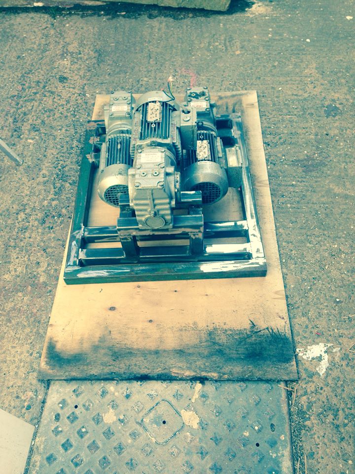

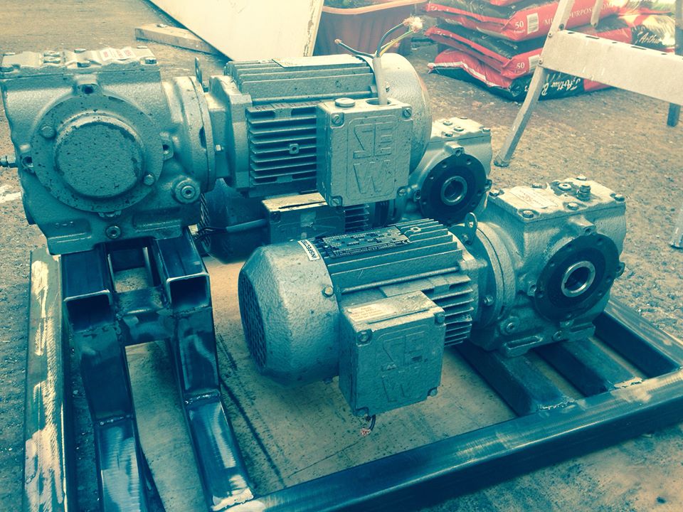

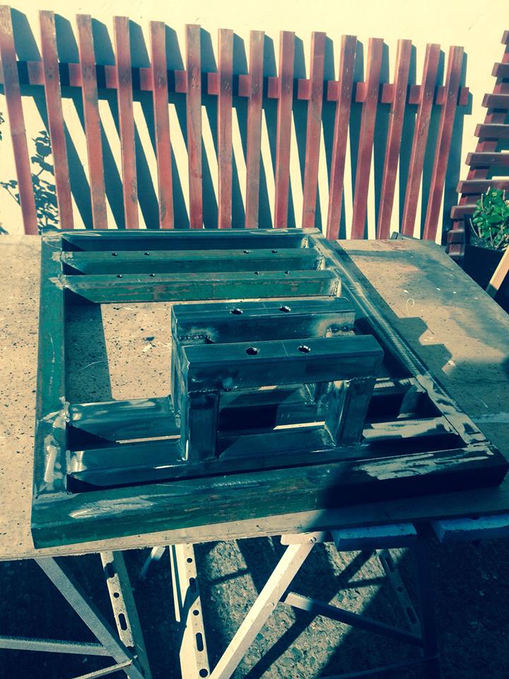

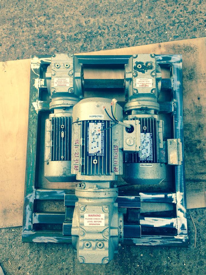

    my small upgrade
  20. misoswan
    Jun 27, 2014
    291
    1,032Coins
    +77 / 1 / -0
    3DOF, Arduino, JRK

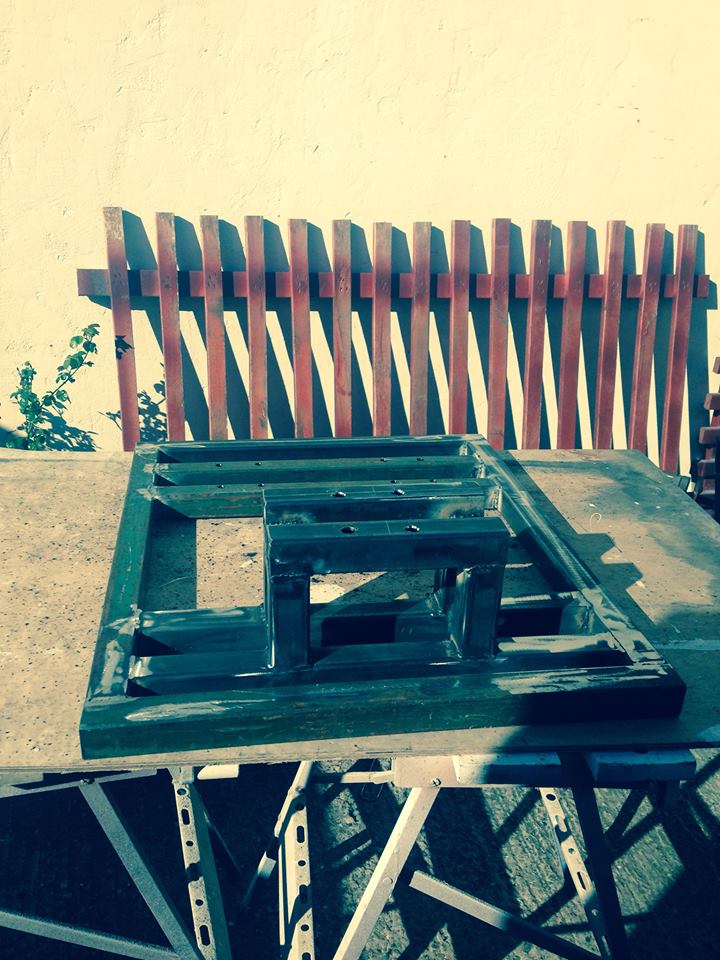

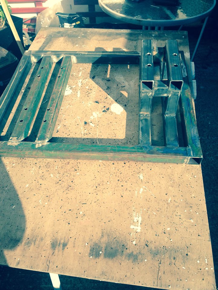

    upgrade
