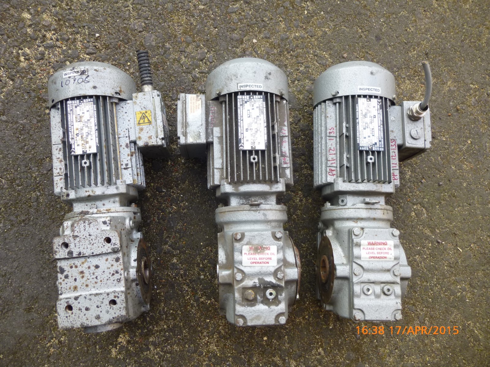

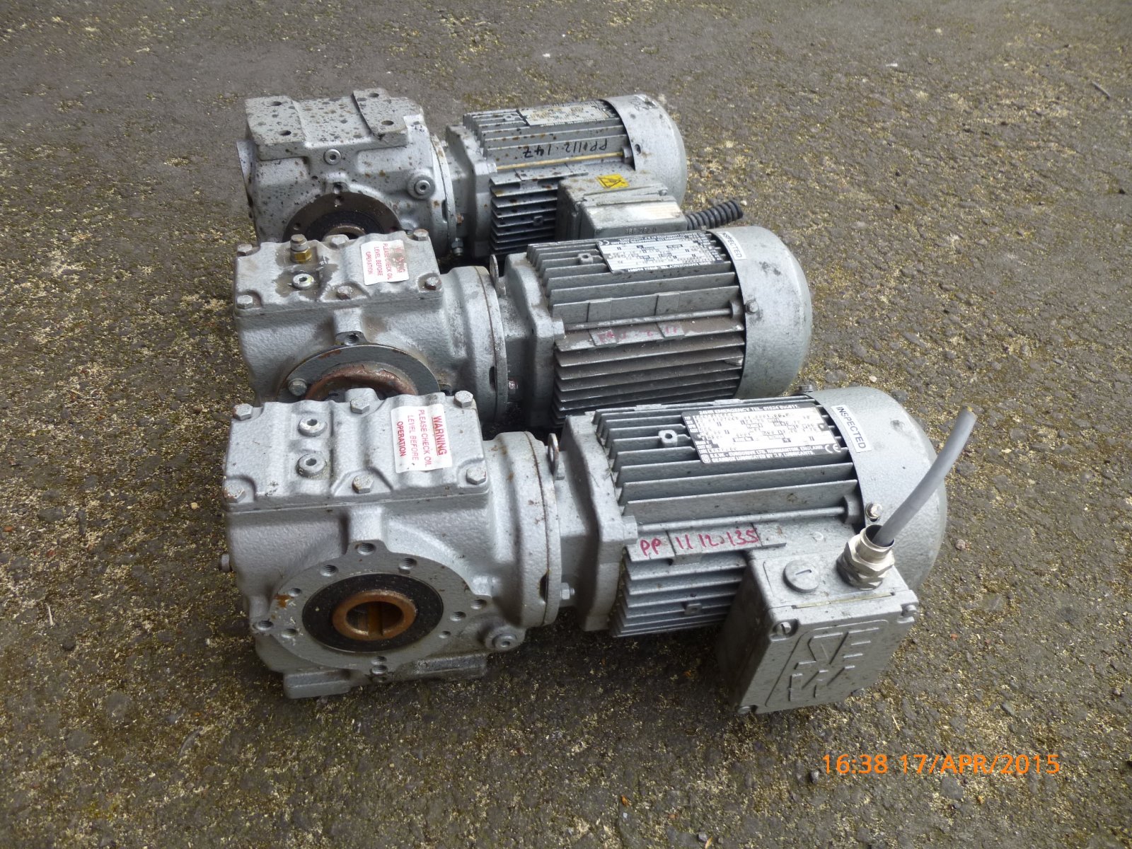

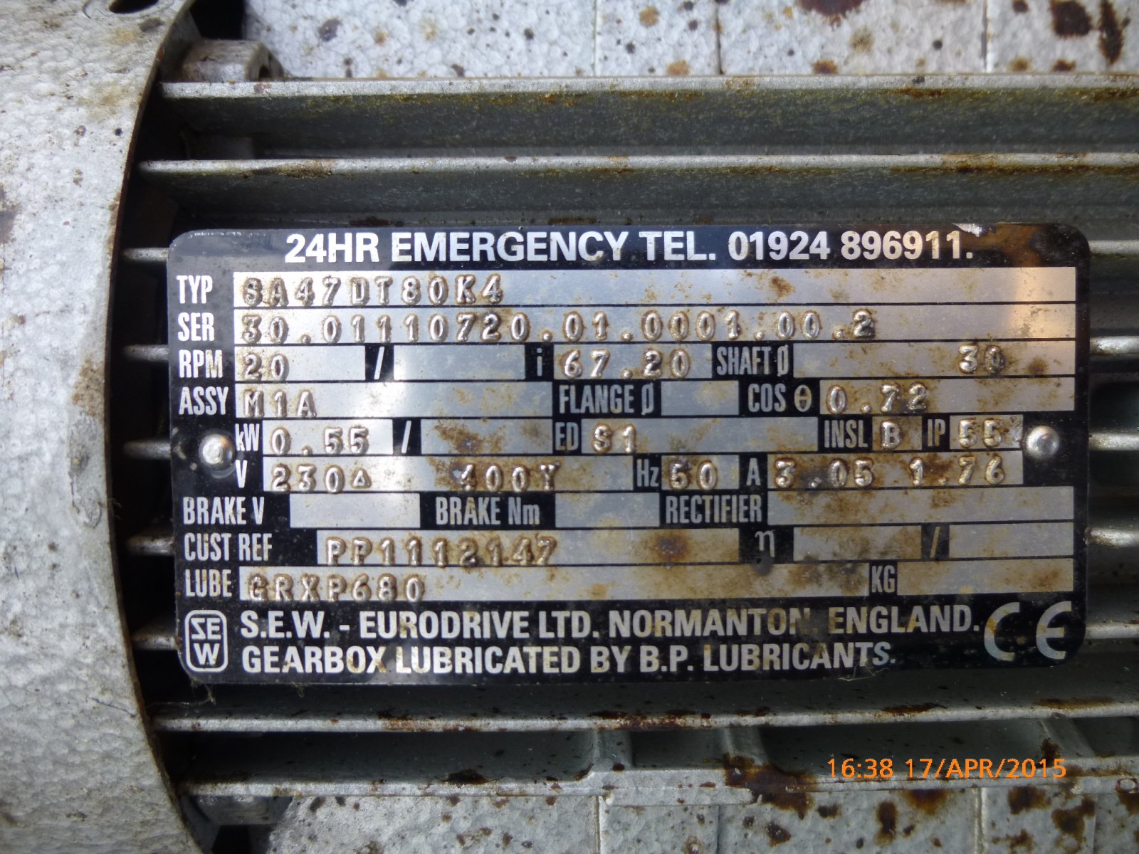

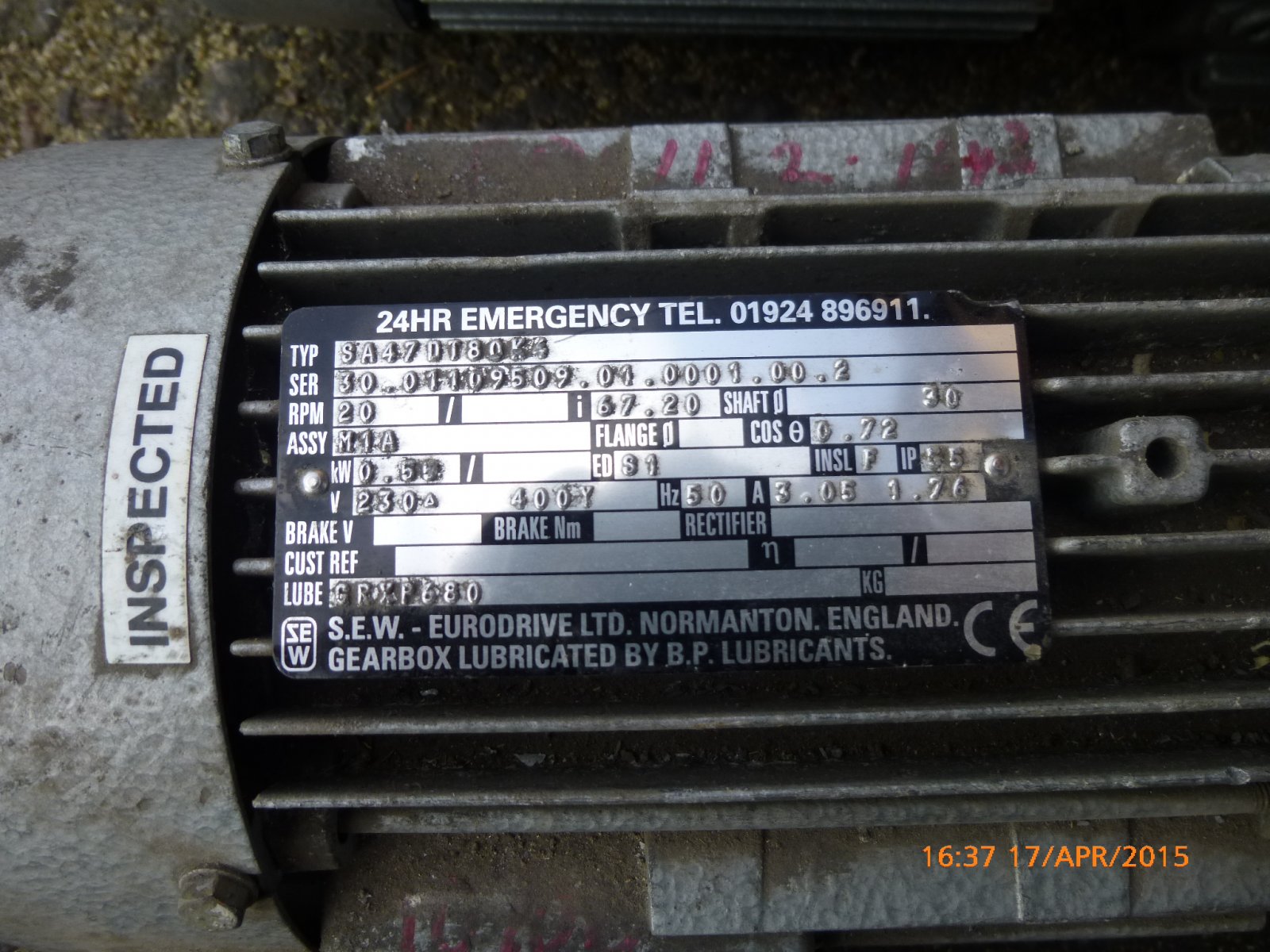

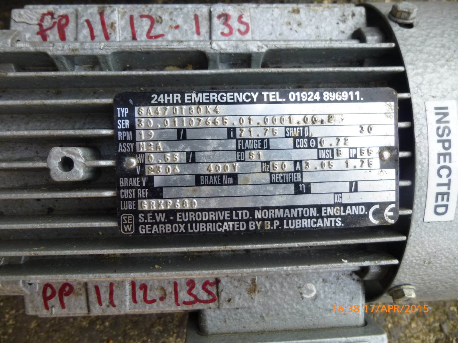

  12. speedy
    speedy Well-Known Member
    Feb 1, 2012
    1,193
    Alexandria , Egypt
    7,943Coins
    +1,287 / 10 / -0
    those motors are not ready for a front mounting flange ... so there is no way you can mount such gearboxes to them even the correct size .
    I prefer the SEW motors as they are ready assembled and the gearbox can provide enormous torque in the output shaft (crank arm) with a minimum motor HP .
    there are tones of such used with good condition motors in UK ...
    http://www.ebay.co.uk/itm/SEW-SA47D...719?pt=LH_DefaultDomain_3&hash=item43da2bb69f
    here is a 3/4HP faster motor ...
    http://www.ebay.co.uk/itm/SEW-Eurod...068?pt=LH_DefaultDomain_3&hash=item4d2cbb6b94

  14. adgun
    adgun Active Member
    Jan 28, 2008
    537
    mechanic
    Netherlands
    5,790Coins
    +138 / 4 / -0
    Those moters can be ordered with the right flens B5

    what engine speed look? first have 19 rpm second 129rpm .thanks

    I found these
