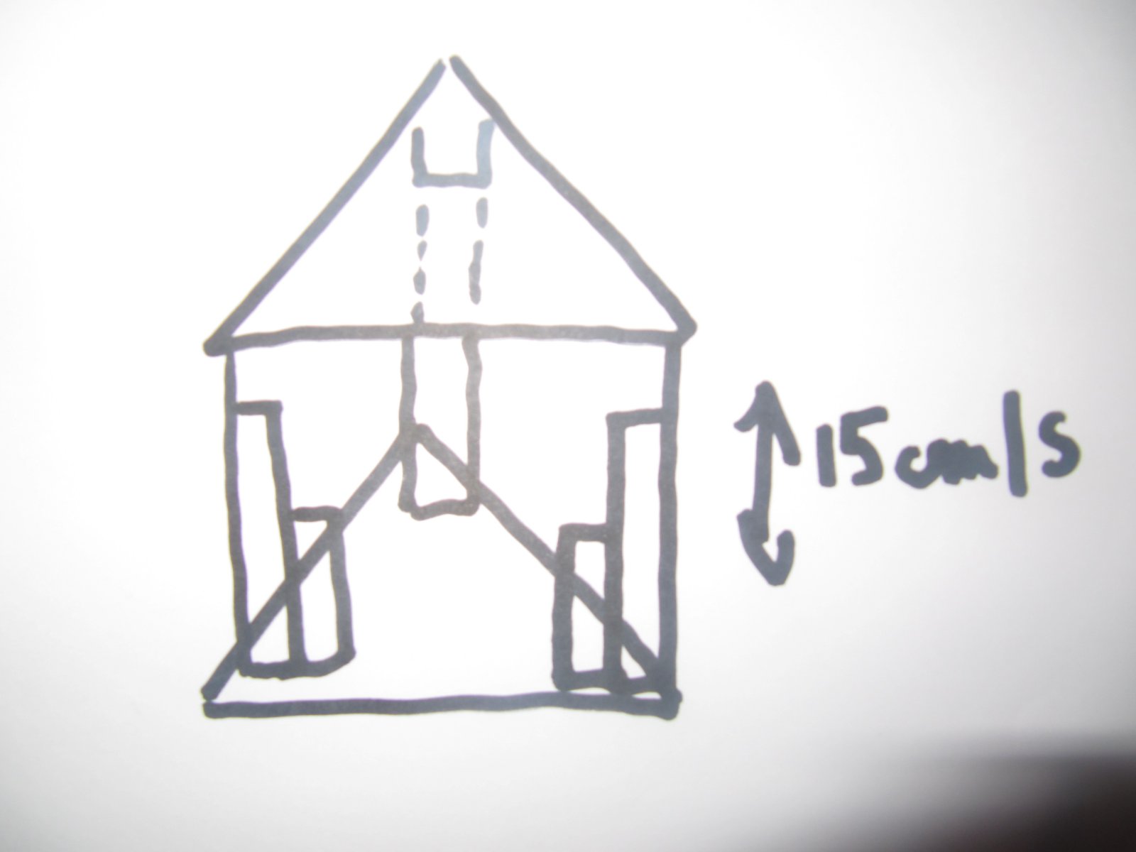

    hi am start build 3 dof . need help I need arduino code for stepper motor.
    how To connect arduino + stepper motor with simtools.thanks
    am used nema 34(steper motor) 12Nm+cnc driver+arduino uno. thanks

  3. bsft
    3 dof drift or 3 dof lift?
    do you have an example photo of what you would like to build

    sorry it is fast drawing
  5. bsft
    3 dof lift, ok
    I will let someone else advise

  8. RacingMat
    2,237
    21,035Coins
    @misoswan : you will need to add some anti-rotation system on this 3DOF lift design. Do you have already an idea about this?

    anti-rotation system?I do not know what you mean. am used linear acurator and change engine ,Timing Pulley Belt Set Kit Reducer Ratio 6:1

  11. RacingMat
    2,237
    21,035Coins

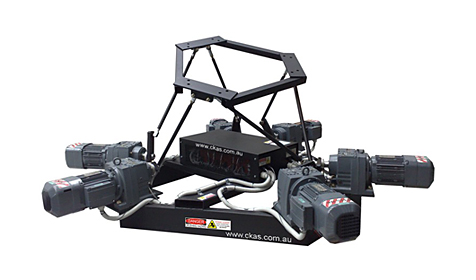

    yes, your design is not stable: 3 articulated rods... and the plateform will fall instantaneously
    For a similar design but stable, it is 6DOF!
    For 3 DOF only, you need to add a guide to allow heave without sway!
    Look at the central part of this 3 DOF
    3_DOF_Motion_Base_-_2000_Lbs.jpg ;)

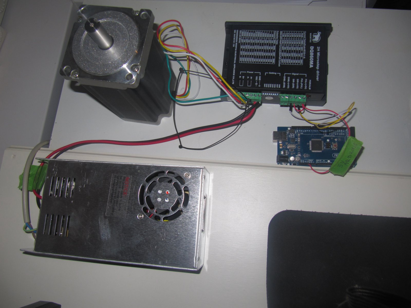

    Or maybe like this below, if your motors are big enough - were the actuators are mounted to a hinged joint at the bottom. As for stepper motors - Ard just driving a stepper motor - easy, but for a sim - high speed + high torque stepper + feedback (rotary encoder etc) and running the required code at the required speed on a Ard - not so easy.

    i have 3x steper motor 12nm.
    1x CNC Power Supply 350W 60V 6A For CNC Stepper Motor Driver MA860H M542H NEMA34
    3x steper driver DQ860ma
    1x arduino mega
    later i buy linear acurator .
    how can i connect an test the stepper motor, can anyone help please, an do i need to nut anymore bits for it to work
