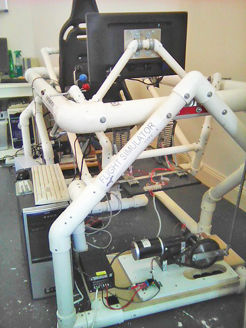

  10. Jugle
    Jugle New Member
    Jul 2, 2013
    23
    Bored Witless
    Bairnsdale, Victoria, Australia
    43Coins
    +25 / 0 / -0
    DC motor, JRK, Joyrider

  19. Jugle
    Jugle New Member
    Jul 2, 2013
    23
    Bored Witless
    43Coins
    +25 / 0 / -0
    I'll post a video and some images that detail the motor and pushrod connections shortly... sorry, sim is in my office at work, no space at home!
