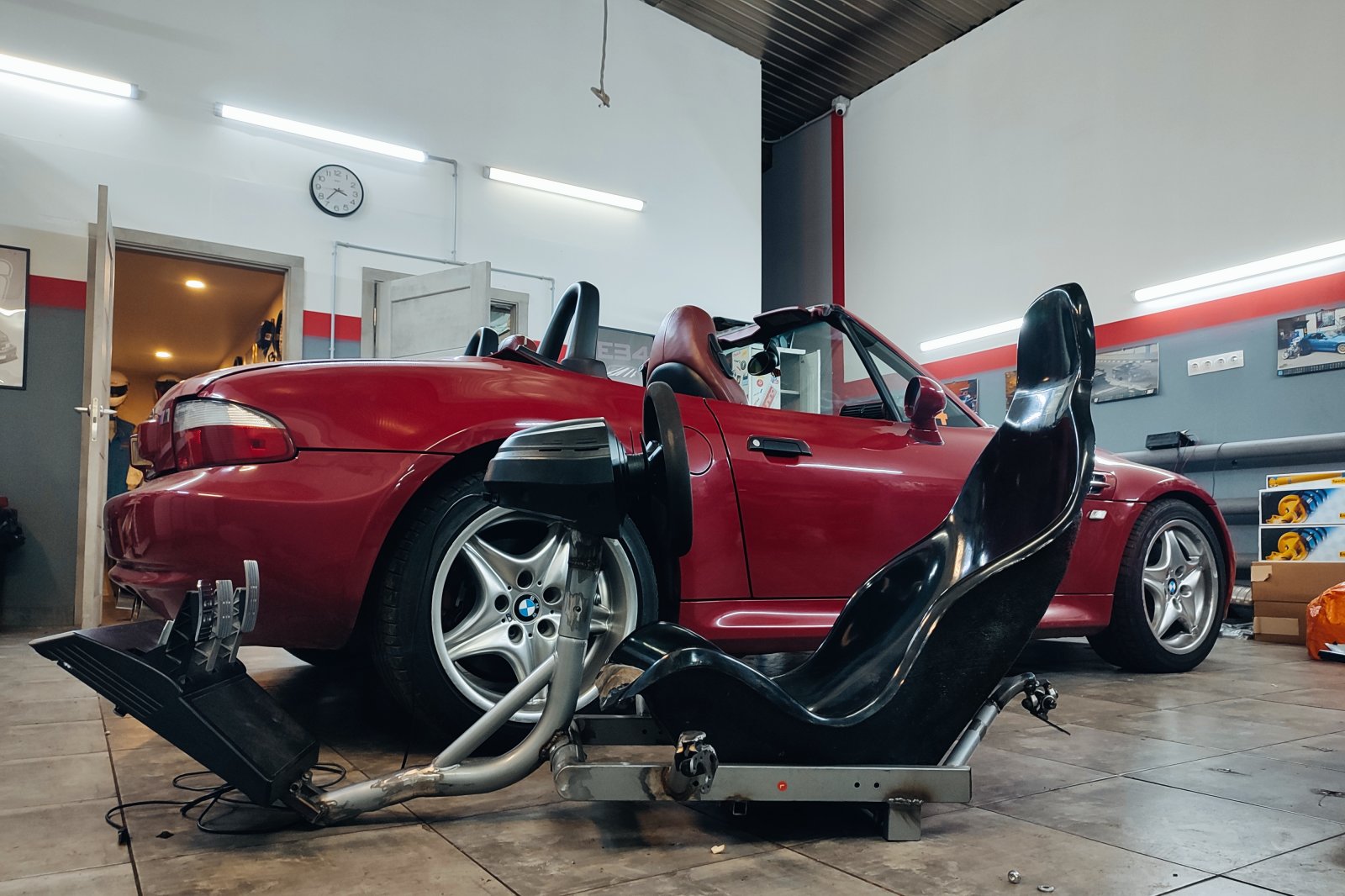

    Fantastic job! The motion is looking very good. What dofs are you running? (Surge, sway, heave,etc)
  5. m50b20
    m50b20 Member
    Jan 4, 2024
    87
    118Coins
    +60 / 1 / -0
    Thanks! It just first test, can't achieve roll more than 3-4 degrees in LFS )), in output test it's much bigger, need to sort out
    Roll, pitch, heave, surge and sway, don't know if it right way to use some of them with 3 actuators

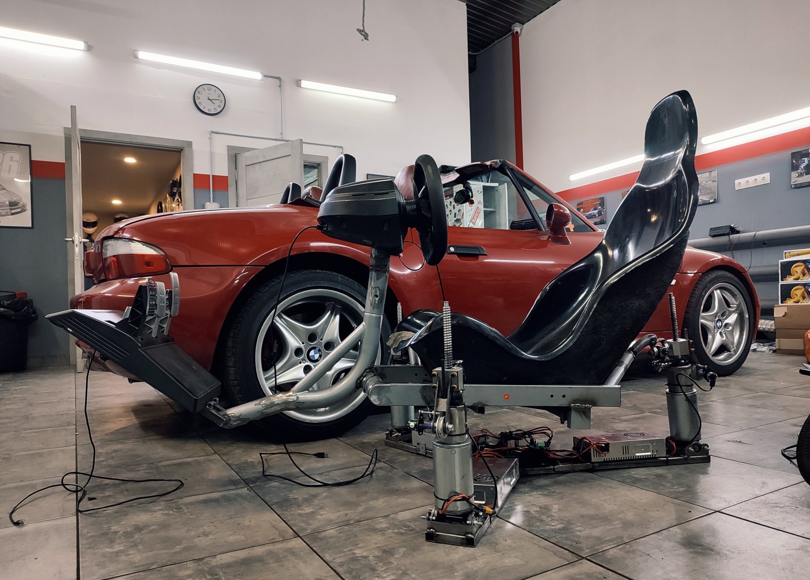

    Time for some tests before disassembly for painting
  11. m50b20
    m50b20 Member
    Jan 4, 2024
    87
    118Coins
    +60 / 1 / -0

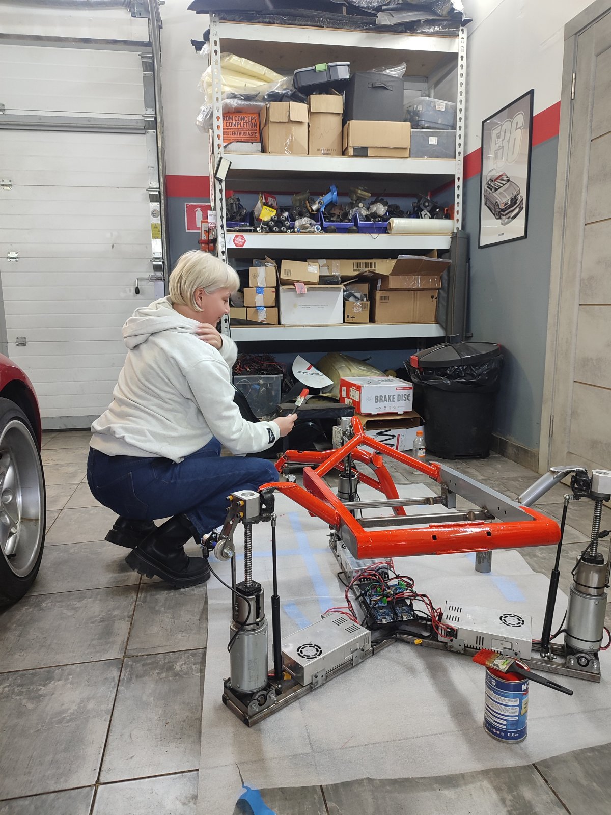

    Sort out little roll in lfs - it must be sway )))
    Add one gas strut to each motor, 230n, it helps to much lower the noise and add smoothness and speed. @early_m, one strut on back motor is enough for my rig
    Can't wait to bring it home and run Dirt Rally 2 )))
  12. noorbeast
    22,185
    154,750Coins
    +11,196 / 57 / -2
    Set sway to lean away from a corner and roll the opposite.

    Color must be different, but as is
  16. m50b20
    m50b20 Member
    Jan 4, 2024
    87
    118Coins
    +60 / 1 / -0
    Made travel 2-3 times less than on start, don't need it that much
    Maybe with vr (later) i will increase it back

  20. m50b20
    m50b20 Member
    Jan 4, 2024
    87
    118Coins
    +60 / 1 / -0
    Totally wrong settings))
    Revised everything, add smoothness to some forces, add travel, changed sway direction - much better. It becomes helper but not the thing to struggle with
    Now it's time to work ))
