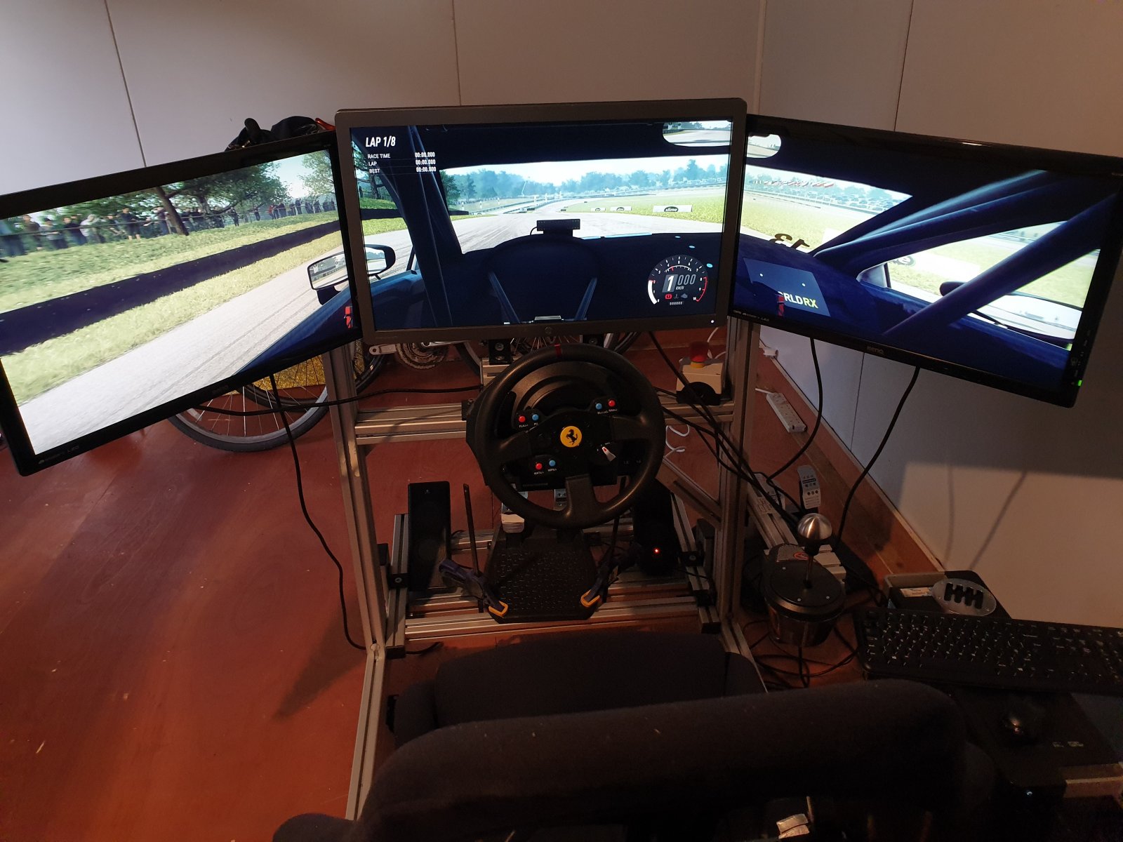

    20200512_195912.jpg - added 3ple screens - highly recomended. it adds lots of immersion.
    I still have small issue with the inverter noise. I will try to earth motors and everything tomorrow and we will see. Any ideas how to get rid of it?
    I have read something about adding capacitors...

    Regarding the motor NOISE- Fixed
    I have lowered the PWMmin value right to ''0'' and now the noise is gone.

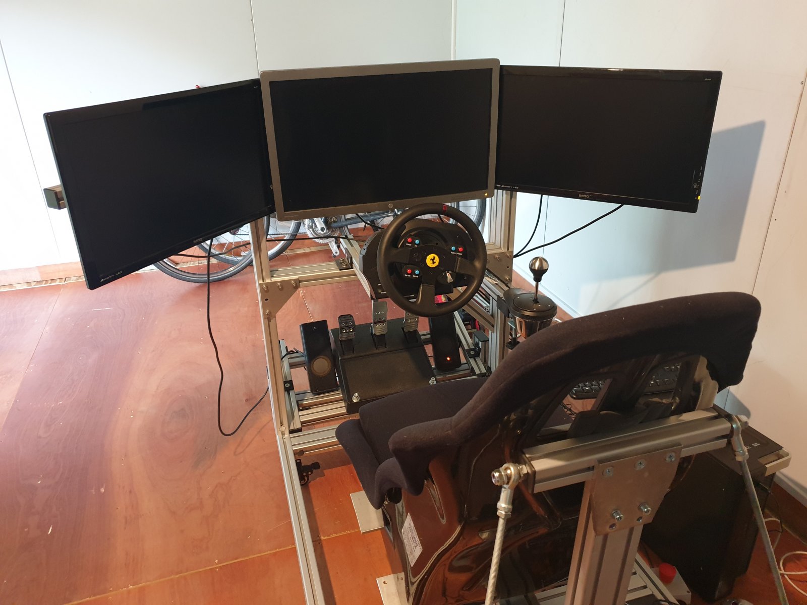

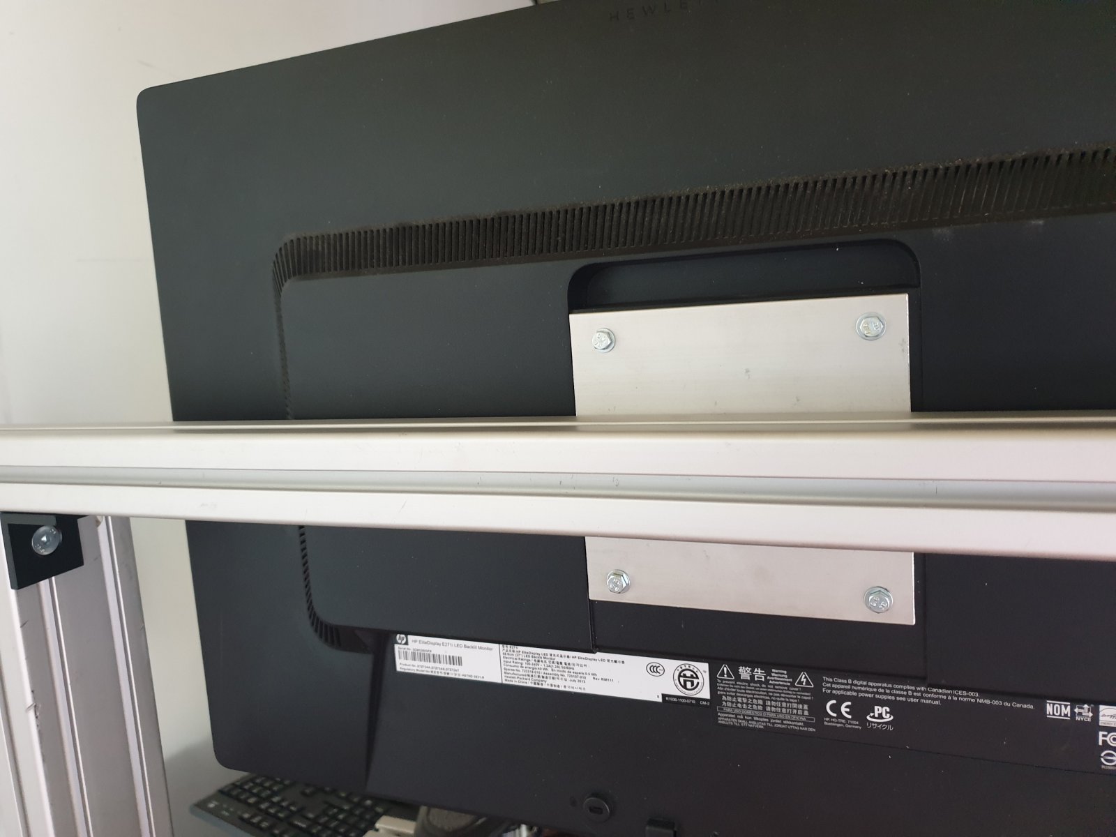

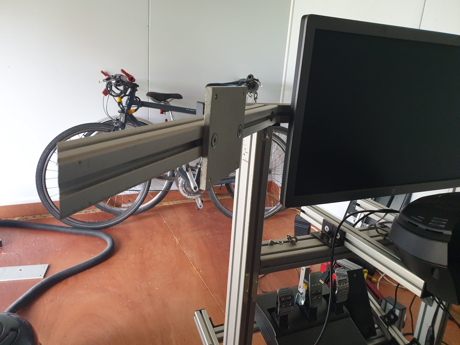

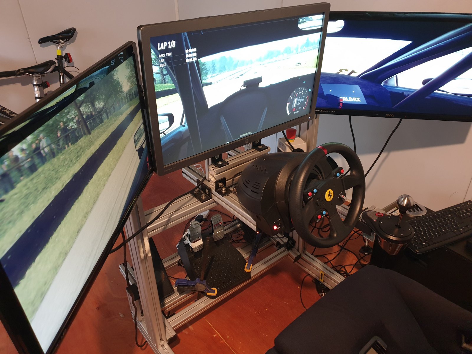

    Small update on my project:
    I have upgraded my triple monitor stand.
    Now is solid, stable and fully adjustable.
    20200609_141156.jpg 20200609_153805.jpg 20200609_153756.jpg IMG-20200609-WA0004.jpeg IMG-20200609-WA0008.jpeg 20200610_151118.jpg

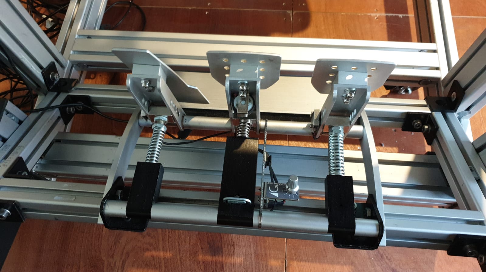

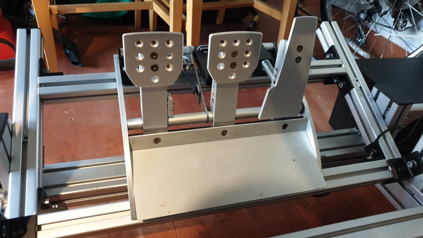

    few photos on the frame:
    WhatsApp Image 2021-02-23 at 16.18.59.jpeg WhatsApp Image 2021-02-23 at 16.18.59(1).jpeg
    Small issues with the V1
    USB socket needed resoldering
    hall sensors needed adjustment
    once you fix those then you have a great upgrade.

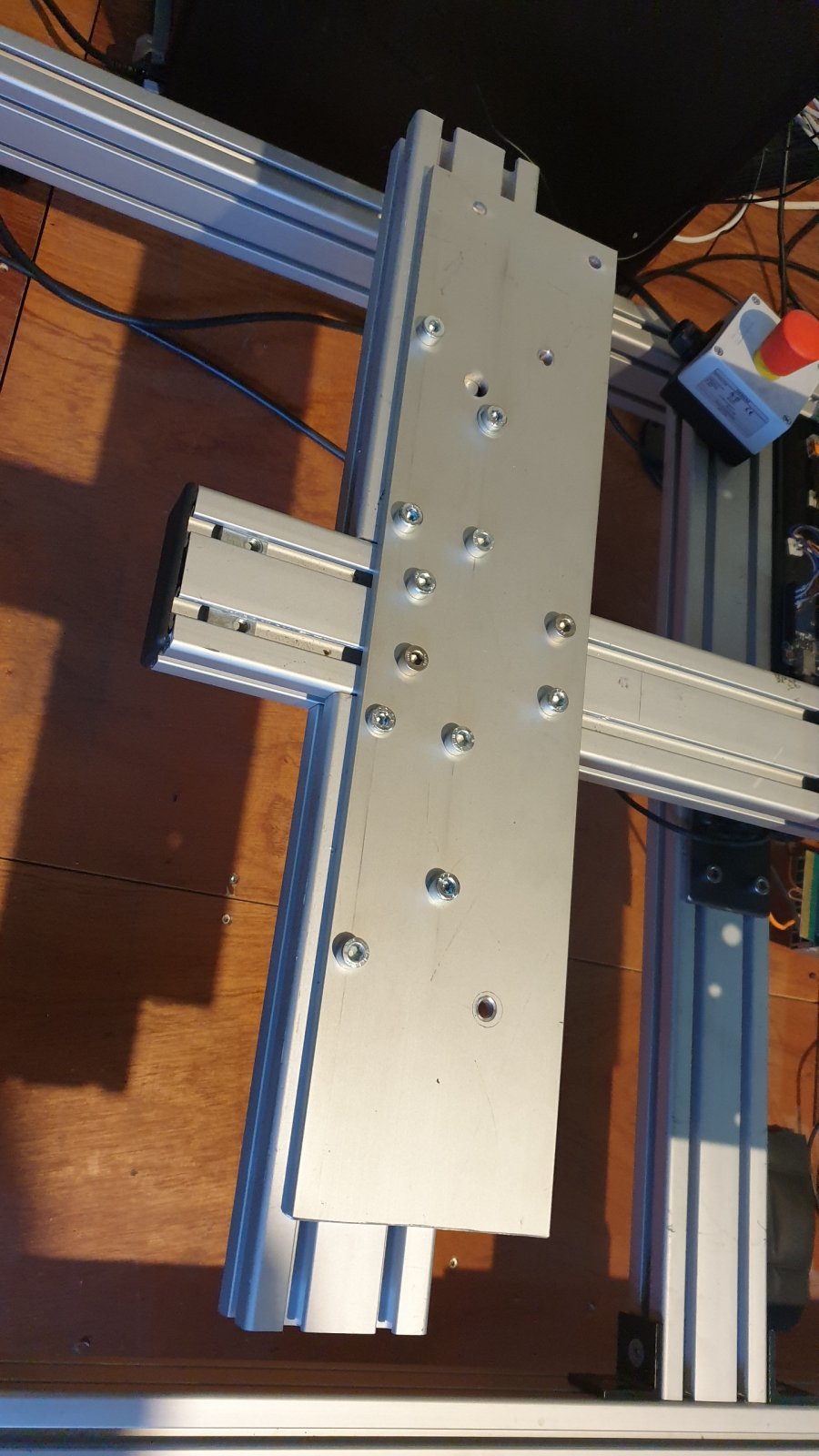

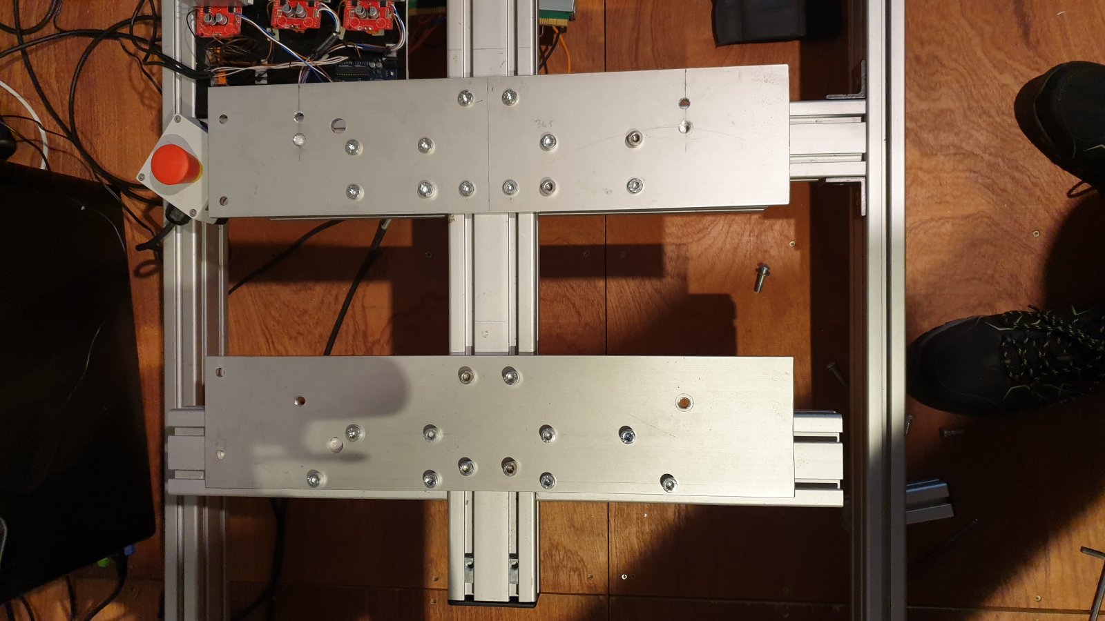

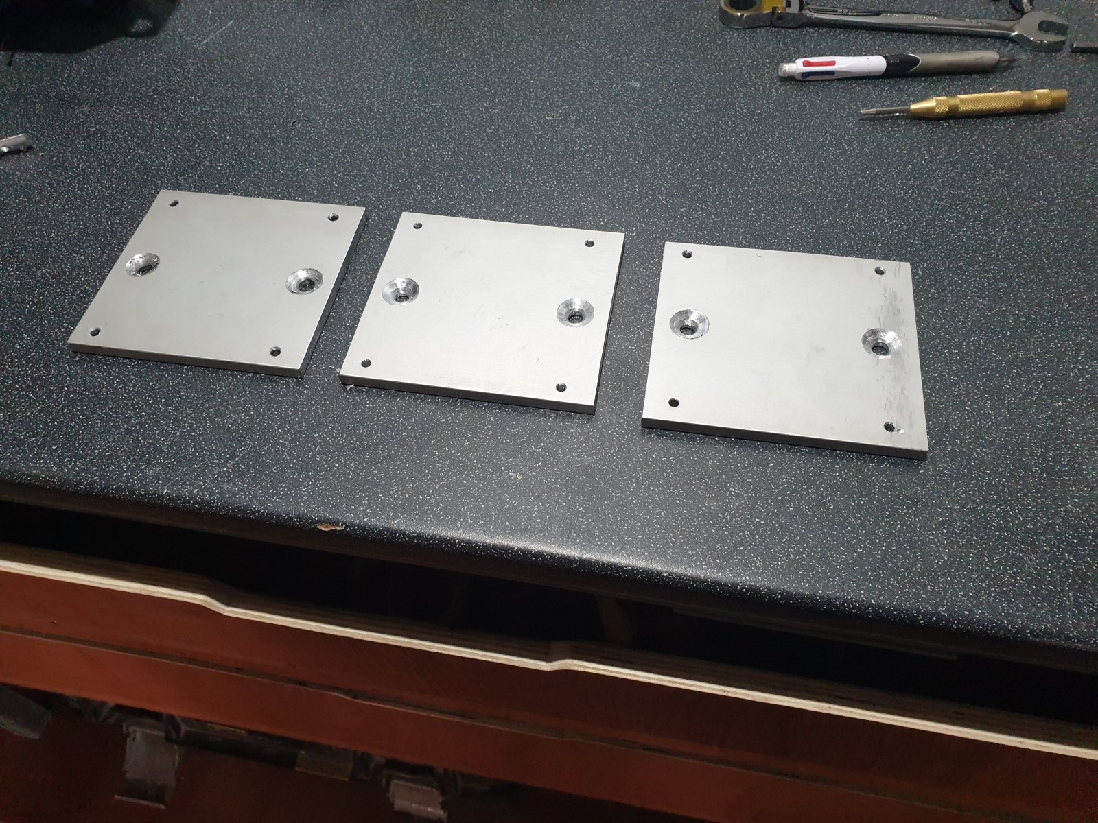

    I had to brace the plates under the seat becauses platform was bending too much under my friends :grin
    This will also allow me to add flying gear.

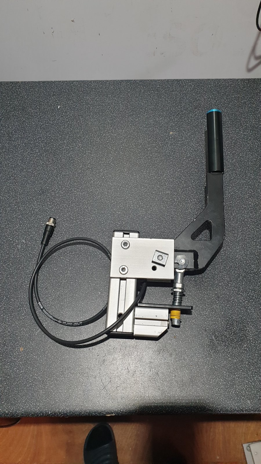

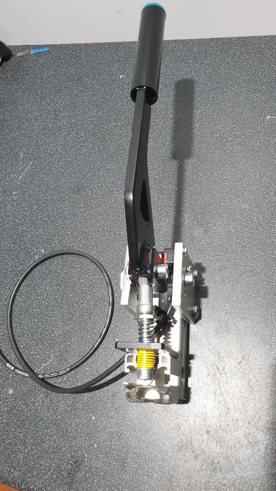

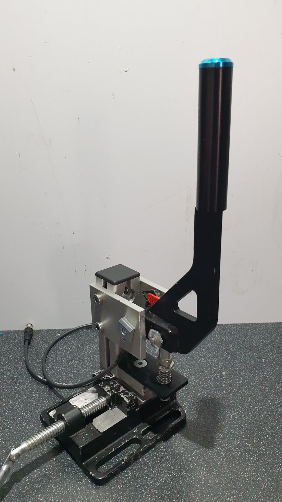

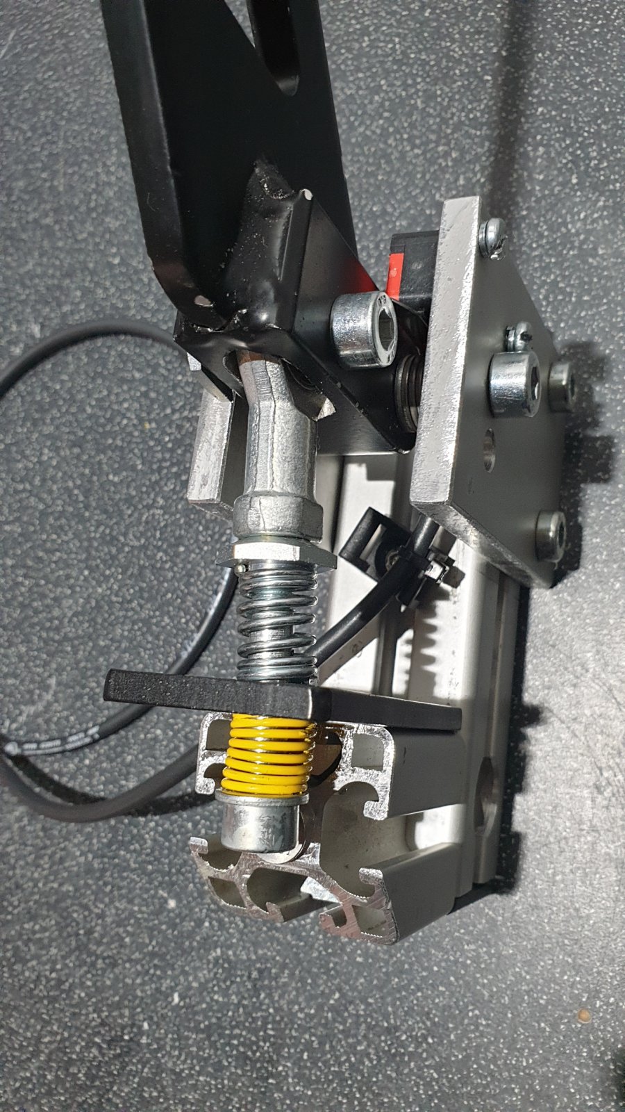

    +26 / 0 / -0

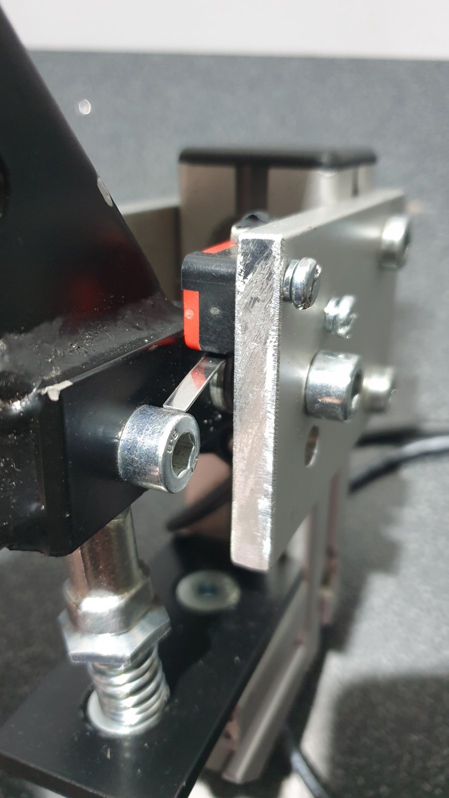

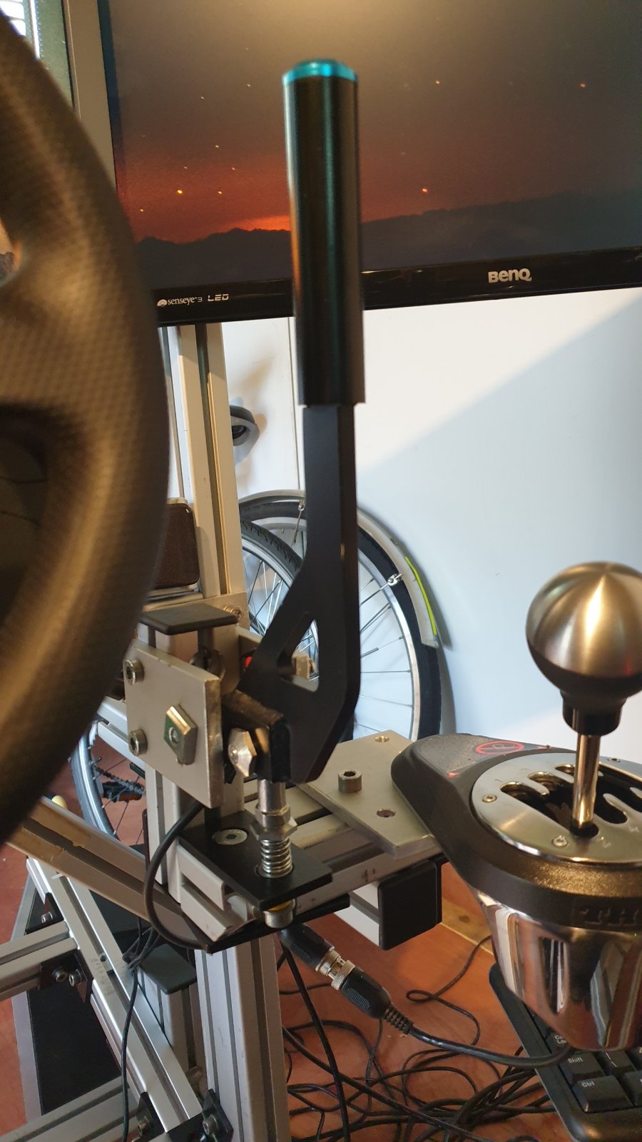

    DIY Hand brake with Aluminium frame
    Total cost £25
    simple micro stick
    Connected through m12 connector to the Thrustmaster wheel. (I have soldered into button R3)
    Work like a charm. Low cost.
    20210316_110840.jpg 20210316_110855.jpg 20210316_110855.jpg 20210316_110901.jpg 20210316_110923.jpg 20210316_111027.jpg

    so did you add an extra din connector to the wheel? My brother has a tx wheel and the th8 shifter but wants a ebrake i'm trying to figure out how to make him one but having surprisingly more trouble finding info on how they wire the din connector then i thought i would.
  15. tomkil192
    tomkil192 Member
    Jun 25, 2015
    81
    Uk. London
    - 25Coins
    +26 / 0 / -0
    Hi. I have simply braked into the r3 wires on the wheel. You need to open the wheel base to do it. I will take some photos later on

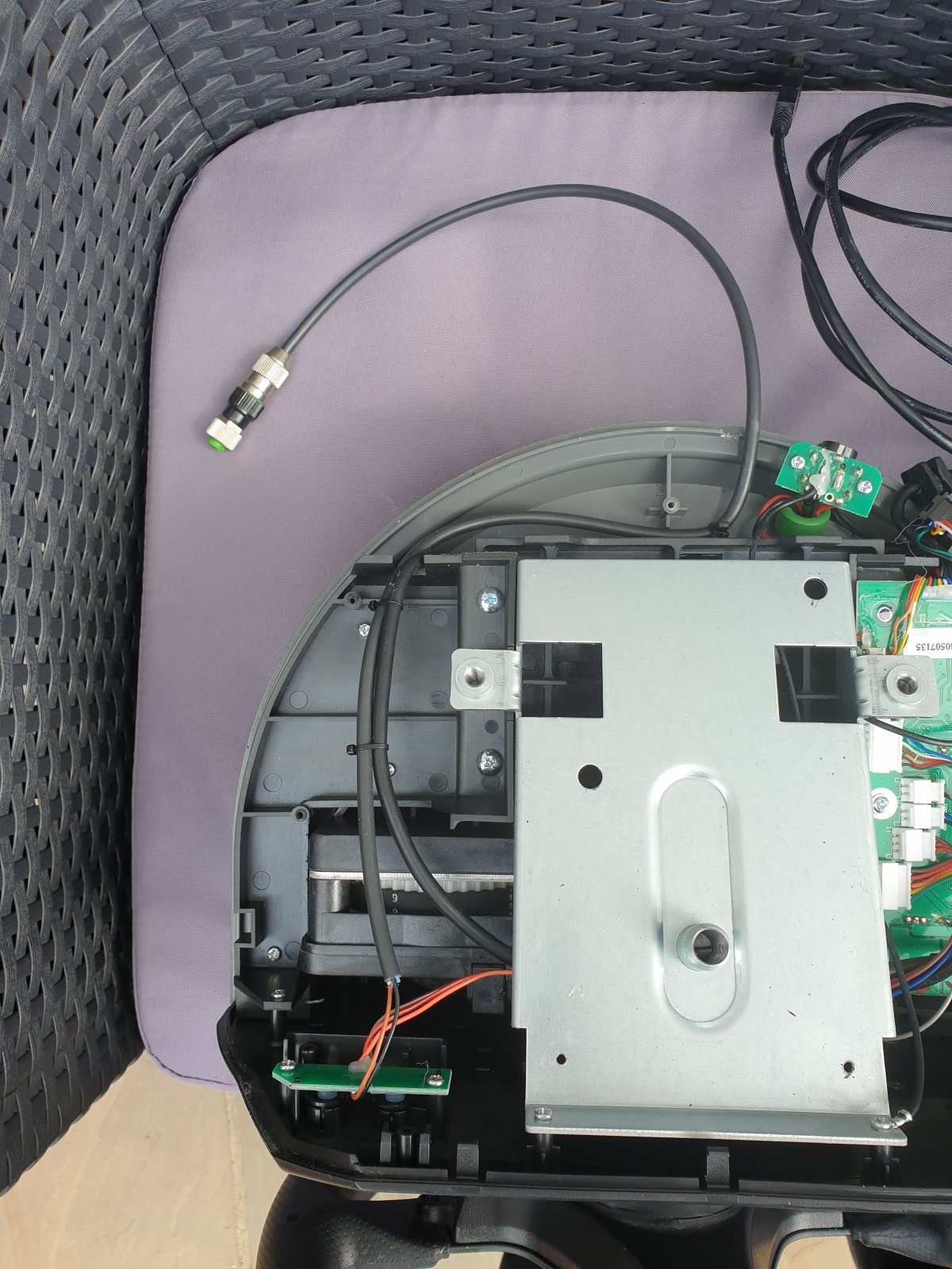

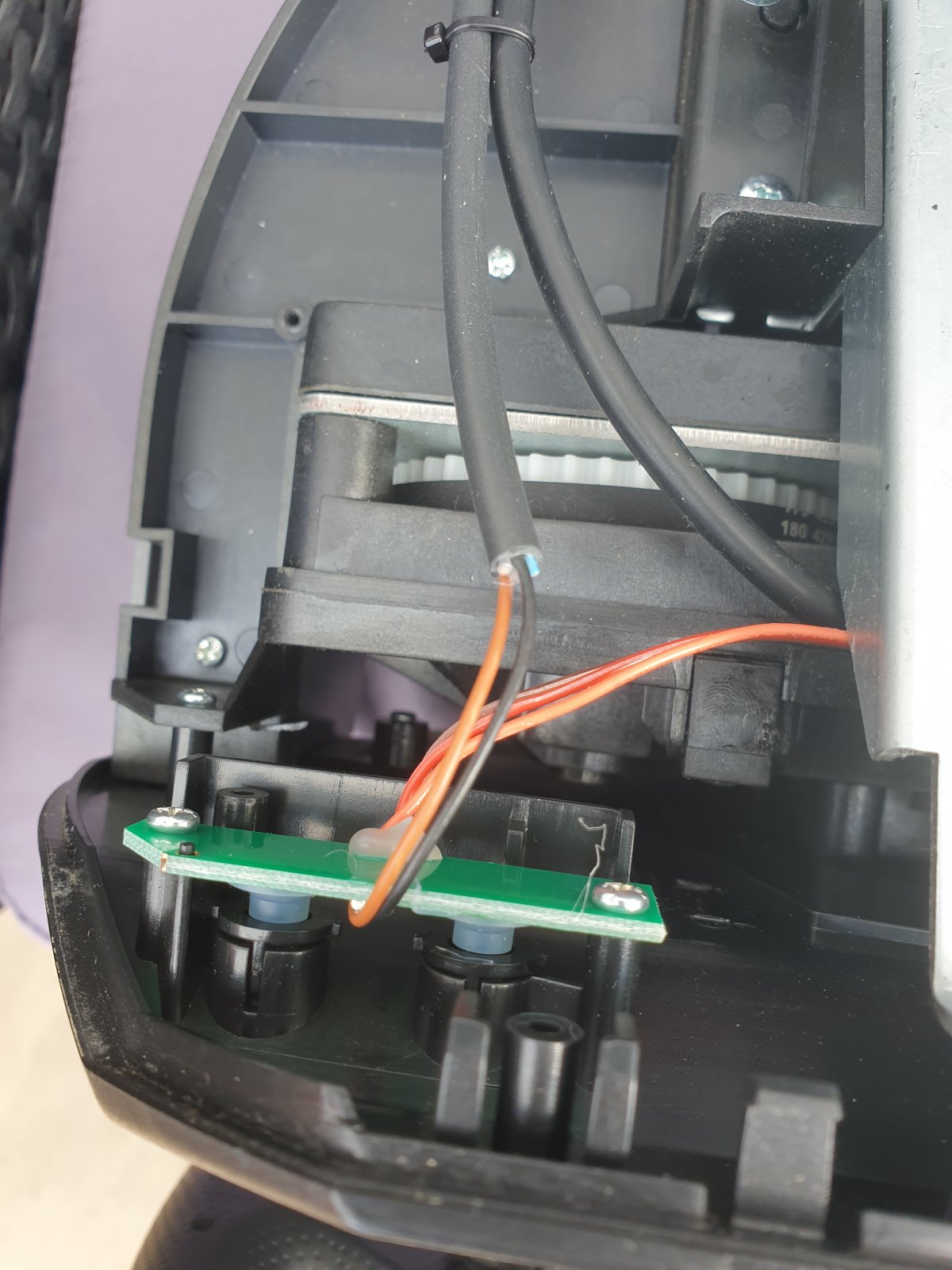

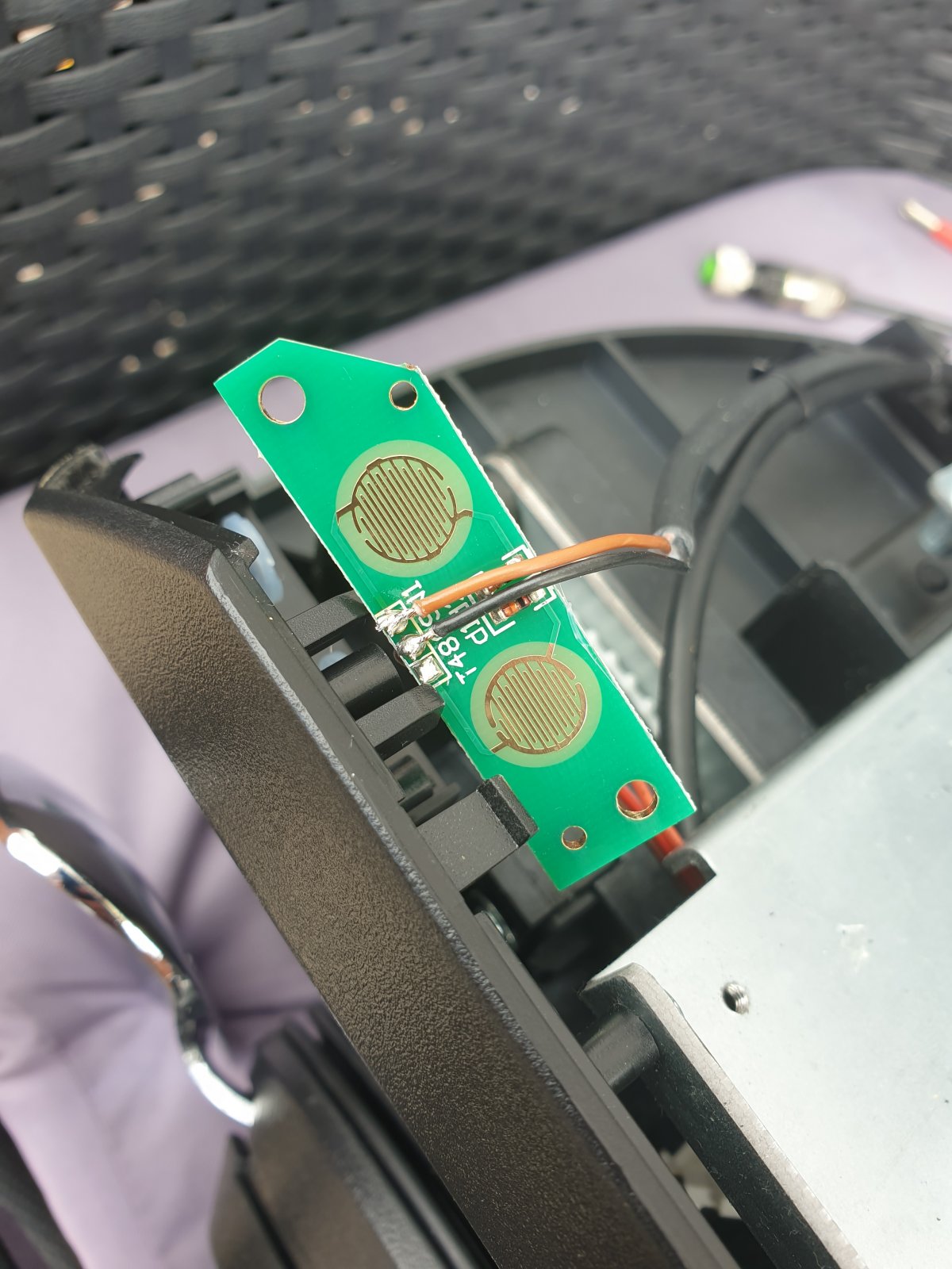

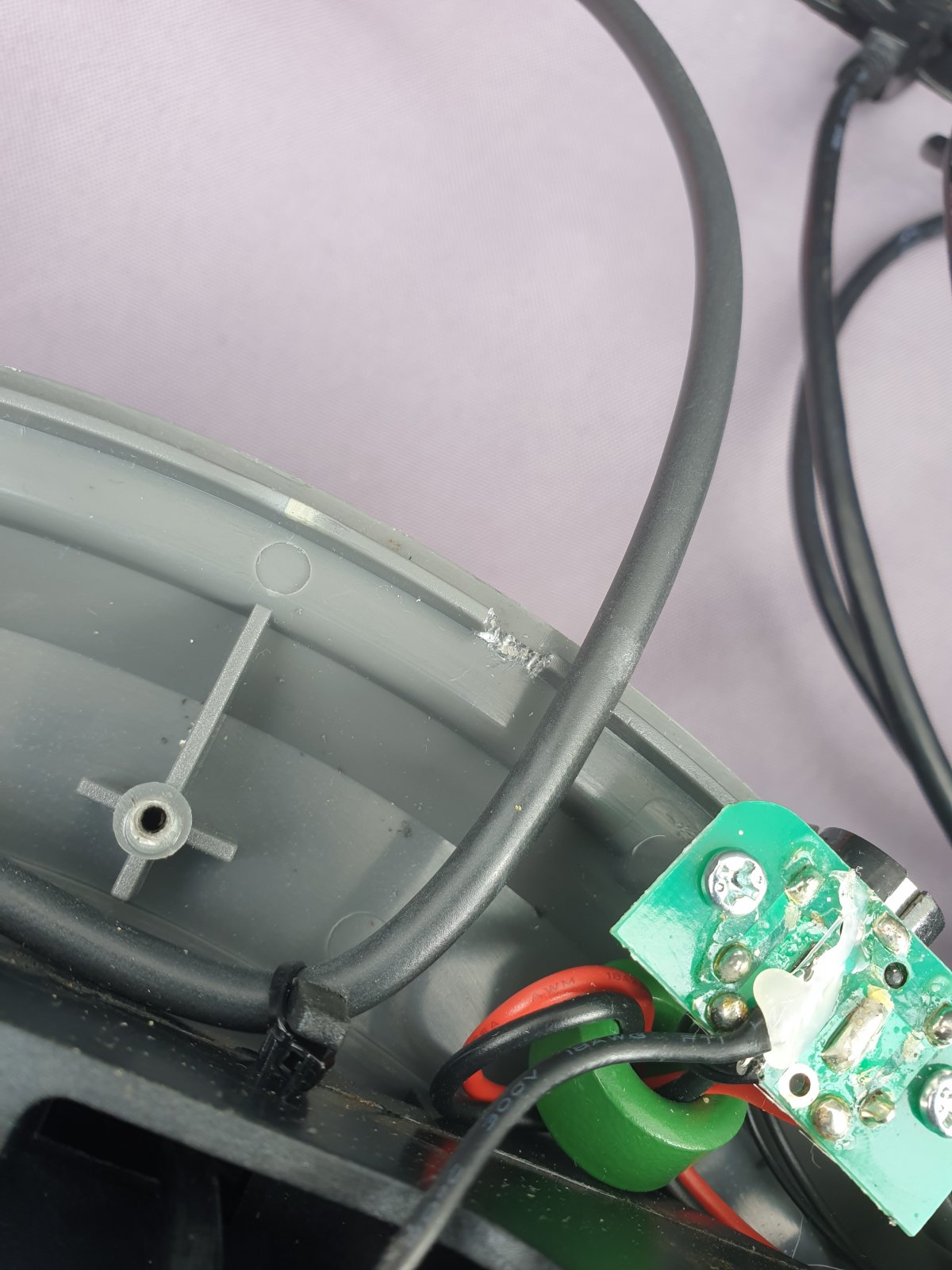

    20210425_102550.jpg bottom of the thrustmaster t500rs ( the same in t300rs)
    20210425_102557.jpg handbrake cable connected to the button r3 (or r2)
    20210425_102705.jpg simply solder as per the photo
    20210425_102711.jpg small cut out at the back for the habdbrake cable.
    Works like a charm with no lag.
