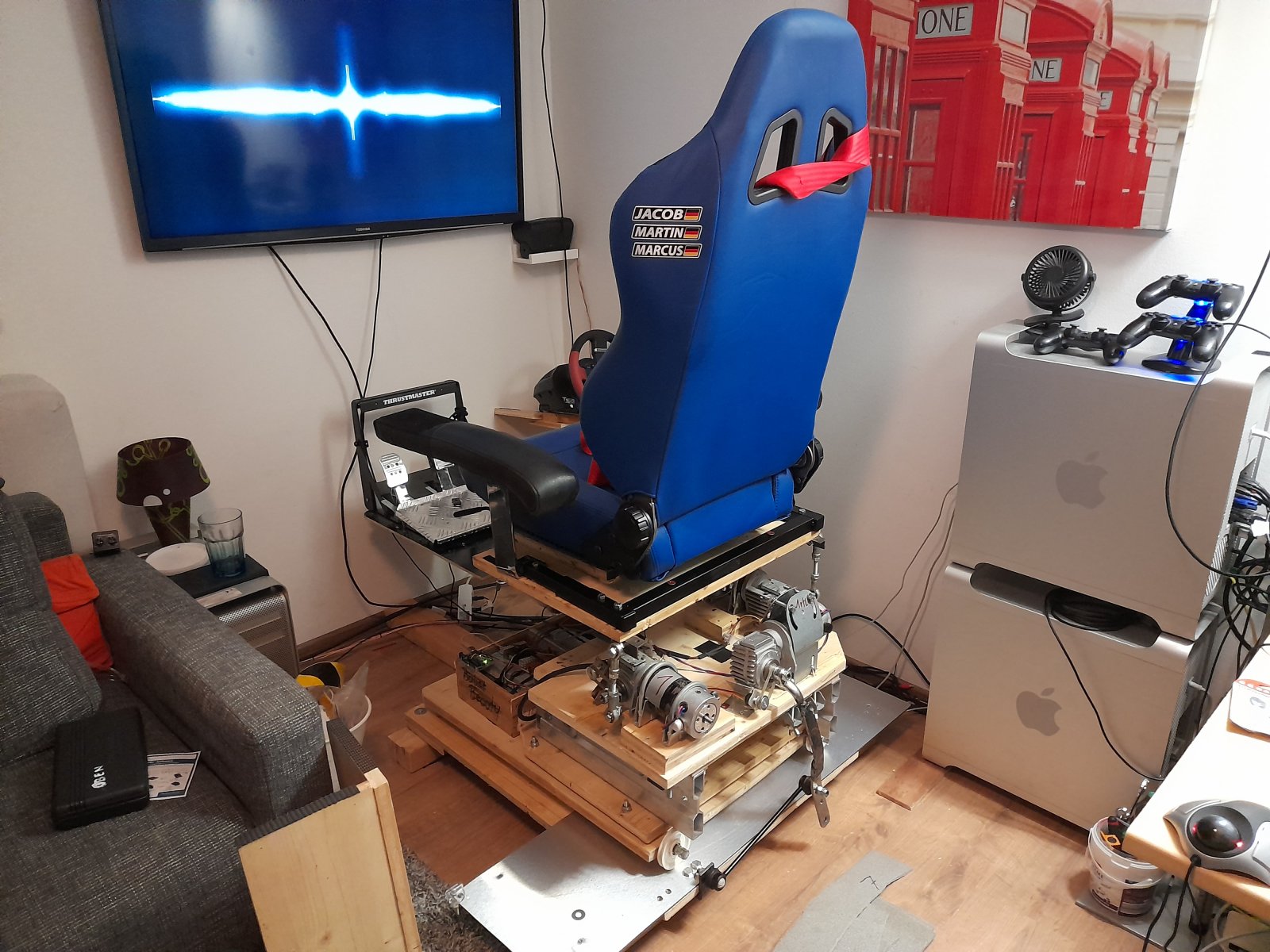

  2. ART FLY

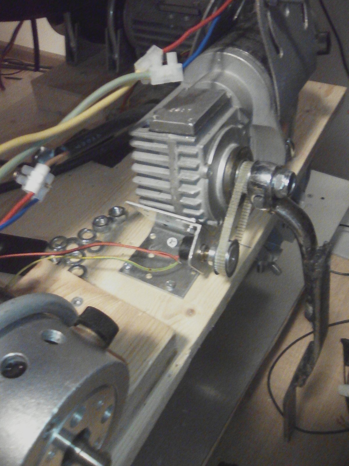

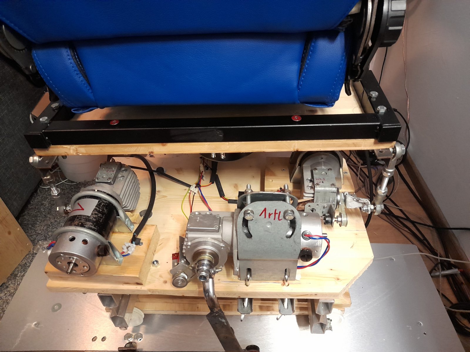

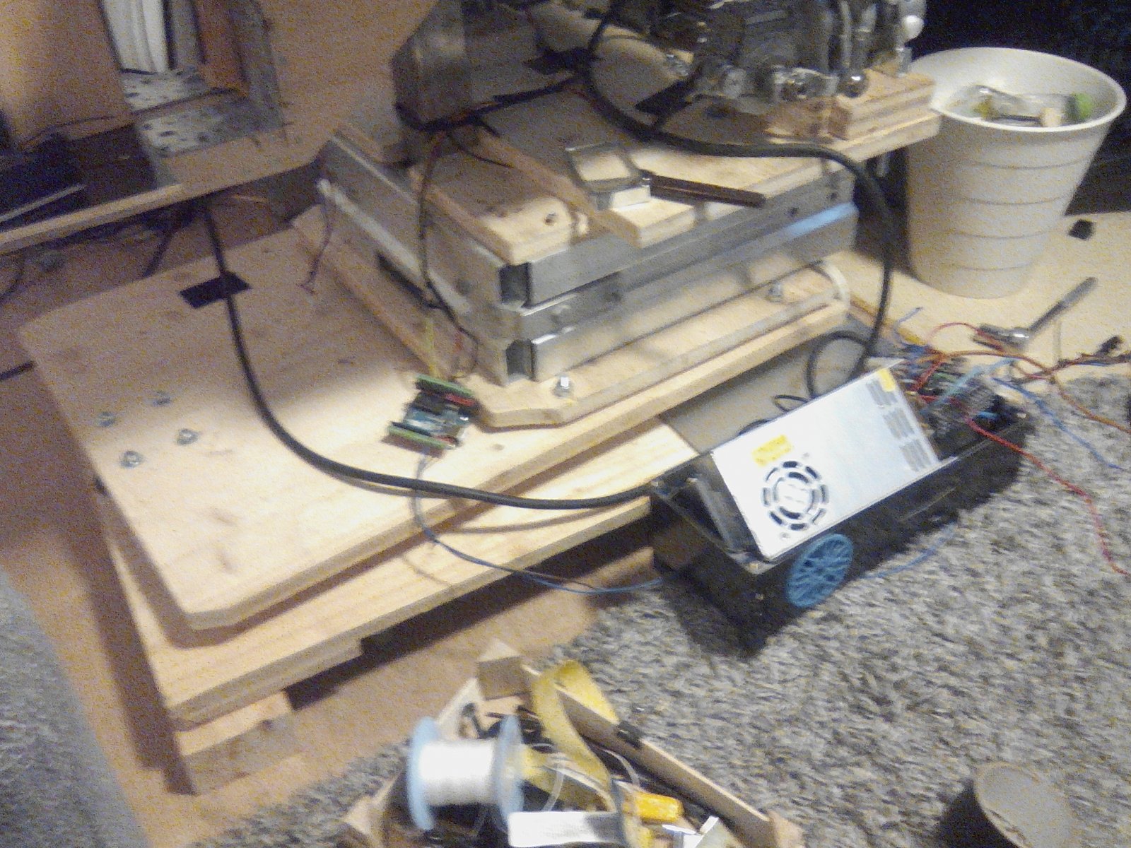

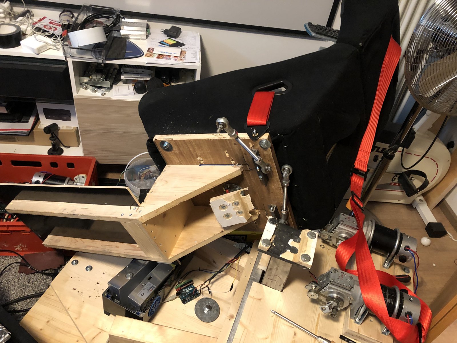

    And now the rocket science o_O
    IMG_20201102_202637.jpg IMG_20201102_202610.jpg IMG_20201102_184434.jpg IMG_20201102_184416.jpg IMG_20201102_184320.jpg

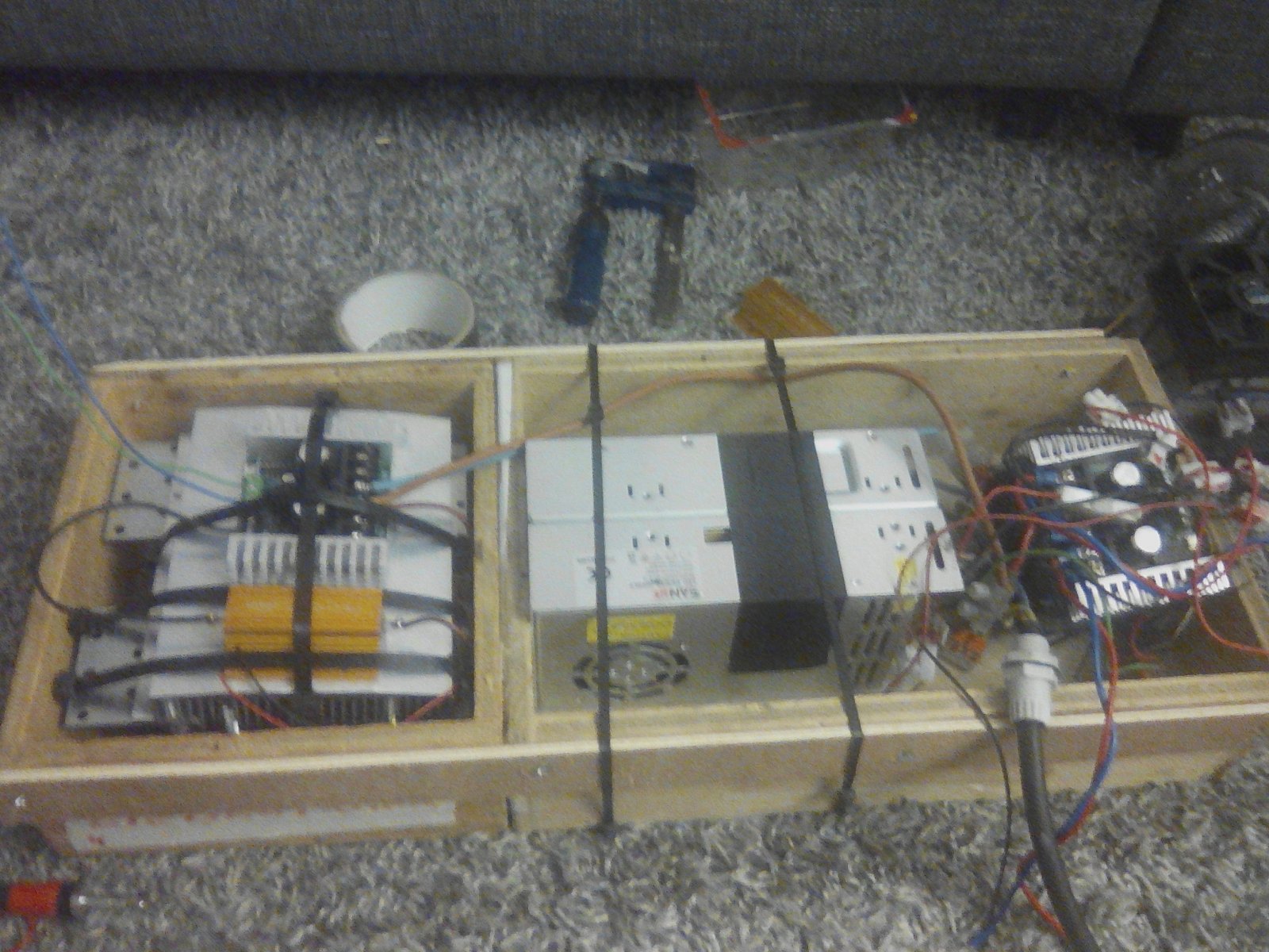

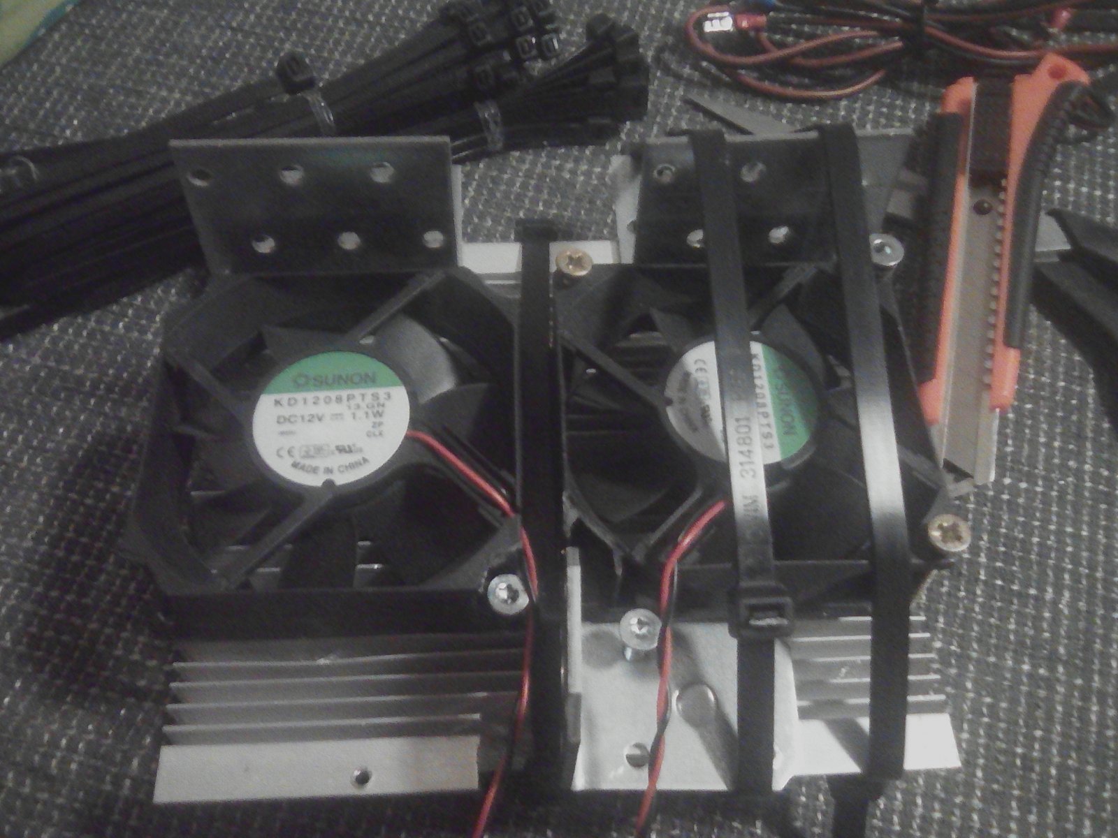

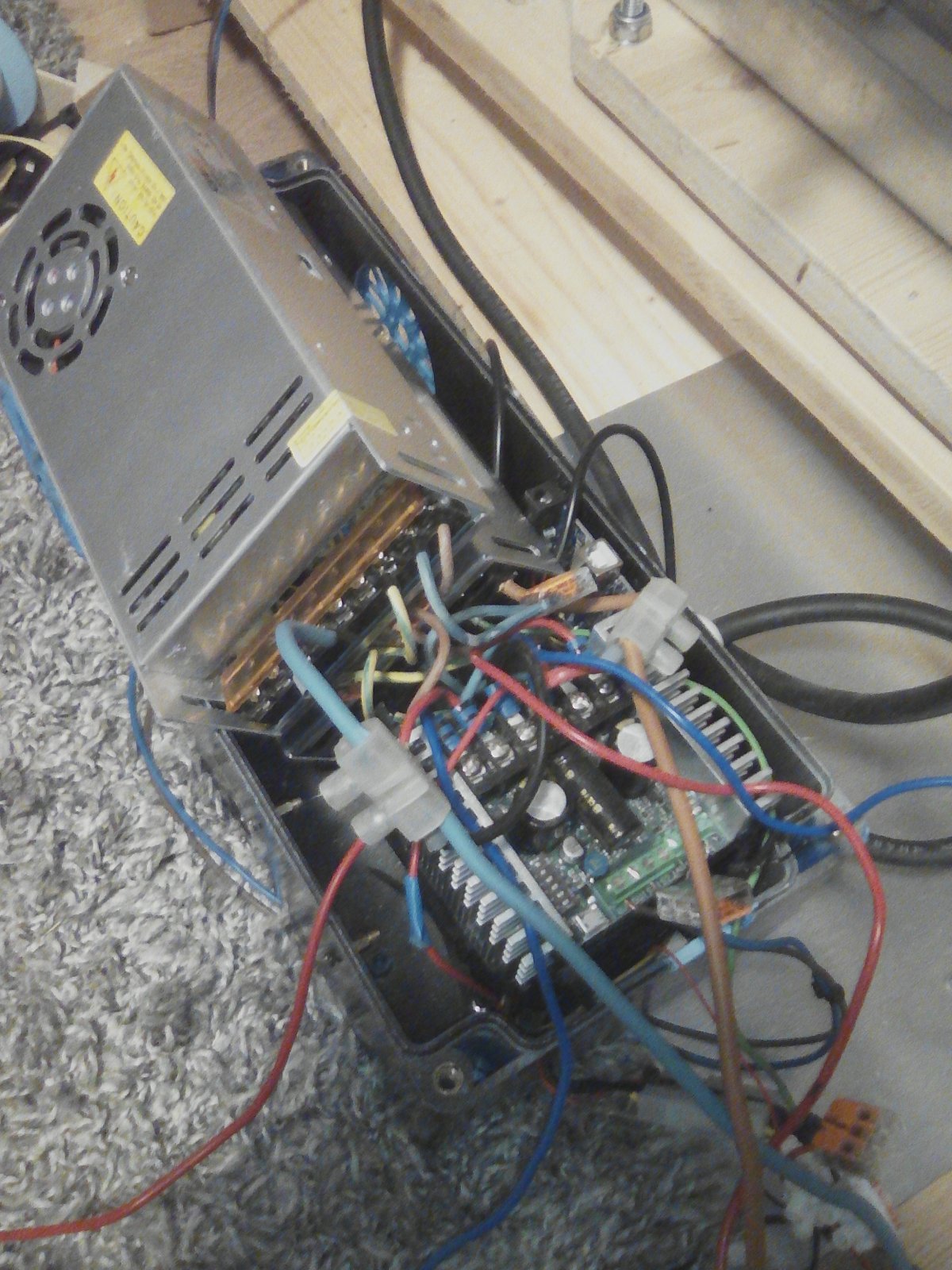

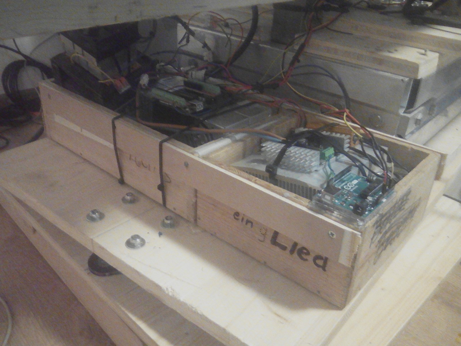

    YippieKaYeah! Vents are running, cabeling checked .... tommorrow is the day to attach the engines ... you will see :cool: wha'ppens.

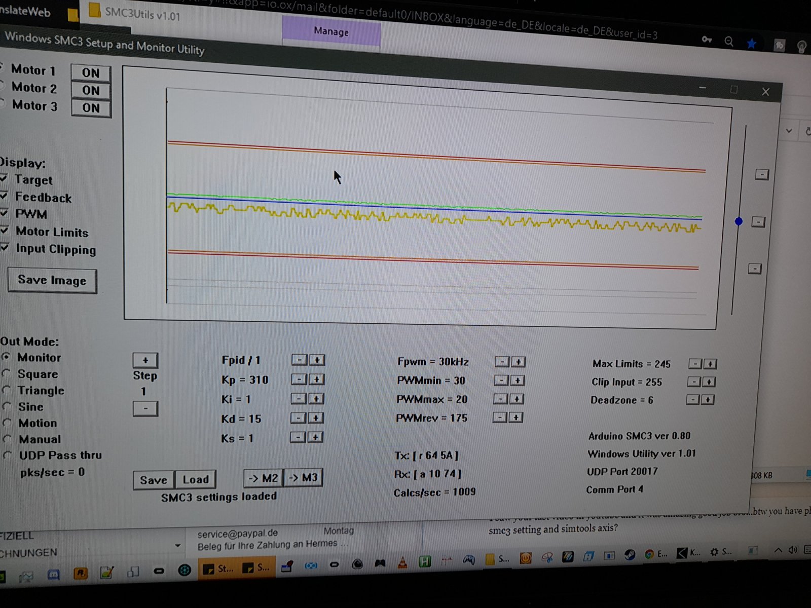

    Congratulations to this successful next step, @ART FLY.
    It seems that the motor is oscillating quite a bit, so that some more PID tuning may be needed.

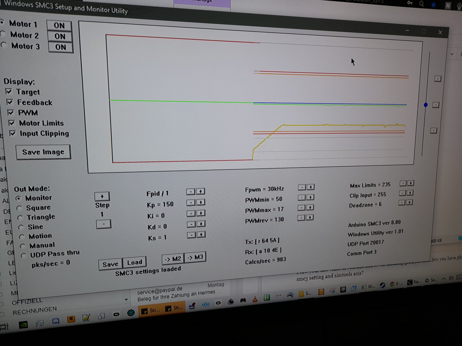

    Now that I finished Motor tuning in smc3utils I am looking forward to start testing in SimTools.

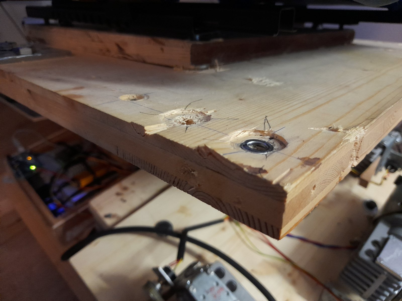

    As I put so much time and spirit into this project I took some time checking what could be done to make DER GERÄT reliable and safe in the long run.

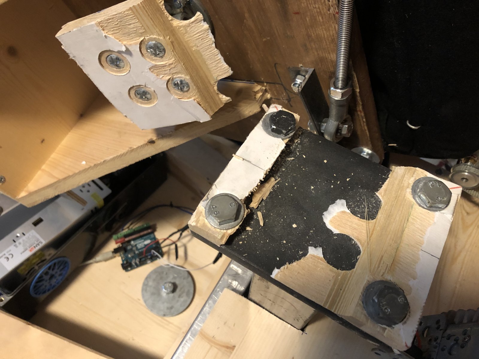

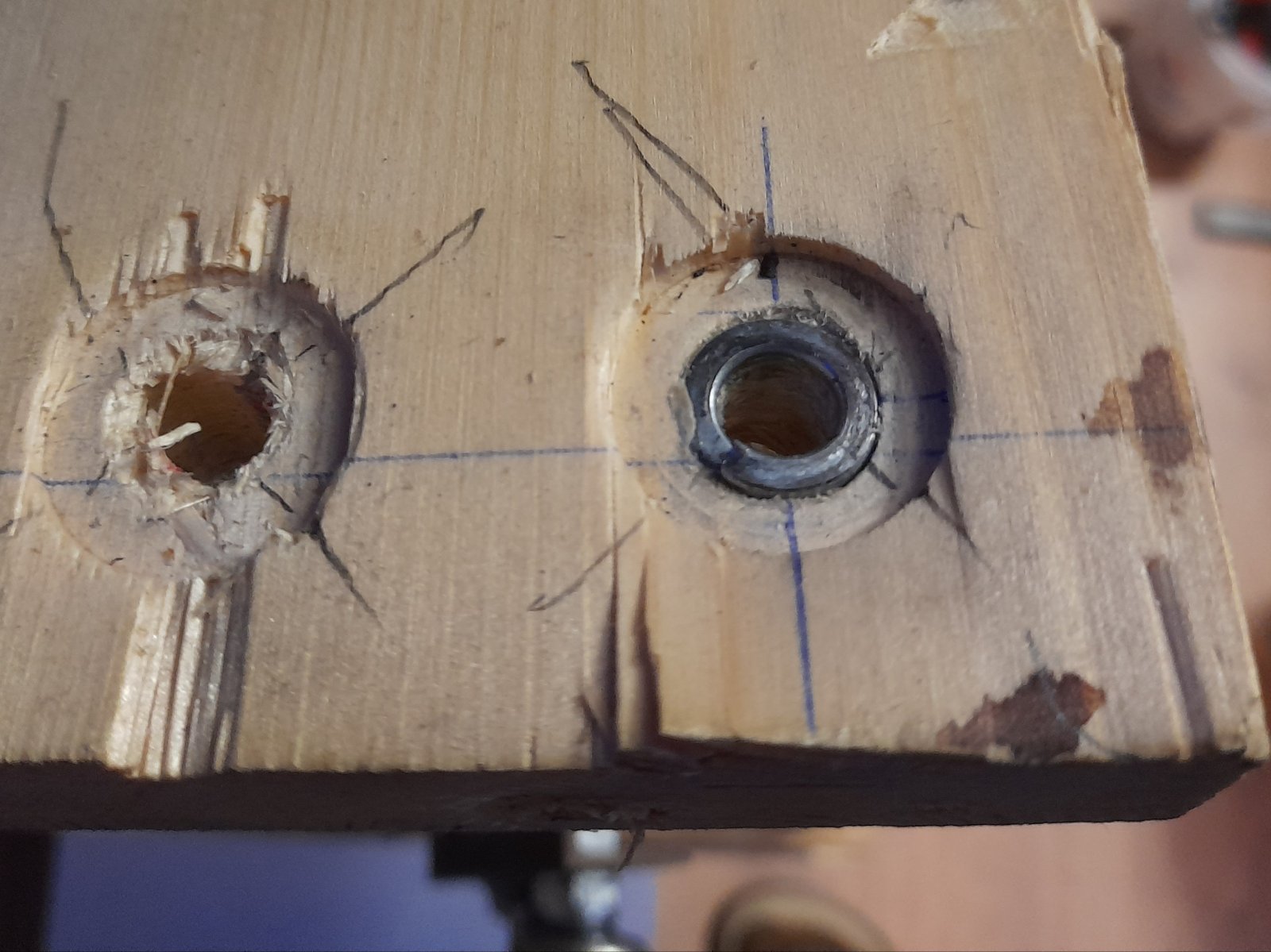

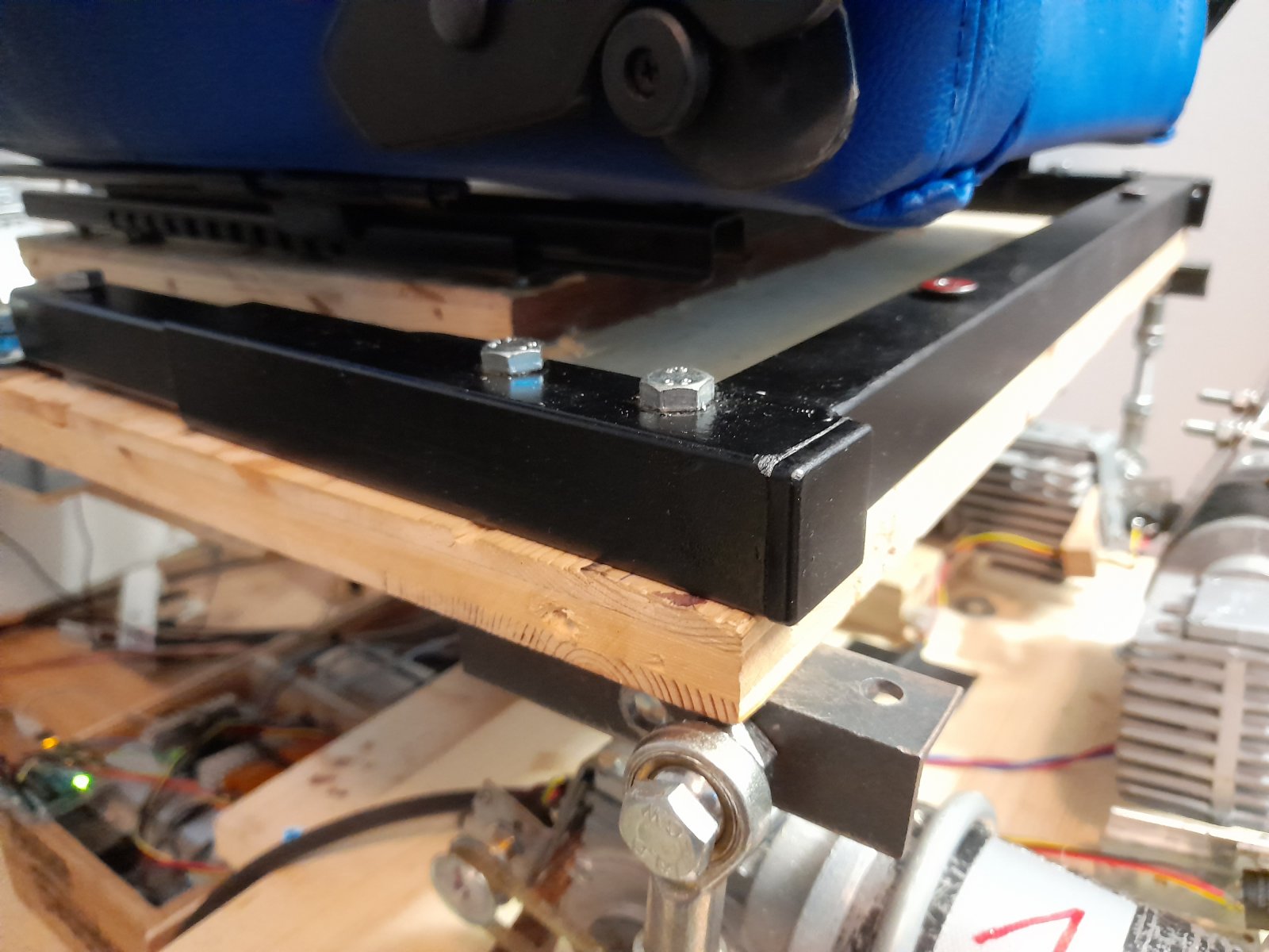

    As I already felt the destruktive power my motors cold have when something goes wrong - I checked all parts today. I found the 21mm carpenter plate was wearing out an would later break if I do not put some bigger armory on it.
    This iron I added will not only make the hardware of DER GERÄT last for a long period - it will for sure also positively improve the performence because the stiffer material will translate in more direct movement. We'll see the next days if that really happens. I am confident :cool:
    Tomorrow is another great day to have a great day - so goodN8 for now.

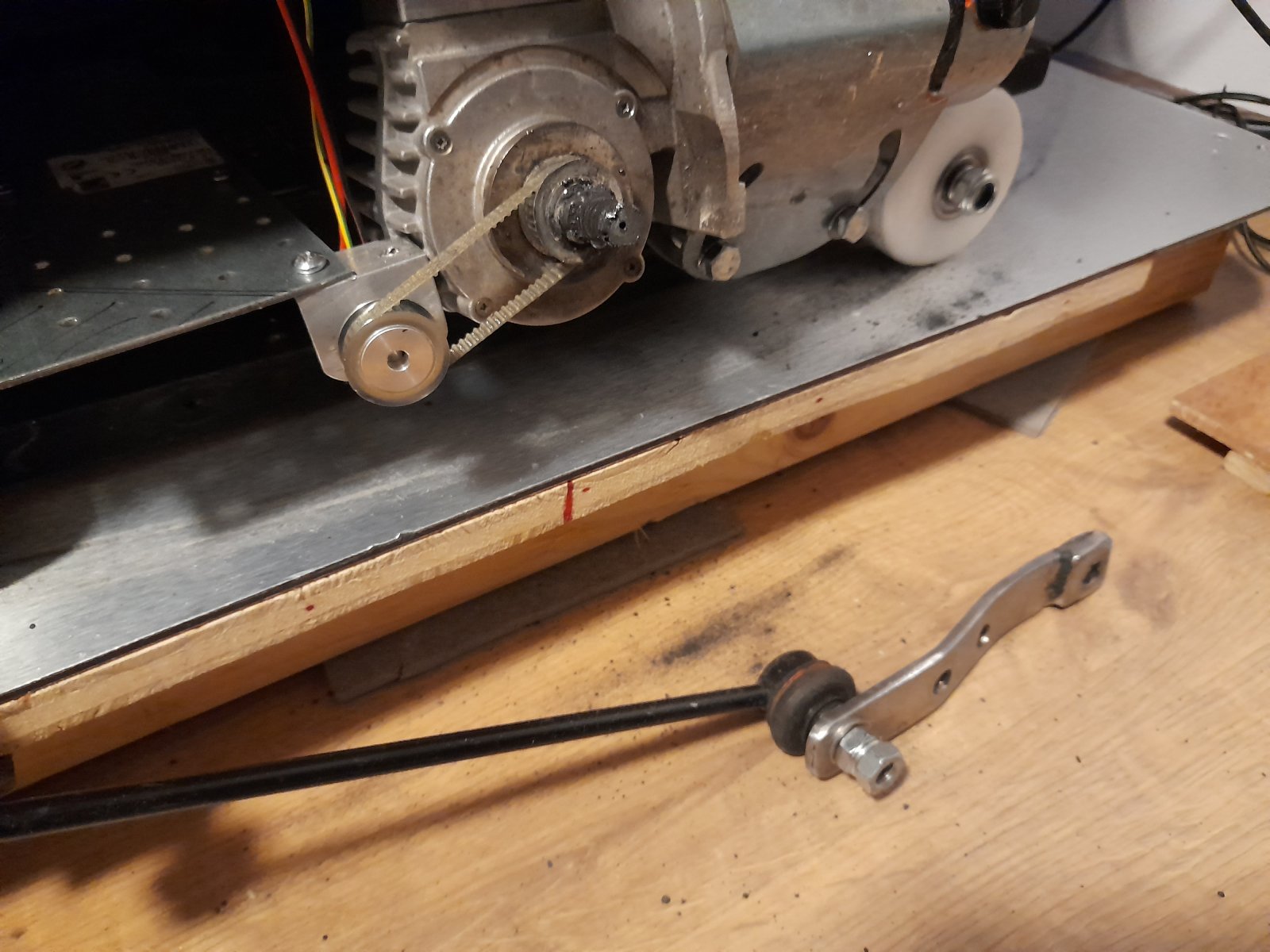

    My welding becomes better :D
    I think this time the lever will hold ... the same I said the two other times before :confused:

    I saw your last video in youtube and it was amazing good job bro...btw you have photo for your smc3 setting and simtools axis?

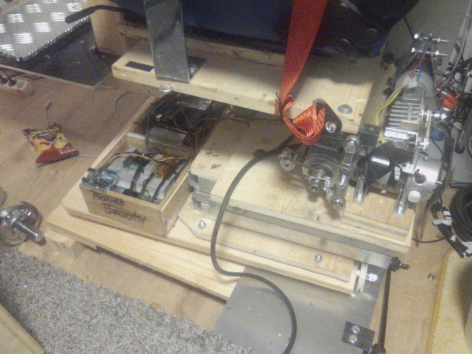

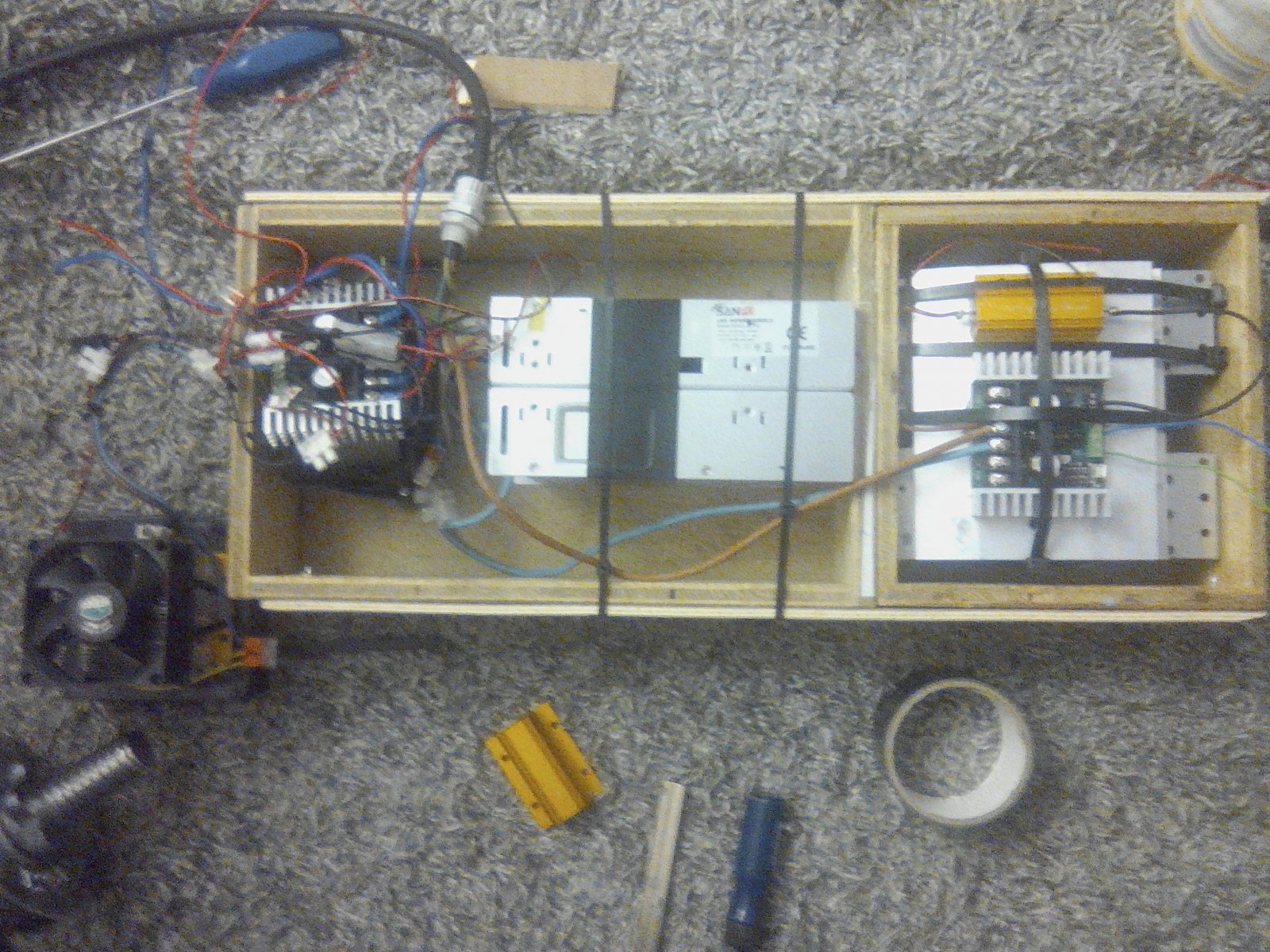

    First picture is motor 3 for Tractionloss.
    Second picture is motor 1 and 2 for the rest.

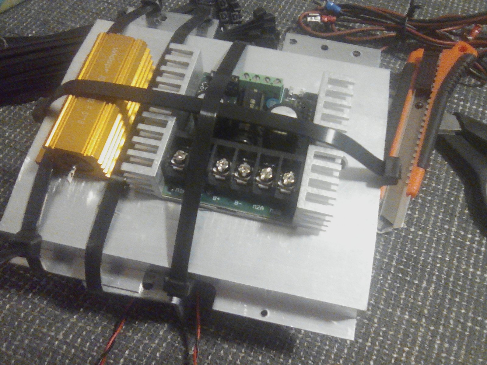

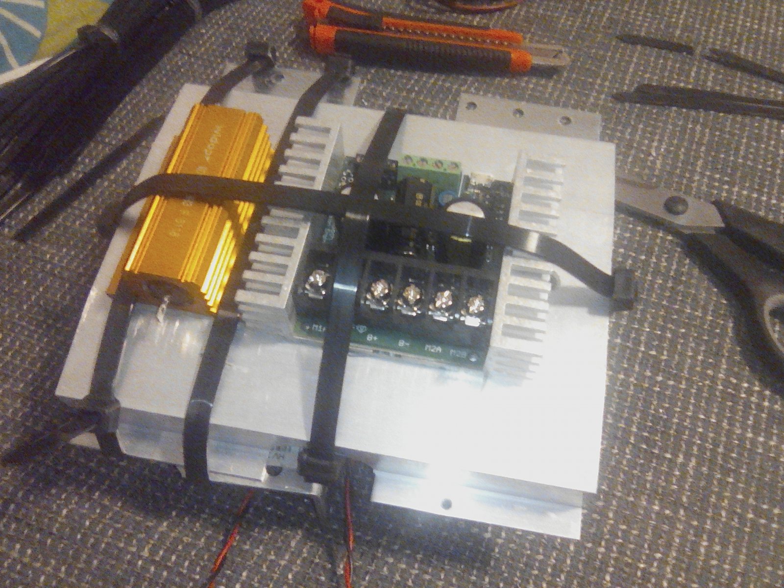

  20. Yinger
    Yinger New Member
    May 12, 2023
    19
    54Coins
    What terminals do you connect the resistors to? I know its p1/p2 but where does the other end go?
